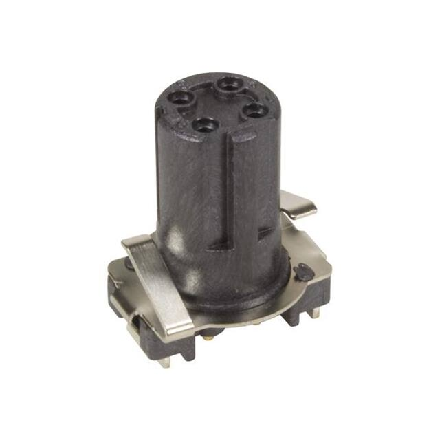

M12 PCB adapter A-coded SMT Mating face A-coding Mating face acc. to IEC 61 076-2-101 Technical characteristics: M12 PCB adapter Degree of protection IP67 (mated and locked) Rated current 4/5 poles: max. 4 A 8 poles: max. 2 A (dependant on PCB layout) Rated voltage 4 poles: 250 V 5 poles:   60 V 8 poles:   30 V Identification Part number Mating cycles ≥ 100 Limiting temperature -40 °C … +85 °C Termination SMT Contact material Copper alloy Contact plating (mating side) Au over Ni Insulator material LCP Drawing Dimensions in mm M12 PCB adapter Male, A-coding, straight, unshielded 4 poles 5 poles 8 poles 21 03 311 1415 21 03 311 1515 21 03 311 1815 Tape on reel 4 poles 5 poles 8 poles 21 03 311 1416 21 03 311 1516 21 03 311 1816 95 M12 PCB adapter A-coded SMT Mating face A-coding Mating face acc. to IEC 61 076-2-101 Identification Part number M12 PCB adapter Male, A-coding, straight, shielded 8 poles 21 03 321 1802 Tape on reel 8 poles 21 03 321 1803 Female socket for front mounting M14x1 H9 21 41 000 0012 Hexagonal nut M14x1 21 41 000 0011 96 Drawing Dimensions in mm M12 PCB adapter A-coded SMT Mating face A-coding Mating face acc. to IEC 61 076-2-101 Technical characteristics: M12 PCB adapter Degree of protection IP67 (mated and locked) Rated current 4/5 poles: max. 4 A 8 poles: max. 2 A (dependant on PCB layout) Rated voltage 4 poles: 250 V 5 poles:   60 V 8 poles:   30 V Identification Part number Mating cycles ≥ 100 Limiting temperature -40 °C … +85 °C Termination SMT Contact material Copper alloy Contact plating (mating side) Au over Ni Insulator material LCP Drawing Dimensions in mm M12 PCB adapter Female, A-coding, straight, unshielded 4 poles 5 poles 8 poles 21 03 311 2410 21 03 311 2510 21 03 311 2810 Tape on reel 4 poles 5 poles 8 poles 21 03 311 2411 21 03 311 2511 21 03 311 2811 97 M12 PCB adapter A-coded SMT Mating face A-coding Mating face acc. to IEC 61 076-2-101 Identification Part number M12 PCB adapter Female, A-coding, straight, shielded 8 poles 21 03 321 2802 Tape on reel 8 poles 21 03 321 2803 Female socket for front mounting M14x1 H9 M14x1 H13 21 41 000 0010 21 41 000 0013 Hexagonal nut M14x1 21 41 000 0011 98 Drawing Dimensions in mm M12 PCB adapter D-coded SMT Mating face D-coding Mating face acc. to IEC 61 076-2-101 Technical characteristics: M12 PCB adapter Degree of protection IP67 (mated and locked) Rated current max. 4 A (dependant on PCB layout) Limiting temperature -40 °C … +85 °C Termination SMT Contact material Copper alloy Rated voltage 250 V Contact plating (mating side) Au over Ni Mating cycles ≥ 100 Insulator material LCP Identification Part number Drawing Dimensions in mm M12 PCB adapter Female, D-coding, straight, shielded 4 poles 21 03 381 2404 Tape on reel 4 poles 21 03 381 2405 Female socket for front mounting M14x1 H9 M14x1 H13 21 41 000 0010 21 41 000 0013 Hexagonal nut M14x1 21 41 000 0011 99 M12 PCB adapter X-coded SMT Mating face X-coding Mating face acc. to IEC 61 076-2-109 Technical characteristics: M12 PCB adapter Degree of protection IP67 (mated and locked) Rated current max. 0.5 A (dependant on PCB layout) -40 °C … +85 °C Termination SMT Contact material Copper alloy Rated voltage 48 V Contact plating (mating side) Au over Ni Mating cycles ≥ 100 Insulator material LCP Identification Part number M12 PCB adapter Female, X-coding, straight, shielded 8 poles 21 03 381 2820 Tape on reel 8 poles 21 03 381 2821 Female socket for front mounting M14x1 H9 M14x1 H13 21 41 000 0010 21 41 000 0013 Hexagonal nut M14x1 21 41 000 0011 100 Limiting temperature Drawing Dimensions in mm
