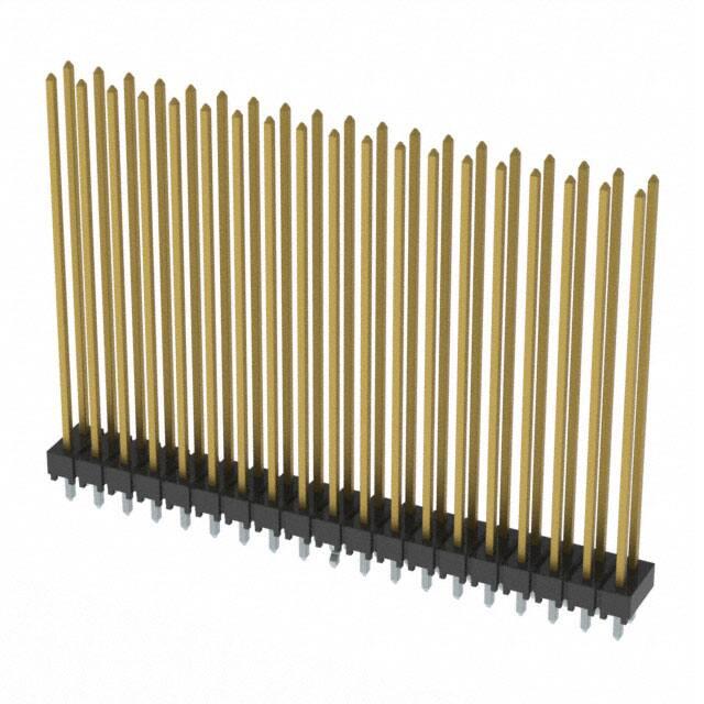

HTSW-119-21-F-D-LL
HTSW-119-21-F-D-LL
    SAMTEC(申泰)
    CONN HEADER VERT 38POS 2.54MM
HTSW-119-21-F-D-LL 数据手册
F-215 (Rev 26AUG15) HTSW–116–11–G–S TSW–209–09–F–S–RA HTSW–115–05–L–Q (2.54 mm) .100" THROUGH-HOLE .025" SQ POST HEADER Mates with: SSW, SSQ, SSM, ESW, ESQ, BCS, BSW, CES, SLW, IDSD, IDSS, SMSD, SMSS SPECIFICATIONS For complete specifications see www.samtec.com?TSW or www.samtec.com?HTSW Insulator Material: TSW: Black Glass Filled Polyester HTSW: Natural Liquid Crystal Polymer Terminal Material: Phosphor Bronze Plating: Au or Sn over 50µ" (1.27 µm) Ni Operating Temp Range: -55°C to +125°C with Gold -55°C to +105°C with Tin Voltage Rating: 550 VAC mated with SSW; 500 VAC mated with BCS or ESQ; 450 VAC -RA/-RE mated with BCS or SSM 400 VAC mated with CES RoHS Compliant: Yes Lead–Free Solderable: HTSW: Yes TSW: Wave Only TYPE STRIP (2.54 mm) Centers, –1 = .100" All Positions Filled TSW = Standard Strip HTSW (5.08) .200 (2.54) .100 (2.54) .100 50 02 (2.54) .100 100 (2.54) (5.02) .100 .198 –D 99 150 (2.54) (7.62) .100 .300 (5.08) (7.56) .200 .298 01 03 –T 148 150 (5.08) (7.56) .200 .298 (7.62) .300 –Q 5.2 A 5.7 A 5.2 A 6.3 A 5.2 A 4.6 A 4.3 A 1 POSITION POWERED PER ROW RECOGNITIONS For complete scope of recognitions see www.samtec.com/quality FILE NO: 090871_0_000 01 Right Angle Versions –S 01 01 03 CURRENT RATING (PER PIN) TSW mated with (2.54) .100 (2.48) .098 (5.08) .200 ESW SSW SLW SSQ SSM BCS SNT (5.08 mm) Centers, – 2 = .200" Every Other Position Filled = Hi-Temp Strip (2.54) .100 x No. of Positions Straight Pin Versions NO. PINS PER ROW PIN CENTERS TSW 148 = .100" (2.54 mm) Center Version HTSW (2.54) .100 x No. of Positions (2.54) .100 (3.02) .119 (1.78) .070 (3.09) (1.78) .122 .070 –S 01 BCS TSW HORIZONTAL ALSO AVAILABLE 50 (2.54) .100 (6.10) .240 (1.78) .070 (5.56) .219 (1.78) .070 (8.12) .320 01 99 03 150 (2.54) .100 (5.08) .200 01 148 03 150 (5.08) .200 (8.12) .320 (8.10) .319 01 TSW HTSW 02 thru 25 = .200" (5.08 mm) Center Version –T –Q (1.78) .070 (1.78) .070 Note: Some lengths, styles and options are non-standard, non-returnable. (8.10) .319 –D (1.78) .070 (1.78) .070 (MOQ Required) • Other platings Contact Samtec. 100 02 APPLICATIONS 01 thru 50 148 WWW.SAMTEC.COM Due to technical progress, all designs, specifications and components are subject to change without notice. TSW–109–10–F–D–RA TSW–114–16–G–S–RE HTSW–120–13–T–D TSW–112–07–G–T TSW, HTSW SERIES PLATING OPTION LEAD STYLE ROW OPTION OTHER OPTIONS –S –F –L –NA = Right Angle (using straight body for coplanar mating with SSW-RA series) = Double Row –G = 10µ" (0.25 µm) Gold on post, Gold flash on balance –T –T = Triple Row = Locking Clip (Styles –08 thru –13 & –22 only) = Right Angle –D = 10µ" (0.25 µm) Gold on post, Matte Tin on tail –LC – RA or –RE = Single Row = Gold flash on post, Matte Tin on tail IDSS or IDSD STRIP ASSEMBLY LOCKING CLIP .025" SQ TERMINAL STRIP (TSW) PC BOARD Requires 4 pin minimum (NA with -T,-Q,-RA or -RE) (1.27) .050 = Matte Tin Straight Pin Versions * * * * A B C STYLE – 05 (3.30) .130 (2.41) .095 (2.54) .100 (5.08) .200 (10.16) .400 (12.70) .500 (15.24) .600 (17.78) .700 (22.86) .900 (8.51) .335 (7.62) .300 (10.92) .430 (13.46) .530 (18.54) .730 (21.08) .830 (23.62) .930 (26.16) 1.030 (31.24) 1.230 (13.46) .530 (2.67) .105 (2.67) .105 –18 – 06 – 07 – 08 – 09 –10 –11 –12 –13 –14 * * * –15 –16 –17 (2.79) .110 (7.87) .310 (2.79) .110 (18.54) .730 (21.08) .830 * * * * * * * * ▲ (5.84) .230 (8.13) .320 (13.21) .520 (8.13) .320 (15.74) .620 –19 – 20 – 21 – 22 – 24 – 25 – 26 – 27 – 28 – 29 – 30 + + * Available with – LL (Locking Lead) Option (0.64) .025 SQ Post (7.62) .300 – 23 – 41 – 42 (2.92) .115 (5.33) .210 (3.20) .126 (25.40) 1.000 (20.32) .800 (23.11) .910 (18.03) .710 (0.89) .035 (1.27) .050 B C (23.62) .930 (26.16) 1.030 (31.24) 1.230 (36.32) 1.430 (16.00) .630 (11.30) .445 (12.15) .480 (16.00) .630 (11.58) .456 (33.78) 1.330 (28.70) 1.130 (33.78) 1.330 (28.70) 1.130 (9.27) .365 (11.94) .470 (18.29) .720 (20.83) .820 (25.91) 1.020 (30.99) 1.220 – 08 – 09 –10 –11 (5.84) .230 (6.73) .265 (8.13) .320 (5.84) .230 (8.13) .320 (5.84) .230 (8.13) .320 SINGLE (– S) –RA LEAD STYLE –12 –13 * * * –16 – 21 – 22 – 25 – 27 – 28 – 29 – 30 A (2.29) .090 (7.37) .290 (9.91) .390 (12.45) .490 (14.99) .590 (20.07) .790 (5.08) .200 (25.15) .990 (4.83) .190 (2.54) .100 (22.61) .890 (17.53) .690 (20.32) .800 (15.24) .600 DOUBLE (– D) TRIPLE (–T & – Q) A A (2.29) .090 (7.37) .290 (9.91) .390 (12.45) .490 (14.99) .590 (20.07) .790 (5.08) .200 (2.29) .090 (7.37) .290 (9.91) .390 (12.45) .490 (14.99) .590 C (5.84) .230 (8.13) .320 (5.84) .230 (8.13) .320 (5.84) .230 (8.13) .320 with HTSW only. B (2.54) .100 LEAD STYLE A B – RA (1.52) .060 (0.64) .025 SQ Tail ▲ – RE Specify -07 for best mate with IDXX Series IDC Cable – 09 (4.83) .190 (7.37) .290 (9.91) .390 (12.45) .490 (17.53) .690 (2.54) .100 (22.61) .890 (2.29) .090 (20.07) .790 (14.99) .590 –10 –11 –12 –13 –16 – 21 N/A N/A – 22 (4.83) .190 (2.54) .100 (4.83) .190 (2.54) .100 – 27 – 28 N/A A C (5.84) .230 (8.13) .320 (5.84) .230 *Available with – LA (Locking Lead) Option (17.53) .690 N/A N/A (15.24) .600 A (0.46) .018 DIA Tail SINGLE (5.08) .200 C ▲Except: Style –26 – RE LEAD STYLE N/A + Style –41 & –42 available C –“XXX” = Polarized Position (Specify “LEAD STYLE” from chart and select –RA or –RE from other options) A (2.79) .110 Two leads per strip crimped in opposite directions on or near centerline. See charts for available styles. N/A with single row 1 or 2 positions. Recommended hole size (1.02 mm ± 0.03 mm) .040" ± .001" Right Angle Versions (Specify “LEAD STYLE” from chart) STYLE = –RA Option with –LL Option = Locking Lead = Double Row (5.08 mm) .200" row space • Elevated Right Angle option • Shunts Contact Samtec –LA –LL –Q OTHER SOLUTIONS (1.78) .070 C A (2.54) .100 B (2.54) .100 (4.06) .160 WWW.SAMTEC.COM Due to technical progress, all designs, specifications and components are subject to change without notice. (2.54) .100
