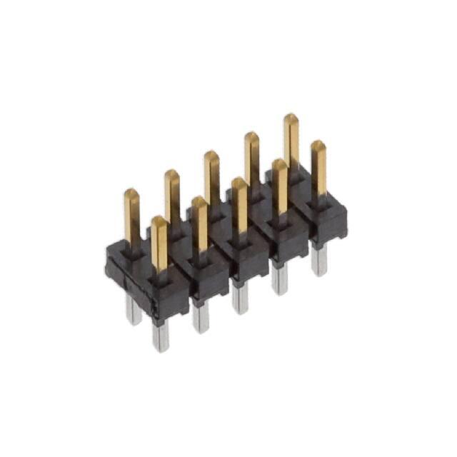

    针座连接器 通孔 10 位置 0.079"(2.00mm)
MTMM-105-03-L-D-146 数据手册
REVISION AG DO NOT SCALE FROM THIS PRINT NOTES: MTMM-1XX-XX-XX-X-XXX-XX-XXX 1. C REPRESENTS A CRITICAL DIMENSION. 2. MAXIMUM ALLOWABLE BOW: 0.005[.13] IN/IN AFTER ASSEMBLY. 3. MAXIMUM PIN ROTATION IN BODY: 2° 4. MINIMUM PUSHOUT FORCE: 1LB 5. CUT PARTS WITH METAL WASHERS TOWARDS OPERATOR ALLOWING FLASH TO BE ON POST AWAY FROM CRITICAL AREA (METAL WASHERS). C 6. INSERT PINS SO THAT BANDOLIER MARKS ARE LIMITED IN THE POST AREA (SEE TABLE 3). C TERMINAL SPEC LEAD STYLE (SEE TABLE 1) PLATING SPECIFICATION (NO OF POS x .0787[2.000]) +.0000[0.000] -.0100[0.254] .0787 2.000 REF 02 T-1S13-XX-XX-2 OPTION POLARIZATION SPECIFY POS -XXX TO BE OMITTED No OF POSITIONS -01 THRU -50 01 .020 0.50 SQ REF (TYP) OPTION **-MW: METAL WASHER (-D & -Q BODY SPECS ONLY) (SEE FIG 4, SHT 2) (30 POS PER ROW MAX) TAIL MUST BE .090[2.29] - .300[7.62] POST HEIGHT XXX = "A" (SEE TABLE 1) -G: 20µ" SELECTIVE GOLD IN CONTACT AREA, 3µ" SELECTIVE GOLD ON TAIL. -T: MATTE TIN ON CONTACT AND TAIL. -S: 30µ" SELECTIVE GOLD IN CONTACT AREA, MATTE TIN ON TAIL. -L: 10µ" SELECTIVE GOLD IN CONTACT AREA, MATTE TIN ON TAIL. -F: 3µ" SELECTIVE GOLD IN CONTACT AREA, MATTE TIN ON TAIL. -H: 30µ" SELECTIVE GOLD IN CONTACT AREA, 3µ" SELECTIVE GOLD ON TAIL. -SM: 30µ" SELECTIVE GOLD IN CONTACT AREA, MATTE TIN ON TAIL. -TM: MATTE TIN ON CONTACT AND TAIL. -LM: 10µ" SELECTIVE GOLD IN CONTACT AREA, MATTE TIN ON TAIL. -FM: 3µ" SELECTIVE GOLD IN CONTACT AREA, MATTE TIN ON TAIL. BODY SPECIFICATION -S: SINGLE (TMM-50-S, SEE FIG 1) -D: DOUBLE (TMM-50-D, SEE FIG 2, SHT 2) -Q: QUAD (TMM-50-Q, SEE FIG 3, SHT 2) ** -MW OPTION, DO NOT DESIGN IN. SAMTEC WILL ONLY SUPPORT EXISTING BUSINESS 02/08/2002 C "A"±.005[0.124] (.0000[0.000] MIN) "L" TAIL REF .0590 1.499 REF 2 MAX SWAY (EITHER DIRECTION) 2 MAX SWAY (EITHER DIRECTION) .0787 2.000 REF FIG 1 -S: SINGLE ROW OPTION MTMM-1XX-02-XX-S-100 SHOWN UNLESS OTHERWISE SPECIFIED, DIMENSIONS ARE IN INCHES. TOLERANCES ARE: DECIMALS ANGLES .XX: .01 [0.3] 2 .XXX: .005 [0.13] .XXXX: .0020 [0.051] MATERIAL: PROPRIETARY NOTE THIS DOCUMENT CONTAINS INFORMATION CONFIDENTIAL AND PROPRIETARY TO SAMTEC, INC. AND SHALL NOT BE REPRODUCED OR TRANSFERRED TO OTHER DOCUMENTS OR DISCLOSED TO OTHERS OR USED FOR ANY PURPOSE OTHER THAN THAT WHICH IT WAS OBTAINED WITHOUT THE EXPRESSED WRITTEN CONSENT OF SAMTEC, INC. DO NOT SCALE DRAWING INSULATOR: LCP, UL 94 VO, COLOR: BLACK TERMINAL: PHOS BRONZE SHEET SCALE: 4:1 520 PARK EAST BLVD, NEW ALBANY, IN 47150 PHONE: 812-944-6733 FAX: 812-948-5047 e-Mail info@SAMTEC.com code 55322 DESCRIPTION: 2MM TERMINAL STRIP ASSEMBLY DWG. NO. MTMM-1XX-XX-XX-X-XXX-XX-XXX F:\DWG\MISC\MKTG\MTMM-1XX-XX-XX-X-XXX-XX-XXX-MKT.SLDDRW BY: REIDINGER 12/01/1993 SHEET 1 OF 2 REVISION AG 04 02 01 03 .1550 3.937 REF 01 05 .3150 8.000 REF .0787 2.000 REF FIG 2 .0787 2.000 REF (TYP) FIG 3 -D: DOUBLE ROW OPTION MTMM-1XX-02-XX-D-100 SHOWN (SAME AS FIG 1, DIFFERENT AS SHOWN) -Q: QUAD ROW OPTION MTMM-1XX-02-XX-Q-100 SHOWN (SAME AS FIG 1, DIFFERENT AS SHOWN) 'A' .090 2.29 'B' IN PROCESS 1 SCALE 4:1 .005 0.13 MAX DETAIL 'B' SCALE 16 : 1 FIG 4 SQT-MW -MW: METAL WASHER OPTION MTMM-1XX-02-XX-X-100-MW SHOWN (ONE PER POSITION) (-D &-Q PODY SPEC ONLY, SEE NOTE 5) (SAME AS FIG 1, DIFFERENT AS SHOWN) ** -MW OPTION, DO NOT DESIGN IN. SAMTEC WILL ONLY SUPPORT EXISTING BUSINESS 02/08/2002 C +.0080 +0.203 .0590 - .0050 1.499 - 0.127 "A" REF (SEE TABLE 1, SHT 4) DETAIL 'A' SCALE 8 : 1 .075 1.91 REF IN PROCESS 2 SCALE 4:1 C BANDOLIER REF IN PROCESS 4 (-T PLATING ONLY) (SEE NOTE 6 & TABLE 3) TAIL AREA PROPRIETARY NOTE .0050 0.127 MAX MEASURE AT TAIL 2 MAX SWAY (EITHER DIRECTION) .0050 0.127 MAX MEASURE AT TAIL POST AREA .090 2.29 THIS DOCUMENT CONTAINS INFORMATION CONFIDENTIAL AND PROPRIETARY TO SAMTEC, INC. AND SHALL NOT BE REPRODUCED OR TRANSFERRED TO OTHER DOCUMENTS OR DISCLOSED TO OTHERS OR USED FOR ANY PURPOSE OTHER THAN THAT WHICH IT WAS OBTAINED WITHOUT THE EXPRESSED WRITTEN CONSENT OF SAMTEC, INC. IN PROCESS 3 SCALE 4:1 REPRESS TO PROPER TAIL DIM F:\DWG\MISC\MKTG\MTMM-1XX-XX-XX-X-XXX-XX-XXX-MKT.SLDDRW DO NOT SCALE DRAWING SHEET SCALE: 3:1 520 PARK EAST BLVD, NEW ALBANY, IN 47150 PHONE: 812-944-6733 FAX: 812-948-5047 e-Mail info@SAMTEC.com code 55322 DESCRIPTION: 2MM TERMINAL STRIP ASSEMBLY DWG. NO. MTMM-1XX-XX-XX-X-XXX-XX-XXX BY: REIDINGER 12/01/1993 SHEET 2 OF 2
