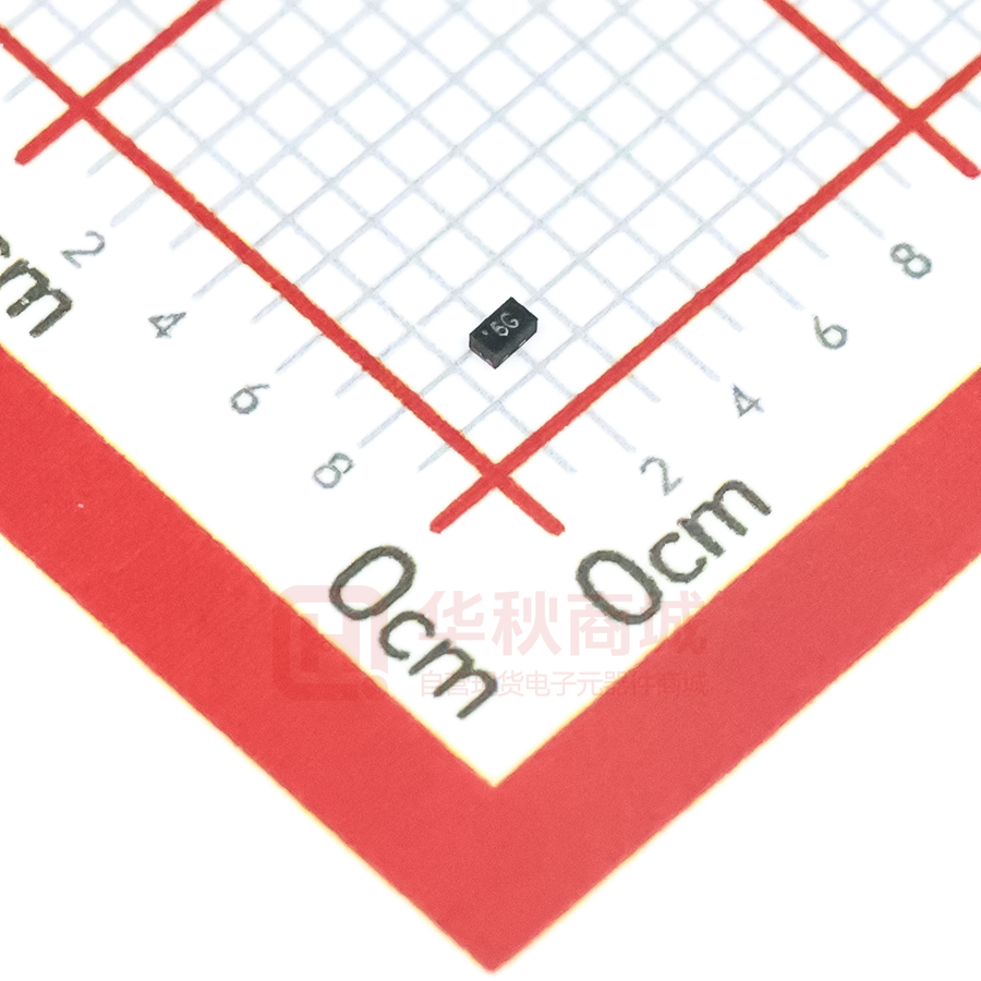

WNM2046E WNM2046E Single N-Channel, 20V, 0.8A, Power MOSFET VDS (V) Http://www.sh-willsemi.com Max. RDS(on) (mΩ) 500 @ VGS=4.5V 570 @ VGS=3.1V 20 700 @ VGS=2.5V 1500 @ VGS=1.8V ESD Rating:2000V HBM DFN1006-3L Description D The WNM2046E is N-Channel enhancement MOS Field Effect Transistor. Uses advanced trench technology and design to provide excellent RDS(ON) with low gate charge. This device is suitable for use in DC-DC conversion, power switch and charging circuit. Standard Product WNM2046E is Pb-free. G S Pin configuration (Top view) Features  Trench Technology  Supper high density cell design  Excellent ON resistance  Extremely Low Threshold Voltage  Small package DFN1006-3L 6 = Device Code * = Month (A~Z) Marking Applications Order information  DC/DC converters  Power supply converters circuit  Load/Power Switching for portable device Will Semiconductor Ltd. Device Package Shipping WNM2046E-3/TR DFN1006-3L 10K/Tape&Reel 1 Nov,2020- Rev.1.1 WNM2046E Absolute Maximum ratings Parameter Symbol Maximum Drain-Source Voltage VDS 20 Gate-Source Voltage VGS ±10 Continuous Drain Current Pulsed Drain Current Power Dissipation TA=25°C d 800 ID TA=70°C c 640 IDM TA=25°C a 3000 480 PD TA=70°C Operating Junction Temperature Storage Temperature Range 305 Unit V mA mA mW TJ -55 to 150 °C TSTG -55 to 150 °C Maximum Unit Thermal resistance ratings Single Operation Parameter Symbol Junction-to-Ambient Thermal Resistance a Junction-to-Ambient Thermal Resistance b a t ≤ 10 s Steady State t ≤ 10 s Steady State 216 RθJA 262 464 RθJA °C/W 580 2 2 The value of RθJA is measured with the device mounted on 1-inch (6.45cm ) with 2oz.(0.071mm thick) 2 Copper pad on a 1.5*1.5 inch , 0.06-inch thick FR4 PCB, in a still air environment with TA =25°C. The power dissipation PD is based on RθJA value and the TJ(MAX)=150°C. The value in any given application is determined by the user's specific board design, and the maximum temperature of 150°C may be used if the PCB allows it to. b The value of RθJA is measured with the device mounted on FR-4 minimum pad board, in a still air environment with TA =25°C. The power dissipation PD is based on RθJA value and the TJ(MAX)=150°C. The value in any given application is determined by the user's specific board design, and the maximum temperature of 150°C may be used if the PCB allows it to. c Repetitive rating, ~10us pulse width, duty cycle ~1%, keep initial TJ =25°C, the maximum allowed junction temperature of 150°C. d The maximum current rating by source bonding technology. e The static characteristics are obtained using ~380us pulses, duty cycle ~1%. Will Semiconductor Ltd. 2 Nov,2020- Rev.1.1 WNM2046E o Electronics Characteristics (Ta=25 C, unless otherwise noted) Parameter Symbol Test Conditions Min 20 Typ Max Unit OFF CHARACTERISTICS Drain-to-Source Breakdown Voltage BVDSS VGS = 0 V, ID = 250uA Zero Gate Voltage Drain Current IDSS VDS =16V, VGS = 0V Gate-to-source Leakage Current IGSS VDS = 0 V, VGS = ±10V VGS(TH) VGS = VDS, ID = 250uA V 1 uA ±10 uA 0.7 1.0 V VGS =4.5V, ID =0.55A 340 500 VGS =3.1V, ID =0.35A 380 570 VGS =2.5V, ID =0.25A 425 700 VGS =1.8V, ID =0.15A 560 1500 ON CHARACTERISTICS Gate Threshold Voltage Drain-to-source On-resistance RDS(on) 0.4 mΩ CHARGES, CAPACITANCES AND GATE RESISTANCE Input Capacitance CISS Output Capacitance COSS Reverse Transfer Capacitance CRSS Total Gate Charge QG(TOT) Threshold Gate Charge QG(TH) Gate-to-Source Charge QGS Gate-to-Drain Charge QGD VGS = 0 V, f = 1.0MHz, VDS = 10 V VGS = 4.5 V, VDS = 10V, ID =0.55 A 29 11 pF 4 1.1 0.11 nC 0.15 0.32 SWITCHING CHARACTERISTICS Turn-On Delay Time td(ON) Rise Time tr Turn-Off Delay Time td(OFF) Fall Time tf VGS = 4.5 V, VDS = 10 V, ID=0.55A , RG=6Ω 5 5.8 ns 15.4 3.6 BODY DIODE CHARACTERISTICS Forward Voltage Will Semiconductor Ltd. VSD VGS = 0 V, IS = 0.8A 3 0.9 1.5 V Nov,2020- Rev.1.1 DS GS V -Drain-to- WNM2046E Source Volta ge(V) o Ice Current -Drain-to-Sour (A) Typical Characteristics (Ta=25 C, unless otherwise noted) =8V =6V V =5.5V 4 2 0 5 0 15 10 IDS -Drain to Source Current(A) 3.0 VGS=4.5V 2.5 2.0 VGS=3.1V VGS=2.5V 1.5 1.0 VGS=1.8V 0.5 0.0 0.0 0.2 0.4 0.6 0.8 1.0 1.2 1.4 1.6 1.8 2.5 Output Characteristics o T=-50 C o T=25 C 2.0 1.5 o T=150 C 1.0 0.5 0.0 0.0 2.0 VDS=2V 0.5 VDS-Drain-to-Source Voltage(V) 1.0 1.5 2.0 2.5 3.0 3.5 4.0 4.5 VGS -Gate to Source Voltage(V) e Transfer Characteristics 500 e 700 RDS(ON)-On Resistance(m) RDS(ON)-Resistance(m) ID=0.55A 450 400 VGS=3.1V 350 VGS=4.5V 300 250 0.2 0.4 0.6 0.8 1.0 1.2 1.4 1.6 1.8 600 500 400 300 200 2.0 1 2 3 IDS-Drain to Source Current(A) e Gate Threshold Voltage Normalized VGS=4.5V ID=0.55A 1.4 1.2 1.0 0.8 0.6 0.4 -50 -25 0 25 50 75 100 125 150 6 7 8 9 10 On-Resistance vs. Junction Temperature e 1.3 ID=250uA 1.2 1.1 1.0 0.9 0.8 0.7 0.6 0.5 -50 -25 0 25 50 75 100 125 150 Temperature (oC) Temperature (oC) Will Semiconductor Ltd. 5 On-Resistance vs. Gate-to-Source Voltage 1.8 1.6 4 VGS-Gate to Source Voltage (V) On-Resistance vs. Drain Current RDS(ON)-On Resistance Normalized DS ID-Drain-to-Source Current(A) 3.0 e Threshold Voltage vs. Temperature 4 Nov,2020- Rev.1.1 WNM2046E 5 50 ISD-Source to Drain Current (A) VGS=0 f=1MHz C-Capacitance(pF) 40 30 Ciss 20 Coss 10 Crss 0 0 2 4 6 8 4 3 o T=150 C 2 o T=25 C 1 o T=-50 C 0.3 10 0.4 VDS-Drain to Source Voltage(V) 0.5 0.6 0.7 0.8 0.9 1.0 1.1 1.2 1.3 1.4 VSD-Source to Drain Voltage (V) Capacitance Body Diode Forward Voltage e 10 30 O TJ(Max)=25 C O TA=25 C ID-Drain Current (A) Power(W) 25 20 15 10 100us 1 Limit by Rdson 1ms 10ms 0.1 DC o 1s o TA=25 C 5 10s Single Pulse 1E-4 1E-3 0.01 0.1 1 10 100 0.01 0.01 1000 100ms TJ(MAX)=150 C 0.1 1 10 Pulse width(s) VDS-Drain to Source Voltage(V) Single Pulse power Safe Operating Power 100 VGS-Gate to Source Voltage (V) 4.5 4.0 3.5 VGS=4.5V VDS=10V ID=0.55A 3.0 2.5 2.0 1.5 1.0 0.5 0.0 0.0 0.3 0.6 0.9 1.2 1.5 Gate Charge Characteristics (nC) Gate Charge Characteristics Will Semiconductor Ltd. 5 Nov,2020- Rev.1.1 WNM2046E Normalized Effective Transient Thermal Impedance 10 In Descending Order D=0.5, 0.3, 0.1, 0.05, 0.02, 0.01, single pluse 1 0.1 single pulse 0.01 1E-3 1E-5 1E-4 1E-3 0.01 0.1 1 10 100 1000 Square Wave Pulse Duration (s) Transient Thermal Response (Junction-to-Ambient) Will Semiconductor Ltd. 6 Nov,2020- Rev.1.1 WNM2046E PACKAGE OUTLINE DIMENSIONS DFN1006-3L L L1 L b1 E b2 e1 D e2 (Ⅰ) TOP VIEW BOTTOM VIEW (Ⅱ) A A1 (Ⅱ) (Ⅰ) SIDE VIEW Symbol Dimensions in Millimeters Min. Typ. Max. A 0.36 - 0.50 A1 0.00 - 0.05 D 0.95 1.00 1.05 E 0.55 0.60 0.65 b1 0.10 0.15 0.20 b2 0.40 0.50 0.60 L 0.20 0.25 0.30 L1 0.20 0.30 0.40 e1 0.35Ref e2 0.65Ref Will Semiconductor Ltd. 7 Nov,2020- Rev.1.1 WNM2046E TAPE AND REEL INFORMATION RD Reel Dimensions W Tape Dimensions P1 Quadrant Assignments For PIN1 Orientation In Tape Q1 Q2 Q1 Q2 Q3 Q4 Q3 Q4 RD Reel Dimension W Overall width of the carrier tape P1 Pitch between successive cavity centers Pin1 Pin1 Quadrant Will Semiconductor Ltd. User Direction of Feed 7inch 13inch 1 8mm 12mm 16mm 2mm 4mm 8mm Q1 Q2 Q3 8 Q4 Nov,2020- Rev.1.1
