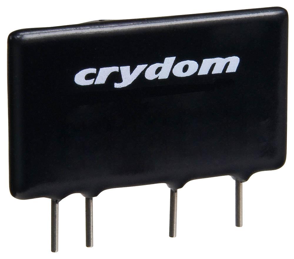

    固态 SPST-NO(1 Form A) 4-SIP
CMXE100D6 数据手册
| CMX SERIES PCB MOUNT Features • SIP SS R • Ratings to 20A @ 60 VDC, 10A @ 100 VDC, 10A @ 60 VDC and 3A @ 200 VDC • MOSFET output • DC control • Low on-state impedance • CE Compliant to EN60950-1 PRODUCT SELECTION Control Voltage 3-10 VDC 20-28 VDC 3A 5A 6A 10 A 10 A 20 A CMX200D3 CMXE200D3 CMX60D5 CMXE60D5 CMX100D6 CMX100D6 CMX60D10 CMX60D10 CMX100D10 CMX100D10 CMX60D20 CMX60D20 OUTPUT SPECIFICATIONS (1)(5) Description 3A 5A 6A 10 A 10 A 20 A Operating Voltage [VDC] Maximum Off-State Leakage Current @ Rated Voltage [μAdc] Maximum Load Current [ADC] Minimum Load Current [mADC] Maximum On-State Resistence [Ohm] (2) Maximum Surge Current (10msec) [Apk] Maximum On-State Voltage Drop @ Rated Current [VDC] 0-200 100 3 2 0.20 30 0.6 0-60 100 5 2 .10 60 0.5 0-100 100 6 2 .040 100 0.24 0-60 100 (6) 10 2 .018 100 0.18 0-100 100 10 2 .010 100 0.1 0-60 100 20 2 .0033 200 0.1 INPUT SPECIFICATIONS (1) Description Control Voltage Range Maximum Turn On Voltage Minimum Turn-Off Voltage Typical Input Current Nominal Input Impedance Maximum Turn-On Time [msec] Maximum Turn-Off Time [μsec] CMXE CMX 20-28 VDC 20 VDC 1 .0 VDC 12 mAdc @ 24 VDC 780 Ohm 1.0 300 3.0-10.0 VDC 3.0 VDC 1 .0 VDC 15 mAdc @ 5 VDC 300 Ohm 1.0 300 GENERAL SPECIFICATIONS Description Parameters Dielectric Strength, Input/Output (50/60Hz) (3) Minimum Insulation Resistance (@ 500 VDC) (3) Maximum Capacitance, Input/Output 2500 Vrms 109 Ohms 15 pF -10°C to 80°C -10°C to 125°C 0.4 oz. (11 g) Thermally Conductive Epoxy Meet the requirements of IEC60335-1 Ambient Operating Temperature Range (4) Ambient Storage Temperature Range (4) Weight (typical) Encapsulation Enclosure and PCB Page 1 Copyright © 2022 Sensata Technologies, Inc. www.sensata.com WIRING DIAGRAM + 1 +VDC LOAD A Load can be wired in location A or B B 2 -VDC LOAD CONTROL CIRCUIT + 3 +VDC 4 -VDC THERMAL DERATE INFORMATION CMX100D6 CMX60D5 CMX200D3 CMX60D10 & CMX100D10 12 5 10 4 3 2 1 0 20 40 60 8 6 4 2 0 80 CMX60D20 LOAD CURRENT (AMPS) 6 LOAD CURRENT (AMPS) LOAD CURRENT (AMPS) 7 AMBIENT TEMPERATURE (ºC) 20 40 60 20 16 12 8 4 0 80 AMBIENT TEMPERATURE (ºC) 20 40 60 80 AMBIENT TEMPERATURE (ºC) MECHANICAL SPECIFICATIONS Tolerances: ±0.02 in / 0.5 mm All dimensions are in: inches [millimeters] .300 MAX (7.6) .300 (7.6) 1.00 MAX (25.4) 1.00 MAX (25.4) .300 TYP. (7.6) 4 .200 (5.1) 3 2 .700 (17.8) 1.100 (27.9) 1 0.100 TYP. (2.5) .300 TYP. (7.6) .100 (2.5) 4 .200 (5.1) .040 (1.0) DIA. (4 PLACES) 3 2 .700 (17.8) 1.100 (27.9) 1 0.100 TYP. (2.5) .100 (2.5) .080 (2.0) DIA. (4 PLACES) 1.70 MAX (43.1) 1.70 (43.1) PIN 1: +DC LOAD PIN 2: -DC LOAD PIN 3: +DC CONTROL PIN 4: -DC CONTROL PIN 1: +DC LOAD PIN 2: -DC LOAD PIN 3: +DC CONTROL PIN 4: -DC CONTROL Page 2 Copyright © 2022 Sensata Technologies, Inc. www.sensata.com AGENCY APPROVALS & CERTIFICATIONS Designed in accordance with the requirements of IEC 62314 EN60950 : Meets the requirements of sections1.5: 1,7: 2.9: 2.10.5.3: 4.2: 4.5: 4.7: IEC60335-1: Resistance to heat and fire meets the requirements of section 30, evaluated by TUV SUD. Glow Wire Test, per requirements of IEC/EN 60695-2-10 and IEC/EN 60695-2-11 Ball Pressure Test, per requirements of IEC/EN 60695-10-2 E116950 (3 Amps, 6 Amps and 10 Amps Models) GENERAL NOTES 1) All parameters at 25°C unless otherwise specified. 2) @ rated current (RDS-ON). 3) Dielectric and insulation resistance are measured between input and output. 4) Low temperature range is limited to -10°C in 20 Amps models. 5) Inductive loads should be diode suppressed. 6) At 55 VDC. WARNINGS RISK OF MATERIAL DAMAGE AND HOT ENCLOSURE • The product’s side panels may be hot, allow the product to cool before touching • Follow proper mounting instructions including torque values • Do not allow liquids or foreign objects to enter this product Failure to follow these instructions can result in serious injury, or equipment damage. HAZARD OF ELECTRIC SHOCK, EXPLOSION OR ARCH FLASH • Disconnect all power before installing or working with this equipment • Verify all connections and replace all covers before turning on power Failure to follow these instructions will result in death or serious injury Page 3 Sensata Technologies, Inc. (“Sensata”) data sheets are solely intended to assist designers (“Buyers”) who are developing systems that incorporate Sensata products (also referred to herein as “components”). Buyer understands and agrees that Buyer remains responsible for using its independent analysis, evaluation and judgment in designing Buyer’s systems and products. Sensata data sheets have been created using standard laboratory conditions and engineering practices. Sensata has not conducted any testing other than that specifically described in the published documentation for a particular data sheet. Sensata may make corrections, enhancements, improvements and other changes to its data sheets or components without notice. Buyers are authorized to use Sensata data sheets with the Sensata component(s) identified in each particular data sheet. HOWEVER, NO OTHER LICENSE, EXPRESS OR IMPLIED, BY ESTOPPEL OR OTHERWISE TO ANY OTHER SENSATA INTELLECTUAL PROPERTY RIGHT, AND NO LICENSE TO ANY THIRD PARTY TECHNOLOGY OR INTELLECTUAL PROPERTY RIGHT, IS GRANTED HEREIN. SENSATA DATA SHEETS ARE PROVIDED “AS IS”. SENSATA MAKES NO WARRANTIES OR REPRESENTATIONS WITH REGARD TO THE DATA SHEETS OR USE OF THE DATA SHEETS, EXPRESS, IMPLIED OR STATUTORY, INCLUDING ACCURACY OR COMPLETENESS. SENSATA DISCLAIMS ANY WARRANTY OF TITLE AND ANY IMPLIED WARRANTIES OF MERCHANTABILITY, FITNESS FOR A PARTICULAR PURPOSE, QUIET ENJOYMENT, QUIET POSSESSION, AND NON-INFRINGEMENT OF ANY THIRD PARTY INTELLECTUAL PROPERTY RIGHTS WITH REGARD TO SENSATA DATA SHEETS OR USE THEREOF. All products are sold subject to Sensata’s terms and conditions of sale supplied at www.sensata.com SENSATA ASSUMES NO LIABILITY FOR APPLICATIONS ASSISTANCE OR THE DESIGN OF BUYERS’ PRODUCTS. BUYER ACKNOWLEDGES AND AGREES THAT IT IS SOLELY RESPONSIBLE FOR COMPLIANCE WITH ALL LEGAL, REGULATORY AND SAFETY-RELATED REQUIREMENTS CONCERNING ITS PRODUCTS, AND ANY USE OF SENSATA COMPONENTS IN ITS APPLICATIONS, NOTWITHSTANDING ANY APPLICATIONS-RELATED INFORMATION OR SUPPORT THAT MAY BE PROVIDED BY SENSATA. Mailing Address: Sensata Technologies, Inc., 529 Pleasant Street, Attleboro, MA 02703, USA. Copyright © 2022 Sensata Technologies, Inc. Rev. 04/27/2022 ECN 493787 FDE-07-01 Rev. B CONTACT US Americas +1 (877) 502 5500 – Option 2 sales.crydom@sensata.com Europe, Middle East & Africa +44 (1202) 416170 ssr-info.eu@sensata.com Asia Pacific sales.isasia@list.sensata.com China +86 (21) 2306 1500 Japan +81 (45) 277 7117 Korea +82 (31) 601 2004 India +91 (80) 67920890 Rest of Asia +886 (2) 27602006 ext 2808 www.sensata.com
