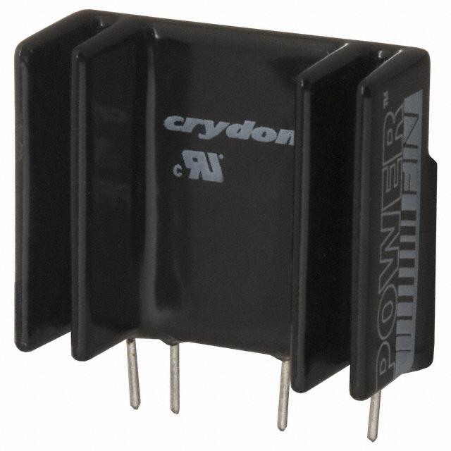

PF240D25
PF240D25
    SENSATA(森萨塔)
    SIP-4
    固态 SPST-NO(1 Form A) 4-SIP
PF240D25 数据手册
PCB Mount DataSheet PF Series • SIP SSR • Ratings to 25A (forced air) @ 480 VAC • SCR output for heavy industrial loads • AC or DC control • Zero-crossing (resistive loads) or random-fire (inductive loads) output PRODUCT SELECTION Control Voltage 25 A 3-15 VDC 4-15 VDC 15-32 VDC 18-36 VAC 90-140 VAC 25 A 25 A PF380D25 PFE380D25 PF480D25 PFE480D25 PF240D25 PFE240D25 PFE240A25 PF240A25 AVAILABLE OPTIONS Operational Voltage 240: 12-280 VAC 380: 48-530 VAC 480: 48-660 VAC Series PF E 240 Control Voltage Blank: 3-15 VDC (240,D suffix only) 4-15 VDC (380/480,D suffix only) 90-140 VAC (A suffix only) E: 15-32 VDC (D suffix only) 18-36 VAC (A suffix only) D Operational Current 25: 25 Amps 25 Control Input Type D: DC Input A: AC Input R Output Type Blank: Normally Open -B: Normally Closed (PF480D25 only) -B Switching Mode Blank: Zero Voltge Turn-On R: Random Turn-On Required for valid part number For options only and not required for valid part number OUTPUT SPECIFICATIONS (1) Description Operating Voltage (47-63Hz) [Vrms] Transient Overvoltage [Vpk] Maximum Off-State Leakage Current @ Rated Voltage [mArms] Minimum Off-State dv/dt @ Maximum Rated Voltage [V/μsec] (2) Maximum Load Current (Convection Air) [Arms] (3) Maximum Load Current (Forced Air) [Arms] (3) Minimum Load Current [Arms] Maximum Surge Current (16.6ms) [Apk] Maximum On-State Voltage Drop @ Rated Current [Vpk] Maximum I²t for fusing (8.3 msec) [A² sec] Minimum Power Factor (with Maximum Load) PF240 PF380 PF480 12-280 600 0.1 500 10 25 0.06 250 1.6 260 0.5 48-530 1200 0.1 500 10 25 0.06 250 1.6 260 0.5 48-660 1200 0.1 500 10 25 0.06 250 1.6 260 0.5 FDE-07-01 REV. A Do not forget to visit us at: www.crydom.com Copyright © 2021 Crydom Inc. Specifications subject to change without notice. PCB Mount DataSheet INPUT SPECIFICATIONS (1) Description Control Voltage Range [VDC] Maximum Turn On Voltage Minimum Turn-Off Voltage Typical Input Current @ Nominal Voltage Nominal Input Impedance Maximum Turn-On Time [msec] (4) Maximum Turn-Off Time [msec] PF240D25 PF380D/480D 3-15 VDC 3.0 VDC 1.0 VDC 15 mAdc 300 Ohm 1/2 Cycle 1/2 Cycle 4-15 VDC 4.0 VDC 1.0 VDC 15 mAdc 240 Ohm 1/2 Cycle 1/2 Cycle PFExxxD25 PF240A25 PFE240A25 15-32 VDC 15.0 VDC 1.0 VDC 15 mAdc 1500 Ohm 1/2 Cycle 1/2 Cycle 90-140 VAC 90.0 Vrms 10.0 Vrms 10 mAdc 14.1 k Ohm 10 40 18-36 VAC 18.0 Vrms 2.0 Vrms 10 mAdc 2.1 k Ohm 10 40 GENERAL SPECIFICATIONS Description Parameters Dielectric Strength, Input/Output (50/60Hz) Minimum Insulation Resistance (@ 500 V DC) Maximum Capacitance, Input/Output 4000 Vrms 10 9 Ohms 8 pF -30ºC to 80ºC -30ºC to 125ºC 1.02 oz. (29g) Thermally Conductive Epoxy Meets the requirements of solderability per IEC60068-2-20 Ambient Operating Temperature Range Ambient Storage Temperature Range Weight (typical) Encapsulation GENERAL NOTES 1) All parameters at 25°C unless otherwise specified. 2) Off-State dv/dt test method per EIA/NARM standard RS-443, paragraph 13.11.1 3) Heatsink temperature 85°C Maximum for 25A forced air cooling. 4) Turn-On Time for Random Turn-On versions 0.1 msec (DC Control Models) 5) Terminals are not suitable for bending or forming process. WIRING DIAGRAM TRIGGER CIRCUIT TRIGGER CIRCUIT AC/DC Converter B AC AC A Load can be wired in location A or B Do not forget to visit us at: www.crydom.com Copyright © 2021 Crydom Inc. Specifications subject to change without notice. 4 3 AC AC B V 2 1 LOAD +DC 1 LOAD -DC 2 LOAD 3 LOAD 4 A AC AC Load can be wired in location A or B PCB Mount DataSheet 10 LOAD CURRENT (AMPS) LOAD CURRENT (AMPS) THERMAL DERATE INFORMATION 8 6 4 2 0 10 20 30 40 50 60 70 80 25 20 15 10 5 0 0 20 40 60 80 100 120 140 AMBIENT TEMPERATURE (ºC) HEATSINK TEMPERATURE (˚C) FIG.1 Convection Cooling FIG.2 Forced Air Cooling MECHANICAL SPECIFICATIONS (5) Tolerances: ±0.02 in / 0.5 mm All dimensions are in: inches [millimeters] 1.6 TYP. (38.1) 1.35 MAX (34.3) .100 (2.5) 1.6 TYP. (38.1) AGENCY APPROVALS Agency Approvals Designed in accordance with the requirements of IEC 62314 E116950 (240V, 380 DC Control Only) Do not forget to visit us at: www.crydom.com Copyright © 2021 Crydom Inc. Specifications subject to change without notice. Rev. 040121 ECN 21039 PCB Mount DataSheet DANGER / PELIGRO / DANGER /GEFAHR / PERICOLO / 危险 HAZARD OF ELECTRIC SHOCK, EXPLOSION, OR ARC FLASH. • Disconnect all power before installing or working with this equipment. • Verify all connections and replace all covers before turning on power. Failure to follow these instructions will result in death or serious injury. RIESGO DE DESCARGA ELECTRICA O EXPLOSION. • Desconectar todos los suministros de energia a este equipo antes de trabajar con este equipo. • Verificar todas las conexiones y colocar todas las tapas antes de energizer el equipo. El incumplimiento de estas instrucciones puede provocar la muerte o lesiones serias. RISQUE DE DESCHARGE ELECTRIQUE OU EXPLOSION • Eteindre toutes les sources d'énergie de cet appareil avant de travailler dessus de cet appareil • Vérifier tous connections, et remettre tous couverts en olace avant de mettre sous De non-suivi de ces instructions provoquera la mort ou des lésions sérieuses sérieuses. GEFAHR EINES ELEKTRISCHE N SCHLAGES ODER EINER EXPLOSION. • Stellen Sie jeglichen Strom ab, der dieses Gerät versorgt, bevor Sie an dem Gerät Arbeiten durchführen • Vor dem Drehen auf Energie alle Anschlüsse überprüfen und alle Abdeckungen ersetzen. Unterlassung dieser Anweisungen können zum Tode oder zu schweren Verletzungen führen. RISCHIO DI SCOSSA ELETTRICA O DELL’ESPLOSIONE. • Spenga tutta l'alimentazione che fornisce questa apparecchiatura prima di lavorare a questa apparecchiatura 存在电击、 爆炸或电弧 闪烁危险 • 在操作此设 备之前请先 关闭电源。 若不遵守这些说明, 可能会导致严重的 人身伤害甚至死亡。 • Verificare tutti i collegamenti e sostituire tutte le coperture prima dell’accensione L'omissione di queste istruzioni provocherà la morte o lesioni serie WARNING / AVERTISSEMENT / WARNUNG /ADVERTENCIA / AVVERTENZA / 警告 RISK OF MATERIAL DAMAGE AND HOT ENCLOSURE RISQUE DE DOMMAGE MATERIEL ET DE SURCHAUFFE DU BOITIER GEFAHR VON MATERIALSCHÄDEN UND GEHÄUSEERHITZUNG • The product's side panels may be hot, allow the product to cool before touching. • Follow proper mounting instructions including torque values. • Do not allow liquids or foreign objects to enter this product. • Les panneaux latéraux du produit peuvent être chauds. Laisser le produit refroidir avant de le toucher. • Respecter les consignes de montage, et notamment les couples de serrage. • Ne pas laisser pénétrer de liquide ni de corps étrangers à l'intérieur du produit. • Die Seitenwände können heiß sein. Lassen Sie das Produkt abkühlen, bevor Sie es berühren. • Beachten Sie die Montageanweisungen, • Führen Sie keine Flüssigkeiten oder Fremdkörper in das Produkt ein. Le non-respect de cette directive peut entraîner, Failure to follow these instructions can result in des lésions corporelles graves ou des serious injury, or equipment damage. dommages matériels. Die Nichtbeachtung dieser Anweisung kann Körperverletzung oder Materialschäden zur Folge haben. RIESGO DE DAÑOS MATERIALES Y DE SOBRECALENTAMIENTO DE LA UNIDAD RISCHIO DI DANNI MATERIALI E D'INVOLUCRO CALDO 材料损坏和高温外壳的危险性 • Los paneles laterales del producto pueden estar calientes. Esperar que el producto se enfríe antes de tocarlo. • Respetar las instrucciones de montaje, y en particular los pares de apretado. • No dejar que penetren líquidos o cuerpos extraños en el producto. • I pannelli laterali dell'apparecchio possono scottare; lasciar quindi raffreddare il prodotto prima di toccarlo. • Seguire le istruzioni di montaggio corrette. • Non far entrare liquidi o oggetti estranei in questo apparecchio. Si no se respetan estas precauciones pueden producirse graves lesiones, daños materiales. La mancata osservanza di questa precauzione può causare gravi rischi per l'incolumità personale o danni alle apparecchiature. Do not forget to visit us at: www.crydom.com Copyright © 2021 Crydom Inc. Specifications subject to change without notice. • 产品的一侧面板可能很热,在其冷却前请 不要触碰。 • 遵照正确的安装说明,包括扭矩值。 • 请勿让液体及其他异物进入本产品。 如不能正确执行这些操作说明, 极有可能造成严重人体伤害或者设备的损坏。 PCB Mount DataSheet ANNEX - ENVIRONMENTAL INFORMATION The environmental information disclosed in this annex including the EIP Pollution logo are in compliance with People’s Republic of China Electronic Industry Standard SJ/T11364 – 2006, Marking for Control of Pollution Caused by Electronic Information Products. Part Name Toxic or hazardous Substance and Elements Lead (Pb) Mercury (Hg) Cadmium (Cd) Hexavalent Chromium (Cr (VI)) Polybrominated biphenyls (PBB) Polybrominated diphenyl ethers (PBDE) Semiconductor die Solder 附件 - 环保信息 此附件所标示的包括电子信息产品污染图标的环保信息符合中华人民共和国电子行业标准 SJ/T11364 - 2006, 电子信息产品污染控制标识要求。 部件 名称 铅 汞 镉 有毒有害物质或元素 六价铬 多溴联苯 (Pb) (Hg) (Cd) (Cr (VI)) 半导体芯片 焊接点 50 Do not forget to visit us at: www.crydom.com Copyright © 2021 Crydom Inc. Specifications subject to change without notice. (PBB) 多溴二苯醚 (PBDE)
