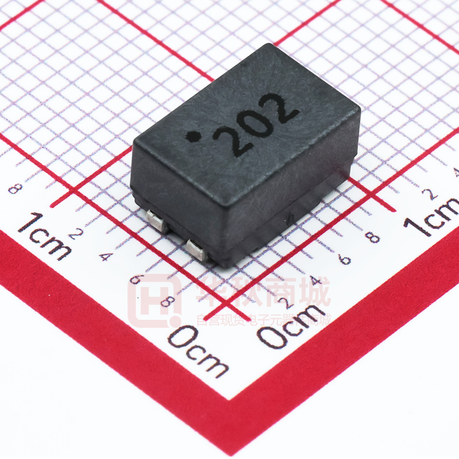

Wire Wound Common Mode Choke -YLCM0905C Series ■ Features ● SMD construction,and low profile. ● High Impedance and Excelletn Frequency Characteristic. ● Self Electromagnetic Shielding. ● Low Magnetic Flux Leakage. ■ Applications ● LED Light,TV game,Monitor,etc. ● EMI common-mode noise. ■ Product Identification ⑴ :Type ⑵ :Dimensions ⑶ :Inductance Value ⑷ :Taping ■ Shapes and Dimensions (Unit:mm) TYPE A B C D E F a b c d Typ. Typ. Typ. Typ. Typ. YLCM0905C 9.2±0.3 6.0±0.3 5.0±0.3 2.54±0.2 1.00±0.1 5.70 9.50 3.74 1.34 5.50 深圳市益嘉源电子有限公司 http://www.yjycoin.com Tel:0755-27803896 Mob:(86)13682526134 -1- Wire Wound Common Mode Choke -YLCM0905C Series ■ Circuit Diagram ■ YLCM0905C Series Rated Inductance DC Resistance Part Number N1,N2(Ω) Max. 10 +50%/-30% Range Volt. (MHz) (Vdc)Max. (Ω)Min. Min. (A)Max. YLCM0905C-100T Rated IR(Ω) Current L1=L2(uH) Freq. Impedance 0.08 1.6 300 20-200 50 10M 0.16 1.0 600 5-100 50 10M 0.25 0.9 800 5-100 50 10M 0.32 0.8 1000 5-50 50 10M 0.13 1.2 600 5-50 50 10M 0.14 1.1 800 1-50 50 10M 0.15 1.0 900 1-40 50 10M 0.31 0.8 1000 1-30 50 10M 0.42 0.6 3000 1-10 50 10M 0.90 0.4 3000 0.5-5 50 10M 1.05 0.3 4000 0.3-2 50 10M @1KHz/0.1V YLCM0905C-250T 25 +50%/-30% @1KHz/0.1V YLCM0905C-400T 40 +50%/-30% @1KHz/0.1V YLCM0905C-510T 51 +50%/-30% @1KHz/0.1V YLCM0905C-251T 250 ±50% @1KHz/5mV YLCM0905C-471T 470 ±50% @1KHz/5mV YLCM0905C-501T 500 ±50% @1KHz/5mV YLCM0905C-102T 1000 ±50% @1KHz/5mV YLCM0905C-202T 2000 ±50% @1KHz/5mV YLCM0905C-472T 4700 ±50% @1KHz/5mV YLCM0905C-652T 6500 ±50% @1KHz/5mV 1. Rated Current:Temp.rise 40℃ Typ 2. Operating Temperature:-20℃ up to +80℃ 3.Storage Temperature:-20℃ up to +40℃,75% RH max. 深圳市益嘉源电子有限公司 http://www.yjycoin.com Tel:0755-27803896 Mob:(86)13682526134 -2- Wire Wound Common Mode Choke -YLCM0905C Series ■ Materlal List NO. ITEM DESCRIPTION 1 CORE FERRITE 2 CASE LCP SC-0186 3 WIRE P180 Grd1 4 ADHESIVE XNR-3614 5 TIN 107H 6 INK WHITE ■ Reliability Testing Operating Temperature - 40 to + 80 ℃ ( Contain Heating coil ) Appearance Inspection No external defects by visual inspection Terminal Strength After soldering , between copper plaet and terminals of coils , push in two directions of X , Y with standing 10N(1.02kg) for10+/-2 sec. Terminal should not peel off. ( Refer to figure at right ) Heat endurance of reflow Refer to figure soldering Insulating resistance Over 100 MΩ at 100V D.C . between wire and core . Dielectric Strength Apply at 0.5KV 3mA for 1 minute between wire and core . Temperature characteristics Inductance coefficient ( 0~2,000 ) × 10 / ℃( - 20 ~ + 80 ℃ ) Humidity characteristics Inductance deviation within ± 10% , after 96 hours in 90~95% relative humidity at 40 ± 2 ℃ and 1 hours drying under normal condition . A test is made under the above mentioned condition , and it is kept for 2 hours in the normal 深圳市益嘉源电子有限公司 http://www.yjycoin.com Tel:0755-27803896 Mob:(86)13682526134 -3- Wire Wound Common Mode Choke -YLCM0905C Series ■ Recommended soldering temp.Graph IR Reflow profile Temperature and humidity. After that,no mechanical and electrical defect should be found. ■ Taping Dimensions(Unit:mm) TYPE W A B D P K T MPQ YLCM0905C 16.0±0.3 6.4±0.3 6.4±0.1 7.5±0.1 8.0±0.1 5.0±0.1 0.40±0.05 1000 深圳市益嘉源电子有限公司 http://www.yjycoin.com Tel:0755-27803896 Mob:(86)13682526134 -4- Wire Wound Common Mode Choke -YLCM0905C Series ■ Reel Dimensions(Unit:mm) TYPE W W1 A B C D YLCM0905C 330±2.0 24.4±1.5 30.4MAX 23.9 Min 13.0±0.50 21.0±0.80 ■ Direction of rolling 深圳市益嘉源电子有限公司 http://www.yjycoin.com Tel:0755-27803896 Mob:(86)13682526134 -5- Wire Wound Common Mode Choke -YLCM0905C Series ■ Cover tape peel off condition Cover tape peel force shall be 0.1N to 1.3N. Reference peel speed 300±10mm/min. 深圳市益嘉源电子有限公司 http://www.yjycoin.com Tel:0755-27803896 Mob:(86)13682526134 -6-
