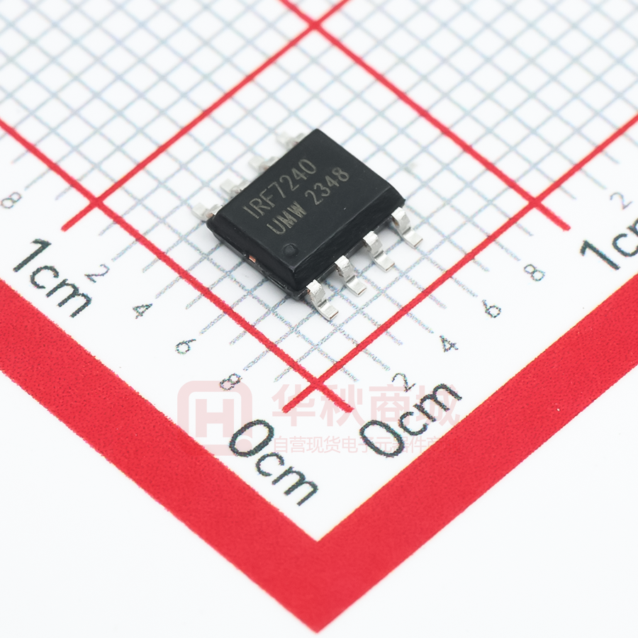

UMW R IRF7240 P-Channel MOSFET Features VDS (V) = -40V ID = -10.5 A RDS(ON) 16m (VGS = -10V) RDS(ON) 27m (VGS = -4.5V) S Ultra Low On-Resistance S Surface Mount S 1 8 2 7 3 6 4 5 A D D D Lead-Free G D SOP-8 Description The SOP-8 has been modified through a customized leadframe for enhanced thermal characteristics and multiple-die capability making it ideal in a variety of power applications. With these improvements, multiple devices can be used in an application with dramatically reduced board space. The package is designed for vapor phase, infrared, or wave soldering techniques. Absolute Maximum Ratings Parameter VDS ID @ TA = 25°C ID @ TA= 70°C IDM PD @TA = 25°C PD @TA = 70°C VGS TJ, TSTG Drain- Source Voltage Continuous Drain Current, VGS @ -10V Continuous Drain Current, VGS @ -10V Pulsed Drain Current  Power Dissipation ƒ Power Dissipationƒ Linear Derating Factor Gate-to-Source Voltage Junction and Storage Temperature Range Max. Units -40 -10.5 -8.6 -43 2.5 1.6 20 ± 20 -55 to + 150 V mW/°C V °C Max. Units 50 °C/W A W Thermal Resistance Parameter RθJA www.umw-ic.com Maximum Junction-to-Ambientƒ 1 UTD Semiconductor Co.,Limited UMW R IRF7240 P-Channel MOSFET Electrical Characteristics @ TJ = 25°C (unless otherwise specified) ∆V(BR)DSS/∆TJ Parameter Drain-to-Source Breakdown Voltage Breakdown Voltage Temp. Coefficient RDS(on) Static Drain-to-Source On-Resistance VGS(th) gfs Gate Threshold Voltage Forward Transconductance IDSS Drain-to-Source Leakage Current IGSS Gate-to-Source Forward Leakage Gate-to-Source Reverse Leakage Total Gate Charge Gate-to-Source Charge Gate-to-Drain ("Miller") Charge Turn-On Delay Time Rise Time Turn-Off Delay Time Fall Time Input Capacitance Output Capacitance Reverse Transfer Capacitance V(BR)DSS Qg Qgs Qgd td(on) tr td(off) tf Ciss Coss Crss Min. Typ. Max. Units -40 V -0.025 V/°C 16 mΩ 27 -1.0 -3.0 V 17 S -15 µA -25 -100 nA 100 73 110 31 47 nC 17 26 52 490 ns 210 97 9250 580 pF 520 Conditions VGS = 0V, ID = -250µA Reference to 25°C, ID = -1mA VGS = -10V, ID = -10.5A ‚ VGS = -4.5V, I D = -8.4A ‚ VDS = VGS, ID = -250µA VDS = -10V, ID = -10.5A VDS = -32V, VGS = 0V VDS = -32V, VGS = 0V, TJ = 70°C VGS = -20V VGS = 20V ID = -10.5A VDS = -20V VGS = -10V VDD = -20V ‚ ID = -1.0A RG = 6.0Ω VGS = -10V VGS = 0V VDS = -25V ƒ = 1.0kHz Source-Drain Ratings and Characteristics IS ISM VSD trr Qrr Parameter Continuous Source Current (Body Diode) Pulsed Source Current (Body Diode)  Diode Forward Voltage Reverse Recovery Time Reverse Recovery Charge Min. Typ. Max. Units -2.5 A -43 43 75 -1.2 65 110 V ns nC Conditions MOSFET symbol showing the G integral reverse p-n junction diode. TJ = 25°C, IS = -2.5A, VGS = 0V TJ = 25°C, IF = -2.5A di/dt = -100A/µs ‚ D S ‚ Notes:  Repetitive rating; pulse width limited by max. junction temperature. ‚ Pulse width ≤ 400µs; duty cycle ≤ 2%. ƒ Surface mounted on 1 in square Cu board, t ≤ 5sec. www.umw-ic.com 2 UTD Semiconductor Co.,Limited UMW 1000 R IRF7240 P-Channel MOSFET 1000 VGS -15V -10V -4.5V -3.7V -3.5V -3.3V -3.0V BOTTOM -2.7V -I D , Drain-to-Source Current (A) -I D , Drain-to-Source Current (A) 100 10 1 0.1 -2.70V 20µs PULSE WIDTH TJ = 25 °C 0.01 0.1 1 10 100 10 -2.70V 1 100 RDS(on) , Drain-to-Source On Resistance (Normalized) -I D , Drain-to-Source Current (A) 2.0 TJ = 150 ° C 10 TJ = 25 ° C 0.1 V DS = -25V 20µs PULSE WIDTH 3.5 4.0 4.5 100 ID = -10.5A 1.5 1.0 0.5 0.0 -60 -40 -20 VGS = -10V 0 20 40 60 80 100 120 140 160 TJ , Junction Temperature ( °C) -VGS , Gate-to-Source Voltage (V) Fig 3. Typical Transfer Characteristics www.umw-ic.com 10 Fig 2. Typical Output Characteristics 100 3.0 1 -VDS , Drain-to-Source Voltage (V) Fig 1. Typical Output Characteristics 0.01 2.5 20µs PULSE WIDTH TJ = 150 °C 0.1 0.1 -VDS , Drain-to-Source Voltage (V) 1 VGS -15V -10V -4.5V -3.7V -3.5V -3.3V -3.0V BOTTOM -2.7V TOP TOP Fig 4. Normalized On-Resistance Vs. Temperature 3 UTD Semiconductor Co.,Limited UMW R IRF7240 P-Channel MOSFET 16000 -VGS , Gate-to-Source Voltage (V) Coss = Cds + Cgd 12000 C, Capacitance(pF) 20 VGS = 0V, f = 1 MHZ Ciss = Cgs + Cgd, Cds SHORTED Crss = Cgd Ciss 8000 4000 Coss ID = -10.5A VDS =-32V VDS =-20V VDS =-8V 16 12 8 4 Crss 0 0 1 10 0 100 20 -V DS, Drain-to-Source Voltage (V) 60 80 100 Fig 6. Typical Gate Charge Vs. Gate-to-Source Voltage Fig 5. Typical Capacitance Vs. Drain-to-Source Voltage 100 100 OPERATION IN THIS AREA LIMITED BY RDS(on) TJ = 150 ° C -IID , Drain Current (A) -ISD , Reverse Drain Current (A) 40 QG , Total Gate Charge (nC) 10 TJ = 25 ° C 1 0.1 0.4 0.8 1.0 10ms 1 0.1 1.2 -VSD ,Source-to-Drain Voltage (V) 1 10 100 -VDS , Drain-to-Source Voltage (V) Fig 8. Maximum Safe Operating Area Fig 7. Typical Source-Drain Diode Forward Voltage www.umw-ic.com 1ms 10 TA = 25 ° C TJ = 150 ° C Single Pulse V GS = 0 V 0.6 100us 4 UTD Semiconductor Co.,Limited UMW R IRF7240 P-Channel MOSFET 12 VDS VGS 10 D.U.T. RG -ID , Drain Current (A) RD + 8 VDD VGS 6 Pulse Width ≤ 1 µs Duty Factor ≤ 0.1 % 4 Fig 10a. Switching Time Test Circuit 2 td(on) tr t d(off) tf VGS 0 25 50 75 100 125 10% 150 TC , Case Temperature ( ° C) 90% Fig 9. Maximum Drain Current Vs. Case Temperature VDS Fig 10b. Switching Time Waveforms Thermal Response (Z thJA ) 100 D = 0.50 0.20 10 0.10 0.05 0.02 1 0.01 PDM t1 0.1 t2 SINGLE PULSE (THERMAL RESPONSE) 0.01 0.00001 0.0001 0.001 Notes: 1. Duty factor D = t 1 / t 2 2. Peak T J = P DM x Z thJA + TA 0.01 0.1 1 10 100 t1, Rectangular Pulse Duration (sec) Fig 11. Maximum Effective Transient Thermal Impedance, Junction-to-Ambient www.umw-ic.com 5 UTD Semiconductor Co.,Limited IRF7240 P-Channel MOSFET 0.035 RDS (on) , Drain-to-Source On Resistance ( Ω) RDS(on) , Drain-to -Source On Resistance (Ω) UMW R 0.030 0.025 0.020 0.015 ID = -10.5A 0.010 0.0 4.0 8.0 12.0 0.025 VGS = -4.5V 0.020 0.015 VGS = -10V 0.010 0 16.0 10 20 30 40 50 -I D , Drain Current (A) -V GS, Gate -to -Source Voltage (V) Fig 12. Typical On-Resistance Vs. Gate Voltage Fig 13. Typical On-Resistance Vs. Drain Current Current Regulator Same Type as D.U.T. 50KΩ QG QGS 12V .3µF QGD D.U.T. +VDS VGS VG -3mA IG Charge ID Current Sampling Resistors Fig 14a. Basic Gate Charge Waveform www.umw-ic.com .2µF Fig 14b. Gate Charge Test Circuit 6 UTD Semiconductor Co.,Limited UMW R IRF7240 P-Channel MOSFET 200 3.0 2.5 Power (W) -VGS(th) , Variace ( V ) 160 ID = -250µA 120 80 2.0 40 0 1.5 -75 -50 -25 0 25 50 75 100 125 0.001 150 0.100 1.000 10.000 100.000 Time (sec) T J , Temperature ( °C ) Fig 16. Typical Power Vs. Time Fig 15. Typical Vgs(th) Variance Vs. Juction Temperature www.umw-ic.com 0.010 7 UTD Semiconductor Co.,Limited UMW R IRF7240 P-Channel MOSFET SOP-8 Symbol A A1 A2 b c D E E1 e L θ www.umw-ic.com Dimensions In Millimeters Min Max 1.350 1.750 0.100 0.250 1.350 1.550 0.330 0.510 0.170 0.250 4.700 5.100 3.800 4.000 5.800 6.200 1.270(BSC) 0.400 1.270 0° 8° 8 Dimensions In Inches Min Max 0.053 0.069 0.004 0.010 0.053 0.061 0.013 0.020 0.006 0.010 0.185 0.200 0.150 0.157 0.228 0.244 0.050(BSC) 0.016 0.050 0° 8° UTD Semiconductor Co.,Limited UMW R IRF7240 P-Channel MOSFET Marking Ordering information Order code Package Baseqty Deliverymode UMW IRF7240TR SOP-8 3000 Tape and reel www.umw-ic.com 9 UTD Semiconductor Co.,Limited
