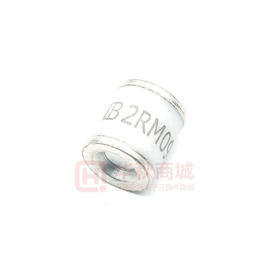

2R-5 SERIES Gas Discharge Tube (GDT) Data Sheet Features ■ Provide ultra-fast response to surge voltage from slow-rising ■ ■ ■ ■ surge of 100V/s to rapid-rising surge of 1KV/μs Stable breakdown voltage High insulation resistance Low capacitance (≤1.5pF) High holdover voltage ■ ■ ■ ■ ■ ■ Large absorbing transient current capability Micro-Gap Design Size: 5.5mm*6.0mm Storage and operating temperature: -40℃ ~ +85℃ Meets MSL level 1, per J-STD-020 Safety certification: E244458 Applications ■ ■ ■ ■ Repeaters, Modems Telephone Interface, Line cards Data communication equipment Line test equipment Part Number Code 2 5 R Electrical Characteristics K: 3KA L: 5KA M: 10KA Electrode Numbers 2R: 2 Electrodes Lead Type L: Lead M: SMD DC Spark-over Voltage Packing Code No suffix: Bulk TR: Tape & Reel packing Dimensions 5: 5.5mm×6.0mm Marking : BrightKing Logo 2RL090-5 : Device Marking Code YXXX : Date Code Revision: GDT-2R-5 SERIES-001(A2) 2/7 http://brightking.pulseelectronics.com 2R-5 SERIES Dimensions L Type D L Dimension (mm) Symbol Spec. Tolerance D 5.5 +0.3, -0.5 T 6.0 +0.3, -0.5 d 0.8 ±0.1 L 30.0 Max. D 5.5 +0.3, -0.5 T 6.0 +0.3, -0.5 B 0.5 ±0.1 d D T M Type 6.0 5.5 B D T 1.5 Recommended Pad Size Electrical Characteristics DC Spark-over Voltage Maximum Impulse Spark-over Voltage Nominal Impulse Discharge Current Alternating Discharge Current Impulse Life 100V/s 1000V/μs 8/20μs 10times 50Hz,1sec 10/1000μs 100A Test Voltage Part Number Minimum Insulation Resistance (V) (V) (KA) (A) (times) DC(V) Maximum Capacitance 1MHz Device Marking Code (GΩ) (pF) 2RL070L-5 2RL070M-5 70±20% 800 5.0 5.0 300 25 1.0 1.5 2RL070-5 2RL075L-5 2RL075M-5 75±20% 800 5.0 5.0 300 25 1.0 1.5 2RL075-5 2RL090L-5 2RL090M-5 90±20% 700 5.0 5.0 300 50 1.0 1.5 2RL090-5 2RL120L-5 2RL120M-5 120±20% 700 5.0 5.0 300 50 1.0 1.5 2RL120-5 2RL145L-5 2RL145M-5 145±20% 700 5.0 5.0 300 100 1.0 1.5 2RL145-5 2RL150L-5 2RL150M-5 150±20% 700 5.0 5.0 300 100 1.0 1.5 2RL150-5 2RL230L-5 2RL230M-5 230±20% 700 5.0 5.0 300 100 1.0 1.5 2RL230-5 2RL250L-5 2RL250M-5 250±20% 700 5.0 5.0 300 100 1.0 1.5 2RL250-5 2RL300L-5 2RL300M-5 300±20% 900 5.0 5.0 300 100 1.0 1.5 2RL300-5 2RL350L-5 2RL350M-5 350±20% 900 5.0 5.0 300 100 1.0 1.5 2RL350-5 2RL400L-5 2RL400M-5 400±20% 1000 5.0 5.0 300 100 1.0 1.5 2RL400-5 2RL470L-5 2RL470M-5 470±20% 1100 5.0 5.0 300 250 1.0 1.5 2RL470-5 2RL600L-5 2RL600M-5 600±20% 1500 5.0 5.0 300 250 1.0 1.5 2RL600-5 2RL800L-5 2RL800M-5 800±20% 1700 5.0 5.0 300 250 1.0 1.5 2RL800-5 Revision: GDT-2R-5 SERIES-001(A2) 3/7 http://brightking.pulseelectronics.com 2R-5 SERIES Electrical Characteristics Part Number DC Spark-over Voltage Maximum Impulse Spark-over Voltage Nominal Impulse Discharge Current Alternating Discharge Current Impulse Life 100V/s 1000V/μs 8/20μs 10times 50Hz,1sec 10/1000μs 100A Test Voltage Minimum Insulation Resistance (V) (V) (KA) (A) (times) DC(V) Maximum Capacitance 1MHz Device Marking Code (GΩ) (pF) 2RM070L-5 2RM070M-5 70±20% 600 10 5.0 500 25 1.0 1.5 2RM070-5 2RM075L-5 2RM075M-5 75±20% 600 10 5.0 500 25 1.0 1.5 2RM075-5 2RM090L-5 2RM090M-5 90±20% 600 10 10 500 50 1.0 1.5 2RM090-5 2RM120L-5 2RM120M-5 120±20% 600 10 10 500 50 1.0 1.5 2RM120-5 2RM145L-5 2RM145M-5 145±20% 700 10 10 500 100 1.0 1.5 2RM145-5 2RM150L-5 2RM150M-5 150±20% 700 10 10 500 100 1.0 1.5 2RM150-5 2RM230L-5 2RM230M-5 230±20% 700 10 10 500 100 1.0 1.5 2RM230-5 Electrical Ratings Items DC Spark-over Voltage Maximum Impulse Spark-over Voltage Test Condition/Description Requirement The voltage is measured with voltage ramp dv/dt=100V/s. The maximum impulse spark-over voltage is measured with voltage ramp dv/dt=1000V/μs. Maximum 8/20μs surge current that can be applied between two electrodes, 5 positive and 5 negative surges, with 3 minutes interval time, without causing the DC spark-over voltage to change more than 25% from its initial value. Crest value 100 90 Current (%) Impulse Discharge Current To meet the specified value 50 20µs 10 0 8µs Time Impulse Width Alternating Discharge Current Insulation Resistance Capacitance Rated RMS value of AC current at 50Hz, 1 sec. for 10 times with interval time 3 min. DC spark-over voltage shall not change more than ±25% from 8 its initial value. IR>10 ohms (-20%, +30% for 70~90V). The resistance of gas tube shall be measured between two electrodes. The capacitance of gas tube shall be measured between two electrodes. Test frequency: 1MHz Revision: GDT-2R-5 SERIES-001(A2) 4/7 http://brightking.pulseelectronics.com 2R-5 SERIES Recommended Soldering Conditions Wave Soldering 300 Preheating Maximum Wave 265℃ Soldering Cooling Temperature (℃) 250 200 150 100 50 0 0 0.5 1 1.5 2 2.5 Time (minutes) 3 3.5 Item Conditions Peak Temperature 265℃ Dipping Time 10 seconds Soldering 1 time 4 Reflow Soldering Critical Zone TL to TP tP TP Ramp-up TL tL Temperature TS max TS min Ramp-down tS Preheat 25 t 25℃ to Peak Time Profile Feature Pb-Free Assembly Average ramp-up rate (TL to TP) Preheat -Temperature Min (TS min) -Temperature Max (TS max) -Time (min to max) (ts) TS max to TL -Ramp-up Rate Time maintained above: -Temperature (TL) -Time (tL) Peak Temperature (TP) 3℃/second max. 150℃ 200℃ 60-180 seconds 3℃/second max. 217℃ 60-150 seconds 260℃ Time within 5℃ of actual Peak Temperature (tP) Ramp-down Rate 6℃/second max. Time 25℃ to Peak Temperature Revision: GDT-2R-5 SERIES-001(A2) 20-40 seconds 8 minutes max. 5/7 http://brightking.pulseelectronics.com 2R-5 SERIES Packaging Axial Packing (Bulk) Skin packing Dimension (mm) Symbol Spec. Tolerance A 265.0 ±5.0 B 146.0 ±5.0 H 6.8 ±0.5 Quantity: 100pcs Inner box A0 270.0 ±2.0 B0 150.0 ±2.0 H0 50.0 ±2.0 Quantity: 500pcs Axial Packing (Tape & Reel) Tape Dimension (mm) Symbol Reel Spec. Tolerance P 10.0 ±0.5 W 65.0 ±1.0 E 6.0 ±0.5 F 26.5 ±0.5 d 0.8 ±0.1 A1 330.0 ±2.0 B1 70.0 ±2.0 C1 82.0 ±2.0 D 25.0 ±0.5 t 2.0 ±0.2 Quantity: 1000pcs Revision: GDT-2R-5 SERIES-001(A2) 6/7 http://brightking.pulseelectronics.com 2R-5 SERIES Packaging SMD Packing (Tape & Reel) Tape Dimension (mm) Symbol Reel Spec. Tolerance W 16.00 ±0.20 P0 4.00 ±0.10 P1 12.00 ±0.20 P2 2.00 ±0.10 D0 1.55 ±0.05 E 1.75 ±0.10 F 7.50 ±0.10 A0 5.85 ±0.10 K0 6.20 ±0.10 B0 7.00 ±0.10 t0 0.50 ±0.10 D 330.00 ±2.00 d 13.00 ±0.50 L 20.00 ±2.00 t 2.00 ±0.20 t D d L Revision: GDT-2R-5 SERIES-001(A2) 7/7 Quantity: 800pcs http://brightking.pulseelectronics.com
