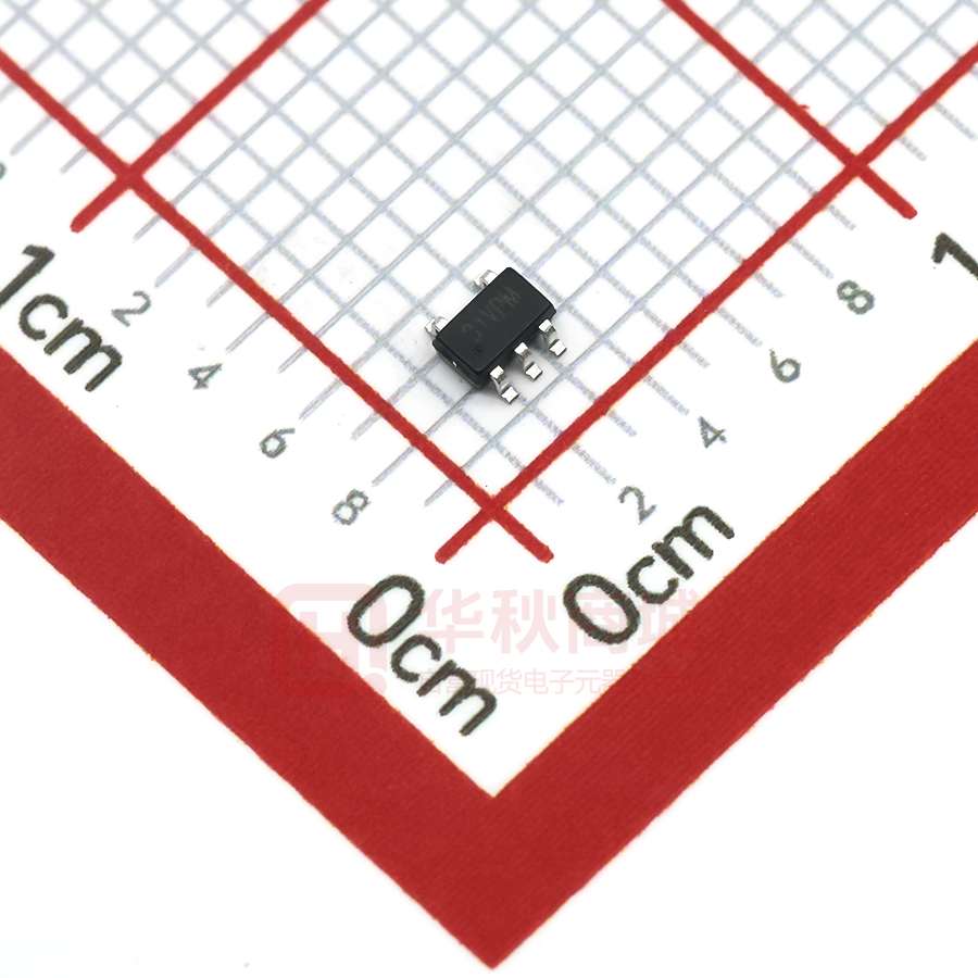

    运放类型:Zero-Drift;放大器组数:1;增益带宽积(GBP):350KHz;压摆率(SR):0.16 V/us;电源电压:1.8V ~ 5.5V;各通道供电电流:34μA;
TP5531U-CR 数据手册
TP5531 / TP5532 / TP5534 1.8V, 34μA, RRIO, Zero Drift Op-amps     Description Features  LOW OFFSET VOLTAGE: 10 μV (Max)  ZERO DRIFT: 0.008 µV/°C  0.1Hz to 10Hz Noise: 1.1 µVPP  Low Supply Current: 34µA per Amplifier  Bandwidth: 350 kHz  Slew Rate: 0.16 V/μs  High Gain, 130 dB High CMRR and PSRR  Rail-to-rail Input and Output Swing  –40°C to 125°C Operation Range  Small Packages: SC70 and SOT23 (TP5531) Applications  Transducer Amplifier       Bidirectional Current Sense DC Offset Correction Temperature Measurement Remote Located Sensors Battery-Powered Instruments Electronic Weigh Scales The 3PEAK TP5531/2/4 low-power chopper stabilized operational amplifiers provide input offset voltage correction for very low offset and offset drift over time and temperature. The devices operate with a single supply voltage as low as 1.8V, while drawing 34μA per amplifier of quiescent current with a gain bandwidth product of 350kHz. They are unity gain stable, have no 1/f noise, have good Power Supply Rejection Ratio (PSRR) and Common Mode Rejection Ratio (CMRR), and feature rail-to-rail input and output swing. The devices were designed using an advanced CMOS process. The TP5531 (single version) is available in SC70-5, SOT23-5 and SO-8 packages. The TP5532 (dual version) is offered in MSOP-8 and SO-8 package. The TP5534 (quad version) is available in TSSOP-14 and SOIC-14 package. All versions are specified for operation from -40°C to 125°C. 3PEAK and the 3PEAK logo are registered trademarks of 3PEAK INCORPORATED. All other trademarks are the property of their respective owners. Related Zero-Drift Op-amps VOS (Max.) 10 μV 5 μV 5 μV GBWP 350 kHz 1.5 MHz 3.5 MHz Supply Current 34 μA 220 μA 500 μA eN at 1 kHz 55 nV/√Hz 25 nV/√Hz 15 nV/√Hz Single TP5531 TP5541 TP5551 Dual TP5532 TP5542 TP5552 Quad TP5534 TP5544 TP5554 Pin Configuration (Top View) 500nV/div 0.1Hz to 10Hz NOISE              www.3peakic.com 5s/div   REV1.0 1  TP5531 / TP5532/TP5534   1.8V, 34μA, RRIO, Zero Drift Op-amps Pin Configuration (Top View, continued)  TP5531 TP5532 8-Pin SOIC (-S Suffix) 8-Pin SOIC/MSOP (-S and -V Suffixes) NC 1 8 NC Out A 1 ﹣In 2 7 ﹢Vs ﹣In A 2 ﹢In 3 6 Out ﹢In A 3 ﹣Vs 4 5 NC ﹣Vs 4 A B TP5534 14-Pin SOIC/TSSOP (-S and -T Suffixes) 8 ﹢Vs Out A 1 14 Out D 7 Out B ﹣In A 2 13 ﹣In D 6 ﹣In B ﹢In A 3 12 ﹢In D 5 ﹢In B ﹢Vs 4 11 ﹣Vs ﹢In B 5 10 ﹢In C A B D C ﹣In B 6 9 ﹣In C Out B 7 8 Out C   Order Information Model Name TP5531 TP5531U TP5532 TP5534 Order Number Package Transport Media, Quantity Marking Information TP5531-TR SOT23-5 Tape and Reel, 3,000 E31T TP5531-CR SC70-5 (SOT353) Tape and Reel, 3,000 E31C TP5531-SR SOIC-8 Tape and Reel, 4,000 E31S TP5531U-TR SOT23-5 Tape and Reel, 3,000 E31U TP5531U-CR SC70-5 E31V TP5532-SR SOIC-8 Tape and Reel, 3,000 Tape and Reel, 4,000 E32S TP5532-VR MSOP-8 Tape and Reel, 3,000 E32V TP5534-SR SOIC-14 Tape and Reel, 2,500 E34S TP5534-TR TSSOP-14 Tape and Reel, 3,000 E34T Absolute Maximum Ratings Note 1 Supply Voltage: .....................................................6V Current at Supply Pins……………............... ±50mA Input Voltage: ....................... ……V– – 0.2 to V+ + 0.2 Operating Temperature Range.......–40°C to 125°C Note 2 ........................... ±20mA Maximum Junction Temperature................... 150°C Output Current: OUT...................................... ±60mA Storage Temperature Range.......... –65°C to 150°C Input Current: +IN, –IN Output Short-Circuit Duration Note 3 …....... Indefinite Lead Temperature (Soldering, 10 sec) ......... 260°C Note 1: Stresses beyond those listed under Absolute Maximum Ratings may cause permanent damage to the device. Exposure to any Absolute Maximum Rating condition for extended periods may affect device reliability and lifetime. Note 2: The inputs are protected by ESD protection diodes to each power supply. If the input extends more than 500mV beyond the power supply, the input current should be limited to less than 10mA. Note 3: A heat sink may be required to keep the junction temperature below the absolute maximum. This depends on the power supply voltage and how many amplifiers are shorted. Thermal resistance varies with the amount of PC board metal connected to the package. The specified values are for short traces connected to the leads. 2  REV1.0 www.3peakic.com TP5531 / TP5532/TP5534          1.8V, 34μA, RRIO, Zero Drift Op-amps ESD, Electrostatic Discharge Protection Symbol Parameter Condition Minimum Level Unit HBM Human Body Model ESD MIL-STD-883H Method 3015.8 7 kV CDM Charged Device Model ESD JEDEC-EIA/JESD22-C101E 2 kV Electrical Characteristics The boldface denotes the specifications which apply over the full operating temperature range, TA = -40°C to +125°C. At TA = 27°C, VDD = 5V, RL = 10kΩ, VCM = VDD/2, unless otherwise noted. SYMBOL PARAMETER VDD Supply Voltage Range IQ Quiescent current per amplifier CONDITIONS MIN TYP V 40 μA 55 μA 2 10 μV 0.008 0.05 μV/°C 34 Over temperature VOS Input Offset Voltage dVOS/dT vs temperature PSRR vs power supply Vn Input grounded, unity gain. 0.5 μV/V input voltage noise, f=0.01Hz to 1Hz 0.4 μVpp input voltage noise, f=0.1Hz to 10Hz 1.1 μVpp en Input voltage noise density, f=1kHz 55 nV/√Hz CIN 3 2 ±50 ISC CL GBWP SR tOR tS Input capacitor, Differential Input capacitor, Common-Mode Input Bias Current Over temperature Input offset current Common-mode voltage range Common-mode rejection ratio Output Voltage Swing from rail Over temperature Short-circuit current Maximum Capacitive Load Unity Gain Bandwidth Slew rate Overload recovery time Settling time to 0.01% 1,000 350 0.16 60 40 pF pF pA pA pA V dB mV mV mA pF kHz V/μs μs μs AVOL Open-Loop Voltage Gain 120 dB 250 200 210 158 83 100 °C/W IB IOS VCM CMRR VO θJA Thermal Resistance Junction to Ambient www.3peakic.com Vs = +1.8V to +5.5V UNITS 5.5 1.8 IO = 0 MAX ±100 (V-)–0.1 110 RL=10kΩ RL=10kΩ CL=100pF G=+1, CL=100pF G=-10 CL=100pF (V-)+100mV
