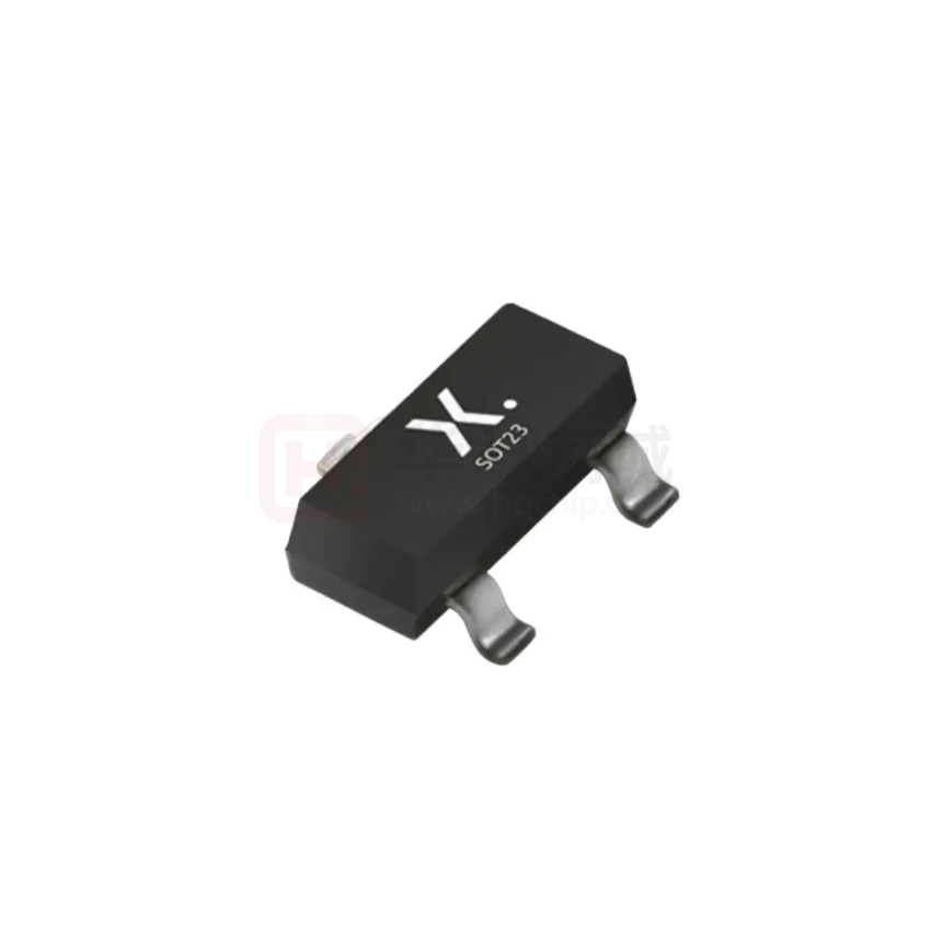

    二极管配置:独立式 功率:300mW 直流反向耐压(Vr):200V 平均整流电流(Io):200mA 正向压降(Vf):1.25V@200mA 反向电流(Ir):100nA@200V 反向恢复时间(...
BAS21THVL 数据手册
BAS21TH High-voltage switching diode 18 January 2019 Product data sheet 1. General description High-voltage switching diode, encapsulated in a small SOT23 (TO-236AB) Surface-Mounted Device (SMD) plastic package. 2. Features and benefits • • • • • • Switching speed max. 50 ns Reverse voltage VR ≤ 200 V Repetitive peak reverse voltage VRRM ≤ 250 V Small SMD plastic package High-temperature applications up to 175 °C AEC-Q101 qualified 3. Applications • • High-speed switching General-purpose switching 4. Quick reference data Table 1. Quick reference data Symbol Parameter Conditions Min Typ Max Unit - - 250 V - - 200 mA - - 200 V VRRM repetitive peak reverse voltage IF forward current VR reverse voltage VF forward voltage IF = 200 mA; tp ≤ 300 µs; δ ≤ 0.02; pulsed - - 1.25 V IR reverse current VR = 200 V - - 100 nA trr reverse recovery time IF = 30 mA; IR = 30 mA; RL = 100 Ω; IR(meas) = 3 mA - - 50 ns [1] [1] Device mounted on an FR4 Printed-Circuit Board (PCB), single-side copper, tin-plated and standard footprint. BAS21TH Nexperia High-voltage switching diode 5. Pinning information Table 2. Pinning information Pin Symbol Description 1 A anode 2 n.c. not connected 3 K cathode Simplified outline Graphic symbol 3 K A n.c. 006aaa764 1 2 SOT23 6. Ordering information Table 3. Ordering information Type number Package BAS21TH Name Description Version SOT23 plastic, surface-mounted package; 3 terminals; 1.9 mm pitch; 2.9 SOT23 mm x 1.3 mm x 1 mm body 7. Marking Table 4. Marking codes Type number Marking code[1] BAS21TH VX% [1] % = placeholder for manufacturing site code BAS21TH Product data sheet All information provided in this document is subject to legal disclaimers. 18 January 2019 © Nexperia B.V. 2019. All rights reserved 2 / 10 BAS21TH Nexperia High-voltage switching diode 8. Limiting values Table 5. Limiting values In accordance with the Absolute Maximum Rating System (IEC 60134). Tj = 25 °C unless otherwise specified. Symbol Parameter Conditions VRRM repetitive peak reverse voltage VR reverse voltage IF forward current IFSM non-repetitive peak forward current Min Max Unit - 250 V - 200 V - 200 mA tp = 1 µs; Tj(init) = 25 °C; - 9 A tp = 100 µs; Tj(init) = 25 °C; - 3 A tp = 10 ms; Tj(init) = 25 °C; - 1.7 A - 625 mA - 300 mW [1] IFRM repetitive peak forward current tp ≤ 1 ms; δ = 0.25 Ptot total power dissipation Tamb ≤ 25 °C Tj junction temperature - 175 °C Tamb ambient temperature -55 175 °C Tstg storage temperature -65 175 °C [1] [1] Device mounted on an FR4 Printed-Circuit Board (PCB), single-side copper, tin-plated and standard footprint. aaa-029058 400 Ptot (mW) 300 200 100 0 -75 25 125 Tamb (°C) 225 FR4 PCB, standard footprint Fig. 1. Power derating curve BAS21TH Product data sheet All information provided in this document is subject to legal disclaimers. 18 January 2019 © Nexperia B.V. 2019. All rights reserved 3 / 10 BAS21TH Nexperia High-voltage switching diode 9. Thermal characteristics Table 6. Thermal characteristics Symbol Parameter Conditions Min Typ Max Unit Rth(j-a) thermal resistance from in free air junction to ambient [1] [2] - - 500 K/W Rth(j-sp) thermal resistance from junction to solder point [3] - - 330 K/W [1] [2] [3] Device mounted on an FR4 Printed-Circuit Board (PCB), single-side copper, tin-plated and standard footprint. Thermal runaway has to be considered, as in some applications the reverse power losses PR are a significant part of the total power losses. Soldering point of cathode tab. 10. Characteristics Table 7. Characteristics Tj = 25 °C unless otherwise specified. Symbol Parameter Conditions Min Typ Max Unit VF forward voltage IF = 100 mA; tp ≤ 300 µs; δ ≤ 0.02; pulsed - - 1 V IF = 200 mA; tp ≤ 300 µs; δ ≤ 0.02; pulsed - - 1.25 V VR = 200 V - - 100 nA VR = 200 V; Tj = 150 °C - - 100 µA IR reverse current Cd diode capacitance VR = 0 V; f = 1 MHz - - 5 pF trr reverse recovery time IF = 30 mA; IR = 30 mA; RL = 100 Ω; IR(meas) = 3 mA - - 50 ns aaa-029056 103 IF (mA) aaa-029057 600 IF (mA) 102 400 10 (2) (1) (4) (3) Tamb = 175 °C 200 (5) 1 Tamb = 150 °C Tamb = 25 °C 10-1 0 0.2 0.4 0.6 0.8 1.0 (1) Tj = 175 °C (2) Tj = 150 °C (3) Tj = 85 °C (4) Tj = 25 °C (5) Tj = −40 °C Fig. 2. 0 1.2 1.4 VF (V) Product data sheet 0.5 1.0 VF (V) 1.5 (1) Tj = 175 °C (2) Tj = 150 °C (3) Tj = 25 °C Fig. 3. Forward current as a function of forward voltage; typical values BAS21TH 0 Forward current as a function of forward voltage; typical values All information provided in this document is subject to legal disclaimers. 18 January 2019 © Nexperia B.V. 2019. All rights reserved 4 / 10 BAS21TH Nexperia High-voltage switching diode mbg703 102 IFSM (A) aaa-029059 103 IR (µA) Tamb = 175 °C 102 Tamb = 150 °C 10 10 1 Tamb = 85 °C 10-1 10-2 Tamb = 25 °C 10-3 1 10-4 10-5 10- 1 1 10 102 103 tp (µs) 10-6 104 Based on square wave currents. Tj = 25 °C prior to surge. Fig. 4. Fig. 5. Non-repetitive peak forward current as a function of pulse duration; maximum values mbg447 1.0 Tamb = -40 °C 0 40 80 120 160 200 VR (V) Reverse current as a function of reverse voltage; typical values aaa-029060 300 Cd (pF) VR (V) 0.8 200 0.6 100 0.4 0.2 0 2 4 6 VR (V) 0 8 f = 1 MHz Tj = 25 °C. Fig. 6. Fig. 7. Diode capacitance as a function of reverse voltage; typical values. BAS21TH Product data sheet 0 100 150 200 Tamb (°C) Maximum continuous reverse voltage as a function of ambient temperature All information provided in this document is subject to legal disclaimers. 18 January 2019 50 © Nexperia B.V. 2019. All rights reserved 5 / 10 BAS21TH Nexperia High-voltage switching diode 11. Test information tr D.U.T. RS = 50 Ω IF tp t 10 % + IF SAMPLING OSCILLOSCOPE trr t Ri = 50 Ω V = VR + IF × RS mga881 VR (1) 90 % input signal output signal (1) IR = 3 mA Fig. 8. Reverse recovery time test circuit and waveforms Quality information This product has been qualified in accordance with the Automotive Electronics Council (AEC) standard Q101 - Stress test qualification for discrete semiconductors, and is suitable for use in automotive applications. 12. Package outline 3.0 2.8 1.1 0.9 3 0.45 0.15 2.5 1.4 2.1 1.2 1 2 1.9 0.48 0.38 Dimensions in mm Fig. 9. 0.15 0.09 18-03-12 Package outline SOT23 BAS21TH Product data sheet All information provided in this document is subject to legal disclaimers. 18 January 2019 © Nexperia B.V. 2019. All rights reserved 6 / 10 BAS21TH Nexperia High-voltage switching diode 13. Soldering 3.3 2.9 1.9 solder lands 3 solder resist 2 1.7 solder paste occupied area 0.6 (3×) 0.7 (3×) Dimensions in mm 0.5 (3×) 0.6 (3×) 1 sot023_fr Fig. 10. Reflow soldering footprint for SOT23 2.2 1.2 (2×) 1.4 (2×) solder lands 4.6 solder resist 2.6 occupied area Dimensions in mm 1.4 preferred transport direction during soldering 2.8 4.5 sot023_fw Fig. 11. Wave soldering footprint for SOT23 BAS21TH Product data sheet All information provided in this document is subject to legal disclaimers. 18 January 2019 © Nexperia B.V. 2019. All rights reserved 7 / 10 BAS21TH Nexperia High-voltage switching diode 14. Revision history Table 8. Revision history Data sheet ID Release date Data sheet status Change notice Supersedes BAS21TH v.2 20190119 Product data sheet - BAS21TH v.1 Modifications: • BAS21TH v.1 20181207 BAS21TH Product data sheet Characteristics: Figure 5 y-scale unit corrected to µA Product data sheet - All information provided in this document is subject to legal disclaimers. 18 January 2019 - © Nexperia B.V. 2019. All rights reserved 8 / 10 BAS21TH Nexperia High-voltage switching diode equipment, nor in applications where failure or malfunction of an Nexperia product can reasonably be expected to result in personal injury, death or severe property or environmental damage. Nexperia and its suppliers accept no liability for inclusion and/or use of Nexperia products in such equipment or applications and therefore such inclusion and/or use is at the customer's own risk. 15. Legal information Data sheet status Document status [1][2] Product status [3] Definition Quick reference data — The Quick reference data is an extract of the product data given in the Limiting values and Characteristics sections of this document, and as such is not complete, exhaustive or legally binding. Objective [short] data sheet Development This document contains data from the objective specification for product development. Preliminary [short] data sheet Qualification This document contains data from the preliminary specification. Applications — Applications that are described herein for any of these products are for illustrative purposes only. Nexperia makes no representation or warranty that such applications will be suitable for the specified use without further testing or modification. Product [short] data sheet Production This document contains the product specification. [1] [2] [3] Please consult the most recently issued document before initiating or completing a design. The term 'short data sheet' is explained in section "Definitions". The product status of device(s) described in this document may have changed since this document was published and may differ in case of multiple devices. The latest product status information is available on the internet at https://www.nexperia.com. Definitions Draft — The document is a draft version only. The content is still under internal review and subject to formal approval, which may result in modifications or additions. Nexperia does not give any representations or warranties as to the accuracy or completeness of information included herein and shall have no liability for the consequences of use of such information. Short data sheet — A short data sheet is an extract from a full data sheet with the same product type number(s) and title. A short data sheet is intended for quick reference only and should not be relied upon to contain detailed and full information. For detailed and full information see the relevant full data sheet, which is available on request via the local Nexperia sales office. In case of any inconsistency or conflict with the short data sheet, the full data sheet shall prevail. Product specification — The information and data provided in a Product data sheet shall define the specification of the product as agreed between Nexperia and its customer, unless Nexperia and customer have explicitly agreed otherwise in writing. In no event however, shall an agreement be valid in which the Nexperia product is deemed to offer functions and qualities beyond those described in the Product data sheet. Disclaimers Limited warranty and liability — Information in this document is believed to be accurate and reliable. However, Nexperia does not give any representations or warranties, expressed or implied, as to the accuracy or completeness of such information and shall have no liability for the consequences of use of such information. Nexperia takes no responsibility for the content in this document if provided by an information source outside of Nexperia. In no event shall Nexperia be liable for any indirect, incidental, punitive, special or consequential damages (including - without limitation - lost profits, lost savings, business interruption, costs related to the removal or replacement of any products or rework charges) whether or not such damages are based on tort (including negligence), warranty, breach of contract or any other legal theory. Customers are responsible for the design and operation of their applications and products using Nexperia products, and Nexperia accepts no liability for any assistance with applications or customer product design. It is customer’s sole responsibility to determine whether the Nexperia product is suitable and fit for the customer’s applications and products planned, as well as for the planned application and use of customer’s third party customer(s). Customers should provide appropriate design and operating safeguards to minimize the risks associated with their applications and products. Nexperia does not accept any liability related to any default, damage, costs or problem which is based on any weakness or default in the customer’s applications or products, or the application or use by customer’s third party customer(s). Customer is responsible for doing all necessary testing for the customer’s applications and products using Nexperia products in order to avoid a default of the applications and the products or of the application or use by customer’s third party customer(s). Nexperia does not accept any liability in this respect. Limiting values — Stress above one or more limiting values (as defined in the Absolute Maximum Ratings System of IEC 60134) will cause permanent damage to the device. Limiting values are stress ratings only and (proper) operation of the device at these or any other conditions above those given in the Recommended operating conditions section (if present) or the Characteristics sections of this document is not warranted. Constant or repeated exposure to limiting values will permanently and irreversibly affect the quality and reliability of the device. Terms and conditions of commercial sale — Nexperia products are sold subject to the general terms and conditions of commercial sale, as published at http://www.nexperia.com/profile/terms, unless otherwise agreed in a valid written individual agreement. In case an individual agreement is concluded only the terms and conditions of the respective agreement shall apply. Nexperia hereby expressly objects to applying the customer’s general terms and conditions with regard to the purchase of Nexperia products by customer. No offer to sell or license — Nothing in this document may be interpreted or construed as an offer to sell products that is open for acceptance or the grant, conveyance or implication of any license under any copyrights, patents or other industrial or intellectual property rights. Export control — This document as well as the item(s) described herein may be subject to export control regulations. Export might require a prior authorization from competent authorities. Translations — A non-English (translated) version of a document is for reference only. The English version shall prevail in case of any discrepancy between the translated and English versions. Trademarks Notice: All referenced brands, product names, service names and trademarks are the property of their respective owners. Notwithstanding any damages that customer might incur for any reason whatsoever, Nexperia’s aggregate and cumulative liability towards customer for the products described herein shall be limited in accordance with the Terms and conditions of commercial sale of Nexperia. Right to make changes — Nexperia reserves the right to make changes to information published in this document, including without limitation specifications and product descriptions, at any time and without notice. This document supersedes and replaces all information supplied prior to the publication hereof. Suitability for use in automotive applications — This Nexperia product has been qualified for use in automotive applications. Unless otherwise agreed in writing, the product is not designed, authorized or warranted to be suitable for use in life support, life-critical or safety-critical systems or BAS21TH Product data sheet All information provided in this document is subject to legal disclaimers. 18 January 2019 © Nexperia B.V. 2019. All rights reserved 9 / 10 BAS21TH Nexperia High-voltage switching diode Contents 1. General description...................................................... 1 2. Features and benefits.................................................. 1 3. Applications.................................................................. 1 4. Quick reference data....................................................1 5. Pinning information......................................................2 6. Ordering information....................................................2 7. Marking.......................................................................... 2 8. Limiting values............................................................. 3 9. Thermal characteristics............................................... 4 10. Characteristics............................................................ 4 11. Test information.......................................................... 6 12. Package outline.......................................................... 6 13. Soldering..................................................................... 7 14. Revision history..........................................................8 15. Legal information........................................................9 © Nexperia B.V. 2019. All rights reserved For more information, please visit: http://www.nexperia.com For sales office addresses, please send an email to: salesaddresses@nexperia.com Date of release: 18 January 2019 BAS21TH Product data sheet All information provided in this document is subject to legal disclaimers. 18 January 2019 © Nexperia B.V. 2019. All rights reserved 10 / 10
