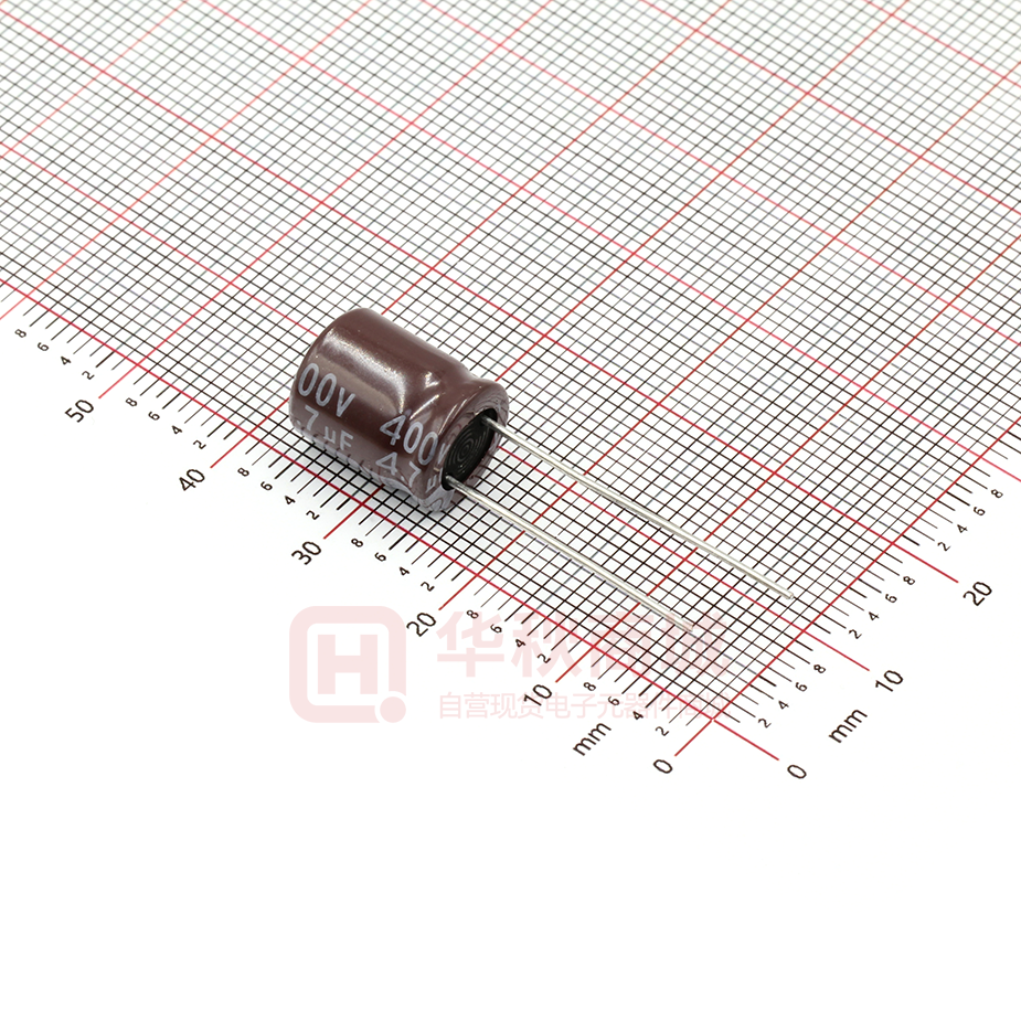

    直插铝电解电容 插件,D10xL13mm 4.7µF ±20% Ф10.00 x 13.00mm 400V 7Ω 160mA 10000Hrs@105℃
01EC1390SHG4.7uF400V 数据手册
SHG Series Aluminum Electrolytic Capacitors Item Name SHG2G4R7M-1013 Rating SHG400V4.7μF Case size Φ10*13L KNSCHA Lifetime 10000 hours 1. Operating Temp. Range -25℃ ~ + 105℃ 2. Electrical Characteristics See Table 1. 【Table 1】 Rated Voltage VDC Surge Voltage VDC 400 450 Nominal Tolerance Permissible Dissipation Leakage Static on Factor Current Ripple Current Impedance(Ω) Capacitan Capacitance (tanδ)max 5min. 20℃ (mArms)max 100KHZ 20℃ ce (%) 20℃ 120Hz (μA)max 105℃100KHz (μF) 20℃ 120Hz 4.7 -20~+20 52.6 0.24 160 7.0 3. Dimensions Rubber Bung Sleeve Фd=0.05 Tinned copper-ply wire φd Safety Vent φ6.3 or over F±0.5 ФD+αmax L+βmax. Unit(mm) φD+0.5Max 10 15min. L+2Max 13 φD+0.5 4min. F±0.5 5.0 d±0.05 0.6 4. Marking Following items are printed with white color on coffee color sleeve Example of Marking 400V 4.7μF ① Rated voltage & Nominal Capacitance ② Polarity (negative) ③ Trade Mark ④ series ⑤ Symbol of Capacitance Tolerance (M) ⑥ Max Operating Temp. ① ② KNSCHA SHG ③ ④ (M )105℃ ⑤⑥ 5.MULTIPLIER FOR RIPPLE CURRENT ①. Frequency Coefficient Freq.(Hz) 60(50) 120 Cap(μF) 0.75 0.80 0.1-47 0.80 0.85 68-680 1000-22000 0.85 0.87 ②. Temperature Coefficient Ambient 40 60 Temperature(℃) Coefficient 2.40 2.10 1K 10K 100K 0.85 0.90 0.89 0.90 0.95 0.92 1.00 1.00 1.00 70 85 105 1.78 1.65 1.00 No,KNS-20200319005 (1/5) 6. No. Characteristics Item 1 Leakage Current Performance I= 52.6 μA Test Method (I=0.02CV+15μA) I= Max Leakage Current C=Ctatic Capacitor: V=Rated Voltage Protection Resistor : 1000±10Ω Applied Volt : Rated Voltage Mesauring time : 5minutes Measured Frequency : 120Hz±20% 2 Static Capacitance 3 Dissiption Factor (tanδ) 3.76 ~ 5.64 μF Measured Voltage ≤ 0.5Vrms, 1.5 ~ 2.0VDC 0.24 and Under Same as condition of Capacitors 4 High Temp. Load Characteristics Leakage Current Cap. Change Dissipation Factor Appearance ≦the value specified in Table 1 Test Temp. : 105±2℃ Applied voltage: Rated voltage ≦±20% of initial value ≦200% of value specified in Table 1 Test Time :10,000 hours No remarkable abnormality +72, -0 hours 5 High Temp. no load Characteristics Leakage Current Cap. Change Dissipation Factor Appearance ≦the value specified in Table 1 Test Temp. : 105±2℃ No voltage applied ≦±20% of initial value ≦200% of value specified in Table 1 Test Time :1000 hours No remarkable abnormality +24, -0 hurs 6 Terminal Strength Tensile Strength Bending Strength 7 Impedance Ratio 45N {4.5kg} 25N {2.5kg} WV Z-25℃/Z+20℃ Z-40℃/Z+20℃ Keeping time Tensile 1~5sec Bending 30±5sec 400 6 - 8 Temperature Stage Item Charac 2,3 Impedance Ratio teristics 5 Cap, Change Performance Stage Test Temp(℃) 20±2 less than the value mentioned in 5-7, 1 -25±3; ≤±25% against value in stage 4 2 -25±3; 3 20±2 4 105±2 After the capacitor is held at tempereture of each stage 5 20±2 and reaches temperature stability, measure performance. 6 9 Surge Voltage Item Leakage Current Cap, Change Dissipation Factor Appearance Perforemance ≤ the initial specified value ≤ ±15% against value before test ≤ the initial specified value No remakable abnormality Test Temp. 15~35℃ Test volt. Surge Volt.Specified in 2 Voltage apply. 1,000times of chage for 30±5sec, under frequency of 6±0.5sec, and discharge for 5min30sec. No,KNS-181102001 (2/5) 6-2. Characteristics No. Item Performance 10 Vibration Resistance Test Method Stability required Capacitance ≤±5% of the initial specified value Cap. Change Appearance No remarkable abnormality Frequency : 10~55Hz/1min. Width of vibration, 1.5mm Direction and duration X, Y and Z directions, each for 2 hours (Total 9 hours) 11 Solderbility 3/4 area of surrounding directions of surface should be covered with new solder. Solder: Sn-Ag, Sn-Cu Type Soldering Temp : 240±5℃ Dipping degree : 2~2.5mm Flux : Ethanol solution (JIS K8101) or Isopropylalchol (JIS K8839) solution of Rosin (JIS K5902) 12 Resistance to Soldering Leakage Current Cap. Change Dissipation Factor Appearance ≦ Initial specified value ≦±10% of initial value ≦ Initial specified in value No remarkable abnormality Soldering Temp. 280±5℃ Soldering Time . 10±1sec. 13 Resistance to Humidity Leakage Current Cap. Change Dissipation Factor Appearance ≦ Initial specified value ≦±15% of initial value ≦ Initial spesified value No remarkable abnormality Test Temp. : 40±2℃ Humidity 90~95% Test Time : 500 ± 8 hours After the above condition,restored to normal temp, and then measured. 14 Perssure valve There must not be thing ignition, scattering moment the resolution that that case works safely characterstics Dcmethod: impress the reverse voltage and of 1A, I cancel an electric current. 7 Packing method Packaging shape, size, quantity Component size 10*13 Quanity per 10000pcs. H L W 8 Related Standards JIS C 5141 9 Marking on packing box ① ② ③ ④ ⑤ ⑥ ⑦ Item name Series name Rated Voltage Nominal Static Capacitance Case size Lot No. Quantity No,KNS-20200319005 (3/5) 10 Leakage current Connecting the capacitor with a protective resistor (1kΩ±10Ω) in series for 2 minutes, and then, measure leakage current.
