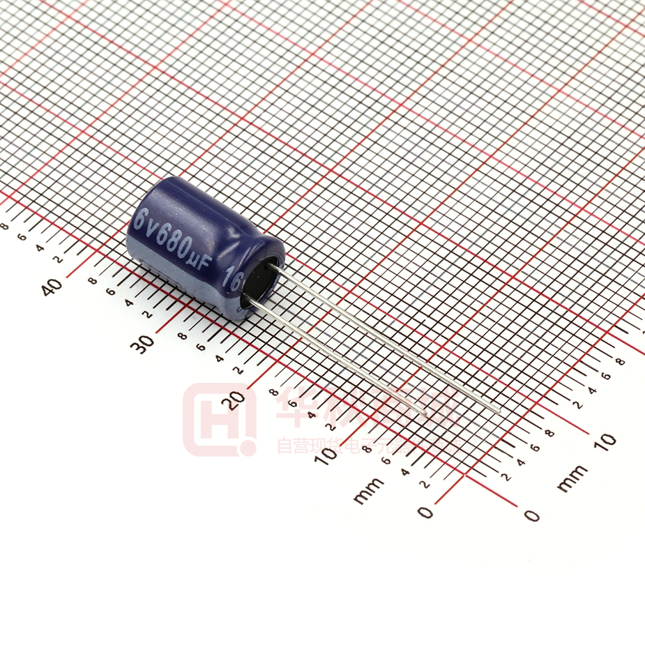

    直插铝电解电容 插件,D8xL12mm 680µF ±20% Ф8.00 x 12.00mm 16V 2000Hrs@105℃

| 11'1 II~ Ir!'t .'I~):I'':].川UM ELECTROLYTIC CAPACITORS RRseri AiSH~ E111 • High frequency,low impedance,high reliability • Endurance: +1 05.C 2 , 000 hours • Suitable for switching power, UPS , power sources , etc. • RoHS Compliant • SPECIFICATIONS lωm. Charactørlatlca ca脑gory Temperature Ra nge -40同时 05.C RatedVol恒ge Range 6.3-50 Vdc CapacilanωToleranω 士 20%(M) lea阳ge Current 1.:50.01 CVor 3μA , whiche内,er is greater. Whe障, 1:Max.leakage current (IIA), C:Nominal capacitance (at20'C ,120Hz) RatadVollaga(Vdc) Dissipation Factor (恼nð) 回 nð (max.) 6.3 10 16 25 35 (~F),V: Raled voltage (V) (at 20.C afler2 minules) 50 : 0.22 : 0.18 : 0.14 : 0.12 : 0.10 : 0.08 : When nomlnal capacltance e明eeds 1,OOO Il F, add 0.02 tolhevalue aÞoveforeach 1 ,000 1l F Increase. low Tømperatura Rated Vollage(Vdc) 6.3 10 16 25 35 (at20'C , 120Hz) 50 Characteri6回c6 (Max.lmp创ence Ratio) Z(-25'C)/Z( +20'C) 2 (al120Hz) Tha spaclflcallons IIsled Þelow sha 11 Þa mat whan Ihe capaclt口rs ara raslorad to 20'C after DC voltaga plus ralad rl pple currant is appl ied for 2 ,000 hours at 105 'C. Enduranω Capacllance Change 量土 20% D.F. (tanð) s200% ofthe inilialspeci而edvalue ofthe Inlllal value (6.3 , 10V: 孟士 30%) Leakage Currenl 量The initielspecifiad value The following specificøtion8 8høll be 8ali8fied when the capacitors are re8t口呻 d 1020.C a'匍.er leaving them under no load øt 105.C for 1,000 h口urs. ShelfLife 量土20% :S: 200% ofthe Inlllal spaclfled value Leakage Cu rrenl :S:200% 口fthe initial 8pecified value DIMENSIONS[mm] @ak ←A -g可 -帽但 • of thø initial value (6.3 ,1OV: 企30%) Capacitance Changø D.F. (Ianð) ~~. 4min. • (ØS唱 18) PART NUMBERING SYSTEM E RR 1H o D11 吃 Tt Sleeve Code: 'c" for PVC, 'r for PET Tønmlnal code Sizeoc回e capeci恒n田∞de capaci回nce tolaranceα>de vo阳唱e ∞de Sertes ∞de caωgory ∞de • RATED RIPPLE CURRENT MULTIP Ll ERS Frequency correction factor for ri pple current cap.(\ \ MF}恼 \.飞{H\ Z1 120 1k 10k 100k Cap.
