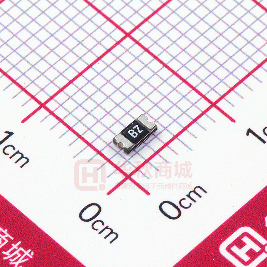

Circuit Protection SRF1206 Series Surface-Mount Devices | 1206 Size PTC Resettable Fuses Applications Features Resettable over current and over temperature protection Small size of 1206 Fast time-to-trip Small footprint RoHS complaint Low resistance Computer Portable electronics Multimedia Game machines Telephony and broadband Mobile phones Battery Industrial controls RoHS 2015/863/EC Electrical Characteristics IH (A) IT (A) V max (V) I max (A) Time to Trip Part Number (A) SRF1206P005 0.05 0.15 30 40 0.25 IH = Hold current: maximum current at which the device will not trip at 25℃ still air reflow soldering of 260℃ for 20 sec. Trip current: minimum current at which the device will always trip at 25℃ still air reflow soldering of 260℃ for 20 sec. Vmax = Maximum continuous voltage device can withstand without damage at rated current Imax = Maximum fault current device can withstand without damage at rated voltage. Ttrip = Maximum time to trip(s) at assigned current reflow soldering of 260℃ for 20 sec. Pdtyp = Typical power dissipation: typical amount of power dissipated by the device when in state air environment. IT = (Sec.) Pd typ (W) Rmin (Ω) R1max (Ω) 1.50 0.40 3.60 50.0 Rmin = Minimum resistance of device in initial (un-soldered) state. R1max = Maximum resistance of device at 25℃ measured one hour after reflow soldering of 260℃ for 20 sec. Value specified is determined by using the PWB with 0.030"*1.5oz copper traces. Caution: Operation beyond the specified rating may result in damage and possible arcing and flame. Thermal Derating Chart Hold Current (A) Part Number SRF1206P005 Ambient Operating Temperature -40°C 0.074 1 Document Number: P0F0310110307002B -20°C 0°C 25°C 40°C 50°C 60°C 70°C 85°C 0.066 0.056 0.050 0.046 0.037 0.035 0.030 0.027 Surface-Mount Devices | 1206 Size SRF1206 Series PTC Resettable Fuses Dimensions A Top View BZ B C Recommended Pad Layout (mm) Side View Bottom View 1.80±0.1 1.8±0.1 BZ 1.0±0.1 D Part Number SRF1206P005 A B C D Min Max Min Max Min Max Min 3.00 3.60 1.50 1.90 0.60 1.20 0.15 Solder Reflow Recommendation Recommended reflow methods:IR,hot air oven ,nitrogen oven Devices can be cleaned using standard industry methods and solvents. NOTE: If reflow temperatures exceed the recommended profile,devices may not meet the performance requirements. Caution: Operation beyond the rated voltage or current may result in rupture electrical arcing or flame Packaging Options Part Number Quantity SRF1206P005 3,500pcs Reel packaging per EIA -481-1 standard 2 Document Number: P0F0310110307002B © 2021 PROSEMI Inc. All Rights Reserved. Specifications and features are subject to change without notice. www.prosemitech.com The PROSEMI logo, and all other PROSEMI trademarks are the property of PROSEMI Inc. All other trademarks are the property of their respective owners.
SRF1206P005
1. 物料型号:SRF1206系列自恢复保险丝。 2. 器件简介:这些保险丝提供可复位的过电流和过温保护,具有1206尺寸的小尺寸、快速的故障响应时间和较小的占用空间。它们还符合RoHS标准,电阻较低。 3. 引脚分配:文档未明确说明引脚分配,但通常保险丝为两个引脚。 4. 参数特性: - 保持电流(IH):在260℃下20秒的回流焊接条件下,设备不会动作的最大电流。 - 动作电流(IT):在相同条件下,设备总是动作的最小电流。 - 最大电压(Vmax):在额定电流下设备能承受的最大连续电压,而不损坏。 - 最大故障电流(Imax):在额定电压下设备能承受的最大故障电流,而不损坏。 - 动作时间(Ttrip):在指定电流下回流焊接的最大动作时间。 - 典型功耗(Pdtyp):在空气中设备处于状态时的典型功耗。 5. 功能详解:自恢复保险丝在过电流或过温情况下动作,保护电路。一旦故障移除,它们可以自动复位。 6. 应用信息:适用于计算机、便携式电子设备、多媒体游戏机、电话和宽带、移动电话、电池和工业控制等领域。 7. 封装信息:1206尺寸,提供了推荐的焊盘布局和尺寸,以及最小和最大值。 8. 回流焊接建议:提供了推荐的回流方法和温度曲线,警告如果超出推荐温度曲线,设备可能无法满足性能要求。
