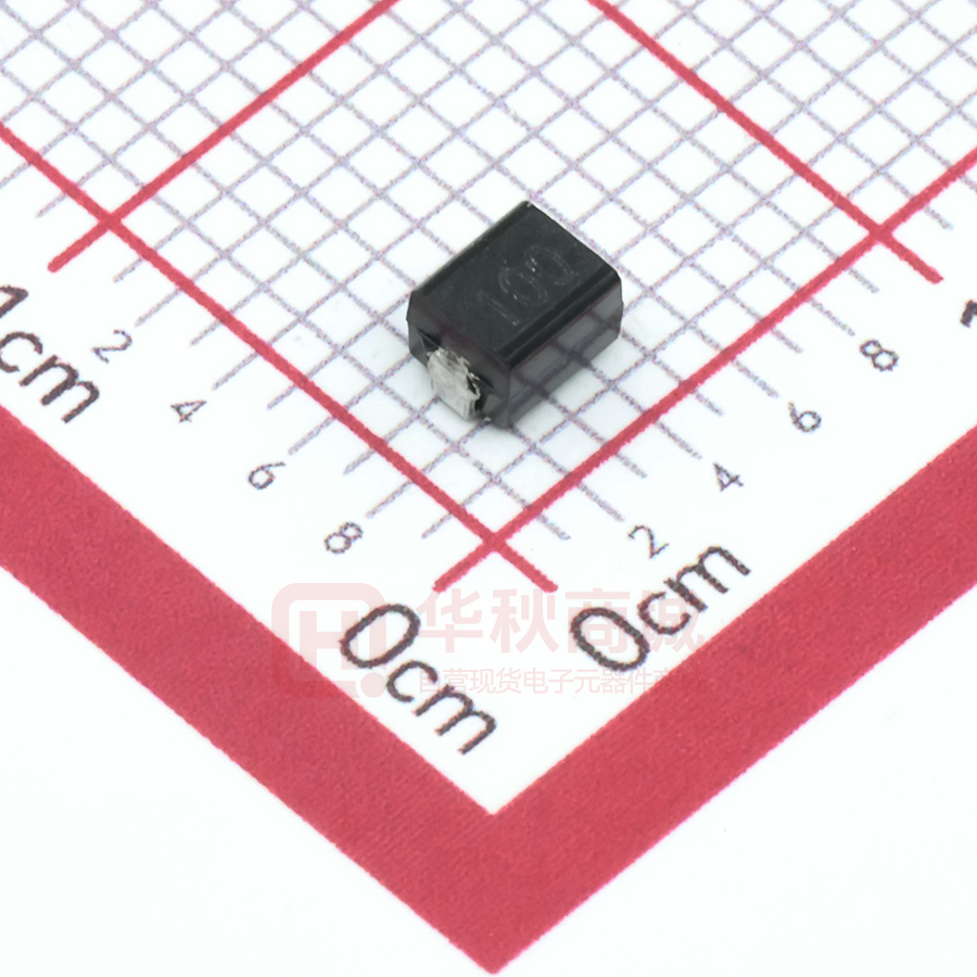

SCW-H Ser ies
Wire Wound SMD Chip Inductor
Pb
◆ FEATURES
、Lead-free materials is used for the plating on the
terminals.
2 、 The product uses metal terminals,which realize
excellent connection reliability.
3、High resistance to heat,humidity,mechanical shocks
1
and presser.Accurate dimensions for automatically
surface mounted.
4 The product has good heat durability that withstands
lead-free compatible reflow soldering conditions.
◆ Application
SCW-H serials high reliable wire would chip inductors
for communication , equipment , instrument , video &
audio have been developen in response to the trend
toward higher density mounting of parts in electric
circuits.
◆ Lead Free Part Numbering
SCW
(1)
(1)
(2)
(3)
(4)
3225 H
(2) (3)
4R7 K
(4) (5)
T
T
(6) (7)
Series Type
Dimension L X W
Material Code
Inductance 2R2=2.2μH
100=10μH 101=100μH
(5) Inductance Tolerance
J= 5%, K= 10%, M= 20%
(6) Company Code
(7) Packaging packed in embossed carrier tape
◆ SHAPE AND DIMENSIONS (unit:
:mm)
SCW3225H Series
SCW4532H Series
Rev.01
Page 1 of 4
