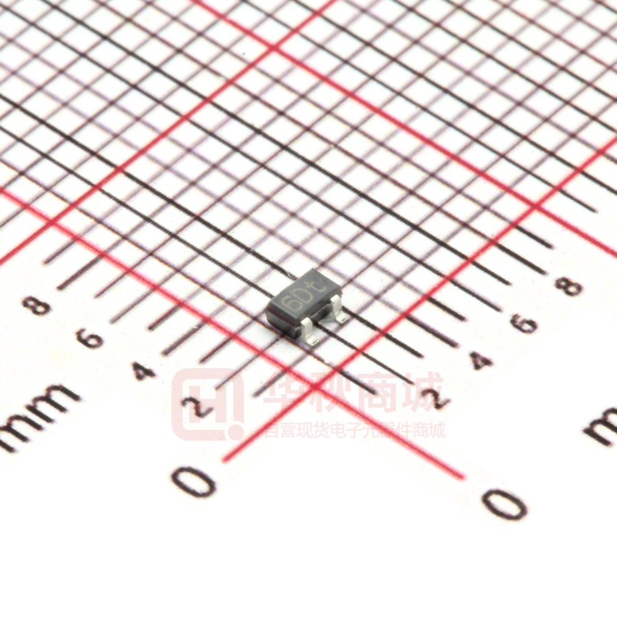

    SOT-323
    通用三极管 VCEO=45V IC=500mA NPN SOT323 100~600
BC817W,115 数据手册
BC817W series 45 V, 500 mA NPN general-purpose transistors Rev. 7 — 11 June 2018 1 Product data sheet Product profile 1.1 General description NPN general-purpose transistors in a very small SOT323 (SC-70) Surface-Mounted Device (SMD) plastic package. Table 1. Product overview Type number BC817W Package PNP complement Nexperia JEDEC JEITA SOT323 - SC-70 BC807W BC817-16W BC807-16W BC817-25W BC807-25W BC817-40W BC807-40W 1.2 Features and benefits • High current • Three current gain selections • AEC-Q101 qualified 1.3 Applications • General-purpose switching and amplification BC817W series Nexperia 45 V, 500 mA NPN general-purpose transistors 1.4 Quick reference data Table 2. Quick reference data Tamb = 25 °C unless otherwise specified. Symbol Parameter Conditions Min Typ Max Unit VCEO collector-emitter voltage open base - - 45 V IC collector current - - 500 mA ICM peak collector current single pulse; tp ≤ 1 ms - - 1 A hFE DC current gain VCE = 1 V; IC = 100 mA BC817W [1] 100 - 600 BC817-16W [1] 100 - 250 BC817-25W [1] 160 - 400 BC817-40W [1] 250 - 600 [1] pulsed; tp ≤ 300 μs; δ ≤ 0.02 2 Pinning information Table 3. Pinning Pin Symbol Description 1 B base 2 E emitter 3 C collector Simplified outline Graphic symbol SOT323 3 C B E sym123 1 3 2 Ordering information Table 4. Ordering information Type number BC817W Package Name Description Version SC-70 Plastic surface-mounted package; 3 leads SOT323 BC817-16W BC817-25W BC817-40W BC817W_SER Product data sheet All information provided in this document is subject to legal disclaimers. Rev. 7 — 11 June 2018 © Nexperia B.V. 2018. All rights reserved. 2 / 16 BC817W series Nexperia 45 V, 500 mA NPN general-purpose transistors 4 Marking Table 5. Marking Type number Marking code BC817W [1] 6D% BC817-16W [1] 6A% BC817-25W [1] 6B% BC817-40W [1] 6C% [1] % = placeholder for manufacturing site code 5 Limiting values Table 6. Limiting values In accordance with the Absolute Maximum Rating System (IEC 60134). Tamb = 25 °C unless otherwise specified. Symbol Parameter Conditions Min Max Unit VCBO collector-base voltage open emitter - 50 V VCEO collector-emitter voltage open base - 45 V VEBO emitter-base voltage open collector - 5 V IC collector current - 500 mA ICM peak collector current single pulse; tp ≤ 1 ms - 1 A IBM peak base current single pulse; tp ≤ 1 ms Ptot total power dissipation Tamb ≤ 25 °C - 200 mA [1] [2] - 200 mW [3] [2] - 290 mW Tj junction temperature - 150 °C Tamb ambient temperature -65 150 °C Tstg storage temperature -65 150 °C [1] Device mounted on an FR4 Printed-Circuit-Board (PCB); single-sided copper; tin-plated and standard footprint. [2] Valid for all available selection groups. 2 [3] Device mounted on an FR4 Printed-Circuit-Board (PCB); single-sided copper; tin-plated; mounting pad for collector 1 cm . BC817W_SER Product data sheet All information provided in this document is subject to legal disclaimers. Rev. 7 — 11 June 2018 © Nexperia B.V. 2018. All rights reserved. 3 / 16 BC817W series Nexperia 45 V, 500 mA NPN general-purpose transistors aaa-028121 400 Ptot (mW) 300 200 (1) (2) 100 0 -75 -25 (1) FR4 PCB, single-sided copper; 1 cm 25 75 125 175 Tamb (°C) 2 (2) FR4 PCB, single-sided copper; standard footprint Figure 1. Power derating curves BC817W_SER Product data sheet All information provided in this document is subject to legal disclaimers. Rev. 7 — 11 June 2018 © Nexperia B.V. 2018. All rights reserved. 4 / 16 BC817W series Nexperia 45 V, 500 mA NPN general-purpose transistors 6 Thermal characteristics Table 7. Thermal characteristics Tamb = 25 °C unless otherwise specified. Symbol Parameter Rth(j-a) Conditions thermal resistance from junction to ambient in free air Min Typ Max Unit [1] [2] - - 625 K/W [3] [2] - - 431 K/W [1] Device mounted on an FR4 Printed-Circuit-Board (PCB); single-sided copper; tin-plated and standard footprint. [2] Valid for all available selection groups. 2 [3] Device mounted on an FR4 Printed-Circuit-Board (PCB); single-sided copper; tin-plated; mounting pad for collector 1 cm . aaa-028114 103 duty cycle = 1 Zth(j-a) (K/W) 0.75 0.33 102 0.50 0.20 0.10 0.05 10 0.02 0.01 0 1 10-5 10-4 10-3 10-2 10-1 1 FR4 PCB; single-sided copper; tin-plated; mounting pad for collector 1 cm 10 102 tp (s) 103 2 Figure 2. Transient thermal impedance from junction to ambient as a function of pulse duration; typical values aaa-028115 103 Zth(j-a) (K/W) 102 duty cycle = 1 0.75 0.33 0.50 0.20 0.10 0.05 10 0.02 0.01 0 1 10-5 10-4 10-3 10-2 10-1 1 FR4 PCB; single-sided copper; tin-plated; mounting pad for collector 1 cm 10 102 tp (s) 103 2 Figure 3. Transient thermal impedance from junction to ambient as a function of pulse duration; typical values BC817W_SER Product data sheet All information provided in this document is subject to legal disclaimers. Rev. 7 — 11 June 2018 © Nexperia B.V. 2018. All rights reserved. 5 / 16 BC817W series Nexperia 45 V, 500 mA NPN general-purpose transistors 7 Characteristics Table 8. Characteristics Tamb = 25 °C unless otherwise specified. Symbol Parameter Conditions Min Typ Max Unit V(BR)CBO collector-base breakdown voltage IC = 100 µA; IE = 0 A 50 - - V V(BR)CEO collector-emitter breakdown voltage IC = 10 mA; IB = 0 A 45 - - V V(BR)EBO emitter-base breakdown voltage IE = 100 µA; IC = 0 A 5 - - V ICBO collector-base cut-off current VCB = 20 V; IE = 0 A - - 100 nA VCB = 20 V; IE = 0 A; Tj = 150 °C - - 5 μA IEBO emitter-base cut-off current VEB = 5 V; IC = 0 A - - 100 nA hFE DC current gain BC817W BC817-16W BC817-25W BC817-40W hFE DC current gain VCE = 1 V; IC = 100 mA [1] 100 - 600 VCE = 1 V; IC = 100 mA [1] 100 - 250 VCE = 1 V; IC = 100 mA [1] 160 - 400 VCE = 1 V; IC = 100 mA [1] 250 - 600 VCE = 1 V; IC = 500 mA [1] 40 - - - - 700 mV - - 1.2 V VCEsat collector-emitter saturation voltage IC = 500 mA; IB = 50 mA [1] VBE base-emitter voltage VCE = 1 V; IC = 500 mA [1] [2] fT transition frequency VCE = 5 V; IC = 10 mA; f = 100 MHz 100 - - MHz Cc collector capacitance VCB = 10 V; IE = ie = 0 A; f = 1 MHz - 3 - pF [1] pulsed; tp ≤ 300 μs; δ ≤ 0.02 [2] VBE decreases by approxymately 2 mV/K with increasing temperature. BC817W_SER Product data sheet All information provided in this document is subject to legal disclaimers. Rev. 7 — 11 June 2018 © Nexperia B.V. 2018. All rights reserved. 6 / 16 BC817W series Nexperia 45 V, 500 mA NPN general-purpose transistors 006aaa131 400 006aaa134 10 hFE 300 VBEsat (V) (1) 200 1 (2) (1) (2) (3) (3) 100 0 10- 1 1 10 102 I C (mA) 103 10- 1 10- 1 1 102 10 I C (mA) 103 VCE = 1 V (1) Tamb = 150 °C (2) Tamb = 25 °C (3) Tamb = -55 °C IC/IB = 10 (1) Tamb = -55 °C (2) Tamb = 25 °C (3) Tamb = 150 °C Figure 4. BC817-16W: DC current gain as a function of collector current; typical values Figure 5. BC817-16W: Base-emitter saturation voltage as a function of collector current; typical values 006aaa137 1 006aaa140 1.2 (5) IC (A) VCEsat (V) (4) (3) (2) 0.8 (1) (6) (7) 10- 1 (8) (9) 0.4 (10) (1) (2) (3) 10- 2 10- 1 1 10 102 I C (mA) 103 IC/IB = 10 (1) Tamb = 150 °C (2) Tamb = 25 °C (3) Tamb = -55 °C Figure 6. BC817-16W: Collector-emitter saturation voltage as a function of collector current; typical values 0 0 1 2 3 4 VCE (V) 5 Tamb = 25 °C (1) IB = 16.0 mA (2) IB = 14.4 mA (3) IB = 12.8 mA (4) IB = 11.2 mA (5) IB = 9.6 mA (6) IB = 8.0 mA (7) IB = 6.4 mA (8) IB = 4.8 mA (9) IB = 3.2 mA (10) IB = 1.6 mA Figure 7. BC817-16W: Collector current as a function of collector-emitter voltage; typical values BC817W_SER Product data sheet All information provided in this document is subject to legal disclaimers. Rev. 7 — 11 June 2018 © Nexperia B.V. 2018. All rights reserved. 7 / 16 BC817W series Nexperia 45 V, 500 mA NPN general-purpose transistors 006aaa132 600 hFE 006aaa135 10 (1) VBEsat (V) (2) 1 400 (2) 200 0 10- 1 (1) (3) 1 (3) 102 10 I C (mA) 103 10- 1 10- 1 1 102 10 I C (mA) 103 VCE = 1 V (1) Tamb = 150 °C (2) Tamb = 25 °C (3) Tamb = -55 °C IC/IB = 10 (1) Tamb = -55 °C (2) Tamb = 25 °C (3) Tamb = 150 °C Figure 8. BC817-25W: DC current gain as a function of collector current; typical values Figure 9. BC817-25W: Base-emitter saturation voltage as a function of collector current; typical values 006aaa138 1 006aaa141 1.2 VCEsat (V) (6) IC (A) 10- 1 (5) (4) (3) (2) (1) 0.8 (7) (8) (1) (9) (2) 10- 2 0.4 (3) (10) 10- 3 10- 1 1 10 102 I C (mA) 103 IC/IB = 10 (1) Tamb = 150 °C (2) Tamb = 25 °C (3) Tamb = -55 °C Figure 10. BC817-25W: Collector-emitter saturation voltage as a function of collector current; typical values 0 0 1 2 3 4 VCE (V) 5 Tamb = 25 °C (1) IB = 13.0 mA (2) IB = 11.7 mA (3) IB = 10.4 mA (4) IB = 9.1 mA (5) IB = 7.8 mA (6) IB = 6.5 mA (7) IB = 5.2 mA (8) IB = 3.9 mA (9) IB = 2.6 mA (10) IB = 1.3 mA Figure 11. BC817-25W: Collector current as a function of collector-emitter voltage; typical values BC817W_SER Product data sheet All information provided in this document is subject to legal disclaimers. Rev. 7 — 11 June 2018 © Nexperia B.V. 2018. All rights reserved. 8 / 16 BC817W series Nexperia 45 V, 500 mA NPN general-purpose transistors 006aaa133 800 006aaa136 10 hFE 600 (1) VBEsat (V) 400 (2) 1 (1) (2) (3) 200 0 10- 1 1 (3) 102 10 I C (mA) 103 VCE = 1 V (1) Tamb = 150 °C (2) Tamb = 25 °C (3) Tamb = -55 °C 10- 1 10- 1 1 102 10 I C (mA) 103 IC/IB = 10 (1) Tamb = -55 °C (2) Tamb = 25 °C (3) Tamb = 150 °C Figure 12. BC817-40W: DC current gain as a function of Figure 13. BC817-40W: Base-emitter saturation voltage collector current; typical values as a function of collector current; typical values 006aaa139 1 006aaa142 1.2 VCEsat (V) (6) IC (A) 10- 1 (5) (4) (3) (2) 0.8 (1) (7) (8) (9) (1) (2) 10- 2 10- 3 10- 1 0.4 (3) 1 10 102 I C (mA) 103 IC/IB = 10 (1) Tamb = 150 °C (2) Tamb = 25 °C (3) Tamb = -55 °C Figure 14. BC817-40W: Collector-emitter saturation voltage as a function of collector current; typical values 0 (10) 0 1 2 3 4 VCE (V) 5 Tamb = 25 °C (1) IB = 12.0 mA (2) IB = 10.8 mA (3) IB = 9.6 mA (4) IB = 8.4 mA (5) IB = 7.2 mA (6) IB = 6.0 mA (7) IB = 4.8 mA (8) IB = 3.6 mA (9) IB = 2.4 mA (10) IB = 1.2 mA Figure 15. BC817-40W: Collector current as a function of collector-emitter voltage; typical values BC817W_SER Product data sheet All information provided in this document is subject to legal disclaimers. Rev. 7 — 11 June 2018 © Nexperia B.V. 2018. All rights reserved. 9 / 16 BC817W series Nexperia 45 V, 500 mA NPN general-purpose transistors 8 Test information 8.1 Quality information This product has been qualified in accordance with the Automotive Electronics Council (AEC) standard Q101 - Stress test qualification for discrete semiconductors, and is suitable for use in automotive applications. BC817W_SER Product data sheet All information provided in this document is subject to legal disclaimers. Rev. 7 — 11 June 2018 © Nexperia B.V. 2018. All rights reserved. 10 / 16 BC817W series Nexperia 45 V, 500 mA NPN general-purpose transistors 9 Package outline Table 9. Package outline Plastic surface-mounted package; 3 leads SOT323 D B E A X HE y v M A 3 Q A A1 1 c 2 e1 bp Lp w M B e detail X 0 1 2 mm scale DIMENSIONS (mm are the original dimensions) UNIT A A1 max bp c D E e e1 HE Lp Q v w mm 1.1 0.8 0.1 0.4 0.3 0.25 0.10 2.2 1.8 1.35 1.15 1.3 0.65 2.2 2.0 0.45 0.15 0.23 0.13 0.2 0.2 OUTLINE VERSION REFERENCES IEC JEDEC SOT323 JEITA SC-70 EUROPEAN PROJECTION ISSUE DATE 04-11-04 06-03-16 Figure 16. Package outline SOT323 (SC70) BC817W_SER Product data sheet All information provided in this document is subject to legal disclaimers. Rev. 7 — 11 June 2018 © Nexperia B.V. 2018. All rights reserved. 11 / 16 BC817W series Nexperia 45 V, 500 mA NPN general-purpose transistors 10 Soldering Table 10. Soldering 2.65 1.85 1.325 solder lands solder resist 2 2.35 0.6 (3×) 3 solder paste 1.3 1 occupied area 0.5 (3×) Dimensions in mm 0.55 (3×) sot323_fr Figure 17. Reflow soldering footprint for SOT323 (SC-70) 4.6 2.575 1.425 (3×) solder lands solder resist occupied area 1.8 3.65 2.1 09 (2×) Dimensions in mm preferred transport direction during soldering sot323_fw Figure 18. Wave soldering footprint for SOT323 (SC-70) BC817W_SER Product data sheet All information provided in this document is subject to legal disclaimers. Rev. 7 — 11 June 2018 © Nexperia B.V. 2018. All rights reserved. 12 / 16 BC817W series Nexperia 45 V, 500 mA NPN general-purpose transistors 11 Revision history Table 11. Revision history Document ID Release date Data sheet status Change notice Supersedes BC817W_SER v.7 20180611 Product data sheet - BC817_BC817W_BC337 v.6 Modifications: • The format of this data sheet has been redesigned to comply with the identity guidelines of Nexperia. • Legal texts have been adapted to the new company name where appropriate. • Removed basic types: BC327 and BC807W (separate data sheet). • Added Fig 1. Power derating curves in section "Limiting values" and the thermal graphs as Fig 2. and Fig 3. in section "Thermal characteristics". • Graphs in section "Characteristics" are sorted in new order. • Added sections 8 "Test information" and 9 "Soldering". • Removed Section "Packing information" • AEC-Q101 qualified BC817_BC817W_BC337 v.6 20091117 Product data sheet - BC817_BC817W_BC337 v.5 BC817_BC817W_BC337 v.5 20050221 Product data sheet CPCN200302007F CPCN200405006F BC817 v.4; BC817W_SER v.4; BC337 v.3 BC817 v.4 20040116 Product Specification - BC817 v.3 BC817W_SER v.4 20040225 Product Specification - BC817W_SER v.3 BC337 v.3 19990415 Product Specification - BC337_338_CNV v.2 BC817W_SER Product data sheet All information provided in this document is subject to legal disclaimers. Rev. 7 — 11 June 2018 © Nexperia B.V. 2018. All rights reserved. 13 / 16 BC817W series Nexperia 45 V, 500 mA NPN general-purpose transistors 12 Legal information 12.1 Data sheet status Document status [1][2] Product status [3] Definition Objective [short] data sheet Development This document contains data from the objective specification for product development. Preliminary [short] data sheet Qualification This document contains data from the preliminary specification. Product [short] data sheet Production This document contains the product specification. [1] [2] [3] Please consult the most recently issued document before initiating or completing a design. The term 'short data sheet' is explained in section "Definitions". The product status of device(s) described in this document may have changed since this document was published and may differ in case of multiple devices. The latest product status information is available on the Internet at URL http://www.nexperia.com. 12.2 Definitions Draft — The document is a draft version only. The content is still under internal review and subject to formal approval, which may result in modifications or additions. Nexperia does not give any representations or warranties as to the accuracy or completeness of information included herein and shall have no liability for the consequences of use of such information. Short data sheet — A short data sheet is an extract from a full data sheet with the same product type number(s) and title. A short data sheet is intended for quick reference only and should not be relied upon to contain detailed and full information. For detailed and full information see the relevant full data sheet, which is available on request via the local Nexperia sales office. In case of any inconsistency or conflict with the short data sheet, the full data sheet shall prevail. Product specification — The information and data provided in a Product data sheet shall define the specification of the product as agreed between Nexperia and its customer, unless Nexperia and customer have explicitly agreed otherwise in writing. In no event however, shall an agreement be valid in which the Nexperia product is deemed to offer functions and qualities beyond those described in the Product data sheet. 12.3 Disclaimers Limited warranty and liability — Information in this document is believed to be accurate and reliable. However, Nexperia does not give any representations or warranties, expressed or implied, as to the accuracy or completeness of such information and shall have no liability for the consequences of use of such information. Nexperia takes no responsibility for the content in this document if provided by an information source outside of Nexperia. In no event shall Nexperia be liable for any indirect, incidental, punitive, special or consequential damages (including - without limitation lost profits, lost savings, business interruption, costs related to the removal or replacement of any products or rework charges) whether or not such damages are based on tort (including negligence), warranty, breach of contract or any other legal theory. Notwithstanding any damages that customer might incur for any reason whatsoever, Nexperia's aggregate and cumulative liability towards customer for the products described herein shall be limited in accordance with the Terms and conditions of commercial sale of Nexperia. Right to make changes — Nexperia reserves the right to make changes to information published in this document, including without limitation specifications and product descriptions, at any time and without notice. This document supersedes and replaces all information supplied prior to the publication hereof. or warranty that such applications will be suitable for the specified use without further testing or modification. Customers are responsible for the design and operation of their applications and products using Nexperia products, and Nexperia accepts no liability for any assistance with applications or customer product design. It is customer’s sole responsibility to determine whether the Nexperia product is suitable and fit for the customer’s applications and products planned, as well as for the planned application and use of customer’s third party customer(s). Customers should provide appropriate design and operating safeguards to minimize the risks associated with their applications and products. Nexperia does not accept any liability related to any default, damage, costs or problem which is based on any weakness or default in the customer’s applications or products, or the application or use by customer’s third party customer(s). Customer is responsible for doing all necessary testing for the customer’s applications and products using Nexperia products in order to avoid a default of the applications and the products or of the application or use by customer’s third party customer(s). Nexperia does not accept any liability in this respect. Limiting values — Stress above one or more limiting values (as defined in the Absolute Maximum Ratings System of IEC 60134) will cause permanent damage to the device. Limiting values are stress ratings only and (proper) operation of the device at these or any other conditions above those given in the Recommended operating conditions section (if present) or the Characteristics sections of this document is not warranted. Constant or repeated exposure to limiting values will permanently and irreversibly affect the quality and reliability of the device. Terms and conditions of commercial sale — Nexperia products are sold subject to the general terms and conditions of commercial sale, as published at http://www.nexperia.com/profile/terms, unless otherwise agreed in a valid written individual agreement. In case an individual agreement is concluded only the terms and conditions of the respective agreement shall apply. Nexperia hereby expressly objects to applying the customer’s general terms and conditions with regard to the purchase of Nexperia products by customer. No offer to sell or license — Nothing in this document may be interpreted or construed as an offer to sell products that is open for acceptance or the grant, conveyance or implication of any license under any copyrights, patents or other industrial or intellectual property rights. Suitability for use in automotive applications — This Nexperia product has been qualified for use in automotive applications. Unless otherwise agreed in writing, the product is not designed, authorized or warranted to be suitable for use in life support, life-critical or safety-critical systems or equipment, nor in applications where failure or malfunction of an Nexperia product can reasonably be expected to result in personal injury, death or severe property or environmental damage. Nexperia and its suppliers accept no liability for inclusion and/or use of Nexperia products in such equipment or applications and therefore such inclusion and/or use is at the customer's own risk. Applications — Applications that are described herein for any of these products are for illustrative purposes only. Nexperia makes no representation BC817W_SER Product data sheet All information provided in this document is subject to legal disclaimers. Rev. 7 — 11 June 2018 © Nexperia B.V. 2018. All rights reserved. 14 / 16 BC817W series Nexperia 45 V, 500 mA NPN general-purpose transistors Quick reference data — The Quick reference data is an extract of the product data given in the Limiting values and Characteristics sections of this document, and as such is not complete, exhaustive or legally binding. Export control — This document as well as the item(s) described herein may be subject to export control regulations. Export might require a prior authorization from competent authorities. Translations — A non-English (translated) version of a document is for reference only. The English version shall prevail in case of any discrepancy between the translated and English versions. 12.4 Trademarks Notice: All referenced brands, product names, service names and trademarks are the property of their respective owners. BC817W_SER Product data sheet All information provided in this document is subject to legal disclaimers. Rev. 7 — 11 June 2018 © Nexperia B.V. 2018. All rights reserved. 15 / 16 BC817W series Nexperia 45 V, 500 mA NPN general-purpose transistors Contents 1 1.1 1.2 1.3 1.4 2 3 4 5 6 7 8 8.1 9 10 11 12 Product profile .................................................... 1 General description ............................................1 Features and benefits ........................................1 Applications ........................................................1 Quick reference data ......................................... 2 Pinning information ............................................ 2 Ordering information .......................................... 2 Marking .................................................................3 Limiting values .................................................... 3 Thermal characteristics ......................................5 Characteristics .................................................... 6 Test information ................................................ 10 Quality information ...........................................10 Package outline .................................................11 Soldering ............................................................12 Revision history ................................................ 13 Legal information .............................................. 14 Please be aware that important notices concerning this document and the product(s) described herein, have been included in section 'Legal information'. © Nexperia B.V. 2018. All rights reserved. For more information, please visit: http://www.nexperia.com For sales office addresses, please send an email to: salesaddresses@nexperia.com Date of release: 11 June 2018 Document identifier: BC817W_SER
