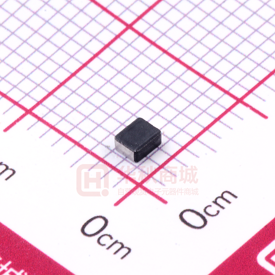

WIP252012P L Series Engineering Specification
1. Scope
Feature
High saturation current realized by material properties and structure design
Low DC resistance to achieve high conversion efficiency and lower temperature rising
Low Profile: 2.5 mm × 2.0 mm × 1.2 mm.
Magnetically shielded structure to accomplish high resolution in EMC protection.
Halogen free, Lead Free, RoHS Compliance.
Applications
WIP252012P L series is generic applied in portable DC to DC converter line.
Smart phone, PAD
DC/DC converter
Thin-type power supply module,
