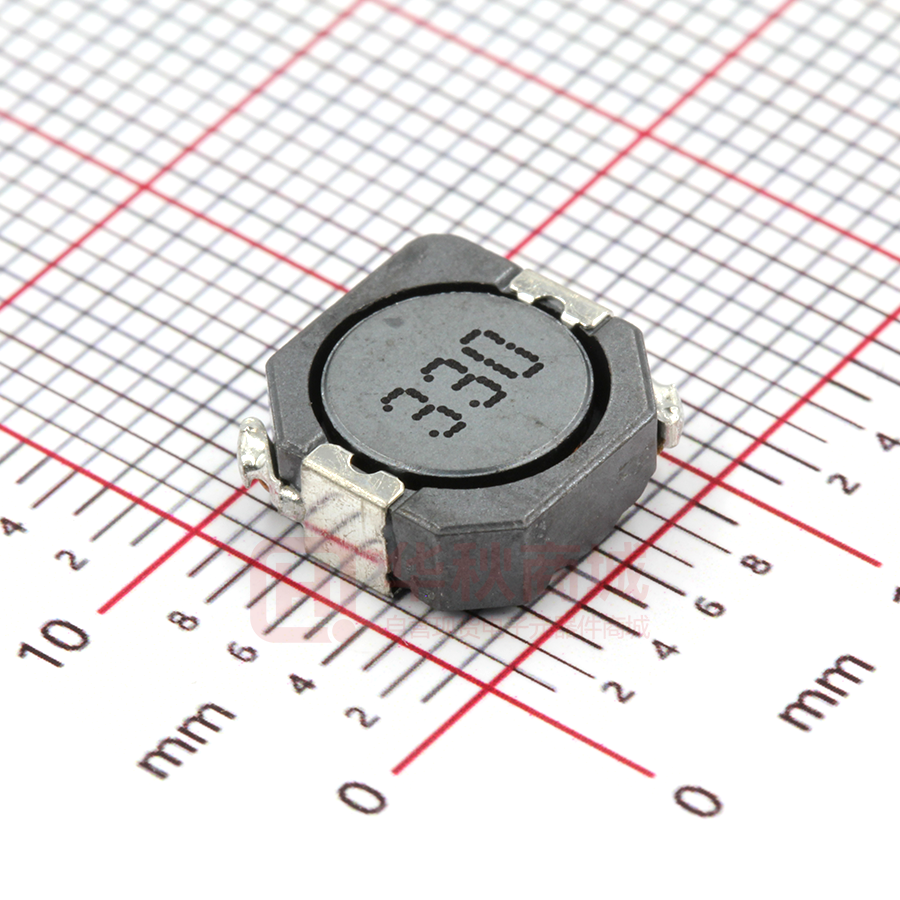

    功率电感 33µH ±20% IND_10.3X10.4MM_SM 4.00mm 10.30 x 10.40mm 93mΩ 2.2A
SMDRH104R-330MT 数据手册
MINIATURE SMD CHIP CHOKE COILS 闭 磁 路 贴 片 电 感 Shielded SMD Power Inductors O p e r a t i n g Te m p : - 3 0 ℃ ~ 8 0 ℃ 特征: EATURES:  直接连接电极在铁氧体磁心上。 ● Directly connected electrode on ferrite core.  理想的感应器是一个直流电的转换。 ● Ideal inductors for DC-DC conversion.  具有高功率,强力高饱和电感器。 ● High power,High saturation inductors.  具有抗电磁干扰。 ● With magnetic shield against radiation.  可利用的磁带和自动卷轴表面的设置。 ● Available on tape and reelfor auto surface mounting. APPLICATIONS: 用途:  录影机。 ● Power supply for VTRs.  液晶电视。 ● LCD televisions.  笔记本电脑。 ● Notebook PCs.  小型通信机器。 ● Portable communication equipment.  DC/DC 变压器之电源供应器等。 ● DC/Dc converters, etc. PRODUCT 产品型号: SMDRH 104R 470 ② ③ ① ① IDENTIFICATION: N T ④ ⑤ ② 类型 Type 闭磁路贴片电感 SMDRH ③ 外形尺寸(L×H) (mm) External Dimensions (L×W×H) (mm) Shielded SMT Power Inductors 104 ④ Inductance 47 uH 10.3×10.3×4.0 ⑤ 包装 Packing Tolerance J:±5%,K: ±10%, L: ±15% B 散装 Bulk Package M: ±20%,P: ±25%, N: ±30% T 编带Tape & Reel Shape and Size(Dimension are in mm): Part No A (max) B(max) C(max) D E F H I J SMDRH103R 10.3 10.4 3.0 7.7 3.0 1.2 3.6 1.7 7.3 SMDRH104R 10.3 10.4 4.0 7.7 3.0 1.2 3.6 1.7 7.3 SMDRH105R 103. 10.4 5.0 7.7 3.0 1.2 3.6 1.7 7.3 SMDRH103R Series ※31.0 MINIATURE SMD CHIP CHOKE COILS Inductance (uH) Quality Factor Nominal Value Tole. Test Freq. Spec. Min Test Freq. DCR (OHM) Max SMDRH103R -1R0N 1.0 N 100KHz 20 1MHz 0.009 6.50 SMDRH103R -1R5N 1.5 N 100KHz 20 1MHz 0.110 5.80 SMDRH103R -2R2N 2.2 N 100KHz 20 1MHz 0.017 5.10 SMDRH103R -3R3N 3.3 N 100KHz 20 1MHz 0.021 4.70 SMDRH103R -4R7N 4.7 N 100KHz 30 1MHz 0.030 4.00 SMDRH103R -6R8N 6.8 N 100KHz 30 1MHz 0.035 3.60 SMDRH103R -8R2N 8.2 N 100KHz 30 1MHz 0.050 3.00 SMDRH103R -100N 10 N 100KHz 35 1MHz 0.059 2.80 SMDRH103R -120N 12 N 100KHz 35 1MHz 0.072 2.25 SMDRH103R -150N 15 N 100KHz 35 1MHz 0. 091 2.05 SMDRH103R -180N 18 N 100KHz 35 1MHz 0.116 1.90 SMDRH103R -220N 22 N 100KHz 35 1MHz 0.145 1.60 SMDRH103R -270N 27 N 100KHz 35 1MHz 0.175 1.63 SMDRH103R -330N 33 N 100KHz 35 1MHz 0.213 1.16 SMDRH103R -390N 39 N 100KHz 35 1MHz 0.268 1.32 SMDRH103R -470N 47 N 100KHz 35 1MHz 0.298 1.18 SMDRH103R -560N 56 N 100KHz 35 1MHz 0.335 1.10 SMDRH103R -680N 68 N 100KHz 35 1MHz 0.451 1.04 SMDRH103R -820N 82 N 100KHz 35 1MHz 0.513 0.94 SMDRH103R -101N 100 N 100KHz 40 0.796MHz 0.700 0.84 SMDRH103R -121N 120 N 100KHz 40 0.796MHz 0.765 0.76 SMDRH103R -151N 150 N 100KHz 40 0.796MHz 0.876 0.70 Part No. Rated DC Current (Amp)Max SMDRH104R Series Inductance (uH) Quality Factor Nominal Value Tole. Test Freq. Spec. Min Test Freq. DCR (OHM) Max SMDRH104R -1R5N 1.5 N 100KHz 20 1MHz 0.008. 6.50 SMDRH104R -2R5N 2.5 N 100KHz 20 1MHz 0.011 6.10 SMDRH104R -3R3N 3.3 N 100KHz 20 1MHz 0.014 5.60 SMDRH104R -3R8N 3.8 N 100KHz 20 1MHz 0.018 5.50 SMDRH104R -4R7N 4.7 N 100KHz 30 1MHz 0.022 5.40 SMDRH104R -5R2N 5.2 N 100KHz 30 1MHz 0.022 5.40 SMDRH104R -7R0N 7.0 N 100KHz 30 1MHz 0.027 4.50 SMDRH104R -8R2N 8.2 N 100KHz 30 1MHz 0.030 4.10 SMDRH104R -100N 10 N 100KHz 35 1MHz 0.035 3.80 SMDRH104R -150N 15 N 100KHz 35 1MHz 0.050 3.10 SMDRH104R -220N 22 N 100KHz 35 1MHz 0.073 2.50 SMDRH104R -330N 33 N 100KHz 35 1MHz 0.093 2.20 Part No. Rated DC Current (Amp)Max ※32.0 MINIATURE SMD CHIP CHOKE COILS SMDRH104R -470N 47 N 100KHz 35 1MHz SMDRH104R -560N 56 N 100KHz 35 1MHz SMDRH104R -680N 68 N 100KHz 35 1MHz 0.213 1.42 SMDRH104R -820N 82 N 100KHz 35 1MHz 0.275 1.32 SMDRH104R -101N 100 N 100KHz 40 0.796MHz 0.304 1.25 SMDRH104R -151N 150 N 100KHz 40 0.796MHz 0.506 0.85 SMDRH104R -221M 220 M 100KHz 40 0.796MHz 0.756 0.70 SMDRH104R -331M 330 M 100KHz 40 0.796MHz 1.090 0.52 0.128 0.185 1.90 1.60 SMDRH105R Series Inductance (uH) Quality Factor Nominal Value Tole. Test Freq. Spec. Min Test Freq. DCR (OHM) Max SMDRH105R -3R3N 3.3 N 100KHz 20 1MHz 0.013 6.00 SMDRH105R -4R7N 4.7 N 100KHz 30 1MHz 0.016 5.70 SMDRH105R -6R8N 6.8 N 100KHz 30 1MHz 0.020 5.35 SMDRH105R -8R2N 8.2 N 100KHz 30 1MHz 0.023 5.00 SMDRH105R -100N 10 N 100KHz 35 1MHz 0.250 3.45 SMDRH105R -120N 12 N 100KHz 35 1MHz 0.032 3.40 SMDRH105R -150N 15 N 100KHz 35 1MHz 0.040 2.83 SMDRH105R -180N 18 N 100KHz 35 1MHz 0.046 2.62 SMDRH105R -220N 22 N 100KHz 35 1MHz 0.058 2.44 SMDRH105R -270N 27 N 100KHz 35 1MHz 0.650 2.24 SMDRH105R -330N 33 N 100KHz 35 1MHz 0.810 1.88 SMDRH105R -390N 39 N 100KHz 35 1MHz 0.103 1.70 SMDRH105R -470N 47 N 100KHz 35 1MHz 0.122 1.56 SMDRH105R -560N 56 N 100KHz 35 1MHz SMDRH105R -680N 68 N 100KHz 35 1MHz 0.193 1.36 SMDRH105R -820N 82 N 100KHz 35 1MHz 0.219 1.20 SMDRH105R -101N 100 N 100KHz 40 0.796MHz 0.247 1.09 SMDRH105R -121N 120 N 100KHz 40 0.796MHz 0.298 1.00 SMDRH105R -151N 150 N 100KHz 40 0.796MHz 0.355 0.91 SMDRH105R -181M 180 M 100KHz 40 0.796MHz 0.393 0.84 SMDRH105R -221M 220 M 100KHz 40 0.796MHz 0.483 0.75 SMDRH105R -271M 270 M 100KHz 40 0.796MHz 0.632 0.68 SMDRH105R -331M 330 M 100KHz 40 0.796MHz 0.780 0.60 SMDRH105R -391M 390 M 100KHz 40 0.796MHz 0.957 0.57 SMDRH105R -471M 470 M 100KHz 40 0.796MHz 1.220 0.50 SMDRH105R -561M 560 M 100KHz 40 0.796MHz 1.352 0.47 SMDRH105R -681M 680 M 100KHz 40 0.796MHz 1.519 0.43 SMDRH105R -821M 820 M 100KHz 40 0.796MHz 1.694 0.39 SMDRH105R -102M 1000 M 100KHz 40 0.796MHz 1.946 0.35 Part No. 0.144 Rated DC Current (Amp)Max 1.39 ※33.0
