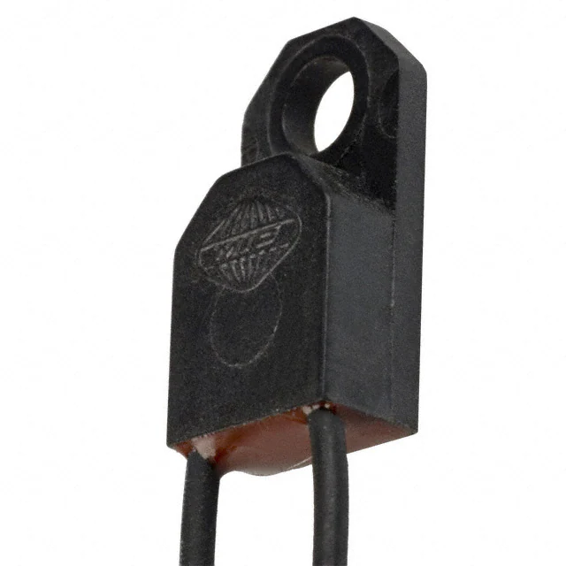

Encapsulated Thermostats for Electronics F20-E06 Formerly Called F11-E06 ADVANTAGES The miniature size, high switching capability and versatility of its contacts make the JEDEC TO-220 compatible device ideal for printed circuit board mounting. The F20-E06 is epoxy sealed to withstand wave soldering and board washing operations. APPLICATIONS The F20-E06 is ideal to sense the temperature of a surface or of stagnant air in an enclosure and can be supplied for mounting on a printed circuit board or with flexible wire leads for remote installation. Its high temperature resistance and high dielectric strength make it the favored device for protecting heatsinks. Heat sensitive semiconductors and other valuable equipment can be saved from thermal damage by shutting down the power or simply turning on a fan. Division of Microtherm International Corporation DESCRIPTION The CANTHERM F20-E06 has been designed to protect today’s technology and meet the requirements of tomorrow’s innovations. The F20 snap action bimetallic element will respond rapidly and accurately to changes in the temperature of the surface to which it is mounted or the air temperature in an enclosure. The single pole, single throw contacts can be configured as either normally open or normally closed, operating on rise in temperature. The average automatic reset will occur at a temperature approximately 20 - 25C below the calibrated set point. The housing has been designed for demanding conditions such as high continuous temperatures and high voltage electrical isolation. The PC version is supplied with TO-220 style stamped lead-frame leads and are shipped in a 50 piece plastic magazine for ease of insertion and handling. OPERATING TEMPERATURES The F20-E06 is available from 65ºC to 160ºC with either normally closed or normally open contacts. Increments are 5ºC and standard tolerance is ±5ºC. CONNECTIONS The F20-E06 is available for PC board mount or a variety of flexible wire leads. Standard leads are 6”, 24 AWG UL Black up to 3398 150ºC and UL1180 Teflon up to the maximum temperature. ADD “-PC” to the part number for solid pins or specify flexible lead type. Other wire types, gauges and lead lengths available upon request. 8415 Mountain Sights Avenue • Montreal (Quebec), H4P 2B8, Canada Tel: (514) 739-3274 • 1-800-561-7207 • Fax: (514) 739-2902 E-mail: sales@cantherm.com • Website: www.cantherm.com 2011/FEB Type Voltage Rating 50-60 Hz Current rating RESISTIVE INDUCTIVE F20A N/C F20B N/O 120 V / 250 V 120 V / 250 V 3.0 A / 2.0 A 1.8A / 1.2 A 1A/1A* 1A/1A 4.0 A 6.3 A 4.0 A 6.3 A max. load RES. short circuit current upto F20-E06-PC Contact Arrangment Normally closed N/C Normally open N/O Contact resistance < 40 mΩ < 40 mΩ 70ºC to 160ºC +65ºC to +150ºC +/- 15ºC, +/-10ºC, +/-5ºC +/- 15ºC, +/-10ºC, +/-5ºC 220ºC ** 175ºC 220ºC ** 175ºC Response temperature range Tolerance (minimum range) Max. permanent temperature - Housing Switch mechanism CURRENT SENSIVITY F20-E06 The thermostats are not current sensitive at rated currents. At loads above the rated values, up to maximum loading there is self-heating of the current carrying contacts. * When N/0 contacts are closed, self heating will occur at currents exceeding normal rating. It is possible that, given certain combinations of set temperature current & ambient temperature, the contacts will not reset. ** Wire insulation must be appropriate INSULATION RESISTANCE Leads to Earth 2500 V @ 25°C 1500 V @ 100°C On request up to 4000 V eff. AC @ 200°C (Requires special testing) Across open contacts, dependent on response temperature 500 V eff. AC RESPONSE TEMPERATURES, TOLERANCE Temperature stepped in 5°C increments. Special switch-off and reset temperatures available on request. Rate of temperature rise from 0.1° C/min. to max. 1.0° C/min. Insulation of the housing will slow down the cutout’s response. QUALITY ASSURANCE Housing material - PPS (UL 94 V-0) Contacts - Silver plated MTBF - 10,000 cycles at rated current and voltage Minimum switching current 50ma Random sample quality testing Function test to AQL 1.0 Nominal response temperature AQL 1.0 Measurement tolerance ±2°C AQL 4.0 Other values AQL 4.0 Thermal conductivity - 4.0 BTU In/hr/Ft2/ºF MARKING A = N/C B = N/O F20 A E06 12505 Housing Response Temperature & Tolerance 125ºC, ±5K Date Code & Factory 0409C April 2009, Country Canada ORDERING INFORMATION Quantity Type Version N/C or N/O Response Temp. Tolerance +/- 5ºC 100 F20 A or B 125º 05 We reserve the right to change specifications without prior notice. ADD - PC to part number for PC lead frame leads. Typical PC P/N = F20A125053600060 With Leads P/N = F20A12505ACFA06E UL E46827 VDE 4523-4510-1015 It is the responsibility of the customer to insure that the devices descibed above are used in a safe manner and within published parameters.

物料型号:F20-E06,曾用名F11-E06。
器件简介:F20-E06是一款小型尺寸、高切换能力、多功能触点的JEDEC TO-220兼容封装的电子温控器。它采用环氧树脂密封,能够承受波峰焊和板洗操作。
引脚分配:该元件采用TO-220风格的引脚框架引脚,适用于PCB板安装。
参数特性: - 工作温度范围:65°C至160°C,增量为5°C,标准公差为±5°C。 - 额定电压:50-60Hz下,F20A和F20B型号均为120V/250V。 - 电流额定值:F20A型号为3.0A/2.0A(电阻性/电感性),F20B型号为1A/1A(电阻性/电感性)。 - 触点配置:单刀单掷,可配置为常开或常闭,随温度上升而动作。 - 响应温度范围:F20A为70°C至160°C,F20B为65°C至150°C。 - 绝缘电阻:在25°C时2500V,100°C时1500V,200°C时可达4000V有效值交流电。
功能详解:F20-E06设计用于保护现代技术并满足未来创新的需求。其双金属元件能够快速准确地响应其安装表面或封闭空间内空气温度的变化。平均自动复位温度大约在设定点以下20-25°C。
应用信息:F20-E06适用于感应表面温度或封闭空间内的静止空气温度,可安装在PCB上或使用软线进行远程安装。其高耐温和高介电强度使其成为保护散热器的首选设备,可以防止热敏半导体和其他贵重设备因热损伤而关闭电源或启动风扇。
封装信息:PC版本提供TO-220风格的冲压引脚框架引脚,以50件塑料杂志形式发货,便于插入和处理。
质量保证:外壳材料为PPS(UL 94 V-0),触点为镀银。MTBF(平均故障间隔时间)为在额定电流和电压下的10000个周期。随机样本质量测试符合UL E46827标准,RoHS合规产品。
