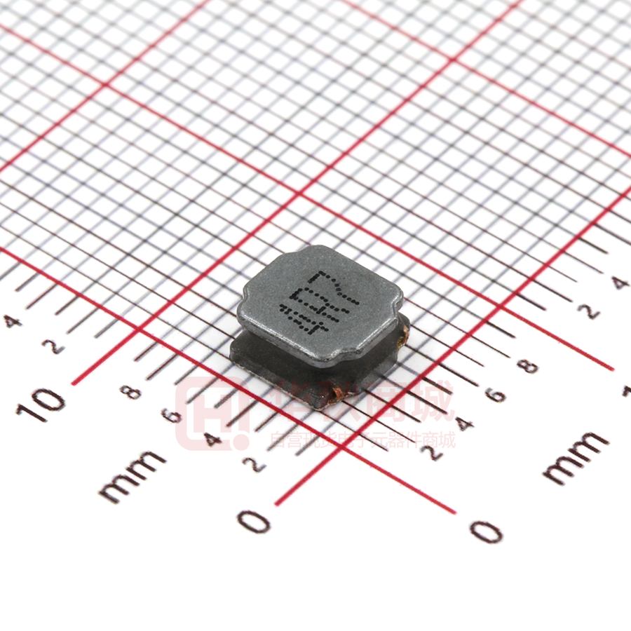

    功率电感 4.7µH ±20% IND_6X6MM_SM 2.80mm 6.00 x 6.00mm 31mΩ 2.7A
