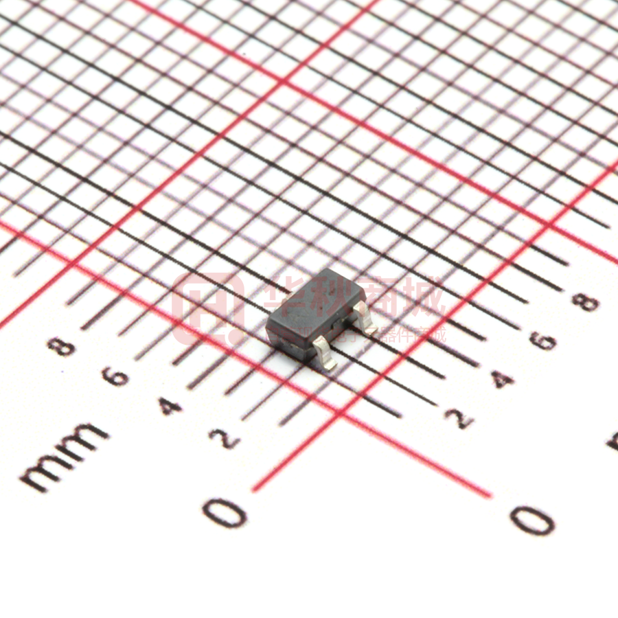

PMST3904
NPN switching transistor
Product data sheet
Supersedes data of 1999 Apr 22
2004 Jan 21
NXP Semiconductors
Product data sheet
PMST3904
FEATURES
QUICK REFERENCE DATA
• Collector current capability IC = 200 mA
SYMBOL
• Collector-emitter voltage VCEO = 40 V.
PARAMETER
MAX.
UNIT
VCEO
collector-emitter voltage
40
V
IC
collector current (DC)
200
mA
APPLICATIONS
• General amplification and switching.
PINNING
PIN
DESCRIPTION
NPN switching transistor in a SOT323 plastic package.
PNP complement: PMST3906.
DESCRIPTION
1
base
2
emitter
3
collector
MARKING
TYPE NUMBER
3
handbook, halfpage
MARKING CODE(1)
3
∗1A
PMST3904
Note
1
1. ∗ = p: Made in Hong Kong.
2
∗ = t: Made in Malaysia.
1
∗ = W: Made in China.
Top view
2
MAM062
Fig.1 Simplified outline (SOT323) and symbol.
