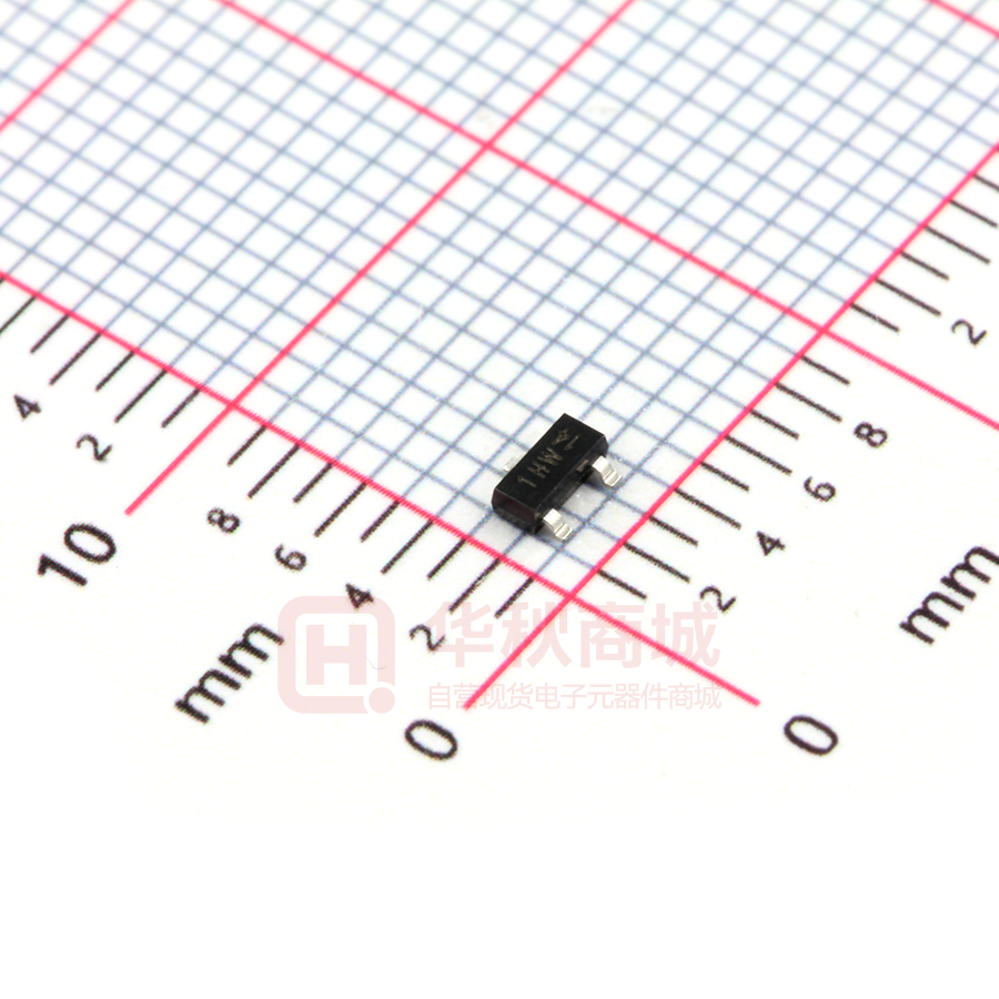

    通用三极管 45V 100mA NPN SOT23 110~800
BC847,215 数据手册
BC847 series 45 V, 100 mA NPN general-purpose transistors Rev. 11 — 5 December 2018 1 Product data sheet Product profile 1.1 General description NPN general-purpose transistors in a small SOT23 (TO-236AB), very small SOT323 (SC-70) or ultra small SOT883 (DFN1006-3) Surface-Mounted Device (SMD) plastic package. Table 1. Product overview [1] Type number BC847 Package Nexperia JEITA JEDEC SOT23 - TO-236AB NPN complement BC857 BC847A BC857A BC847B BC857B BC847C BC857C BC847W SOT323 SC-70 - BC857W BC847AW BC857AW BC847BW BC857BW BC847CW BC857CW BC847AM SOT883 SC-101 - BC857AM BC847BM BC857BM BC847CM BC857CM [1] Valid for all available selection groups. 1.2 Features and benefits • • • • General-purpose transistors SMD plastic packages Three different gain selections AEC-Q101 qualified 1.3 Applications • General-purpose switching and amplification BC847 series Nexperia 45 V, 100 mA NPN general-purpose transistors 1.4 Quick reference data Table 2. Quick reference data Tamb = 25 °C unless otherwise specified. 2 Symbol Parameter Conditions Min Typ Max Unit VCEO collector-emitter voltage open base - - 45 V IC collector current - - 100 mA hFE DC current gain 110 - 800 hFE group A 110 180 220 hFE group B 200 290 450 hFE group C 420 520 800 VCE = 5 V; IC = 2 mA Pinning information Table 3. Pinning information Pin Symbol Descrition 1 B base 2 E emitter 3 C collector Simlified outline Graphic symbol SOT23; SOT323 3 C B E 1 2 sym123 SOT883 1 B base 2 E emitter 1 3 C collector 2 C 3 Transparent top view B E sym123 BC847_SER Product data sheet All information provided in this document is subject to legal disclaimers. Rev. 11 — 5 December 2018 © Nexperia B.V. 2018. All rights reserved. 2 / 18 BC847 series Nexperia 45 V, 100 mA NPN general-purpose transistors 3 Ordering information Table 4. Ordering information Type number BC847 Package Name Description Version TO-236AB plastic surface-mounted package; 3 leads SOT23 BC847A BC847B BC847C BC847W SC-70 SOT323 BC847AW BC847BW BC847CW BC847AM SC-101 BC847BM lesdless ultra small plastic package; 3 solder lands; body 1.0 x 0.6 x 0.5 mm SOT 883 BC847CM 4 Marking Table 5. Marking codes Type number Marking code BC847 [1] 1H% BC847A [1] 1E% BC847B [1] 1F% BC847C [1] 1G% BC847W [1] 1H% BC847AW [1] 1E% BC847BW [1] 1F% BC847CW [1] 1G% BC847AM D4 BC847BM D5 BC847CM D6 [1] % = placeholder for manufacturing site code BC847_SER Product data sheet All information provided in this document is subject to legal disclaimers. Rev. 11 — 5 December 2018 © Nexperia B.V. 2018. All rights reserved. 3 / 18 BC847 series Nexperia 45 V, 100 mA NPN general-purpose transistors 5 Limiting values Table 6. Limiting values In accordance with the Absolute Maximum Rating System (IEC 60134). Symbol Parameter Conditions Min Max Unit VCBO collector-base voltage open emitter - 50 V VCEO collector-emitter voltage open base - 45 V VEBO emitter-base voltage open collector - 6 V IC collector current - 100 mA ICM peak collector current single pulse; tp ≤ 1 ms - 200 mA IBM peak base current single pulse; tp ≤ 1 ms - 100 mA Ptot total power dissipation Tamb ≤ 25 °C SOT23 [1] - 250 mW SOT323 [1] - 200 mW SOT883 [2] - 250 mW Tj junction temperature - 150 °C Tamb ambient temperature -65 150 °C Tstg storage temperature -65 150 °C [1] Device mounted on an FR4 Printed-Circuit-Board (PCB); single-sided copper; tin-plated and standard footprint. [2] Device mounted on an PCB with 60 μm copper strip line, standard footprint. 6 Thermal characteristics Table 7. Thermal characteristics Symbol Parameter Conditions Rth(j-a) thermal resistance from junction to ambient in free air Min Typ Max Unit SOT23 [1] - - 500 K/W SOT323 [1] - - 625 K/W SOT883 [2] - - 500 K/W [1] Device mounted on an FR4 PCB; single-sided copper; tin-plated and standard footprint. [2] Device mounted on an PCB with 60 μm copper strip line, standard footprint. BC847_SER Product data sheet All information provided in this document is subject to legal disclaimers. Rev. 11 — 5 December 2018 © Nexperia B.V. 2018. All rights reserved. 4 / 18 BC847 series Nexperia 45 V, 100 mA NPN general-purpose transistors aaa-028968 103 duty cycle = 1 Zth(j-a) (K/W) 0.5 102 0.75 0.33 0.2 0.1 0.05 10 0.02 0.01 0 1 10-5 10-4 10-3 10-2 10-1 1 10 102 tp (s) 103 FR4 PCB; single-sided copper; tin-plated and standard footprint Figure 1. SOT23: Transient thermal impedance from junction to ambient as a function of pulse duration; typical values 103 aaa-028969 duty cycle = Zth(j-a) (K/W) 102 1 0.5 0.75 0.33 0.2 0.1 0.05 10 0.02 0.01 0 1 10-5 10-4 10-3 10-2 10-1 1 10 102 tp (s) 103 FR4 PCB; single-sided copper; tin-plated and standard footprint Figure 2. SOT323: Transient thermal impedance from junction to ambient as a function of pulse duration; typical values BC847_SER Product data sheet All information provided in this document is subject to legal disclaimers. Rev. 11 — 5 December 2018 © Nexperia B.V. 2018. All rights reserved. 5 / 18 BC847 series Nexperia 45 V, 100 mA NPN general-purpose transistors 103 Zth(j-a) (K/W) 102 006aab603 duty cycle = 1 0.5 0.75 0.33 0.2 0.1 0.05 10 0.02 0.01 0 1 10-5 10-4 10-3 10-2 10-1 1 10 102 tp (s) 103 FR4 PCB; single-sided copper; tin-plated and standard footprint Figure 3. SOT883: Transient thermal impedance from junction to ambient as a function of pulse duration; typical values BC847_SER Product data sheet All information provided in this document is subject to legal disclaimers. Rev. 11 — 5 December 2018 © Nexperia B.V. 2018. All rights reserved. 6 / 18 BC847 series Nexperia 45 V, 100 mA NPN general-purpose transistors 7 Characteristics Table 8. Characteristics Tamb = 25 °C unless otherwise specified. Symbol Parameter Conditions Min Typ Max Unit V(BR)CBO collector-base breakdown voltage IC = 100 µA; IE = 0 A 50 - - V V(BR)CES collector-emitter breakdown voltage IC = 2 mA; VBE = 0 A 45 - - V V(BR)EBO emitter-base breakdown voltage IC = 0 A; IE = 100 µA 6 - - V ICBO collector-base cut-off current VCB = 30 V; IE = 0 A - - 15 nA VCB = 30 V; IE = 0 A; Tj = 150 °C - - 5 μA IEBO emitter-base cut-off current VEB = 5 V; IC = 0 A - - 100 nA hFE DC current gain VCE = 5 V; IC = 10 μA hFE group A - 170 - hFE group B - 280 - hFE group C - 420 - 110 - 800 hFE group A 110 180 220 hFE group B 200 290 450 hFE group C 420 520 800 DC current gain VCEsat VBEsat VBE collector-emitter saturation voltage VCE = 5 V; IC = 2 mA IC = 10 mA; IB = 0.5 mA - 90 200 mV [1] - 200 400 mV base-emitter saturation IC = 10 mA; IB = 0.5 mA voltage IC = 100 mA; IB = 5 mA [2] - 700 - mV [2] - 900 - mV base-emitter voltage [2] 580 660 700 mV VCE = 5 V; IC = 10 mA - - 770 mV IC = 100 mA; IB = 5 mA VCE = 5 V; IC = 2 mA fT transition frequency VCE = 5 V; IC = 10 mA; f = 100 MHz 100 - - MHz Cc collector capacitance VCB = 10 V; IE = ie = 0 A; f = 1 MHz - - 1.5 pF Ce emitter capacitance VEB = 0.5 V; IC = ic = 0 A; f = 1 MHz - 11 - pF NF noise figure IC = 200 μA; VCE = 5 V; RS = 2 kΩ; f = 1 kHz; B = 200Hz - 2 10 dB [1] pulsed; tp ≤ 300 μs; δ ≤ 0.02 [2] VBE decreases by approximately 2 mV/K with increasing temperature BC847_SER Product data sheet All information provided in this document is subject to legal disclaimers. Rev. 11 — 5 December 2018 © Nexperia B.V. 2018. All rights reserved. 7 / 18 BC847 series Nexperia 45 V, 100 mA NPN general-purpose transistors mgt723 400 hFE (1) 300 mgt724 1200 VBE (mV) 1000 (1) 800 (2) (2) 200 600 100 (3) 400 (3) 200 0 10- 1 1 10 102 I C (mA) 103 0 10- 1 1 10 102 I C (mA) 103 VCE = 5 V (1) Tamb = 150 °C (2) Tamb = 25 °C (3) Tamb = -55 °C VCE = 5 V (1) Tamb = -55 °C (2) Tamb = 25 °C (3) Tamb = 150 °C Figure 4. Group A: DC current gain as a function of collector current; typical values Figure 5. Group A: Base-emitter voltage as a function of collector current; typical values mgt725 103 VCEsat (mV) mgt726 1200 VBEsat (mV) 1000 (1) 800 102 (2) 600 (1) (3) (2) 400 (3) 200 10 10- 1 1 10 102 I C (mA) 103 0 10- 1 1 10 102 I C (mA) 103 IC/IB = 20 (1) Tamb = 150 °C (2) Tamb = 25 °C (3) Tamb = -55 °C IC/IB = 10 (1) Tamb = -55 °C (2) Tamb = 25 °C (3) Tamb = 150 °C Figure 6. Group A: Collector-emitter saturation voltage as a function of collector current; typical values Figure 7. Group A: Base-emitter saturation voltage as a function of collector current; typical values BC847_SER Product data sheet All information provided in this document is subject to legal disclaimers. Rev. 11 — 5 December 2018 © Nexperia B.V. 2018. All rights reserved. 8 / 18 BC847 series Nexperia 45 V, 100 mA NPN general-purpose transistors mgt727 600 hFE 500 400 mgt728 1200 VBE (mV) 1000 (1) 800 (1) (2) 300 600 (2) 200 (3) 100 0 10-1 (3) 400 1 10 200 102 I C (mA) 103 0 10- 2 10- 1 1 10 102 103 I C (mA) VCE = 5 V (1) Tamb = 150 °C (2) Tamb = 25 °C (3) Tamb = -55 °C VCE = 5 V (1) Tamb = -55 °C (2) Tamb = 25 °C (3) Tamb = 150 °C Figure 8. Group B: DC current gain as a function of collector current; typical values Figure 9. Group B: Base-emitter voltage as a function of collector current; typical values mgt729 104 VCEsat (mV) mgt730 1200 VBEsat (mV) 1000 (1) 103 800 (2) 600 (3) 102 400 (1) 200 (3) (2) 10 10- 1 IC/IB = 20 (1) Tamb = 150 °C (2) Tamb = 25 °C (3) Tamb = -55 °C 1 10 102 I C (mA) 103 0 10- 1 1 10 102 I C (mA) 103 IC/IB = 10 (1) Tamb = -55 °C (2) Tamb = 25 °C (3) Tamb = 150 °C Figure 10. Group B: Collector-emitter saturation voltage Figure 11. Group B: Base-emitter saturation voltage as a function of collector current; typical values as a function of collector current; typical values BC847_SER Product data sheet All information provided in this document is subject to legal disclaimers. Rev. 11 — 5 December 2018 © Nexperia B.V. 2018. All rights reserved. 9 / 18 BC847 series Nexperia 45 V, 100 mA NPN general-purpose transistors mgt731 1200 hFE 1000 (1) 800 (1) 800 (2) (2) 600 400 600 (3) 400 (3) 200 0 10- 1 mgt732 1200 VBE (mV) 1000 200 1 10 102 I C (mA) 103 0 10- 2 10- 1 1 10 102 103 I C (mA) VCE = 5 V (1) Tamb = 150 °C (2) Tamb = 25 °C (3) Tamb = -55 °C VCE = 5 V (1) Tamb = -55 °C (2) Tamb = 25 °C (3) Tamb = 150 °C Figure 12. Group C: DC current gain as a function of collector current; typical values Figure 13. Group C: Base-emitter voltage as a function of collector current; typical values mgt733 104 VCEsat (mV) mgt734 1200 VBEsat (mV) 1000 (1) 103 800 (2) 600 (3) 102 400 (1) 200 (3) (2) 10 10- 1 IC/IB = 20 (1) Tamb = 150 °C (2) Tamb = 25 °C (3) Tamb = -55 °C 1 10 102 I C (mA) 103 0 10- 1 1 10 102 I C (mA) 103 IC/IB = 10 (1) Tamb = -55 °C (2) Tamb = 25 °C (3) Tamb = 150 °C Figure 14. Group C: Collector-emitter saturation voltage Figure 15. Group C: Base-emitter saturation voltage as a function of collector current; typical values as a function of collector current; typical values BC847_SER Product data sheet All information provided in this document is subject to legal disclaimers. Rev. 11 — 5 December 2018 © Nexperia B.V. 2018. All rights reserved. 10 / 18 BC847 series Nexperia 45 V, 100 mA NPN general-purpose transistors 8 Test information 8.1 Quality information This product has been qualified in accordance with the Automotive Electronics Council (AEC) standard Q101 - Stress test qualification for discrete semiconductors, and is suitable for use in automotive applications. 9 Package outline Table 9. Package outline 3.0 2.8 1.1 0.9 3 0.45 0.15 2.5 1.4 2.1 1.2 1 2 0.48 0.38 1.9 0.15 0.09 Dimensions in mm 04-11-04 Figure 16. Package outline SOT23 (TO-236AB) 2.2 1.8 1.1 0.8 0.45 0.15 3 2.2 1.35 2.0 1.15 1 2 1.3 0.4 0.3 0.25 0.10 Dimensions in mm 04-11-04 Figure 17. Package outline SOT323 (SC-70) BC847_SER Product data sheet All information provided in this document is subject to legal disclaimers. Rev. 11 — 5 December 2018 © Nexperia B.V. 2018. All rights reserved. 11 / 18 BC847 series Nexperia 45 V, 100 mA NPN general-purpose transistors 0.62 0.55 0.55 0.47 0.50 0.46 3 0.30 0.22 0.65 0.30 0.22 2 0.20 0.12 1.02 0.95 1 0.35 Dimensions in mm 03-04-03 Figure 18. Package outline SOT883 (SC-101) BC847_SER Product data sheet All information provided in this document is subject to legal disclaimers. Rev. 11 — 5 December 2018 © Nexperia B.V. 2018. All rights reserved. 12 / 18 BC847 series Nexperia 45 V, 100 mA NPN general-purpose transistors 10 Soldering Table 10. Soldering 3.3 2.9 1.9 solder lands 3 solder resist 2 1.7 solder paste occupied area 0.6 (3×) 0.7 (3×) Dimensions in mm 0.5 (3×) 0.6 (3×) 1 sot023_fr Figure 19. Reflow soldering footprint SOT23 (TO-236AB) 2.2 1.2 (2×) 1.4 (2×) solder lands 4.6 solder resist 2.6 occupied area Dimensions in mm 1.4 preferred transport direction during soldering 2.8 4.5 sot023_fw Figure 20. Wave soldering footprint SOT23 (TO-236AB) BC847_SER Product data sheet All information provided in this document is subject to legal disclaimers. Rev. 11 — 5 December 2018 © Nexperia B.V. 2018. All rights reserved. 13 / 18 BC847 series Nexperia 45 V, 100 mA NPN general-purpose transistors 2.65 1.85 1.325 solder lands solder resist 2 2.35 0.6 (3×) 3 solder paste 1.3 occupied area 0.5 (3×) 1 Dimensions in mm 0.55 (3×) sot323_fr Figure 21. Reflow soldering footprint SOT323 (SC-70) 4.6 2.575 1.425 (3×) solder lands solder resist occupied area 1.8 3.65 2.1 09 (2×) Dimensions in mm preferred transport direction during soldering sot323_fw Figure 22. Wave soldering footprint SOT323 (SC-70) 1.3 0.7 R0.05 (12×) solder lands 0.9 0.6 0.7 solder resist solder paste 0.25 (2×) occupied area 0.3 (2×) 0.3 0.4 (2×) 0.4 Dimensions in mm sot883_fr Figure 23. Reflow soldering footprint SOT883 (SC-101) BC847_SER Product data sheet All information provided in this document is subject to legal disclaimers. Rev. 11 — 5 December 2018 © Nexperia B.V. 2018. All rights reserved. 14 / 18 BC847 series Nexperia 45 V, 100 mA NPN general-purpose transistors 11 Revision history Table 11. Revision history Document ID Release date Data sheet status Change notice Supersedes BC847_SER v.11 20181205 - BC847_SER v.10 Modifications: • General description: missing packages added • Marking: Last type name BC847CW is changed to correct BC847CM • Thermal graphs added BC847_SER v.10 20180302 Product data sheet - BC847_SER v.9 BC847_SER v.9 20140923 Product data sheet - BC847_SER v.8 BC847_SER v.8 20120820 Product data sheet - BC847_BC547_SER v.7 BC847_BC547_SER v.7 20081210 Product data sheet - BC847_BC547_SER v.6 BC847_BC547_SER v.6 20050519 Product data sheet - - BC847_SER Product data sheet Product data sheet All information provided in this document is subject to legal disclaimers. Rev. 11 — 5 December 2018 © Nexperia B.V. 2018. All rights reserved. 15 / 18 BC847 series Nexperia 45 V, 100 mA NPN general-purpose transistors 12 Legal information 12.1 Data sheet status Document status [1][2] Product status [3] Definition Objective [short] data sheet Development This document contains data from the objective specification for product development. Preliminary [short] data sheet Qualification This document contains data from the preliminary specification. Product [short] data sheet Production This document contains the product specification. [1] [2] [3] Please consult the most recently issued document before initiating or completing a design. The term 'short data sheet' is explained in section "Definitions". The product status of device(s) described in this document may have changed since this document was published and may differ in case of multiple devices. The latest product status information is available on the Internet at URL http://www.nexperia.com. 12.2 Definitions Draft — The document is a draft version only. The content is still under internal review and subject to formal approval, which may result in modifications or additions. Nexperia does not give any representations or warranties as to the accuracy or completeness of information included herein and shall have no liability for the consequences of use of such information. Short data sheet — A short data sheet is an extract from a full data sheet with the same product type number(s) and title. A short data sheet is intended for quick reference only and should not be relied upon to contain detailed and full information. For detailed and full information see the relevant full data sheet, which is available on request via the local Nexperia sales office. In case of any inconsistency or conflict with the short data sheet, the full data sheet shall prevail. Product specification — The information and data provided in a Product data sheet shall define the specification of the product as agreed between Nexperia and its customer, unless Nexperia and customer have explicitly agreed otherwise in writing. In no event however, shall an agreement be valid in which the Nexperia product is deemed to offer functions and qualities beyond those described in the Product data sheet. 12.3 Disclaimers Limited warranty and liability — Information in this document is believed to be accurate and reliable. However, Nexperia does not give any representations or warranties, expressed or implied, as to the accuracy or completeness of such information and shall have no liability for the consequences of use of such information. Nexperia takes no responsibility for the content in this document if provided by an information source outside of Nexperia. In no event shall Nexperia be liable for any indirect, incidental, punitive, special or consequential damages (including - without limitation lost profits, lost savings, business interruption, costs related to the removal or replacement of any products or rework charges) whether or not such damages are based on tort (including negligence), warranty, breach of contract or any other legal theory. Notwithstanding any damages that customer might incur for any reason whatsoever, Nexperia's aggregate and cumulative liability towards customer for the products described herein shall be limited in accordance with the Terms and conditions of commercial sale of Nexperia. Right to make changes — Nexperia reserves the right to make changes to information published in this document, including without limitation specifications and product descriptions, at any time and without notice. This document supersedes and replaces all information supplied prior to the publication hereof. or warranty that such applications will be suitable for the specified use without further testing or modification. Customers are responsible for the design and operation of their applications and products using Nexperia products, and Nexperia accepts no liability for any assistance with applications or customer product design. It is customer’s sole responsibility to determine whether the Nexperia product is suitable and fit for the customer’s applications and products planned, as well as for the planned application and use of customer’s third party customer(s). Customers should provide appropriate design and operating safeguards to minimize the risks associated with their applications and products. Nexperia does not accept any liability related to any default, damage, costs or problem which is based on any weakness or default in the customer’s applications or products, or the application or use by customer’s third party customer(s). Customer is responsible for doing all necessary testing for the customer’s applications and products using Nexperia products in order to avoid a default of the applications and the products or of the application or use by customer’s third party customer(s). Nexperia does not accept any liability in this respect. Limiting values — Stress above one or more limiting values (as defined in the Absolute Maximum Ratings System of IEC 60134) will cause permanent damage to the device. Limiting values are stress ratings only and (proper) operation of the device at these or any other conditions above those given in the Recommended operating conditions section (if present) or the Characteristics sections of this document is not warranted. Constant or repeated exposure to limiting values will permanently and irreversibly affect the quality and reliability of the device. Terms and conditions of commercial sale — Nexperia products are sold subject to the general terms and conditions of commercial sale, as published at http://www.nexperia.com/profile/terms, unless otherwise agreed in a valid written individual agreement. In case an individual agreement is concluded only the terms and conditions of the respective agreement shall apply. Nexperia hereby expressly objects to applying the customer’s general terms and conditions with regard to the purchase of Nexperia products by customer. No offer to sell or license — Nothing in this document may be interpreted or construed as an offer to sell products that is open for acceptance or the grant, conveyance or implication of any license under any copyrights, patents or other industrial or intellectual property rights. Suitability for use in automotive applications — This Nexperia product has been qualified for use in automotive applications. Unless otherwise agreed in writing, the product is not designed, authorized or warranted to be suitable for use in life support, life-critical or safety-critical systems or equipment, nor in applications where failure or malfunction of an Nexperia product can reasonably be expected to result in personal injury, death or severe property or environmental damage. Nexperia and its suppliers accept no liability for inclusion and/or use of Nexperia products in such equipment or applications and therefore such inclusion and/or use is at the customer's own risk. Applications — Applications that are described herein for any of these products are for illustrative purposes only. Nexperia makes no representation BC847_SER Product data sheet All information provided in this document is subject to legal disclaimers. Rev. 11 — 5 December 2018 © Nexperia B.V. 2018. All rights reserved. 16 / 18 BC847 series Nexperia 45 V, 100 mA NPN general-purpose transistors Quick reference data — The Quick reference data is an extract of the product data given in the Limiting values and Characteristics sections of this document, and as such is not complete, exhaustive or legally binding. Export control — This document as well as the item(s) described herein may be subject to export control regulations. Export might require a prior authorization from competent authorities. Translations — A non-English (translated) version of a document is for reference only. The English version shall prevail in case of any discrepancy between the translated and English versions. 12.4 Trademarks Notice: All referenced brands, product names, service names and trademarks are the property of their respective owners. BC847_SER Product data sheet All information provided in this document is subject to legal disclaimers. Rev. 11 — 5 December 2018 © Nexperia B.V. 2018. All rights reserved. 17 / 18 BC847 series Nexperia 45 V, 100 mA NPN general-purpose transistors Contents 1 1.1 1.2 1.3 1.4 2 3 4 5 6 7 8 8.1 9 10 11 12 Product profile .................................................... 1 General description ............................................1 Features and benefits ........................................1 Applications ........................................................1 Quick reference data ......................................... 2 Pinning information ............................................ 2 Ordering information .......................................... 3 Marking .................................................................3 Limiting values .................................................... 4 Thermal characteristics ......................................4 Characteristics .................................................... 7 Test information ................................................ 11 Quality information ...........................................11 Package outline .................................................11 Soldering ............................................................13 Revision history ................................................ 15 Legal information .............................................. 16 Please be aware that important notices concerning this document and the product(s) described herein, have been included in section 'Legal information'. © Nexperia B.V. 2018. All rights reserved. For more information, please visit: http://www.nexperia.com For sales office addresses, please send an email to: salesaddresses@nexperia.com Date of release: 5 December 2018 Document identifier: BC847_SER
