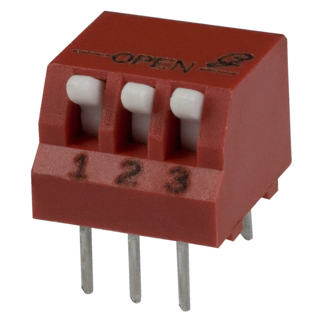

    SWITCH PIANO DIP SPST 150MA 30V
76PSB03T 数据手册
Thru-Hole DIP Switches Series 76 SPST Rocker DIMENSIONS DIP Switches FEATURES • Raised and Recessed, Rocker and PIANO-DIP® Styles • Sealed Base Standard • Spring and Ball Contact • Top Tape Seal Option in inches (and millimeters) Rocker and Recessed Rocker PIANO-DIP® End Views 1 2 3 4 5 6 .020 + .005 –.000 (0,51 + 0,13) LENGTH ± .010 (±0,25) SEE ORDER INFO. LENGTH ± .010 (±0,25) SEE ORDER INFO. .281 ± .010 (7,14 ± 0,25) TYP. B 7 .380 ± .010 (9,65 ± 0,25) .380 ± .010 (9,65 ± 0,25) OPEN CL Rocker OPEN 1 .090 ± .005 (2,29 ± 0,13) .020 ± .002 (0,51 ± 0,05) .100 ± .005 (2,5 ± 0,13) 2 3 4 5 6 7 CL .012 ± .001 (0,30 ± 0,03) .300 + .030 –.000 (7,62 + 0,76) A = .272 ± .010 (6,91 ± 0,25) 8 .020 + .005 –.000 (0,51 + 0,13) A .090 ± .005 (2,29 ± 0,13) .020 ± .002 (0,51 ± 0,05) See also end view. B = .156 ± .010 (3,96 ± 0,25) TYPICAL .295 + .000 –.020 (7,49 –0,51) .100 ± .005 (2,5 ± 0,13) .156 ± .010 (3,96 ± 0,25) TYP. CL CL .012 ± .001 (0,30 ± 0,03) .300 + .030 –.000 (7,62 + 0,76) For recessed rockers, delete .295 dimension. See also end view. circuitry Styles 76SB and 76RSB Typical circuit diagram with actuator in the closed position. Style 76PSB Styles 76PRB UP IS OPEN (OFF) UP IS CLOSED (ON) Actuator shown in the down position. Actuator shown in the down position. Ordering Information Series Switch Style: SB = Raised Rocker RSB = Recessed Rocker PSB = Piano-DIP (Up is Off) PRB = Piano-DIP (Up is On) 76RSB04ST T = RoHS compliant Sealed*: S = Tape Seal Number of Positions: 02 through 10, 12 *A top tape seal is required for switches that are machine soldered or heavily cleaned after hand soldering. To order top seal versions, add "S" to the Grayhill part number. No. of Pos. 2 3 4 5 6 7 8 9 10 12 Length (Inches) 0.280" 0.380" 0.480" 0.580" 0.680" 0.780" 0.880" 0.980" 1.080" 1.280" Length (Metric) No./Tube 7,1 mm 9,7 mm 12,2 mm 14,7 mm 17,3 mm 19,8 mm 22,4 mm 24,9 mm 27,4 mm 32,5 mm 35 27 21 18 15 13 12 10 9 8 Available from your local Grayhill Distributor. For prices and discounts, contact a local Sales Office, an authorized local Distributor or Grayhill. Grayhill, Inc. • 561 Hillgrove Avenue • LaGrange, Illinois 60525-5997 • USA • Phone: 708-354-1040 • Fax: 708-354-2820 • www.grayhill.com Thru-Hole DIP Switches Specifications: Standard Styles Ratings 78 90B 2,000 2,000 2,000 Make-and-break Current Rating: Operations per switch position at these resistive loads 1 mA, 5 Vdc; 50 mA, 30 Vdc; or 150 mA, 30 Vdc: 10 mA, 30 Vdc; or 10 mA, 50 mVdc: 10 mA, 50 mVdc; or 25 mA, 24 Vdc; or 100 mA, 6 Vdc: 2,000 — — 2,000 — — — 2,000 2,000 ≤ 30 mΩ ≤ 100 mΩ ≤ 30 mΩ ≤ 100 mΩ ≤ 20 mΩ ≤ 100 mΩ Insulation Resistance: Minimum, at 100 Vdc between adjacent closed contacts and also across open switch contacts Initially (Mohms): After life (Mohms): 5,000 1,000 5,000 1,000 5,000 1,000 Dielectric Strength: Minimum voltage (AC, RMS) measured between adjacent closed contacts and also across open switch contacts. lnitially: After life: 750 V 500 V 750 V 500 V 500 V 500 V Contact Resistance: Initially: After life, at 10 mA, 50 mVdc, open circuit: Current Carry Rating: Maximum rise of 20°C 5 A 4 A 3A Switch Capacitance: At 1 megahertz 2 pF 2 pF 2 pF Operating Temperature Range: -40°C to + 85°C -40°C to + 85°C -40°C to + 85°C Storage Temperature Range: -55°C to + 85°C -55°C to + 85°C -55°C to + 85°C Mechanical Ratings Vibration Resistance: Per Method 204, Test Condition B, 1 mS opening (10 mS allowed) Mechanical Shock: Per Method 213, Test Condition A. 1 mS opening (10 mS allowed) Thermal Shock Resistance: Per specification; no failures; passes contact resistance. Terminal Strength: Per specification Thermal Aging: 1,000 hours at 85°C; no failures. Environmental Ratings Meets all requirements of MIL- S-83504.** Where Grayhill performance is superior, the MIL spec is listed in parentheses. Moisture Resistance: Per MIL-STD-202, Method 106. Soldering Information Series 90 MIDIP and Series 76 recessed rocker (76RSB style) sealed switches have been tested to EIA Standard RS-448-2. Similar performance can be expected from other sealed Series 76 and 78 DIP switches. Solderability: Per MIL-STD-202, Method 208 Resistance to Soldering Heat: 76RSB: Passes EIA Standard using two, four, and six second soldering time. 90: Per MIL-S-83504, six second test. Fluxing: Per EIA RS-448-2 with flux touching switch body. Cleaning: 76, 78 and 90 series tape sealed products: Passes immersion test using water/ detergent. Acceptable solutions include 1-1-1 trichlorethane, freon, (TF, TE, or TMS), isopropyl alcohol, detergent (140°F maximum). Terpene acceptable for Series 90 only. Solutions which are not recommended include acetone, methylene chloride, freon TMC. Materials and Finishes Shorting Member (Ball): Brass, gold-plated over nickel barrier. Base Contacts: Copper alloy, gold-plated over nickel barrier. Terminals: Copper alloy, matte tin plated over nickel barrier. Non-Conductive Parts: Thermoplastic (UL94V-O) Potting Material: Epoxy, 76,78 only. Protective Cover: 76,78, only-Polycarbonate. Tape Seal: 76, 78: Polyester film 90: Polyimide film Tape Seal Integrity: Passes gross leak test using 125°C flourinert for 20 seconds minimum. Reference MIL-STD-202, Method 112. Grayhill, Inc. • 561 Hillgrove Avenue • LaGrange, Illinois 60525-5997 • USA • Phone: 708-354-1040 • Fax: 708-354-2820 • www.grayhill.com DIP Switches 76 Mechanical Life: Operations per switch position
76PSB03T
物料型号:Grayhill Series 76
器件简介:这是一款通孔式DIP开关,具有多种样式,包括凸起和凹陷的摇杆式以及PIANO-DIP®样式。标准密封底座,弹簧和球接触,可选顶部胶带密封。
引脚分配:文档中未提供具体的引脚分配图,但提供了不同位置数量的DIP开关的长度尺寸。
参数特性: - 机械寿命:每个开关位置2000次操作 - 接触电阻:初始值小于30毫欧,寿命后不超过100毫欧 - 绝缘电阻:初始值5000兆欧,寿命后1000兆欧 - 耐电压:初始值750V,寿命后500V - 电流承载能力:最大20°C温升时为5A
功能详解: - 76SB和76RSB样式的开关,向上是开(OFF) - 76PRB样式的开关,向上是闭(ON)
应用信息:适用于需要机械式开关的各种应用,如电子设备、测试设备等。
封装信息:提供不同位置数量的封装,从2到12个位置,长度从7.1mm到32.5mm不等。需要顶部胶带密封的开关,可以在Grayhill零件号后添加"S"。
