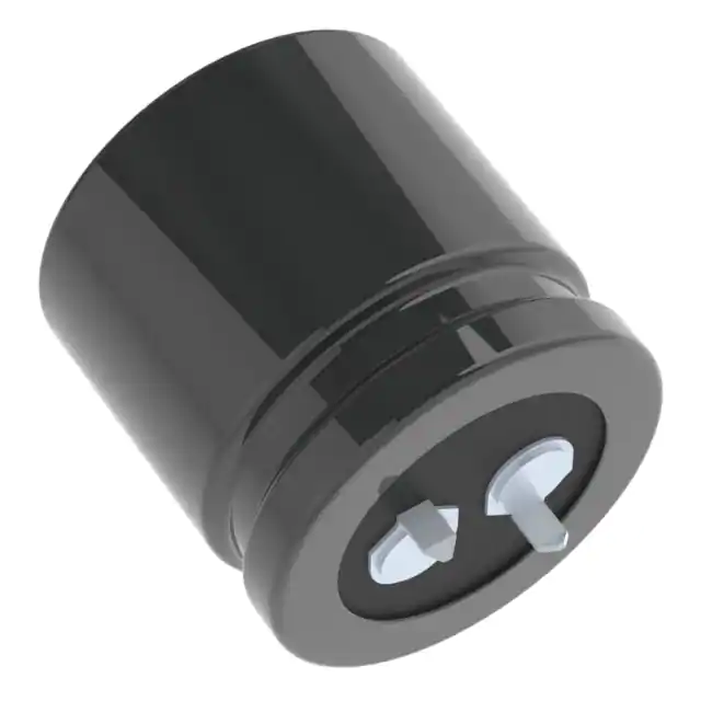

KMH SERIES Engineering Bulletin Mar 07 KMH Series  The KMH series capacitors are the standard 105C , large capacitance, snap-in capacitors from United Chemi-Con. The load life for the KMH series is 2,000 hours at 105C with the rated ripple current applied. The very high CV values and ripple current capabilities make these capacitors ideal for use in power supply filter circuits. The KMH capacitors are available in 2 or 4-pin snap-in styles and 4 or 5-pin straight terminals. The KMH series is RoHS compliant offering Pb-free construction. The standard KMH series capacitors are not solvent proof. Refer to guidelines and precautions on the website for usage and installation conditions recommended for United Chemi-Con products. Summary of Specifications  PC board 2 or 4-pin snap-in; optional 4 or 5-pin straight terminals.  Capacitance range: 47 to 220,000µF.  Voltage range: 6.3 to 450VDC.  Category temperature range: 40C to 105C for 6.3 to 100V; 25C to 105C for 160 to 450V.  Leakage current: 0.02CV(µA) or 3mA, whichever is smaller, after 5 minutes at 20C.  Standard capacitance tolerance: 20%  Nominal case size (DL): 2220mm to 4080mm.  Rated lifetime: 2,000 hours at 105C with the rated ripple current applied. United Chemi-Con, Inc. 9801 W. Higgins Road, Rosemont, IL 60018 Tel 847-696-2000 Fax 847-696-9278 www.chemi-con.com 1/ 15 KMH SNAP MOUNT 105C Snap Mount  Large Capacitance  High CV  High Ripple  RoHS Compliant  105C Maximum Temperature Engineering Bulletin Mar 07 KMH Series KMH Specifications - Snap Mount Item Characteristics Category Temperature Range 40 to 105C for 6.3 to 100VDC; 25 to 105C for 160 to 450VDC Rated Voltage Range 6.3 to 450VDC Capacitance Range 47 to 220,000F Capacitance Tolerance 20% ( M ) at 20C, 120Hz Leakage Current I  0.02CV (A ) or 3mA, whichever is smaller, after 5 minutes at 20C. Where I = Max. leakage current (A ), C = Nominal capacitance (F ) and V = Rated voltage ( V ) Dissipation Factor ( Tan ) At 20C, 120Hz Rated Voltage ( V ) 6.3 10 16 25 35 50 63 -100 160 - 250 315 - 450 Tan  ( DF ) Max.† 0.60 0.50 0.40 0.30 0.25 0.20 0.15 * 0.10 * 0.15 * 0.15 maximum for 35mm and 40mm diameter or 20mm in length. † For rated voltages ≤ 63V, values are not valid for case sizes >35mm in diameter or >50mm in length. Low Temperature Characteristics At 120Hz, impedance ( Z ) ratio between the 25C or 40C value and 20C value shall not exceed the values given below. Rated Voltage ( V ) KMH SNAP MOUNT 105C Rated Ripple Current Multipliers 6.3 -16 25 35 50, 63 80, 100 160 - 400 Z (25C ) / Z (20C ) 4 3 3 2 2 4 450 8 Z (40C ) / Z (20C ) 15 10 8 6 5 — — Ambient Temperature (C ) 45C 60C 70C 85C 105C 2.64 2.23 2.12 1.73 1.00 Frequency (Hz ) Endurance (Load Life) DC Rated Voltage 50Hz 120Hz 300Hz 1kHz 10kHz 100kHz 6.3 -50V 0.95 1.00 1.03 1.05 1.08 1.08 63 -100V 0.92 1.00 1.07 1.13 1.19 1.20 160 - 250V 0.81 1.00 1.17 1.32 1.45 1.50 315 - 450V 0.77 1.00 1.16 1.30 1.41 1.43 The following specifications shall be satisfied when the capacitors are restored to 20C after subjecting them to DC voltage for 2,000 hours at 105C with the rated ripple current applied. The sum of the DC voltage and peak AC voltage must not exceed the full rated voltage of the capacitors. Capacitance change: ≤ 20% of initial measured value Tan  ( DF ) : ≤ 200% of initial specified value Leakage current : ≤ initial specified value Shelf Life The following specifications shall be satisfied when the capacitors are restored to 20C after exposing them for 1,000 hours at 105C without voltage applied. The rated voltage shall be applied to the capacitors for a minimum of 30 minutes, at least 24 hours and not more than 48 hours before the measurements. Capacitance change: ≤ 20% of initial measured value Tan  ( DF ) : ≤ 150% of initial specified value Leakage current : ≤ initial specified value 2 / 15 United Chemi-Con, Inc. 9801 W. Higgins Road, Rosemont, IL 60018 Tel 847-696-2000 Fax 847-696-9278 www.chemi-con.com Engineering Bulletin Mar 07 KMH Series Diagram of Dimensions - Snap Mount Unit: mm Snap Mount Types VSN & VNN Ø 22~ Ø 35 Type VRD Ø 35 See Pin Detail Pb-free PVC Sleeve See Pin Detail Pb-free PVC Sleeve PC board pin-out C* A* D 1 PC board pin-out B 30° D35 1 10 2-2x ** Vent ** Vent L 2 Type VND Ø 35 & Ø 40 PC board pin-out B 22.5 2-4x L 2 C* 30° D35 1 ** Vent 22.5 2-4x L 2 Type VQT Ø 40 P See Pin Detail Pb-free PVC Sleeve W1 PC board pin-out C 360° 6 D* B* Edge of can 25 D40 1 A* W ** Vent Type VSN Ø 22 - Ø 30 VSN Ø 35 VNN Ø 22 - Ø 35 VND Ø 35 - Ø 40 P 4.00.5 3.50.5 5.81.0 5.81.0 W W1 W2 1.50.2 1.0 1.0 2-5x L 2 VR & VQ Pin Dimensions VR Straight Pin W1 VQ Standoff Pin P CAUTION: * Use the blank terminals for mechanical support only. The blank terminals must not be connected to a solder trace on the PC board, but be electrically isolated from the negative or positive terminal. ** Vent may be located either on the bottom or side of the can. W1 W W P Edge of can Edge of can P1 Type Straight Pin (VR) Standoff Pin (VQ) P 5.501.0 3.751.0 P1 — 2.0 max. W W1 1.50.1 0.7 United Chemi-Con, Inc. 9801 W. Higgins Road, Rosemont, IL 60018 Tel 847-696-2000 Fax 847-696-9278 www.chemi-con.com 3 / 15 KMH SNAP MOUNT 105C VS & VN Pin Dimensions PC board pin-out B A* 30° D35 1 W2 See Pin Detail Pb-free PVC Sleeve C* A* ** Vent 2-4x L 2 Type VQD Ø 35 See Pin Detail Pb-free PVC Sleeve 22.5 Engineering Bulletin Mar 07 KMH Series Part Numbering System for KMH Series When ordering, always specify complete 18-field global part number. 18 Fields 1 2 3 4 5 6 7 8 9 10 11 12 13 14 15 16 17 18 E KMH 2 0 1 V S N 5 6 1 M P 4 5 T 9 7 SNAP MOUNT 105C KMH 8 6 5 4 3 2 1 4 / 15 Supplement Code. Field 18. All construction options listed have Sn100% terminal plating. S = PET sleeve without end disk. W = PET sleeve with end disk. M = Pb-free PVC sleeve without end disk. T = Pb-free PVC sleeve with end disk. Case Size. Fields 15, 16 and 17. The single letter diameter code is inserted in field 15. P = Ø 22mm Q = Ø 25.4mm R = Ø 30mm A = Ø 35mm B = Ø 40mm The double digit length code is inserted in fields 16 and 17. 20 = 20mm 25 = 25mm 30 = 30mm 35 = 35mm 40 = 40mm 45 = 45mm 50 = 50mm 63 = 63mm 80 = 80mm Capacitance Tolerance. Field 14. M = 20% Capacitance. Fields 11, 12 and 13. Expressed in Microfarads. The first two digits are significant figures inserted in fields 11 and 12, and the third digit inserted in field 13 indicates the number of zeros for capacitance of 10F or more. R indicates the decimal point for capacitance less than 10F (e.g. 5R6 = 5.6F; 560 = 56F; 561 = 560F; 562 = 5,600F; 563 = 56,000F ). Dummy Terminals. Field 10. N = No dummy terminals. D = 2 dummy terminals. T = 3 dummy terminals. Terminal Type. Fields 8 and 9. VS = Snap-in pins, 4.0mm in length, 3.5mm for Ø35 only. VN = Snap-in pins, 5.8mm in length. VR = Straight pins. VQ = Straight standoff pins. DC Rated Voltage. Fields 5, 6 and 7. Expressed in Volts. The first two digits are significant figures inserted in fields 5 and 6, and the third digit inserted in field 7 indicates the number of zeros for rated voltage of 10VDC or more. R indicates the decimal point for rated voltage less than 10VDC (e.g. 2R0 = 2.0VDC; 200 = 20VDC; 201 = 200VDC). Rule Exception: Coding for rated voltage 315VDC = 3B1. Series Name. Fields 2, 3 and 4. Enter the 3-letter/digit series name in fields 2, 3 and 4. If the series name is only 2 letters/digits, place a dash in field 4. For a series name with more than 3 letters/digits, refer to the individual series for the appropriate 3-field series name. Capacitor Type. Field 1. Aluminum Electrolytic Capacitor (Polar). United Chemi-Con, Inc. 9801 W. Higgins Road, Rosemont, IL 60018 Tel 847-696-2000 Fax 847-696-9278 www.chemi-con.com Engineering Bulletin Mar 07 KMH Series Standard Voltage Ratings - Snap Mount Rated Voltage (WVDC) 6.3 Volts 8 Volts Surge 12,000 15,000 18,000 22,000 27,000 33,000 18,000 22,000 27,000 33,000 39,000 47,000 22,000 27,000 33,000 39,000 47,000 56,000 68,000 33,000 39,000 47,000 56,000 68,000 82,000 120,000 180,000 56,000 68,000 82,000 100,000 150,000 180,000 220,000 EKMH6R3VSN123MP25T EKMH6R3VSN153MP25T EKMH6R3VSN183MP30T EKMH6R3VSN223MP35T EKMH6R3VSN273MP40T EKMH6R3VSN333MP45T EKMH6R3VSN183MQ25T EKMH6R3VSN223MQ30T EKMH6R3VSN273MQ35T EKMH6R3VSN333MQ40T EKMH6R3VSN393MQ40T EKMH6R3VSN473MQ50T EKMH6R3VSN223MR25T EKMH6R3VSN273MR25T EKMH6R3VSN333MR30T EKMH6R3VSN393MR35T EKMH6R3VSN473MR40T EKMH6R3VSN563MR45T EKMH6R3VSN683MR50T EKMH6R3VSN333MA25T EKMH6R3VSN393MA30T EKMH6R3VSN473MA30T EKMH6R3VSN563MA35T EKMH6R3VSN683MA40T EKMH6R3VSN823MA45T EKMH6R3VSN124MA63T EKMH6R3VSN184MA80T EKMH6R3VQT563MB25T EKMH6R3VQT683MB30T EKMH6R3VQT823MB35T EKMH6R3VQT104MB40T EKMH6R3VQT154MB50T EKMH6R3VQT184MB63T EKMH6R3VQT224MB80T 10,000 12,000 15,000 18,000 22,000 27,000 15,000 18,000 22,000 27,000 33,000 39,000 22,000 27,000 33,000 39,000 47,000 56,000 27,000 33,000 39,000 47,000 56,000 68,000 EKMH100VSN103MP25T EKMH100VSN123MP30T EKMH100VSN153MP30T EKMH100VSN183MP35T EKMH100VSN223MP40T EKMH100VSN273MP50T EKMH100VSN153MQ25T EKMH100VSN183MQ30T EKMH100VSN223MQ35T EKMH100VSN273MQ40T EKMH100VSN333MQ45T EKMH100VSN393MQ50T EKMH100VSN223MR25T EKMH100VSN273MR30T EKMH100VSN333MR35T EKMH100VSN393MR40T EKMH100VSN473MR45T EKMH100VSN563MR50T EKMH100VSN273MA25T EKMH100VSN333MA30T EKMH100VSN393MA30T EKMH100VSN473MA35T EKMH100VSN563MA40T EKMH100VSN683MA50T Case Size Code Maximum ESR ( Ω ) at 20C, 120Hz Rated Ripple Current (A rms) at 105C, 120Hz 22  25 22  25 22  30 22  35 22  40 22  45 25.4  25 25.4  30 25.4  35 25.4  40 25.4  40 25.4  50 30  25 30  25 30  30 30  35 30  40 30  45 30  50 35  25 35  30 35  30 35  35 35  40 35  45 35  63 35  80 40  25 40  30 40  35 40  40 40  50 40  63 40  80 P25 P25 P30 P35 P40 P45 Q25 Q30 Q35 Q40 Q40 Q50 R25 R25 R30 R35 R40 R45 R50 A25 A30 A30 A35 A40 A45 A63 A80 B25 B30 B35 B40 B50 B63 B80 0.083 0.066 0.055 0.045 0.037 0.03 0.055 0.045 0.037 0.03 0.026 0.021 0.045 0.037 0.03 0.026 0.021 0.018 0.015 0.03 0.026 0.021 0.018 0.015 0.012 0.011 0.008 0.026 0.02 0.018 0.014 0.011 0.009 0.008 1.54 1.72 1.95 2.23 2.54 2.88 1.96 2.25 2.57 2.93 3.18 3.69 2.28 2.52 2.89 3.26 3.69 4.16 4.71 2.93 3.4 3.73 4.12 4.69 5.32 6.9 9.04 3.87 4.47 5.09 5.79 7.54 8.82 10.61 22  25 22  30 22  30 22  35 22  40 22  50 25.4  25 25.4  30 25.4  35 25.4  40 25.4  45 25.4  50 30  25 30  30 30  35 30  40 30  45 30  50 35  25 35  30 35  30 35  35 35  40 35  50 P25 P30 P30 P35 P40 P50 Q25 Q30 Q35 Q40 Q45 Q50 R25 R30 R35 R40 R45 R50 A25 A30 A30 A35 A40 A50 0.083 0.069 0.055 0.046 0.038 0.031 0.055 0.046 0.038 0.031 0.025 0.021 0.038 0.031 0.025 0.021 0.018 0.015 0.031 0.025 0.021 0.018 0.015 0.012 1.55 1.77 1.97 2.21 2.51 2.93 1.96 2.23 2.54 2.9 3.3 3.68 2.4 2.87 3.28 3.69 4.17 4.68 2.73 3.16 3.43 3.76 4.67 5.46 Nominal Case Size* DL ( mm ) † For terminal and construction options, refer to the part numbering system for descriptions and codes. * Refer to diagram of dimensions for detailed case size specifications. United Chemi-Con, Inc. 9801 W. Higgins Road, Rosemont, IL 60018 Tel 847-696-2000 Fax 847-696-9278 www.chemi-con.com 5 / 15 KMH Global Part Number† SNAP MOUNT 105C 10 Volts 13 Volts Surge Capacitance (µF ) Engineering Bulletin Mar 07 KMH Series Standard Voltage Ratings - Snap Mount Rated Voltage (WVDC) 10 Volts KMH SNAP MOUNT 105C 13 Volts Surge 16 Volts 20 Volts Surge 25 Volts 32 Volts Surge Capacitance (µF ) Global Part Number† Nominal Case Size* DL ( mm ) Case Size Code Maximum ESR ( Ω ) at 20C, 120Hz Rated Ripple Current (A rms) at 105C, 120Hz 100,000 120,000 39,000 56,000 68,000 82,000 120,000 150,000 180,000 EKMH100VSN104MA63T EKMH100VSN124MA80T EKMH100VQT393MB25T EKMH100VQT563MB30T EKMH100VQT683MB35T EKMH100VQT823MB40T EKMH100VQT124MB50T EKMH100VQT154MB63T EKMH100VQT184MB80T 35  63 35  80 40  25 40  30 40  35 40  40 40  50 40  63 40  80 A63 A80 B25 B30 B35 B40 B50 B63 B80 0.011 0.009 0.027 0.021 0.018 0.015 0.012 0.009 0.008 6.9 8.08 3.54 4.44 5.08 5.75 7.39 8.82 10.51 6,800 10,000 12,000 15,000 18,000 10,000 12,000 15,000 18,000 22,000 27,000 12,000 15,000 18,000 22,000 27,000 33,000 39,000 18,000 22,000 27,000 33,000 39,000 47,000 68,000 100,000 33,000 39,000 47,000 56,000 82,000 100,000 150,000 EKMH160VSN682MP25T EKMH160VSN103MP30T EKMH160VSN123MP35T EKMH160VSN153MP40T EKMH160VSN183MP45T EKMH160VSN103MQ25T EKMH160VSN123MQ30T EKMH160VSN153MQ35T EKMH160VSN183MQ40T EKMH160VSN223MQ45T EKMH160VSN273MQ50T EKMH160VSN123MR25T EKMH160VSN153MR25T EKMH160VSN183MR30T EKMH160VSN223MR35T EKMH160VSN273MR40T EKMH160VSN333MR45T EKMH160VSN393MR50T EKMH160VSN183MA25T EKMH160VSN223MA25T EKMH160VSN273MA30T EKMH160VSN333MA35T EKMH160VSN393MA40T EKMH160VSN473MA45T EKMH160VSN683MA63T EKMH160VSN104MA80T EKMH160VQT333MB25T EKMH160VQT333MB30T EKMH160VQT333MB35T EKMH160VQT333MB40T EKMH160VQT333MB50T EKMH160VQT333MB63T EKMH160VQT333MB80T 22  25 22  30 22  35 22  40 22  45 25.4  25 25.4  30 25.4  35 25.4  40 25.4  45 25.4  50 30  25 30  25 30  30 30  35 30  40 30  45 30  50 35  25 35  25 35  30 35  35 35  40 35  45 35  63 35  80 40  25 40  30 40  35 40  40 40  50 40  63 40  80 P25 P30 P35 P40 P45 Q25 Q30 Q35 Q40 Q45 Q50 R25 R25 R30 R35 R40 R45 R50 A25 A25 A30 A35 A40 A45 A63 A80 B25 B30 B35 B40 B50 B63 B80 0.098 0.066 0.055 0.044 0.037 0.066 0.055 0.044 0.037 0.03 0.025 0.055 0.044 0.037 0.03 0.025 0.02 0.017 0.037 0.03 0.025 0.02 0.017 0.014 0.012 0.009 0.027 0.021 0.018 0.015 0.012 0.010 0.008 1.57 1.97 2.22 2.55 2.87 1.97 2.24 2.58 2.92 3.32 3.78 2.45 2.52 2.88 3.29 3.77 4.3 4.81 2.92 3.23 3.45 4.26 4.79 5.43 6.36 8.25 3.64 4.15 4.72 5.31 6.83 8.05 10.73 4,700 5,600 6,800 8,200 10,000 12,000 6,800 8,200 10,000 12,000 15,000 18,000 8,200 10,000 12,000 15,000 EKMH250VSN472MP25T EKMH250VSN562MP25T EKMH250VSN682MP30T EKMH250VSN822MP35T EKMH250VSN103MP40T EKMH250VSN123MP45T EKMH250VSN682MQ25T EKMH250VSN822MQ30T EKMH250VSN103MQ35T EKMH250VSN123MQ40T EKMH250VSN153MQ45T EKMH250VSN183MQ50T EKMH250VSN822MR25T EKMH250VSN103MR25T EKMH250VSN123MR30T EKMH250VSN153MR35T 22  25 22  25 22  30 22  35 22  40 22  45 25.4  25 25.4  30 25.4  35 25.4  40 25.4  45 25.4  50 30  25 30  25 30  30 30  35 P25 P25 P30 P35 P40 P45 Q25 Q30 Q35 Q40 Q45 Q50 R25 R25 R30 R35 0.106 0.089 0.073 0.061 0.05 0.041 0.073 0.061 0.05 0.041 0.033 0.028 0.061 0.05 0.041 0.033 1.5 1.63 1.86 2.11 2.39 2.69 1.87 2.12 2.42 2.74 3.15 3.54 2.15 2.37 2.7 3.13 † For terminal and construction options, refer to the part numbering system for descriptions and codes. * Refer to diagram of dimensions for detailed case size specifications. 6 / 15 United Chemi-Con, Inc. 9801 W. Higgins Road, Rosemont, IL 60018 Tel 847-696-2000 Fax 847-696-9278 www.chemi-con.com Engineering Bulletin Mar 07 KMH Series Standard Voltage Ratings - Snap Mount Rated Voltage (WVDC) 25 Volts 32 Volts Surge Nominal Case Size* DL ( mm ) Case Size Code Maximum ESR ( Ω ) at 20C, 120Hz Rated Ripple Current (A rms) at 105C, 120Hz 18,000 22,000 12,000 15,000 18,000 22,000 27,000 33,000 47,000 68,000 18,000 27,000 33,000 39,000 47,000 68,000 82,000 EKMH250VSN183MR40T EKMH250VSN223MR45T EKMH250VSN123MA25T EKMH250VSN153MA30T EKMH250VSN183MA30T EKMH250VSN223MA35T EKMH250VSN273MA45T EKMH250VSN333MA50T EKMH250VSN473MA63T EKMH250VSN683MA80T EKMH250VQT183MB25T EKMH250VQT273MB30T EKMH250VQT333MB35T EKMH250VQT393MB40T EKMH250VQT473MB50T EKMH250VQT683MB63T EKMH250VQT823MB80T 30  40 30  45 35  25 35  30 35  30 35  35 35  45 35  50 35  63 35  80 40  25 40  30 40  35 40  40 40  50 40  63 40  80 R40 R45 A25 A30 A30 A35 A45 A50 A63 A80 B25 B30 B35 B40 B50 B63 B80 0.028 0.023 0.041 0.033 0.028 0.023 0.018 0.015 0.012 0.009 0.029 0.021 0.018 0.015 0.013 0.010 0.008 3.54 4.04 2.74 3.27 3.58 3.64 4.73 5.39 6.11 7.86 3.11 3.98 4.57 5.12 5.97 7.67 9.16 3,300 3,900 4,700 5,600 6,800 8,200 4,700 5,600 6,800 8,200 10,000 12,000 5,600 6,800 8,200 10,000 12,000 15,000 8,200 10,000 12,000 15,000 18,000 22,000 33,000 39,000 12,000 18,000 22,000 27,000 33,000 47,000 56,000 EKMH350VSN332MP25T EKMH350VSN392MP30T EKMH350VSN472MP30T EKMH350VSN562MP35T EKMH350VSN682MP40T EKMH350VSN822MP50T EKMH350VSN472MQ25T EKMH350VSN562MQ30T EKMH350VSN682MQ35T EKMH350VSN822MQ40T EKMH350VSN103MQ45T EKMH350VSN123MQ50T EKMH350VSN562MR25T EKMH350VSN682MR25T EKMH350VSN822MR30T EKMH350VSN103MR35T EKMH350VSN123MR40T EKMH350VSN153MR45T EKMH350VSN822MA25T EKMH350VSN103MA30T EKMH350VSN123MA30T EKMH350VSN153MA35T EKMH350VSN183MA40T EKMH350VSN223MA50T EKMH350VSN333MA63T EKMH350VSN393MA80T EKMH350VQT123MB25T EKMH350VQT183MB30T EKMH350VQT223MB35T EKMH350VQT273MB40T EKMH350VQT333MB50T EKMH350VQT473MB63T EKMH350VQT563MB80T 22  25 22  30 22  30 22  35 22  40 22  50 25.4  25 25.4  30 25.4  35 25.4  40 25.4  45 25.4  50 30  25 30  25 30  30 30  35 30  40 30  45 35  25 35  30 35  30 35  35 35  40 35  50 35  63 35  80 40  25 40  30 40  35 40  40 40  50 40  63 40  80 P25 P30 P30 P35 P40 P50 Q25 Q30 Q35 Q40 Q45 Q50 R25 R25 R30 Q35 R40 R45 A25 A30 A30 A35 A40 A50 A63 A80 B25 B30 B35 B40 B50 B63 B80 0.126 0.106 0.088 0.074 0.061 0.051 0.088 0.074 0.061 0.051 0.041 0.035 0.074 0.061 0.051 0.041 0.035 0.028 0.051 0.041 0.035 0.028 0.023 0.019 0.012 0.010 0.030 0.022 0.019 0.016 0.013 0.010 0.008 1.4 1.57 1.72 1.95 2.2 2.55 1.8 1.96 2.23 2.53 2.87 3.24 1.99 2.19 2.75 2.9 3.23 3.72 2.75 2.91 2.99 3.67 4.37 4.92 5.60 6.52 2.78 3.56 4.09 4.66 5.48 6.98 8.29 1,800 2,700 3,300 3,900 4,700 5,600 2,700 3,300 EKMH500VSN182MP25T EKMH500VSN272MP30T EKMH500VSN332MP35T EKMH500VSN392MP40T EKMH500VSN472MP45T EKMH500VSN562MP50T EKMH500VSN272MQ25T EKMH500VSN332MQ30T 22  25 22  30 22  35 22  40 22  45 22  50 25.4  25 25.4  30 P25 P30 P35 P40 P45 P50 Q25 Q30 0.184 0.123 0.10 0.085 0.071 0.059 0.123 0.10 1.33 1.69 1.93 2.16 2.43 2.75 1.7 1.85 † For terminal and construction options, refer to the part numbering system for descriptions and codes. * Refer to diagram of dimensions for detailed case size specifications. United Chemi-Con, Inc. 9801 W. Higgins Road, Rosemont, IL 60018 Tel 847-696-2000 Fax 847-696-9278 www.chemi-con.com 7/ 15 KMH 50 Volts 63 Volts Surge Global Part Number† SNAP MOUNT 105C 35 Volts 44 Volts Surge Capacitance (µF ) Engineering Bulletin Mar 07 KMH Series Standard Voltage Ratings - Snap Mount Rated Voltage (WVDC) 50 Volts KMH SNAP MOUNT 105C 63 Volts Surge 63 Volts 79 Volts Surge Capacitance (µF ) Global Part Number† 3,900 4,700 5,600 6,800 3,900 4,700 5,600 6,800 8,200 10,000 4,700 5,600 6,800 8,200 10,000 12,000 18,000 27,000 8,200 10,000 12,000 15,000 22,000 27,000 39,000 EKMH500VSN392MQ35T EKMH500VSN472MQ35T EKMH500VSN562MQ40T EKMH500VSN682MQ50T EKMH500VSN392MR25T EKMH500VSN472MR30T EKMH500VSN562MR35T EKMH500VSN682MR40T EKMH500VSN822MR45T EKMH500VSN103MR50T EKMH500VSN472MA25T EKMH500VSN562MA25T EKMH500VSN682MA30T EKMH500VSN822MA35T EKMH500VSN103MA40T EKMH500VSN123MA45T EKMH500VSN183MA63T EKMH500VSN273MA80T EKMH500VQT822MB25T EKMH500VQT103MB30T EKMH500VQT123MB35T EKMH500VQT153MB40T EKMH500VQT223MB50T EKMH500VQT273MB63T EKMH500VQT393MB80T 1,200 1,500 1,800 2,200 2,700 3,300 1,800 2,200 2,700 3,300 3,900 4,700 2,700 3,300 3,900 4,700 5,600 6,800 3,300 3,900 4,700 5,600 6,800 8,200 10,000 15,000 18,000 5,600 8,200 10,000 12,000 15,000 18,000 27,000 EKMH630VSN122MP25T EKMH630VSN152MP25T EKMH630VSN182MP30T EKMH630VSN222MP35T EKMH630VSN272MP40T EKMH630VSN332MP50T EKMH630VSN182MQ25T EKMH630VSN222MQ30T EKMH630VSN272MQ35T EKMH630VSN332MQ40T EKMH630VSN392MQ45T EKMH630VSN472MQ50T EKMH630VSN272MR25T EKMH630VSN332MR30T EKMH630VSN392MR35T EKMH630VSN472MR40T EKMH630VSN562MR45T EKMH630VSN682MR50T EKMH630VSN332MA25T EKMH630VSN392MA25T EKMH630VSN472MA30T EKMH630VSN562MA35T EKMH630VSN682MA40T EKMH630VSN822MA45T EKMH630VSN103MA50T EKMH630VSN153MA63T EKMH630VSN183MA80T EKMH630VQT562MB25T EKMH630VQT822MB30T EKMH630VQT103MB35T EKMH630VQT123MB40T EKMH630VQT153MB50T EKMH630VQT183MB63T EKMH630VQT273MB80T Case Size Code Maximum ESR ( Ω ) at 20C, 120Hz Rated Ripple Current (A rms) at 105C, 120Hz 25.4  35 25.4  35 25.4  40 25.4  50 30  25 30  30 30  35 30  40 30  45 30  50 35  25 35  25 35  30 35  35 35  40 35  45 35  63 35  80 40  25 40  30 40  35 40  40 40  50 40  63 40  80 Q35 Q35 Q40 Q50 R25 R30 R35 R40 R45 R50 A25 A25 A30 A35 A40 A45 A63 A80 B25 B30 B35 B40 B50 B63 B80 0.085 0.071 0.059 0.049 0.085 0.071 0.059 0.049 0.04 0.033 0.071 0.059 0.049 0.04 0.033 0.028 0.014 0.011 0.035 0.027 0.023 0.019 0.015 0.012 0.009 2.18 2.39 2.7 3.3 1.95 2.25 2.76 3.3 3.6 4.04 2.48 2.7 3.25 3.55 4.03 4.55 4.63 6.06 2.57 2.97 3.37 3.89 5.0 5.92 7.74 22  25 22  25 22  30 22  35 22  40 22  50 25.4  25 25.4  30 25.4  35 25.4  40 25.4  45 25.4  50 30  25 30  30 30  35 30  40 30  45 30  50 35  25 35  25 35  30 35  35 35  40 35  45 35  50 35  63 35  80 40  25 40  30 40  35 40  40 40  50 40  63 40  80 P25 P25 P30 P35 P40 P50 Q25 Q30 Q35 Q40 Q45 Q50 R25 R30 R35 R40 R45 R50 A25 A25 A30 A35 A40 A45 A50 A63 A80 B25 B30 B35 B40 B50 B63 B80 0.207 0.166 0.138 0.113 0.092 0.075 0.138 0.113 0.092 0.075 0.064 0.053 0.092 0.075 0.064 0.053 0.044 0.037 0.075 0.064 0.053 0.044 0.037 0.03 0.025 0.014 0.012 0.038 0.028 0.026 0.02 0.016 0.013 0.010 1.19 1.33 1.51 1.73 1.97 2.29 1.52 1.74 1.99 2.27 2.54 2.86 1.76 2.24 2.55 2.86 3.22 3.65 2.06 2.24 2.79 3.19 3.64 3.9 4.4 4.88 5.72 2.45 3.1 3.56 4.01 4.77 5.58 7.43 Nominal Case Size* DL ( mm ) † For terminal and construction options, refer to the part numbering system for descriptions and codes. * Refer to diagram of dimensions for detailed case size specifications. 8 / 15 United Chemi-Con, Inc. 9801 W. Higgins Road, Rosemont, IL 60018 Tel 847-696-2000 Fax 847-696-9278 www.chemi-con.com Engineering Bulletin Mar 07 KMH Series Standard Voltage Ratings - Snap Mount Rated Voltage (WVDC) 80 Volts 100 Volts Surge 820 1,000 1,200 1,500 1,800 2,200 1,200 1,500 1,800 2,200 2,700 3,300 1,800 2,200 2,700 3,300 3,900 4,700 2,200 2,700 3,300 3,900 4,700 5,600 6,800 8,200 12,000 3,900 4,700 5,600 6,800 10,000 12,000 18,000 EKMH800VSN821MP25T EKMH800VSN102MP25T EKMH800VSN122MP30T EKMH800VSN152MP35T EKMH800VSN182MP40T EKMH800VSN222MP45T EKMH800VSN122MQ25T EKMH800VSN152MQ30T EKMH800VSN182MQ30T EKMH800VSN222MQ35T EKMH800VSN272MQ45T EKMH800VSN332MQ50T EKMH800VSN182MR25T EKMH800VSN222MR30T EKMH800VSN272MR35T EKMH800VSN332MR40T EKMH800VSN392MR45T EKMH800VSN472MR50T EKMH800VSN222MA25T EKMH800VSN272MA25T EKMH800VSN332MA30T EKMH800VSN392MA35T EKMH800VSN472MA40T EKMH800VSN562MA45T EKMH800VSN682MA50T EKMH800VSN822MA63T EKMH800VSN103MA80T EKMH800VQT392MB25T EKMH800VQT472MB30T EKMH800VQT562MB35T EKMH800VQT682MB40T EKMH800VQT103MB50T EKMH800VQT123MB63T EKMH800VQT183MB80T 560 820 1,000 1,200 1,500 820 1,000 1,200 1,500 1,800 2,200 1,200 1,500 1,800 2,200 2,700 3,300 1,500 1,800 2,200 2,700 3,300 3,900 4,700 EKMH101VSN561MP25T EKMH101VSN821MP30T EKMH101VSN102MP35T EKMH101VSN122MP40T EKMH101VSN152MP45T EKMH101VSN821MQ25T EKMH101VSN102MQ30T EKMH101VSN122MQ35T EKMH101VSN152MQ40T EKMH101VSN182MQ45T EKMH101VSN222MQ50T EKMH101VSN122MR25T EKMH101VSN152MR30T EKMH101VSN182MR35T EKMH101VSN222MR40T EKMH101VSN272MR45T EKMH101VSN332MR50T EKMH101VSN152MA25T EKMH101VSN182MA25T EKMH101VSN222MA30T EKMH101VSN272MA35T EKMH101VSN332MA40T EKMH101VSN392MA45T EKMH101VSN472MA50T Case Size Code Maximum ESR ( Ω ) at 20C, 120Hz Rated Ripple Current (A rms) at 105C, 120Hz 22  25 22  25 22  30 22  35 22  40 22  45 25.4  25 25.4  30 25.4  30 25.4  35 25.4  45 25.4  50 30  25 30  30 30  35 30  40 30  45 30  50 35  25 35  25 35  30 35  35 35  40 35  45 35  50 35  63 35  80 40  25 40  30 40  35 40  40 40  50 40  63 40  80 P25 P25 P30 P35 P40 P45 Q25 Q30 Q30 Q35 Q45 Q50 R25 R30 R35 R40 R45 R50 A25 A25 A30 A35 A40 A45 A50 A63 A80 B25 B30 B35 B40 B50 B63 B80 0.303 0.249 0.207 0.166 0.138 0.113 0.207 0.166 0.138 0.113 0.092 0.075 0.138 0.113 0.092 0.075 0.064 0.053 0.113 0.092 0.075 0.064 0.053 0.044 0.037 0.03 0.021 0.064 0.053 0.044 0.037 0.025 0.021 0.014 1.11 1.22 1.38 1.59 1.8 2.04 1.39 1.61 1.76 2.01 2.36 2.68 1.65 2.05 2.35 2.68 3.0 3.39 2.07 2.29 2.45 2.98 3.38 3.8 3.9 4.42 5.72 2.5 2.88 3.26 3.7 4.77 5.58 7.43 22  25 22  30 22  35 22  40 22  45 25.4  25 25.4  30 25.4  35 25.4  40 25.4  45 25.4  50 30  25 30  30 30  35 30  40 30  45 30  50 35  25 35  25 35  30 35  35 35  40 35  45 35  50 P25 P30 P35 P40 P45 Q25 Q30 Q35 Q40 Q45 Q50 R25 R30 R35 R40 R45 R50 A25 A25 A30 A35 A40 A45 A50 0.444 0.303 0.249 0.207 0.166 0.303 0.249 0.207 0.166 0.138 0.113 0.207 0.166 0.138 0.113 0.092 0.075 0.166 0.138 0.113 0.092 0.075 0.064 0.053 1.05 1.32 1.5 1.69 1.94 1.33 1.51 1.71 1.98 2.23 2.53 1.68 1.95 2.5 2.7 2.88 3.28 1.98 2.17 2.5 2.86 3.27 3.67 3.8 Nominal Case Size* DL ( mm ) † For terminal and construction options, refer to the part numbering system for descriptions and codes. * Refer to diagram of dimensions for detailed case size specifications. United Chemi-Con, Inc. 9801 W. Higgins Road, Rosemont, IL 60018 Tel 847-696-2000 Fax 847-696-9278 www.chemi-con.com 9 / 15 KMH Global Part Number† SNAP MOUNT 105C 100 Volts 125 Volts Surge Capacitance (µF ) Engineering Bulletin Mar 07 KMH Series Standard Voltage Ratings - Snap Mount Rated Voltage (WVDC) 100 Volts KMH SNAP MOUNT 105C 125 Volts Surge 160 Volts 200 Volts Surge 180 Volts 225 Volts Surge Capacitance (µF ) Global Part Number† Nominal Case Size* DL ( mm ) Case Size Code Maximum ESR ( Ω ) at 20C, 120Hz Rated Ripple Current (A rms) at 105C, 120Hz 5,600 6,800 2,200 2,700 3,300 4,700 5,600 8,200 10,000 EKMH101VSN562MA63T EKMH101VSN682MA80T EKMH101VQT222MB25T EKMH101VQT272MB30T EKMH101VQT332MB35T EKMH101VQT472MB40T EKMH101VQT562MB50T EKMH101VQT822MB63T EKMH101VQT103MB80T 35  63 35  80 40  25 40  30 40  35 40  40 40  50 40  63 40  80 A63 A80 B25 B30 B35 B40 B50 B63 B80 0.044 0.037 0.113 0.092 0.075 0.053 0.044 0.03 0.025 4.08 4.81 2.1 2.44 2.8 3.44 3.99 5.16 6.19 220 270 330 390 470 560 680 820 330 390 470 560 680 820 1,000 1,200 390 470 560 680 820 1,000 1,200 1,500 1,800 560 680 820 1,000 1,200 1,500 1,800 2,200 3,300 3,900 1,200 1,800 2,200 2,700 3,300 4,700 5,600 EKMH161VSN221MP20T EKMH161VSN271MP25T EKMH161VSN331MP25T EKMH161VSN391MP30T EKMH161VSN471MP35T EKMH161VSN561MP40T EKMH161VSN681MP45T EKMH161VSN821MP50T EKMH161VSN331MQ20T EKMH161VSN391MQ25T EKMH161VSN471MQ25T EKMH161VSN561MQ30T EKMH161VSN681MQ35T EKMH161VSN821MQ40T EKMH161VSN102MQ45T EKMH161VSN122MQ50T EKMH161VSN391MR20T EKMH161VSN471MR20T EKMH161VSN561MR25T EKMH161VSN681MR25T EKMH161VSN821MR30T EKMH161VSN102MR35T EKMH161VSN122MR40T EKMH161VSN152MR45T EKMH161VSN182MR50T EKMH161VSN561MA20T EKMH161VSN681MA20T EKMH161VSN821MA25T EKMH161VSN102MA25T EKMH161VSN122MA30T EKMH161VSN152MA35T EKMH161VSN182MA45T EKMH161VSN222MA50T EKMH161VSN332MA63T EKMH161VSN392MA80T EKMH161VQT122MB25T EKMH161VQT182MB30T EKMH161VQT222MB35T EKMH161VQT272MB40T EKMH161VQT332MB50T EKMH161VQT472MB63T EKMH161VQT562MB80T 22  20 22  25 22  25 22  30 22  35 22  40 22  45 22  50 25.4  20 25.4  25 25.4  25 25.4  30 25.4  35 25.4  40 25.4  45 25.4  50 30  20 30  20 30  25 30  25 30  30 30  35 30  40 30  45 30  50 35  20 35  20 35  25 35  25 35  30 35  35 35  45 35  50 35  63 35  80 40  25 40  30 40  35 40  40 40  50 40  63 40  80 P20 P25 P25 P30 P35 P40 P45 P50 Q20 Q25 Q25 Q30 Q35 Q40 Q45 Q50 R20 R20 R25 R25 R30 R35 R40 R45 R50 A20 A20 A25 A25 A30 A35 A45 A50 A63 A80 B25 B30 B35 B40 B50 B63 B80 1.13 0.614 0.502 0.425 0.353 0.296 0.244 0.202 0.753 0.425 0.353 0.296 0.244 0.202 0.166 0.138 0.638 0.529 0.296 0.244 0.202 0.166 0.138 0.111 0.092 0.444 0.366 0.303 0.249 0.207 0.166 0.138 0.113 0.075 0.064 0.207 0.138 0.113 0.092 0.075 0.053 0.044 0.8 1.09 1.2 1.3 1.4 1.5 1.71 1.93 1.02 1.28 1.41 1.51 1.7 2.01 2.2 2.45 1.17 1.28 1.56 1.72 2.0 2.22 2.44 2.82 3.31 1.54 1.7 1.91 2.11 2.44 2.5 3.31 3.77 3.96 4.61 1.96 2.52 2.89 3.3 3.87 4.94 5.86 180 220 270 330 390 470 EKMH181VSN181MP20T EKMH181VSN221MP20T EKMH181VSN271MP25T EKMH181VSN331MP25T EKMH181VSN391MP30T EKMH181VSN471MP35T 22  20 22  20 22  25 22  25 22  30 22  35 P20 P20 P25 P25 P30 P35 1.381 1.13 0.614 0.502 0.425 0.353 0.73 0.8 0.96 1.06 1.3 1.35 † For terminal and construction options, refer to the part numbering system for descriptions and codes. * Refer to diagram of dimensions for detailed case size specifications. 10 / 15 United Chemi-Con, Inc. 9801 W. Higgins Road, Rosemont, IL 60018 Tel 847-696-2000 Fax 847-696-9278 www.chemi-con.com Engineering Bulletin Mar 07 KMH Series Standard Voltage Ratings - Snap Mount Rated Voltage (WVDC) 180 Volts 225 Volts Surge Global Part Number† Nominal Case Size* DL ( mm ) Case Size Code Maximum ESR ( Ω ) at 20C, 120Hz Rated Ripple Current (A rms) at 105C, 120Hz EKMH181VSN561MP40T EKMH181VSN681MP45T EKMH181VSN821MP50T EKMH181VSN271MQ20T EKMH181VSN331MQ25T EKMH181VSN391MQ25T EKMH181VSN471MQ30T EKMH181VSN561MQ35T EKMH181VSN681MQ40T EKMH181VSN821MQ45T EKMH181VSN102MQ50T EKMH181VSN391MR20T EKMH181VSN471MR25T EKMH181VSN561MR25T EKMH181VSN681MR30T EKMH181VSN821MR35T EKMH181VSN102MR40T EKMH181VSN122MR45T EKMH181VSN152MR50T EKMH181VSN471MA20T EKMH181VSN561MA20T EKMH181VSN681MA25T EKMH181VSN821MA25T EKMH181VSN102MA30T EKMH181VSN122MA35T EKMH181VSN152MA40T EKMH181VSN182MA40T EKMH181VSN222MA50T EKMH181VSN272MA63T EKMH181VSN332MA80T EKMH181VQT102MB25T EKMH181VQT152MB30T EKMH181VQT182MB35T EKMH181VQT222MB40T EKMH181VQT272MB50T EKMH181VQT392MB63T EKMH181VQT472MB80T 22  40 22  45 22  50 25.4  20 25.4  25 25.4  25 25.4  30 25.4  35 25.4  40 25.4  45 25.4  50 30  20 30  25 30  25 30  30 30  35 30  40 30  45 30  50 35  20 35  20 35  25 35  25 35  30 35  35 35  40 35  40 35  50 35  63 35  80 40  25 40  30 40  35 40  40 40  50 40  63 40  80 P40 P45 P50 Q20 Q25 Q25 Q30 Q35 Q40 Q45 Q50 R20 R25 R25 R30 R35 R40 R45 R50 A20 A20 A25 A25 A30 A35 A40 A40 A50 A63 A80 B25 B30 B35 B40 B50 B63 B80 0.296 0.244 0.202 0.921 0.502 0.425 0.353 0.296 0.244 0.202 0.166 0.638 0.353 0.296 0.244 0.202 0.166 0.138 0.111 0.529 0.444 0.366 0.303 0.249 0.207 0.166 0.138 0.113 0.092 0.075 0.249 0.166 0.138 0.113 0.092 0.064 0.053 1.51 1.71 1.97 0.92 1.2 1.3 1.4 1.53 1.74 1.97 2.23 1.17 1.38 1.51 1.72 2.0 2.24 2.52 2.89 1.41 1.53 1.74 1.91 2.26 2.5 2.89 3.17 3.6 4.01 4.74 2.01 2.57 2.92 3.33 3.92 5.03 6.01 150 180 220 270 330 390 470 560 680 220 270 330 390 470 560 680 820 330 390 470 560 EKMH201VSN151MP20T EKMH201VSN181MP20T EKMH201VSN221MP25T EKMH201VSN271MP25T EKMH201VSN331MP30T EKMH201VSN391MP35T EKMH201VSN471MP40T EKMH201VSN561MP45T EKMH201VSN681MP50T EKMH201VSN221MQ20T EKMH201VSN271MQ25T EKMH201VSN331MQ25T EKMH201VSN391MQ25T EKMH201VSN471MQ30T EKMH201VSN561MQ35T EKMH201VSN681MQ40T EKMH201VSN821MQ50T EKMH201VSN331MR20T EKMH201VSN391MR25T EKMH201VSN471MR25T EKMH201VSN561MR25T 22  20 22  20 22  25 22  25 22  30 22  35 22  40 22  45 22  50 25.4  20 25.4  25 25.4  25 25.4  25 25.4  30 25.4  35 25.4  40 25.4  50 30  20 30  25 30  25 30  25 P20 P20 P25 P25 P30 P35 P40 P45 P50 Q20 Q25 Q25 Q25 Q30 Q35 Q40 Q50 R20 R25 R25 R25 1.658 1.381 0.753 0.614 0.502 0.425 0.353 0.296 0.244 1.13 0.614 0.502 0.425 0.353 0.296 0.244 0.202 0.753 0.425 0.353 0.296 0.66 0.72 0.79 0.87 1.2 1.31 1.4 1.56 1.74 0.83 1.09 1.21 1.31 1.41 1.53 1.74 2.04 1.08 1.37 1.5 1.63 † For terminal and construction options, refer to the part numbering system for descriptions and codes. * Refer to diagram of dimensions for detailed case size specifications. United Chemi-Con, Inc. 9801 W. Higgins Road, Rosemont, IL 60018 Tel 847-696-2000 Fax 847-696-9278 www.chemi-con.com 11/ 15 KMH 560 680 820 270 330 390 470 560 680 820 1,000 390 470 560 680 820 1,000 1,200 1,500 470 560 680 820 1,000 1,200 1,500 1,800 2,200 2,700 3,300 1,000 1,500 1,800 2,200 2,700 3,900 4,700 SNAP MOUNT 105C 200 Volts 250 Volts Surge Capacitance (µF ) Engineering Bulletin Mar 07 KMH Series Standard Voltage Ratings - Snap Mount Rated Voltage (WVDC) 200 Volts KMH SNAP MOUNT 105C 250 Volts Surge 250 Volts 300 Volts Surge Global Part Number† Nominal Case Size* DL ( mm ) Case Size Code Maximum ESR ( Ω ) at 20C, 120Hz Rated Ripple Current (A rms) at 105C, 120Hz 680 820 1,000 1,200 470 560 680 820 1,000 1,200 1,500 1,800 2,200 3,300 1,000 1,200 1,500 1,800 2,700 3,300 4,700 EKMH201VSN681MR30T EKMH201VSN821MR35T EKMH201VSN102MR45T EKMH201VSN122MR50T EKMH201VSN471MA20T EKMH201VSN561MA25T EKMH201VSN681MA25T EKMH201VSN821MA30T EKMH201VSN102MA35T EKMH201VSN122MA40T EKMH201VSN152MA45T EKMH201VSN182MA50T EKMH201VSN222MA63T EKMH201VSN332MA80T EKMH201VQT102MB25T EKMH201VQT122MB30T EKMH201VQT152MB35T EKMH201VQT182MB40T EKMH201VQT272MB50T EKMH201VQT332MB63T EKMH201VQT472MB80T 30  30 30  35 30  45 30  50 35  20 35  25 35  25 35  30 35  35 35  40 35  45 35  50 35  63 35  80 40  25 40  30 40  35 40  40 40  50 40  63 40  80 R30 R35 R45 R50 A20 A25 A25 A30 A35 A40 A45 A50 A63 A80 B25 B30 B35 B40 B50 B63 B80 0.244 0.202 0.166 0.138 0.529 0.444 0.366 0.303 0.249 0.207 0.166 0.138 0.113 0.075 0.249 0.207 0.166 0.138 0.092 0.075 0.053 1.74 2.0 2.3 2.6 1.41 1.56 1.72 2.04 2.3 2.65 3.08 3.47 3.62 4.74 2.01 2.3 2.67 3.01 3.92 4.63 6.01 120 150 180 220 270 330 390 470 180 220 270 330 390 470 560 680 220 270 330 390 470 560 680 820 330 390 470 560 680 820 1,000 1,200 1,800 2,200 680 1,000 1,200 EKMH251VSN121MP20T EKMH251VSN151MP25T EKMH251VSN181MP25T EKMH251VSN221MP30T EKMH251VSN271MP35T EKMH251VSN331MP40T EKMH251VSN391MP45T EKMH251VSN471MP50T EKMH251VSN181MQ20T EKMH251VSN221MQ25T EKMH251VSN271MQ25T EKMH251VSN331MQ30T EKMH251VSN391MQ35T EKMH251VSN471MQ40T EKMH251VSN561MQ45T EKMH251VSN681MQ50T EKMH251VSN221MR20T EKMH251VSN271MR20T EKMH251VSN331MR25T EKMH251VSN391MR25T EKMH251VSN471MR30T EKMH251VSN561MR35T EKMH251VSN681MR40T EKMH251VSN821MR45T EKMH251VSN331MA20T EKMH251VSN391MA25T EKMH251VSN471MA25T EKMH251VSN561MA30T EKMH251VSN681MA30T EKMH251VSN821MA35T EKMH251VSN102MA40T EKMH251VSN122MA45T EKMH251VSN182MA63T EKMH251VSN222MA80T EKMH251VQT681MB25T EKMH251VQT102MB30T EKMH251VQT122MB35T 22  20 22  25 22  25 22  30 22  35 22  40 22  45 22  50 25.4  20 25.4  25 25.4  25 25.4  30 25.4  35 25.4  40 25.4  45 25.4  50 30  20 30  20 30  25 30  25 30  30 30  35 30  40 30  45 35  20 35  25 35  25 35  30 35  30 35  35 35  40 35  45 35  63 35  80 40  25 40  30 40  35 P20 P25 P25 P30 P35 P40 P45 P50 Q20 Q25 Q25 Q30 Q35 Q40 Q45 Q50 R20 R20 R25 R25 R30 R35 R40 R45 A20 A25 A25 A30 A30 A35 A40 A45 A63 A80 B25 B30 B35 2.072 1.105 0.921 0.753 0.614 0.502 0.425 0.353 1.381 0.753 0.614 0.502 0.425 0.353 0.296 0.244 1.13 0.921 0.502 0.425 0.353 0.296 0.244 0.202 0.753 0.638 0.529 0.444 0.366 0.303 0.249 0.207 0.138 0.113 0.366 0.249 0.207 0.59 0.71 0.78 0.95 1.14 1.26 1.49 1.57 0.75 0.95 1.05 1.2 1.49 1.57 1.79 1.84 0.88 0.97 1.26 1.37 1.57 1.79 2.0 2.16 1.18 1.43 1.57 1.79 1.97 1.98 2.3 2.43 3.27 3.87 1.65 2.1 2.39 Capacitance (µF ) † For terminal and construction options, refer to the part numbering system for descriptions and codes. * Refer to diagram of dimensions for detailed case size specifications. 12 / 15 United Chemi-Con, Inc. 9801 W. Higgins Road, Rosemont, IL 60018 Tel 847-696-2000 Fax 847-696-9278 www.chemi-con.com Engineering Bulletin Mar 07 KMH Series Standard Voltage Ratings - Snap Mount Rated Voltage (WVDC) 250 Volts 300 Volts Surge Case Size Code Maximum ESR ( Ω ) at 20C, 120Hz Rated Ripple Current (A rms) at 105C, 120Hz 1,500 1,800 2,200 3,300 EKMH251VQT152MB40T EKMH251VQT182MB50T EKMH251VQT222MB63T EKMH251VQT332MB80T 40  40 40  50 40  63 40  80 B40 B50 B63 B80 0.166 0.138 0.113 0.075 2.75 3.2 3.78 5.03 68 82 100 120 150 180 220 270 100 120 150 180 220 270 330 120 150 180 220 270 330 390 470 180 220 270 330 390 470 560 680 1,000 1,200 330 470 560 680 1,000 1,500 1,800 EKMH3B1VSN680MP20T EKMH3B1VSN820MP25T EKMH3B1VSN101MP30T EKMH3B1VSN121MP30T EKMH3B1VSN151MP35T EKMH3B1VSN181MP40T EKMH3B1VSN221MP45T EKMH3B1VSN271MP50T EKMH3B1VSN101MQ20T EKMH3B1VSN121MQ25T EKMH3B1VSN151MQ30T EKMH3B1VSN181MQ30T EKMH3B1VSN221MQ35T EKMH3B1VSN271MQ40T EKMH3B1VSN331MQ50T EKMH3B1VSN121MR20T EKMH3B1VSN151MR25T EKMH3B1VSN181MR25T EKMH3B1VSN221MR30T EKMH3B1VSN271MR35T EKMH3B1VSN331MR35T EKMH3B1VSN391MR40T EKMH3B1VSN471MR50T EKMH3B1VSN181MA20T EKMH3B1VSN221MA25T EKMH3B1VSN271MA25T EKMH3B1VSN331MA30T EKMH3B1VSN391MA35T EKMH3B1VSN471MA40T EKMH3B1VSN561MA45T EKMH3B1VSN681MA50T EKMH3B1VSN102MA63T EKMH3B1VSN122MA80T EKMH3B1VQT331MB25T EKMH3B1VQT471MB30T EKMH3B1VQT561MB35T EKMH3B1VQT681MB40T EKMH3B1VQT102MB50T EKMH3B1VQT152MB63T EKMH3B1VQT182MB80T 22  20 22  25 22  30 22  30 22  35 22  40 22  45 22  50 25.4  20 25.4  25 25.4  30 25.4  30 25.4  35 25.4  40 25.4  50 30  20 30  25 30  25 30  30 30  35 30  35 30  40 30  50 35  20 35  25 35  25 35  30 35  35 35  40 35  45 35  50 35  63 35  80 40  25 40  30 40  35 40  40 40  50 40  63 40  80 P20 P25 P30 P30 P35 P40 P45 P50 Q20 Q25 Q30 Q30 Q35 Q40 Q50 R20 R25 R25 R30 R35 R35 R40 R50 A20 A25 A25 A30 A35 A40 A45 A50 A63 A80 B25 B30 B35 B40 B50 B63 B80 3.656 3.032 2.486 2.072 1.658 1.381 1.13 0.921 2.486 2.072 1.658 1.381 1.13 0.921 0.753 2.072 1.658 1.381 1.13 0.921 0.753 0.638 0.529 1.381 1.13 0.921 0.753 0.638 0.529 0.444 0.366 0.249 0.207 0.753 0.529 0.444 0.366 0.249 0.166 0.138 0.44 0.64 0.68 0.75 0.82 0.91 1.02 1.16 0.56 0.76 0.8 0.88 1.02 1.15 1.33 0.65 0.82 0.9 1.02 1.17 1.3 1.46 1.7 0.83 1.03 1.15 1.32 1.47 1.69 1.9 2.15 2.82 3.3 1.33 1.66 1.88 2.14 2.75 3.6 4.29 56 68 82 100 120 150 180 220 82 100 120 150 180 EKMH351VSN560MP20T EKMH351VSN680MP25T EKMH351VSN820MP25T EKMH351VSN101MP30T EKMH351VSN121MP35T EKMH351VSN151MP40T EKMH351VSN181MP45T EKMH351VSN221MP50T EKMH351VSN820MQ20T EKMH351VSN101MQ25T EKMH351VSN121MQ25T EKMH351VSN151MQ30T EKMH351VSN181MQ35T 22  20 22  25 22  25 22  30 22  35 22  40 22  45 22  50 25.4  20 25.4  25 25.4  25 25.4  30 25.4  35 P20 P25 P25 P30 P35 P40 P45 P50 Q20 Q25 Q25 Q30 Q35 4.44 3.656 3.032 2.486 2.072 1.658 1.381 1.13 3.032 2.486 2.072 1.658 1.381 0.4 0.51 0.56 0.69 0.75 0.82 0.92 1.05 0.51 0.69 0.75 0.83 0.92 † For terminal and construction options, refer to the part numbering system for descriptions and codes. * Refer to diagram of dimensions for detailed case size specifications. United Chemi-Con, Inc. 9801 W. Higgins Road, Rosemont, IL 60018 Tel 847-696-2000 Fax 847-696-9278 www.chemi-con.com 13 / 15 KMH 350 Volts 400 Volts Surge Nominal Case Size* DL ( mm ) SNAP MOUNT 105C 315 Volts 365 Volts Surge Global Part Number† Capacitance (µF ) Engineering Bulletin Mar 07 KMH Series Standard Voltage Ratings - Snap Mount Rated Voltage (WVDC) 350 Volts KMH SNAP MOUNT 105C 400 Volts Surge 400 Volts 450 Volts Surge Capacitance (µF ) Global Part Number† Nominal Case Size* DL ( mm ) Case Size Code Maximum ESR ( Ω ) at 20C, 120Hz Rated Ripple Current (A rms) at 105C, 120Hz 220 270 100 120 150 180 220 270 330 390 150 180 220 270 330 390 470 560 1,000 1,200 330 470 560 680 1,000 1,200 1,800 EKMH351VSN221MQ40T EKMH351VSN271MQ45T EKMH351VSN101MR20T EKMH351VSN121MR20T EKMH351VSN151MR25T EKMH351VSN181MR25T EKMH351VSN221MR30T EKMH351VSN271MR35T EKMH351VSN331MR40T EKMH351VSN391MR45T EKMH351VSN151MA20T EKMH351VSN181MA25T EKMH351VSN221MA25T EKMH351VSN271MA30T EKMH351VSN331MA30T EKMH351VSN391MA35T EKMH351VSN471MA40T EKMH351VSN561MA45T EKMH351VSN102MA63T EKMH351VSN122MA80T EKMH351VQT331MB25T EKMH351VQT471MB30T EKMH351VQT561MB35T EKMH351VQT681MB40T EKMH351VQT102MB50T EKMH351VQT122MB63T EKMH351VQT182MB80T 25.4  40 25.4  45 30  20 30  20 30  25 30  25 30  30 30  35 30  40 30  45 35  20 35  25 35  25 35  30 35  30 35  35 35  40 35  45 35  63 35  80 40  25 40  30 40  35 40  40 40  50 40  63 40  80 Q40 Q45 R20 R20 R25 R25 R30 R35 R40 R45 A20 A25 A25 A30 A30 A35 A40 A45 A63 A80 B25 B30 B35 B40 B50 B63 B80 1.13 0.921 2.486 2.072 1.658 1.381 1.13 0.921 0.753 0.638 1.658 1.381 1.13 0.921 0.753 0.638 0.529 0.444 0.249 0.207 0.753 0.529 0.444 0.366 0.249 0.207 0.138 1.04 1.18 0.59 0.64 0.83 0.91 1.02 1.17 1.34 1.51 0.76 0.94 1.04 1.2 1.33 1.47 1.69 1.9 2.82 3.3 1.33 1.66 1.88 2.14 2.75 3.22 4.29 47 56 68 82 100 120 150 180 68 82 100 120 150 180 220 270 100 120 150 180 220 270 330 390 150 180 220 270 330 390 470 EKMH401VSN470MP20T EKMH401VSN560MP20T EKMH401VSN680MP25T EKMH401VSN820MP30T EKMH401VSN101MP30T EKMH401VSN121MP35T EKMH401VSN151MP40T EKMH401VSN181MP50T EKMH401VSN680MQ20T EKMH401VSN820MQ25T EKMH401VSN101MQ25T EKMH401VSN121MQ30T EKMH401VSN151MQ35T EKMH401VSN181MQ40T EKMH401VSN221MQ45T EKMH401VSN271MQ50T EKMH401VSN101MR20T EKMH401VSN121MR25T EKMH401VSN151MR25T EKMH401VSN181MR30T EKMH401VSN221MR35T EKMH401VSN271MR40T EKMH401VSN331MR45T EKMH401VSN391MR50T EKMH401VSN151MA20T EKMH401VSN181MA25T EKMH401VSN221MA30T EKMH401VSN271MA30T EKMH401VSN331MA35T EKMH401VSN391MA40T EKMH401VSN471MA45T 22  20 22  20 22  25 22  30 22  30 22  35 22  40 22  50 25.4  20 25.4  25 25.4  25 25.4  30 25.4  35 25.4  40 25.4  45 25.4  50 30  20 30  25 30  25 30  30 30  35 30  40 30  45 30  50 35  20 35  25 35  30 35  30 35  35 35  40 35  45 P20 P20 P25 P30 P30 P35 P40 P50 Q20 Q25 Q25 Q30 Q35 Q40 Q45 Q50 R20 R25 R25 R30 R35 R40 R45 R50 A20 A25 A30 A30 A35 A40 A45 5.29 4.44 3.656 3.032 2.486 2.072 1.658 1.381 3.656 3.032 2.486 2.072 1.658 1.381 1.13 0.921 2.486 2.072 1.658 1.381 1.13 0.921 0.753 0.638 1.658 1.381 1.13 0.921 0.753 0.638 0.529 0.37 0.4 0.51 0.58 0.64 0.72 0.82 0.95 0.46 0.64 0.67 0.72 0.84 0.94 1.07 1.21 0.59 0.76 0.84 0.92 1.06 1.21 1.39 1.55 0.76 0.94 1.08 1.2 1.35 1.54 1.74 † For terminal and construction options, refer to the part numbering system for descriptions and codes. * Refer to diagram of dimensions for detailed case size specifications. 14 / 15 United Chemi-Con, Inc. 9801 W. Higgins Road, Rosemont, IL 60018 Tel 847-696-2000 Fax 847-696-9278 www.chemi-con.com Engineering Bulletin Mar 07 KMH Series Standard Voltage Ratings - Snap Mount Rated Voltage (WVDC) 400 Volts 450 Volts Surge Case Size Code Maximum ESR ( Ω ) at 20C, 120Hz Rated Ripple Current (A rms) at 105C, 120Hz 820 1,000 270 390 470 560 820 1,200 1,500 EKMH401VSN821MA63T EKMH401VSN102MA80T EKMH401VQT271MB25T EKMH401VQT391MB30T EKMH401VQT471MB35T EKMH401VQT561MB40T EKMH401VQT821MB50T EKMH401VQT122MB63T EKMH401VQT152MB80T 35  63 35  80 40  25 40  30 40  35 40  40 40  50 40  63 40  80 A63 A80 B25 B30 B35 B40 B50 B63 B80 0.303 0.249 0.921 0.638 0.529 0.444 0.303 0.207 0.166 2.55 3.01 1.2 1.51 1.72 1.94 2.49 3.22 3.92 56 68 82 100 120 150 68 82 100 120 150 180 220 100 120 150 180 220 270 330 150 180 220 270 330 390 470 560 820 220 270 390 470 560 820 1,200 EKMH451VSN560MP25T EKMH451VSN680MP30T EKMH451VSN820MP35T EKMH451VSN101MP40T EKMH451VSN121MP45T EKMH451VSN151MP50T EKMH451VSN680MQ25T EKMH451VSN820MQ25T EKMH451VSN101MQ30T EKMH451VSN121MQ35T EKMH451VSN151MQ40T EKMH451VSN181MQ45T EKMH451VSN221MQ50T EKMH451VSN101MR25T EKMH451VSN121MR25T EKMH451VSN151MR30T EKMH451VSN181MR35T EKMH451VSN221MR40T EKMH451VSN271MR45T EKMH451VSN331MR50T EKMH451VSN151MA25T EKMH451VSN181MA30T EKMH451VSN221MA30T EKMH451VSN271MA35T EKMH451VSN331MA40T EKMH451VSN391MA45T EKMH451VSN471MA50T EKMH451VSN561MA63T EKMH451VSN821MA80T EKMH451VQT221MB25T EKMH451VQT271MB30T EKMH451VQT391MB35T EKMH451VQT471MB40T EKMH451VQT561MB50T EKMH451VQT821MB63T EKMH451VQT122MB80T 22  25 22  30 22  35 22  40 22  45 22  50 25.4  25 25.4  25 25.4  30 25.4  35 25.4  40 25.4  45 25.4  50 30  25 30  25 30  30 30  35 30  40 30  45 30  50 35  25 35  30 35  30 35  35 35  40 35  45 35  50 35  63 35  80 40  25 40  30 40  35 40  40 40  50 40  63 40  80 P25 P30 P35 P40 P45 P50 Q25 Q25 Q30 Q35 Q40 Q45 Q50 R25 R25 R30 R35 R40 R45 R50 A25 A30 A30 A35 A40 A45 A50 A63 A80 B25 B30 B35 B40 B50 B63 B80 4.44 3.656 3.032 2.486 2.072 1.658 3.656 3.032 2.486 2.072 1.658 1.381 1.13 2.486 2.072 1.658 1.381 1.13 0.921 0.753 1.658 1.381 1.13 0.921 0.753 0.638 0.529 0.444 0.303 1.13 0.921 0.638 0.529 0.444 0.303 0.207 0.4 0.5 0.56 0.64 0.72 0.79 0.5 0.55 0.57 0.71 0.75 0.84 0.98 0.64 0.7 0.74 0.87 0.98 1.15 1.38 0.75 0.9 1.0 1.17 1.38 1.55 1.72 2.11 2.73 1.09 1.26 1.57 1.78 2.06 2.66 3.5 † For terminal and construction options, refer to the part numbering system for descriptions and codes. * Refer to diagram of dimensions for detailed case size specifications. United Chemi-Con, Inc. 9801 W. Higgins Road, Rosemont, IL 60018 Tel 847-696-2000 Fax 847-696-9278 www.chemi-con.com 15 / 15 KMH Nominal Case Size* DL ( mm ) SNAP MOUNT 105C 450 Volts 500 Volts Surge Global Part Number† Capacitance (µF )
EKMH500VSN472MR30T
物料型号:KMH系列
器件简介:KMH系列电容器是United Chemi-Con公司生产的符合RoHS标准的105°C高温、大容量、快插式电容器。这些电容器具有很高的CV值和纹波电流能力,非常适合用于电源滤波电路。
引脚分配:KMH系列电容器有2或4个快插式引脚,以及4或5个直插式端子。
参数特性: - 电容范围:47μF至220,000μF - 电压范围:6.3VDC至450VDC - 漏电流:0.02CV(μA)或3mA(取较小值),在20°C下5分钟后测量 - 标准电容公差:20% - 额定寿命:在105°C下,额定纹波电流下2,000小时
功能详解:KMH系列电容器设计用于高温环境下的长寿命应用,具有优异的高温稳定性和高纹波电流承受能力。
应用信息:适用于电源滤波电路,以及其他需要大容量和高温性能的电子设备。
封装信息:提供多种尺寸的封装,包括直径和长度不同的规格,以满足不同应用的需求。
