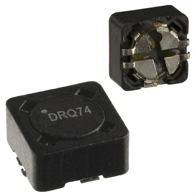

Technical Data DS4311 Effective September 2017 Supersedes April 2014 DRQ Dual winding, high power density, shielded drum core power inductors Applications • • • • • • • • • Product features • • • • • • • • Dual winding inductors that can be used as either a single inductor, or in coupled inductor/transformer applications (1:1 turns ratio) Four sizes of shielded drum core inductors Windings can be connected in series or parallel, offering a broad range of inductance and current ratings Peak current ratings from 0.13 A to 56 A RMS current ratings from 0.128 A to 17.9 A Inductance ratings from 0.33 µH to 4.02 mH 200 Vac Isolation between windings Ferrite core material Desktop and servers DVD and media players Portable and handheld devices LCD panels As a transformer: SEPIC, flyback As an inductor: buck, boost, coupled inductor DC-DC Converters VRM inductor for CPU and DDR power supplies Input and output filter chokes Environmental data • • • Storage temperature range (component): -40 °C to +125 °C Operating temperature range: -40 °C to +125 °C (ambient plus self-temperature rise) Solder reflow temperature: J-STD-020 (latest revision) compliant Pb HF FREE HALOGEN  Technical Data DS4311 Effective September 2017 Product specifications Parallel Ratings Part Number Rated Inductance (µH) OCL1 ±20% (µH) Irms2 (A) Isat3 (A) Peak DCR Ω4 typ. Volt5 µ-sec Irms2 (A) Isat3 (A) Peak DCR Ω4 typ. Volt5 µ-sec DRQ73-R33-R 0.33 0.306 6.19 14.4 0.0074 1.98 1.224 3.10 7.18 0.0296 3.96 DRQ73-1R0-R 1.00 0.992 5.25 7.97 0.0103 3.56 3.968 2.63 3.99 0.0411 7.12 DRQ73-1R5-R 1.50 1.482 4.64 6.52 0.0132 4.36 5.928 2.32 3.26 0.0527 8.72 DRQ73-2R2-R 2.20 2.070 4.11 5.52 0.0167 5.15 8.280 2.06 2.76 0.0669 10.3 DRQ73-3R3-R 3.30 3.540 3.31 4.22 0.0259 6.73 14.16 1.66 2.11 0.1035 13.5 DRQ73-4R7-R 4.70 4.422 3.09 3.78 0.0297 7.52 17.69 1.55 1.89 0.1188 15.0 DRQ73-6R8-R 6.80 6.480 2.55 3.12 0.0435 9.11 25.92 1.28 1.56 0.1742 18.2 DRQ73-8R2-R 8.20 8.930 2.19 2.66 0.0592 10.7 35.72 1.10 1.33 0.2368 21.4 DRQ73-100-R 10.0 10.30 2.08 2.47 0.0656 11.5 41.20 1.04 1.24 0.2623 23.0 DRQ73-150-R 15.0 15.01 1.83 2.05 0.0844 13.9 60.04 0.916 1.03 0.339 27.8 DRQ73-220-R 22.0 22.65 1.62 1.67 0.107 17.0 90.60 0.811 0.83 0.429 34.0 DRQ73-330-R 33.0 34.41 1.31 1.35 0.166 21.0 137.6 0.653 0.68 0.665 42.0 DRQ73-470-R 47.0 48.62 1.08 1.14 0.241 24.9 194.5 0.542 0.57 0.965 49.8 DRQ73-680-R 68.0 68.91 0.89 0.96 0.358 29.7 275.6 0.444 0.48 1.43 59.4 DRQ73-820-R 82.0 80.37 0.86 0.89 0.384 32.1 321.5 0.430 0.44 1.54 64.2 DRQ73-101-R 100 101.4 0.73 0.79 0.527 36.0 405.6 0.367 0.39 2.11 72.0 DRQ73-151-R 150 150.9 0.58 0.65 0.851 44.0 603.6 0.289 0.32 3.41 88.0 DRQ73-221-R 220 223.3 0.52 0.53 1.05 53.5 893.2 0.260 0.27 4.20 107 DRQ73-331-R 330 325.5 0.42 0.44 1.59 64.5 1302 0.211 0.22 6.36 129 DRQ73-471-R 470 465.8 0.35 0.37 2.36 77.2 1863 0.173 0.18 9.44 154 DRQ73-681-R 680 676.5 0.29 0.31 3.47 93.1 2706 0.143 0.15 13.88 186 DRQ73-821-R 820 821.7 0.27 0.28 3.93 103 3287 0.134 0.14 15.72 206 DRQ73-102-R 1000 995.0 0.26 0.25 4.34 113 3980 0.128 0.13 17.36 226 1. Open Circuit Inductance Test Parameters: 100 kHz, 0.25 Vrms, 0.0 Adc Parallel: (1,2 -4,3) Series: (1-4) tie (2-3) 2. RMS current for an approximate DT of 40 °C without core loss. It is recommended that the temperature of the part not exceed +125 °C. 3. Peak current for approximately 30% roll-off at +20 °C 4. DCR limits @ +20 °C 5. Applied Volt-Time product (V-µs) across the inductor. This value represents the applied V-µs at 100 kHz necessary to generate a core loss equal to 10% of the total losses for a 40 °C temperature rise. 2 Series Ratings OCL1 ±20% (µH) www.eaton.com/electronics 6. Turns Ratio (1:3):(2-4) 1:1 7. Part number definition: DRQxxx-yyy- DRQxxx = product code and size, - yyy = inductance value in µH, - R = decimal point. If no R is present, third character = # of zeros - “-R” suffix = RoHS complian DRQ Dual winding, high power density, shielded drum core power inductors Technical Data DS4311 Effective September 2017 Product specifications Parallel Ratings Series Ratings Part Number Rated Inductance (µH) OCL ±20% (µH) Irms2 (A) Isat (A) Peak DCR Ω4 Typ. Volt5 µ-sec OCL ±20% (µH) Irms2 (A) Isat3 (A) Peak DCR Ω4 Typ. Volt5 µ-sec DRQ74-R33-R 0.33 0.294 6.20 18.4 0.0074 1.71 1.176 3.10 9.18 0.0295 3.42 DRQ74-1R0-R 1.00 0.952 5.33 10.2 0.0100 3.08 3.808 2.66 5.10 0.0400 6.16 DRQ74-1R5-R 1.50 1.422 4.96 8.35 0.0115 3.76 5.688 2.48 4.17 0.0461 7.52 DRQ74-2R2-R 2.20 1.986 4.66 7.06 0.0130 4.45 7.944 2.33 3.53 0.0521 8.9 DRQ74-3R3-R 3.30 3.396 3.94 5.40 0.0183 5.81 13.58 1.97 2.70 0.0732 11.6 DRQ74-4R7-R 4.70 5.182 3.34 4.37 0.0254 7.18 20.73 1.67 2.19 0.102 14.4 DRQ74-6R8-R 6.80 7.344 2.60 3.67 0.0418 8.55 29.38 1.30 1.84 0.167 17.1 DRQ74-8R2-R 8.20 8.566 2.53 3.40 0.0441 9.23 34.26 1.27 1.70 0.177 18.5 DRQ74-100-R 10.0 9.882 2.41 3.17 0.0489 9.92 39.53 1.20 1.58 0.196 19.8 DRQ74-150-R 15.0 16.09 2.11 2.48 0.0637 12.7 64.36 1.05 1.24 0.255 25.4 DRQ74-220-R 22.0 21.73 1.75 2.13 0.0925 14.7 86.92 0.874 1.07 0.371 29.4 DRQ74-330-R 33.0 33.01 1.41 1.73 0.143 18.1 132.0 0.702 0.87 0.574 36.2 DRQ74-470-R 47.0 49.64 1.15 1.41 0.216 22.2 198.6 0.573 0.71 0.865 44.4 DRQ74-680-R 68.0 69.67 1.03 1.19 0.265 26.3 278.7 0.517 0.60 1.06 52.6 DRQ74-820-R 82.0 80.95 0.91 1.11 0.345 28.4 323.8 0.453 0.55 1.38 56.8 DRQ74-101-R 100 101.6 0.86 0.99 0.383 31.8 406.4 0.430 0.49 1.53 63.6 1 1 3 DRQ74-151-R 150 150.0 0.69 0.81 0.591 38.6 600.0 0.346 0.41 2.37 77.2 DRQ74-221-R 220 227.0 0.56 0.66 0.907 47.5 908.0 0.279 0.33 3.63 95 DRQ74-331-R 330 335.6 0.45 0.54 1.41 57.8 1342 0.224 0.27 5.66 116 DRQ74-471-R 470 465.3 0.40 0.46 1.74 68.1 1861 0.202 0.23 6.97 136 DRQ74-681-R 680 671.2 0.33 0.38 2.58 81.7 2685 0.166 0.19 10.3 163 DRQ74-821-R 820 812.7 0.31 0.35 2.93 89.9 3251 0.156 0.17 11.7 180 DRQ74-102-R 1000 1009 0.27 0.31 3.89 100 4036 0.135 0.16 15.6 200 1. Open Circuit Inductance Test Parameters: 100 kHz, 0.25 Vrms, 0.0 Adc Parallel: (1,2 -4,3) Series: (1-4) tie (2-3) 2. RMS current for an approximate DT of 40 °C without core loss. It is recommended that the temperature of the part not exceed +125 °C. 3. Peak current for approximately 30% roll-off at +20 °C 4. DCR limits @ +20 °C 5. Applied Volt-Time product (V-µs) across the inductor. This value represents the applied V-µs at 100 kHz necessary to generate a core loss equal to 10% of the total losses for a 40 °C temperature rise. 6. Turns Ratio (1:3):(2-4) 1:1 7. Part number definition: DRQxxx-yyy- DRQxxx = product code and size, - yyy = inductance value in µH, - R = decimal point. If no R is present, third character = # of zeros - “-R” suffix = RoHS complian www.eaton.com/electronics 3 DRQ Dual winding, high power density, shielded drum core power inductors Technical Data DS4311 Effective September 2017 Product specifications Rated Inductance Part Number (µH) Parallel Ratings OCL1 ±20% (µH) Series Ratings Irms2 (A) Isat3 (A) Peak DCR Ω4 typ. Volt5 µ-sec OCL1 ±20% (µH) Irms2 (A) Isat3 (A) Peak DCR Ω4 typ. Volt5 µ-sec DRQ125-R47-R 0.47 0.456 17.6 33.0 0.0018 3.17 1.824 8.80 16.5 0.0078 6.34 DRQ125-1R0-R 1.00 0.894 15.0 23.6 0.0024 4.43 3.576 7.51 11.8 0.0096 8.86 DRQ125-1R5-R 1.50 1.478 13.8 18.3 0.0029 5.70 5.912 6.89 9.15 0.0114 11.40 DRQ125-2R2-R 2.20 2.208 10.9 15.0 0.0045 6.97 8.832 5.46 7.50 0.0182 13.9 DRQ125-3R3-R 3.30 3.084 9.26 12.7 0.0063 8.23 12.34 4.63 6.35 0.0253 16.5 DRQ125-4R7-R 4.70 5.274 7.18 9.71 0.0105 10.8 21.10 3.59 4.86 0.0420 21.6 DRQ125-6R8-R 6.80 6.588 6.64 8.68 0.0123 12.0 26.35 3.32 4.34 0.0492 24.0 DRQ125-8R2-R 8.20 8.048 5.54 7.86 0.0176 13.3 32.19 2.77 3.93 0.0705 26.6 DRQ125-100-R 10.0 9.654 5.35 7.17 0.0189 14.6 38.62 2.67 3.59 0.0757 29.2 DRQ125-150-R 15.0 15.35 4.27 5.69 0.0298 18.4 61.40 2.13 2.85 0.120 36.8 DRQ125-220-R 22.0 22.36 3.70 4.71 0.0396 22.2 89.44 1.84 2.36 0.159 44.4 DRQ125-330-R 33.0 33.74 3.28 3.84 0.0505 27.2 135.0 1.64 1.92 0.203 54.4 DRQ125-470-R 47.0 47.47 2.71 3.24 0.0740 32.3 189.9 1.35 1.62 0.297 64.6 DRQ125-680-R 68.0 67.91 2.22 2.70 0.101 38.6 271.6 1.11 1.35 0.440 77.2 DRQ125-820-R 82.0 86.89 2.05 2.39 0.128 43.7 347.6 1.03 1.20 0.515 87.4 DRQ125-101-R 100 102.7 1.78 2.20 0.170 47.5 410.8 0.892 1.10 0.682 95.0 DRQ125-151-R 150 151.1 1.48 1.81 0.248 57.6 604.4 0.739 0.905 0.991 115.2 DRQ125-221-R 220 216.8 1.19 1.51 0.384 69.0 867.2 0.594 0.755 1.54 138 DRQ125-331-R 330 332.6 1.06 1.22 0.482 85.5 1330 0.530 0.610 1.93 171 DRQ125-471-R 470 473.1 0.87 1.02 0.718 102 1892 0.434 0.510 2.87 204 DRQ125-681-R 680 679.8 0.70 0.85 1.10 122 2719 0.350 0.425 4.42 244 DRQ125-821-R 820 828.0 0.60 0.77 1.49 135 3312 0.301 0.385 5.96 270 DRQ125-102-R 1000 1008 0.57 0.70 1.69 149 4032 0.283 0.350 6.76 298 1. Open Circuit Inductance Test Parameters: 100 kHz, 0.25 Vrms, 0.0 Adc Parallel: (1,2 -4,3) Series: (1-4) tie (2-3) 2. RMS current for an approximate DT of 40 °C without core loss. It is recommended that the temperature of the part not exceed +125 °C. 3. Peak current for approximately 30% roll-off at +20 °C 4. DCR limits @ +20 °C 5. Applied Volt-Time product (V-µs) across the inductor. This value represents the applied V-µs at 100 kHz necessary to generate a core loss equal to 10% of the total losses for a 40 °C temperature rise. 4 www.eaton.com/electronics 6. Turns Ratio (1:3):(2-4) 1:1 7. Part number definition: DRQxxx-yyy- DRQxxx = product code and size, - yyy = inductance value in µH, - R = decimal point. If no R is present, third character = # of zeros - “-R” suffix = RoHS complian Technical Data DS4311 DRQ Dual winding, high power density, shielded drum core power inductors Effective September 2017 Product specifications Parallel Ratings Rated Inductance (µH) OCL1 ±20% (µH) DRQ127-R47-R 0.47 DRQ127-1R0-R 1.00 DRQ127-1R5-R DRQ127-2R2-R Series Ratings 2 Isat3 (A) Peak 5 Volt µ-sec OCL1 ±20% (µH) Isat3 (A) Peak DCR Ω typ. DCR Ω4 typ. Volt5 µ-sec 0.419 17.9 56.0 0.821 15.5 40.0 0.00195 3.50 1.676 0.00261 4.90 3.284 8.94 28 0.0078 7.00 7.74 20 0.0104 9.80 1.50 1.357 13.5 2.20 2.027 12.5 31.1 0.00341 6.30 25.5 0.00373 7.70 5.428 6.77 15.6 0.0137 12.60 8.108 6.23 12.7 0.0161 15.4 DRQ127-3R3-R 3.30 2.831 10.4 21.5 0.00567 9.10 11.32 5.23 10.8 0.0229 18.2 DRQ127-4R7-R 4.70 DRQ127-6R8-R 6.80 4.841 8.25 16.5 7.387 7.34 13.3 0.00917 11.9 19.36 4.13 8.24 0.0367 23.8 0.0116 14.7 29.55 3.67 6.67 0.0465 29.4 DRQ127-8R2-R DRQ127-100-R 8.20 8.861 6.32 10.0 10.47 6.04 12.2 0.0157 16.1 35.44 3.16 6.09 0.0627 32.2 11.2 0.0172 17.5 41.88 3.02 5.60 0.0686 35.0 DRQ127-150-R 15.0 14.09 5.03 9.66 0.0247 20.3 56.36 2.51 4.83 0.0990 40.6 DRQ127-220-R 22.0 DRQ127-330-R 33.0 22.93 4.00 7.57 0.0391 25.9 91.72 2.00 3.78 0.157 51.8 33.92 3.23 6.22 0.0600 31.5 135.7 1.61 3.11 0.241 63.0 DRQ127-470-R 47.0 47.05 2.95 5.28 0.0719 37.1 188.2 1.47 2.64 0.288 74.2 DRQ127-680-R 68.0 66.48 2.44 4.44 0.105 44.1 265.9 1.22 2.22 0.421 88.2 DRQ127-820-R 82.0 79.75 2.09 4.06 0.143 48.3 319.0 1.04 2.03 0.573 96.6 DRQ127-101-R 100 99.31 1.96 3.64 0.163 53.9 397.2 0.980 1.82 0.653 107.8 DRQ127-151-R 150 144.9 1.59 3.01 0.247 65.1 579.6 0.796 1.51 0.989 130.2 DRQ127-221-R 220 221.5 1.29 2.43 0.376 80.5 886.0 0.645 1.22 1.50 161 DRQ127-331-R 330 323.6 1.04 2.01 0.574 97.3 1294 0.522 1.01 2.30 195 DRQ127-471-R 470 467.1 0.85 1.68 0.861 117 1868 0.427 0.838 3.44 234 DRQ127-681-R 680 676.7 0.76 1.39 1.08 141 2707 0.380 0.697 4.32 282 DRQ127-821-R 820 818.1 0.65 1.27 1.47 155 3272 0.325 0.633 5.88 310 DRQ127-102-R 1000 1005 0.61 1.14 1.66 172 4020 0.307 0.571 6.64 344 Part Number Irms (A) 1. Open Circuit Inductance Test Parameters: 100 kHz, 0.25 Vrms, 0.0 Adc Parallel: (1,2 -4,3) Series: (1-4) tie (2-3) 2. RMS current for an approximate DT of 40 °C without core loss. It is recommended that the temperature of the part not exceed +125 °C. 3. Peak current for approximately 30% roll-off at 20°C 4. DCR limits @ +20 °C 5. Applied Volt-Time product (V-µs) across the inductor. This value represents the applied V-µs at 100 kHz necessary to generate a core loss equal to 10% of the total losses for a 40 °C temperature rise. 4 Irms (A) 2 6. Turns Ratio (1:3):(2-4) 1:1 7. Part number definition: DRQxxx-yyy- DRQxxx = product code and size, - yyy = inductance value in µH, - R = decimal point. If no R is present, third character = # of zeros - “-R” suffix = RoHS complian www.eaton.com/electronics 5 DRQ Dual winding, high power density, shielded drum core power inductors Technical Data DS4311 Effective September 2017 Dimensions - mm DRQ73 Recommended Pad Layout Side View Top View 3.55 Max 1.00 1.73 1.00 0.40 0.40 • DRQ73 ### wllyy R 7.6 Max. 1.73 7.9 7.9 Dual Inductor Mode Bottom View Series Mode Schematic 6.1 0.73 Dual Inductor 0.60 Series Mode 1 7.6 Max. 2 L1 0.80 1 L2 2 L1 4 3 Parallel Mode L2 3 2 1 L1 4 L2 3 4 DRQ74 Recommended Pad Layout Side View Top View 4.45 Max • DRQ74 ### wllyy R 1.00 0.40 1.73 7.6 Max 7.9 7.9 Dual Inductor Mode Bottom View Series Mode Schematic 0.73 Dual Inductor 7.6 Max 0.60 1.73 1.00 0.40 1 2 L1 3 Parallel Mode Series Mode 1 L2 2 L1 4 3 1 2 L1 L2 4 3 L2 4 6.1 ### = Inductance value per family chart wllyy = Date code R = Revision level Dot indicates pin #1 Do not route traces or vias underneath the inductor 6 www.eaton.com/electronics DRQ Dual winding, high power density, shielded drum core power inductors Technical Data DS4311 Effective September 2017 Dimensions - mm DRQ125 Side View Top View 6.00 Max DRQ125 ### wwlly y R 2 3.85 2.50 4 4 2 12.5 Max 3 0.50 3.85 1 • 1 Recommended Pad Layout 2.50 3 1 4 2 3 0.50 13.80 13.80 Dual Inductor Mode Series Mode Bottom View 2.05 Schematic 2.00 2 3 1 4 Dual Inductor 12.5 Max 1 2 L1 1 L2 3 10.0 Parallel Mode Series Mode L1 4 1 2 L1 L2 3 2 L2 3 4 4 DRQ127 Side View Top View 1 2 Recommended Pad Layout 8.0 Max • DRQ127 ### wwll yy R 2.50 4 2.50 12.5 Max 3 0.50 3.85 3.85 1 4 2 3 0.50 13.80 13.80 Dual Inductor Mode Series Mode Bottom View 2.05 Schematic 2.00 2 3 1 4 10.0 12.5 Max Dual Inductor 1 L1 3 Series Mode 2 1 4 3 L2 L1 Parallel Mode 2 1 4 3 L2 2 L1 L2 4 ### = Inductance value per family chart wwllyy = (date code) R = revision level Dot indicates pin #1 Do not route traces or vias underneath the inductor www.eaton.com/electronics 7 DRQ Dual winding, high power density, shielded drum core power inductors Technical Data DS4311 Effective September 2017 Packaging information- mm DRQ73 Supplied in tape and reel packaging, 1350 parts per reel, 13" diameter reel. ACTUAL SIZE DRQ73 Ao=7.90mm Bo=7.90mm Ko=3.80mm Direction of Feed DRQ74 Supplied in tape and reel packaging, 1100 parts per reel, 13" diameter reel. Ø1.50 +0.1/-0.0 2.00 ±0.1 Ø1.50 Min. 4.00 A 1.75±0.10 1 2 7.50±0.1 DRQ74 ### Bo ACTUAL SIZE DRQ74 4 3 Ao=7.90mm Bo=7.90mm Ko=4.70mm 16.00 ±0.3 A Ko Direction of Feed 12.00 0 Ao SECTION A-A DRQ125 Supplied in tape and reel packaging, 600 parts per reel, 13" diameter reel. 4.0 1.5 dia +0.1/-0.0 2.0 1.5 dia min A 1.7 1 2 11.5 • 24.0 +/-0.3 DRQ125 ### wwllyy B0 K0 A0 SECTION A-A DRQ127 ACTUAL SIZE DRQ125 4 3 Ao=13.00mm Bo=13.00mm Ko=6.30mm Direction of Feed A 16.00 4.0 Supplied in tape and reel packaging, 350 parts per reel, 13" diameter reel. 1.5 dia +0.1/-0.0 2.0 1.5 dia min A 1.7 R0.3 max. 1 2 11.5 . K0 SECTION A-A Dimensions are in millimeters. 8 www.eaton.com/electronics ACTUAL SIZE DRQ127 4 3 Ao=13.00mm Bo=13.00mm Ko=8.30mm 24.0 +/-0.3 DRQ127 ### wwllyy B0 A0 20.00 Direction of Feed A R0.5 TYP. DRQ Dual winding, high power density, shielded drum core power inductors Technical Data DS4311 Effective September 2017 Core loss z KH Hz 25 10 50 K 0K Hz Hz 0K 20 30 0K Hz % of Losses from Irms (max) Irms Derating with Core Loss % of Applied Volt-µsecond Inductance characteristics DRQ73 DRQ74 100 100 90 80 80 60 OCL (%) OCL (%) 70 50 40 60 40 30 20 20 10 0 0 20 40 60 80 100 120 140 160 0 % of I sat 0 20 40 60 80 DRQ125 140 180 160 100 90 90 80 80 70 70 60 OCL (%) OCL (%) 120 DRQ127 100 50 40 60 50 40 30 30 20 20 10 0 100 % of I sat 10 0 10 20 30 40 50 60 70 80 % of I sat 90 100 110 120 130 140 150 0 0 10 20 30 40 50 60 70 80 90 100 110 120 130 150 140 % of I sat www.eaton.com/electronics 9 DRQ Dual winding, high power density, shielded drum core power inductors Technical Data DS4311 Effective September 2017 Solder Reflow Profile TP tP Max. Ramp Up Rate = 3°C/s Max. Ramp Down Rate = 6°C/s Temperature TL 25°C Preheat A T smax t TC -5°C Table 1 - Standard SnPb Solder (Tc) Volume mm3 220°C 220°C Table 2 - Lead (Pb) Free Solder (T c) Tsmin ts Package Thickness 2.5mm Time 25°C to Peak Volume mm3 2000 260°C 245°C 245°C Time Reference JDEC J-STD-020 Profile Feature Preheat and Soak • Temperature min. (Tsmin) • Temperature max. (Tsmax) • Time (Tsmin to Tsmax) (ts) Average ramp up rate Tsmax to Tp Liquidous temperature (TL) Time at liquidous (tL) Peak package body temperature (TP)* Time (tp)** within 5 °C of the specified classification temperature (Tc) Average ramp-down rate (Tp to Tsmax) Time 25°C to Peak Temperature Standard SnPb Solder 100°C Lead (Pb) Free Solder 150°C 150°C 200°C 60-120 Seconds 60-120 Seconds 3°C/ Second Max. 3°C/ Second Max. 183°C 60-150 Seconds 217°C 60-150 Seconds Table 1 Table 2 20 Seconds** 30 Seconds** 6°C/ Second Max. 6°C/ Second Max. 6 Minutes Max. 8 Minutes Max. * Tolerance for peak profile temperature (Tp) is defined as a supplier minimum and a user maximum. ** Tolerance for time at peak profile temperature (tp) is defined as a supplier minimum and a user maximum. Life Support Policy: Eaton does not authorize the use of any of its products for use in life support devices or systems without the express written approval of an officer of the Compan . Life support systems are devices which support or sustain life, and whose failure to perform, when properly used in accordance with instructions for use provided in the labeling, can be reasonably expected to result in significant inju y to the user. Eaton reserves the right, without notice, to change design or construction of any products and to discontinue or limit distribution of any products. Eaton also reserves the right to change or update, without notice, any technical information contained in this bulletin. Eaton Electronics Division 1000 Eaton Boulevard Cleveland, OH 44122 United States www.eaton.com/electronics © 2017 Eaton All Rights Reserved Printed in USA Publication No. DS4311 BU-SB14113 September 2017 Eaton is a registered trademark. All other trademarks are property of their respective owners.

物料型号: - DRQ系列,包括DRQ73、DRQ74、DRQ125、DRQ127等不同型号,具体型号根据额定电感值不同而有所区别。
器件简介: - 这些是双绕组、高功率密度、带屏蔽的鼓形芯电源电感器,可以作为单个电感器使用,或在耦合电感器/变压器应用中使用(1:1匝数比)。
引脚分配: - 文档中提供了不同型号的推荐焊盘布局,包括顶视图、侧视图和底视图,以及电路图的串联和并联模式。
参数特性: - 包括额定电感值、并联和串联的峰值电流、直流电阻(DCR)、电压-秒(Volts-sec)等参数,以及环境数据,如存储温度范围、操作温度范围和焊接回流温度。
功能详解: - 这些电感器适用于多种应用,包括桌面和服务器、DVD和媒体播放器、便携式和手持设备、LCD面板、DC-DC转换器、CPU和DDR电源供应的VRM电感器、输入和输出滤波器电感器。
应用信息: - 适用于多种电子产品,包括但不限于上述提到的应用场景。
封装信息: - 提供了不同型号的尺寸信息和包装信息,包括胶带和卷轴包装,以及每卷的数量和卷径。
