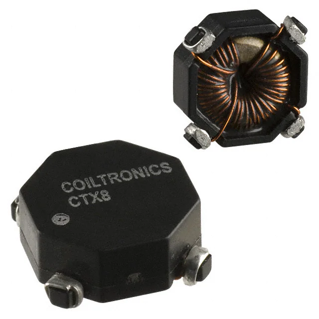

Technical Data DS4314 Effective July 2017 Supersedes June 2017 ECONO-PAC™/OCTA-PAC® OCTA-PAC® PLUS Dual winding toroid power inductors/transformers Applications • • • • • • Computer and portable power devices LCD panels, DVD players Inductor: DC-DC converters Buck, boost, forward, and resonant converters Noise filtering and filter chokes Transformers: 1:1 300 Vdc isolation, flyback, sepic Part number • Product features • • • • • • Surface mount magnetics that can be used as single or coupled inductors or 1:1 transformers that provide isolation between two windings OCTA-PAC’s are designed around high frequency, low loss core material ECONO-PAC’s are a lower cost version of OCTAPAC’s offering high saturation flux density, Iron powder core material OCTA-PAC PLUS’s offer higher current ratings and higher saturation flux densities than OCTAPAC and ECONO-PAC, Amorphous metal core material Secure 4 Terminal Mounting Inductor more versatile inductance combination by series or parallel connections s u , l 1 P 3 r ac 3A) e P b o a is t t , c c y r A O nto O , -2 d e e A u v 1 n i n ( i t n il t o n c dis 7 or u 201 leted. dep • CTX___-__ -R(First three digits CTX; Second 2-3 digits = Inductance Value; Last 1-2 digits, product size & type) -R indicates RoHS compliant Product size/type • • • CTX___-1 (-1 = size; no suffix = OCTA-PAC®) CTX___-1P (-1 = size; P suffix = ECONOPAC™) CTX___-1A (-1 = size; A suffix = OCTA-PAC® PLUS) Environmental data • • • Storage temperature range (component): -40 °C to +125 °C Operating temperature range: -40 °C to +125 °C (ambient plus self-temperature rise) Solder reflow temperature: J-STD-020 (latest revision) compliant Pb HF FREE HALOGEN  Technical Data DS4314 Effective July 2017 PARALLEL Part Number 2 Open Circuit Inductance µH +/-20% Full Load Inductance µH min. SERIES Full Load Current Adc DC Resistance ohms max. Open Circuit Inductance µH +/-20% Full Load Inductance µH min. Full Load Current Adc DC Resistance ohms max. CTX0.47-1P-R CTX0.68-1P-R CTX1-1P-R CTX2-1P-R CTX5-1P-R CTX8-1P-R CTX10-1P-R CTX15-1P-R CTX20-1P-R CTX25-1P-R CTX33-1P-R CTX50-1P-R CTX68-1P-R CTX100-1P-R CTX150-1P-R CTX200-1P-R CTX300-1P-R CTX0.47-2P-R CTX0.68-2P-R CTX1-2P-R CTX2-2P-R CTX5-2P-R CTX8-2P-R CTX10-2P-R CTX 15-2P-R CTX20-2P-R CTX25-2P-R CTX33-2P-R CTX50-2P-R CTX68-2P-R CTX100-2P-R CTX150-2P-R CTX200-2P-R CTX300-2P-R .42 .60 1.07 2.02 4.83 8.08 9.62 15.03 20.46 25.40 32.33 50.52 68.40 99.01 150.72 198.41 299.87 .54 .85 1.22 2.18 4.90 7.65 9.83 14.99 19.58 24.79 32.67 49.10 68.85 99.14 148.10 201.59 300.42 .31 .43 .73 1.36 3.37 5.31 6.23 9.62 14.12 17.07 22.27 33.57 43.65 63.64 96.64 130.79 190.05 .42 .64 .89 1.56 3.57 5.31 6.73 10.51 13.37 16.60 21.29 35.31 47.93 69.56 100.07 138.49 197.52 5.50 5.10 4.50 3.40 2.00 1.80 1.70 1.40 1.00 .96 .80 .70 .66 .54 .44 .36 .32 5.90 5.40 5.00 3.90 2.50 2.30 2.10 1.60 1.50 1.40 1.30 .82 .76 .62 .56 .46 .42 .005 .006 .008 .013 .040 .052 .057 .087 .158 .177 .250 .316 .373 .557 .844 1.208 1.525 .006 .007 .008 .014 .032 .040 .045 .085 .097 .109 .126 .305 .362 .541 .665 .951 1.176 1.67 2.40 4.28 8.08 19.31 32.33 38.48 60.12 81.83 101.60 129.32 202.07 273.61 396.06 602.87 793.65 1199.46 2.18 3.40 4.90 8.70 19.58 30.60 39.30 59.98 78.34 99.14 130.70 196.38 275.40 396.58 592.42 806.34 1201.70 1.25 1.74 2.92 5.44 13.47 21.23 24.94 38.47 56.47 68.29 89.06 134.27 174.61 254.55 386.56 523.16 760.19 1.69 2.55 3.57 6.26 14.26 21.23 26.92 42.02 53.48 66.38 85.17 141.24 191.71 278.22 400.27 553.97 790.08 2.75 2.55 2.25 1.70 1.00 .90 .85 .70 .50 .48 .40 .35 .33 .27 .22 .18 .16 2.95 2.70 2.50 1.95 1.25 1.15 1.05 .80 .75 .70 .65 .41 .38 .31 .28 .23 .21 .021 .025 .032 .054 .161 .207 .227 .348 .634 .708 1.001 1.263 1.490 2.227 3.376 4.831 6.100 .024 .029 .033 .055 .128 .158 .179 .339 .387 .436 .503 1.221 1.445 2.162 2.660 3.804 4.703 CTX0.47-3P-R CTX0.68-3P-R CTX1-3P-R CTX2-3P-R CTX5-3P-R CTX8-3P-R CTX10-3P-R CTX15-3P-R CTX20-3P-R CTX25-3P-R CTX33-3P-R CTX50-3P-R CTX68-3P-R CTX100-3P-R CTX150-3P-R CTX200-3P-R CTX300-3P-R CTX0.47-4P-R CTX0.68-4P-R CTX1-4P-R CTX2-4P-R CTX5-4P-R CTX8-4P-R CTX10-4P-R CTX15-4P-R CTX20-4P-R CTX25-4P-R CTX33-4P-R CTX50-4P-R CTX68-4P-R CTX100-4P-R CTX150-4P-R CTX200-4P-R CTX300-4P-R .46 .67 .91 1.85 4.74 8.16 9.79 14.50 20.15 25.33 32.63 50.02 68.84 101.31 149.85 200.10 298.39 .49 .76 1.10 1.95 5.15 7.81 9.88 14.76 20.62 25.65 33.21 48.80 67.37 99.09 149.45 200.11 298.93 .35 .50 .65 1.24 3.04 4.90 5.71 8.50 13.12 16.16 20.32 33.06 44.15 65.50 90.92 116.51 172.12 .37 .56 .81 1.42 3.56 5.15 6.70 9.52 13.44 17.17 22.93 32.21 43.04 69.54 101.46 131.37 188.03 6.20 5.70 5.40 4.60 3.20 2.80 2.70 2.20 1.50 1.40 1.30 .92 .84 .68 .64 .60 .50 7.90 7.20 5.90 4.60 3.30 3.00 2.50 2.30 1.90 1.60 1.30 1.20 1.10 .72 .64 .60 .54 .006 .007 .008 .011 .022 .030 .033 .050 .111 .125 .146 .277 .328 .501 .621 .731 .926 .005 .006 .008 .014 .027 .033 .047 .057 .084 .115 .166 .201 .238 .565 .696 .810 1.003 1.85 2.66 3.63 7.40 18.94 32.63 39.15 58.02 80.59 101.31 130.54 200.10 275.35 405.22 599.40 800.38 1193.55 1.95 3.05 4.39 7.81 20.62 31.23 39.53 59.05 82.47 102.60 132.86 195.20 269.50 396.38 597.80 800.44 1195.72 1.42 1.98 2.62 4.97 12.15 19.60 22.85 34.01 52.48 64.66 81.30 132.24 176.61 262.02 363.68 466.03 688.50 1.49 2.24 3.24 5.69 14.23 20.61 26.79 38.09 53.76 68.68 91.72 128.83 172.16 278.15 405.83 525.47 752.13 3.10 2.85 2.70 2.30 1.60 1.40 1.35 1.10 .75 .70 .65 .46 .42 .34 .32 .30 .25 3.95 3.60 2.95 2.30 1.65 1.50 1.25 1.15 .95 .80 .65 .60 .55 .36 .32 .30 .27 .025 .028 .032 .045 .090 .119 .131 .198 .443 .499 .571 1.108 1.312 2.005 2.483 2.925 3.702 .019 .023 .033 .055 .107 .131 .187 .228 .337 .461 .662 .805 .952 2.259 2.784 3.240 4.011 www.eaton.com/electronics Technical Data DS4314 ECONO-PAC™/OCTA-PAC® OCTA-PAC® PLUS Dual winding toroid power inductors/transformers Effective July 2017 PARALLEL Part Number CTX0.47-1-R CTX0.68-1-R CTX1-1-R CTX2-1-R CTX5-1-R CTX8-1-R CTX10-1-R CTX15-1-R CTX20-1-R CTX25-1-R CTX33-1-R CTX50-1-R CTX68-1-R CTX100-1-R CTX150-1-R CTX200-1-R CTX300-1-R CTX0.47-2-R CTX0.68-2-R CTX1-2-R CTX2-2-R CTX5-2-R CTX8-2-R CTX10-2-R CTX15-2-R CTX20-2-R CTX25-2-R CTX33-2-R CTX50-2-R CTX68-2-R CTX100-2-R CTX150-2-R CTX200-2-R CTX300-2-R CTX0.47-3-R CTX0.68-3-R CTX1-3-R C TX2-3-R CTX5-3-R CTX8-3-R CTX10-3-R CTX15-3-R CTX20-3-R CTX25-3-R CTX33-3-R CTX50-3-R CTX68-3-R CTX100-3-R CTX150-3-R CTX200-3-R CTX300-3-R CTX0.47-4-R CTX0.68-4-R CTX1-4-R CTX2-4-R CTX5-4-R CTX8-4-R CTX10-4-R CTX15-4-R CTX20-4-R CTX25-4-R CTX33-4-R CTX50-4-R CTX68-4-R CTX100-4-R CTX150-4-R CTX200-4-R CTX300-4-R SERIES Open Circuit Inductance µH +/-20% Full Load Inductance µH min. Full Load Current Adc DC Resistance ohms max. Open Circuit Inductance µH +/-20% Full Load Inductance µH min. Full Load Current Adc DC Resistance ohms max. .40 .63 .90 2.03 4.90 8.10 10.00 14.40 19.60 25.60 32.40 50.63 67.60 99.23 148.23 202.50 302.50 .42 .75 1.18 2.30 4.70 7.94 10.58 15.23 20.73 24.86 31.77 51.18 67.87 99.45 147.39 198.58 300.80 .38 .60 .86 1.94 4.70 7.78 9.60 15.00 20.18 24.58 32.86 50.78 67.42 101.40 149.78 198.74 301.06 .44 .78 1.23 1.76 4.90 8.28 9.60 14.16 19.60 25.92 33.12 50.18 67.08 99.23 148.23 200.70 298.12 .26 .41 .56 1.00 2.66 4.08 4.85 8.74 11.54 16.35 19.84 29.34 39.73 58.72 85.16 107.60 191.38 .29 .50 .76 1.27 2.66 4.18 5.18 8.53 12.36 16.09 15.90 28.79 38.71 57.45 93.46 122.94 169.06 .27 .42 .57 1.05 2.56 3.74 4.38 7.26 10.76 15.64 19.69 27.18 36.53 52.48 97.16 119.18 157.44 .32 .55 .85 1.06 2.59 4.29 4.82 6.76 10.68 13.32 16.82 25.03 35.29 54.56 77.17 111.08 147.92 5.50 4.50 4.20 4.10 2.30 2.00 1.90 1.10 1.00 .74 .72 .64 .54 .44 .38 .37 .22 6.50 5.50 4.60 4.50 3.00 2.60 2.50 1.70 1.30 1.00 1.40 .92 .78 .63 .43 .39 .38 6.00 5.00 4.80 4.70 3.00 2.80 2.70 2.00 1.50 .98 .96 .94 .80 .70 .38 .39 .40 7.00 6.00 5.00 4.90 4.40 3.50 3.40 3.00 2.10 2.00 1.80 1.50 1.20 .92 .82 .64 .62 .005 .006 .007 .010 .030 .039 .044 .080 .146 .167 .293 .365 .516 .784 .965 1.142 1.431 .005 .006 .007 .010 .021 .027 .031 .059 .107 .117 .105 .210 .303 .457 .560 .796 1.231 .005 .006 .007 .010 .019 .025 .028 .043 .078 .086 .083 .239 .277 .345 .430 .619 .951 .004 .005 .006 .007 .014 .018 .019 .024 .055 .063 .072 .111 .157 .302 .372 .545 .672 1.60 2.50 3.60 8.10 19.60 32.40 40.00 57.60 78.40 102.40 129.60 202.50 270.40 396.90 592.90 810.00 1210.00 1.69 3.01 4.70 9.21 18.80 31.77 42.30 60.91 82.91 99.45 127.09 204.73 271.47 397.81 589.57 794.30 1203.20 1.54 2.40 3.46 7.78 18.82 31.10 38.40 60.00 80.74 98.30 131.42 203.14 269.66 405.60 599.14 794.98 1204.22 1.76 3.14 4.90 7.06 19.60 33.12 38.42 56.64 78.40 103.68 132.50 200.70 268.32 396.90 592.90 802.82 1192.46 1.05 1.63 2.24 4.01 10.64 16.34 19.40 34.96 46.15 65.42 79.37 117.38 158.92 234.88 340.64 430.39 765.54 1.17 1.98 3.04 5.07 10.65 16.72 20.72 34.10 49.46 64.35 63.59 115.16 154.83 229.79 373.84 491.76 676.24 1.08 1.67 2.28 4.22 10.26 14.98 17.54 29.06 43.04 62.56 78.77 108.71 146.11 209.93 388.63 476.71 629.75 1.29 2.21 3.41 4.24 10.37 17.14 19.28 27.03 42.73 53.27 67.27 100.11 141.15 218.25 308.69 444.32 591.66 2.75 2.25 2.10 2.05 1.15 1.00 .95 .55 .50 .37 .36 .32 .27 .22 .19 .19 .11 3.25 2.75 2.30 2.25 1.50 1.30 1.25 .85 .65 .50 .70 .46 .39 .32 .22 .20 .19 3.00 2.50 2.40 2.35 1.50 1.40 1.35 1.00 .75 .49 .48 .47 .40 .35 .19 .20 .20 3.50 3.00 2.50 2.45 2.20 1.75 1.70 1.50 1.05 1.00 .90 .75 .60 .46 .41 .32 .31 .020 .024 .028 .040 .122 .157 .176 .319 .583 .668 1.171 1.461 2.064 3.137 3.861 4.567 5.724 .019 .024 .028 .038 .084 .108 .125 .236 .426 .466 .420 .839 1.214 1.828 2.241 3.184 4.929 .020 .024 .028 .040 .077 .099 .111 .172 .312 .346 .331 .956 1.109 1.381 1.718 2.475 3.083 .016 .020 .024 .028 .056 .072 .078 .096 .220 .253 .287 .443 .630 1.210 1.488 2.180 2.687 www.eaton.com/electronics 3 ECONO-PAC™/OCTA-PAC® OCTA-PAC® PLUS Dual winding toroid power inductors/transformers Technical Data DS4314 Effective July 2017 Part Number Rated Inductance (µH) CTX0.33-1A-R CTX0.68-1A-R CTX1-1A-R CTX2-1A-R CTX5-1A-R CTX8-1A-R CTX10-1A-R CTX15-1A-R CTX20-1A-R CTX25-1A-R CTX33-1A-R CTX50-1A-R CTX68-1A-R CTX100-1A-R CTX150-1A-R CTX200-1A-R CTX300-1A-R CTX0.33-2A-R CTX0.68-2A-R CTX1-2A-R CTX2-2A-R CTX5-2A-R CTX8-2A-R CTX10-2A-R CTX15-2A-R CTX20-2A-R CTX25-2A-R CTX33-2A-R CTX50-2A-R CTX68-2A-R CTX100-2A-R CTX150-2A-R CTX200-2A-R CTX300-2A-R CTX0.33-3A-R CTX0.68-3A-R CTX1-3A-R CTX2-3A-R CTX5-3A-R CTX8-3A-R CTX10-3A-R CTX15-3A-R CTX20-3A-R CTX25-3A-R CTX33-3A-R CTX50-3A-R 0.33 0.68 1.0 2.0 5.0 8.0 10.0 15.0 20.0 25.0 33.0 50.0 68.0 100.0 150.0 200.0 300.0 0.33 0.68 1.0 2.0 5.0 8.0 10.0 15.0 20.0 25.0 33.0 50.0 68.0 100.0 150.0 200.0 300.0 0.33 0.68 1.0 2.0 5.0 8.0 10.0 15.0 20.0 25.0 33.0 50.0 OCL (1) nominal +/-25% (µH) 0.402 0.752 1.18 2.30 4.70 7.94 10.58 15.23 20.73 24.86 34.26 51.18 67.87 99.45 147.4 198.6 300.8 0.284 0.675 1.26 1.98 5.06 7.90 11.38 15.48 20.22 25.60 34.84 49.38 66.44 102.38 152.9 197.5 303.7 0.368 0.688 1.08 2.11 5.20 8.43 9.68 15.52 20.81 24.77 33.71 49.71 I sat. (2) Amperes Peak 12.5 9.4 7.5 5.36 3.75 2.88 2.5 2.08 1.79 1.63 1.39 1.14 0.99 0.82 0.67 0.58 0.47 18.8 12.5 9.38 7.50 4.69 3.75 3.13 2.68 2.34 2.08 1.79 1.50 1.29 1.04 0.85 0.75 0.60 15.0 11.3 9.0 6.43 4.09 3.21 3.00 2.37 2.05 1.88 1.61 1.32 Parallel Ratings I rms. (3) DCR Ω (4) Amperes max. @ 20°C. 10.0 9.0 7.26 5.64 4.27 3.37 2.84 2.07 1.71 1.46 1.22 0.99 0.92 0.74 0.67 0.62 0.56 10.9 9.4 8.22 6.74 4.34 3.50 2.89 2.69 2.24 1.89 1.56 1.28 1.07 0.75 0.68 0.64 0.58 11.4 9.3 8.38 7.26 5.24 4.23 3.64 3.25 2.43 2.34 1.93 1.56 0.0037 0.0046 0.0070 0.012 0.020 0.033 0.046 0.087 0.127 0.173 0.249 0.381 0.437 0.686 0.832 0.963 1.181 0.0033 0.0045 0.0058 0.0090 0.021 0.032 0.047 0.054 0.078 0.111 0.162 0.240 0.342 0.695 0.842 0.950 1.174 0.0032 0.0048 0.0059 0.0079 0.015 0.023 0.032 0.039 0.071 0.076 0.112 0.171 Volt (7) µ-Sec .93 1.24 1.55 2.17 3.11 4.04 4.66 5.59 6.52 7.14 8.39 10.3 11.8 14.3 17.4 20.2 24.9 .85 1.28 1.71 2.14 3.42 4.27 5.13 5.98 6.84 7.69 8.97 10.7 12.4 15.4 18.8 21.4 26.5 0.97 1.29 1.61 2.26 3.54 4.51 4.83 6.12 7.09 7.73 9.02 11.0 OCL (1) nominal +/-25% (µH) 1.61 3.01 4.70 9.21 18.8 31.77 42.30 60.91 82.91 99.45 137.1 204.7 271.5 397.8 589.6 794.3 1203 1.14 2.70 5.06 7.90 20.22 31.60 45.50 61.94 80.90 102.38 139.4 197.5 265.8 409.5 611.8 790.0 1215 1.47 2.75 4.20 8.43 20.81 33.77 38.70 62.09 83.25 99.07 134.8 198.8 I sat. (2) Amperes Peak 6.25 4.69 3.75 2.68 1.88 1.44 1.25 1.04 0.89 0.82 0.69 0.57 0.49 0.41 0.33 0.29 0.23 9.38 6.25 4.69 3.75 2.34 1.88 1.56 1.34 1.17 1.04 0.89 0.75 0.65 0.52 0.43 0.38 0.30 7.50 5.63 4.50 3.21 2.05 1.61 1.50 1.18 1.02 0.94 0.80 0.66 Series Ratings I rms. (3) DCR Ω (4) Amperes max. @ 20°C. 4.98 4.48 3.63 2.82 2.13 1.69 1.42 1.03 0.86 0.73 0.61 0.49 0.46 0.37 0.33 0.31 0.28 5.47 4.68 4.11 3.37 2.17 1.75 1.45 1.35 1.12 0.94 0.78 0.64 0.54 0.38 0.34 0.32 0.29 5.72 4.64 4.19 3.63 2.62 2.12 1.82 1.63 1.22 1.17 0.96 0.78 0.015 0.0185 0.0282 0.0470 0.082 0.130 0.183 0.348 0.507 0.693 0.995 1.524 1.749 2.745 3.329 3.854 4.726 0.0132 0.0180 0.0233 0.035 0.084 0.129 0.188 0.218 0.313 0.443 0.649 0.961 1.367 2.778 3.366 3.800 4.697 0.0128 0.0194 0.0238 0.0317 0.061 0.093 0.126 0.158 0.282 0.306 0.449 0.686 Volt (7) µ-Sec 1.86 2.49 3.11 4.35 6.21 8.08 9.32 11.2 13.0 14.3 16.8 20.5 23.6 28.6 34.8 40.4 49.7 1.71 2.56 3.42 4.27 6.84 8.55 10.3 12.0 13.7 15.4 17.9 21.4 24.8 30.8 37.6 42.7 53.0 1.93 2.58 3.22 4.51 7.09 9.02 9.67 12.2 14.2 15.5 18.0 21.9 r ) o A 17 3 0 A 2 2 , , 1 A 3 1 r . e ( d b ete s o u l t c epl P O c a d d P e s i a u t n y c i r t O on o t n c e s i v d il in t n u 1) Open Circuit Inductance Test Parameters: 100kHz, 0.250 Vrms, 0.0 Adc Parallel: (1,4 - 3,2) Series: (1 - 3) tie (2 - 4) 2) Peak current for approximately 30% roll-off 3) RMS current, delta temp. of 40° C ambient temperature of 85° C 4) DCR @ 20°C 4 www.eaton.com/electronics 5) Hipot rating: winding to winding: 300Vdc min. 6) Turns Ratio: (1-2):(4-3) 1:1 7) Applied volt-time product (v-us) across the inductor. This value represents the applied V-us at 300KHz necessary to generate a core loss equal to 10% of the total losses for a 40°C temperature rise. Technical Data DS4314 ECONO-PAC™/OCTA-PAC® OCTA-PAC® PLUS Dual winding toroid power inductors/transformers Part Number Rated Inductance (µH) CTX68-3A-R CTX100-3A-R CTX150-3A-R CTX200-3A-R CTX300-3A-R CTX0.33-4A-R CTX0.68-4A-R CTX1-4A-R CTX2-4A-R CTX5-4A-R CTX8-4A-R CTX10-4A-R CTX15-4A-R CTX20-4A-R CTX25-4A-R CTX33-4A-R CTX50-4A-R CTX68-4A-R CTX100-4A-R CTX150-4A-R CTX200-4A-R CTX300-4A-R 68.0 100.0 150.0 200.0 300.0 0.33 0.68 1.0 2.0 5.0 8.0 10.0 15.0 20.0 25.0 33.0 50.0 68.0 100.0 150.0 200.0 300.0 OCL (1) nominal +/-25% (µH) 68.80 99.07 149.7 198.8 296.2 0.313 0.744 1.39 2.18 4.26 8.70 10.53 14.70 19.58 25.14 34.80 50.11 68.21 100.57 153.5 200.4 302.8 I sat. (2) Amperes Peak 1.13 0.94 0.76 0.66 0.54 22.5 15.0 11.25 9.00 6.43 4.50 4.09 3.46 3.00 2.65 2.25 1.88 1.61 1.32 1.07 0.94 0.76 Parallel Ratings I rms. (3) DCR Ω (4) Amperes max. @ 20°C. 1.28 1.05 0.86 0.71 0.56 12.2 10.6 9.23 8.38 7.21 5.49 4.67 3.87 3.62 3.02 2.49 2.05 1.70 1.37 1.10 0.92 0.75 1) Open Circuit Inductance Test Parameters: 100kHz, 0.250 Vrms, 0.0 Adc Parallel: (1,4 - 3,2) Series: (1 - 3) tie (2 - 4) 2) Peak current for approximately 30% roll-off 3) RMS current, delta temp. of 40° C ambient temperature of 85° C 4) DCR @ 20°C 0.253 0.379 0.571 0.829 1.309 0.0030 0.0040 0.0052 0.0063 0.0085 0.015 0.020 0.029 0.034 0.048 0.071 0.104 0.153 0.235 0.365 0.521 0.787 Effective July 2017 Volt (7) µ-Sec 12.9 15.5 19.0 21.9 26.7 0.98 1.47 1.96 2.45 3.44 4.91 5.40 6.38 7.36 8.34 9.81 11.8 13.7 16.7 20.6 23.6 29.0 OCL (1) nominal +/-25% (µH) 275.2 396.3 598.7 795.3 1185 1.25 2.98 5.57 8.70 17.05 34.80 42.11 58.81 78.30 100.51 139.2 200.4 272.8 402.3 613.9 801.8 1211 I sat. (2) Amperes Peak 0.56 0.47 0.38 0.33 0.27 11.25 7.50 5.63 4.50 3.21 2.25 2.05 1.73 1.50 1.32 1.13 0.94 0.80 0.66 0.54 0.47 0.38 Series Ratings I rms. (3) DCR Ω (4) Amperes max. @ 20°C. 0.64 0.53 0.43 0.35 0.28 6.09 5.28 4.62 4.19 3.61 2.74 2.33 1.94 1.81 1.51 1.25 1.03 0.85 0.69 0.55 0.46 0.37 1.013 1.514 2.283 3.315 5.236 0.0119 0.0158 0.0207 0.0251 0.0339 0.059 0.081 0.117 0.135 0.193 0.283 0.418 0.612 0.939 1.462 2.085 3.148 Volt (7) µ-Sec 25.8 30.9 38.0 43.8 53.5 1.96 2.94 3.93 4.91 6.87 9.81 10.8 12.8 14.7 16.7 19.6 23.6 27.5 33.4 41.2 47.1 57.9 5) Hipot rating: winding to winding: 300Vdc min. 6) Turns Ratio: (1-2):(4-3) 1:1 7) Applied volt-time product (v-us) across the inductor. This value represents the applied V-us at 300KHz necessary to generate a core loss equal to 10% of the total losses for a 40°C temperature rise. d e u n i til t n n o s u c u s r l i P o d 7 . ) c d a 1 A e t P 0 3 - , 2 ple a A t 1 2 c e 3 O A, er d s i 1 b (- to ory c O ent v n i www.eaton.com/electronics 5 Technical Data DS4314 Effective July 2017 ECONO-PAC™/OCTA-PAC® OCTA-PAC® PLUS Dual winding toroid power inductors/transformers Mechanical Diagrams CTX 1, 1P, 1A Series CTX 2, 2P, 2A Series CTX 3, 3P, 3A Series CTX 4, 4P, 4A Series Dimensions in Millimeters. 6 www.eaton.com/electronics wwllyy = (date code) R = revision level Technical Data DS4314 ECONO-PAC™/OCTA-PAC® OCTA-PAC® PLUS Dual winding toroid power inductors/transformers Effective July 2017 Packaging Information CTX 1, 1P, 1A Series ➞ Direction of Feed Parts packaged on 13" Diameter reel, 1,100 parts per reel. CTX 2, 2P, 2A Series Direction of Feed ➞ Parts packaged on 13" Diameter reel, 800 parts per reel. CTX 3, 3P, 3A Series Direction of Feed ➞ Parts packaged on 13" Diameter reel, 800 parts per reel. CTX 4, 4P, 4A Series Direction of Feed ➞ Parts packaged on 13" Diameter reel, 600 parts per reel. Dimensions are in millimeters. www.eaton.com/electronics 7 ECONO-PAC™/OCTA-PAC® OCTA-PAC® PLUS Dual winding toroid power inductors/transformers Technical Data DS4314 Effective July 2017 Performance Characteristics TEMPERATURE RISE VS. RATED CURRENT INDUCTANCE VS. CURRENT Max. Ambient plus Rise = 125°C 140 ECONO-PAC 120 Degrees C Percentage of Inductance 100 90 80 70 60 50 40 30 20 10 0 0.00 OCTA-PAC 100 ECONO-PAC & OCTA-PAC 80 60 40 20 0.25 0.50 0.75 1.00 1.25 1.50 1.75 2.00 2.25 0 0.00 2.50 0.25 0.50 Per Unit Full Load Current +5 Percentage Change in Inductance 1.50 1.75 2.00 2.25 2.50 • CURRENT LIMITATION: The maximum allowable currents are defined by the internal “hot-spot” temperatures which are limited to 130°C, including ambient. OCTA-PAC -15 1.25 • FREQUENCY RESPONSE: Wide-band frequency response to 1 megaHertz. ECONO-PAC -35 1.00 • INDUCTANCE VS. CURRENT: Inductance will fall off as DC Current is increased. (See Inductance vs. Current graph). INDUCTANCE VS. TEMPERATURE +8 +6 +4 +2 +0 -2 -4 -6 -8 -10 -12 -14 0.75 Per Unit Full Load Current +25 +45 +65 +85 +105 +125 Temperature in Degrees C. OCTA-PAC® PLUS Typical Inductance vs. DC Current OCTA-PAC® PLUS Winding Loss Derating with Core Loss 100 50 40 30 20 10 Hz Hz 10 0K 0K 0K 30 80 Hz 70 20 60 60 0K Hz % of OCL 70 40 50 50 80 20 1M Hz % of Losses from Irms (maximum) 0 90 90 92 94 95 96 97 98 99 0 10 0 20 40 60 80 100 % of Isat 8 www.eaton.com/electronics 120 140 160 180 200 20 30 40 50 60 80 100 200 300 400 500 600 % of Applied Volt-µ-Second Rating 800 1000 Technical Data DS4314 ECONO-PAC™/OCTA-PAC® OCTA-PAC® PLUS Dual winding toroid power inductors/transformers Effective July 2017 Solder Reflow Profile TP TC -5°C Temperature TL 25°C Preheat A T smax Table 1 - Standard SnPb Solder (Tc) tP Max. Ramp Up Rate = 3°C/s Max. Ramp Down Rate = 6°C/s t Volume mm3 220°C 220°C Table 2 - Lead (Pb) Free Solder (T c) Tsmin Package Thickness 2.5mm ts Time 25°C to Peak Volume mm3 2000 260°C 245°C 245°C Time Reference JDEC J-STD-020 Profile Feature Preheat and Soak • Temperature min. (Tsmin) • Temperature max. (Tsmax) • Time (Tsmin to Tsmax) (ts) Average ramp up rate Tsmax to Tp Liquidous temperature (TL) Time at liquidous (tL) Peak package body temperature (TP)* Time (tp)** within 5 °C of the specified classification temperature (Tc) Average ramp-down rate (Tp to Tsmax) Time 25°C to Peak Temperature Standard SnPb Solder 100°C Lead (Pb) Free Solder 150°C 150°C 200°C 60-120 Seconds 60-120 Seconds 3°C/ Second Max. 3°C/ Second Max. 183°C 60-150 Seconds 217°C 60-150 Seconds Table 1 Table 2 20 Seconds** 30 Seconds** 6°C/ Second Max. 6°C/ Second Max. 6 Minutes Max. 8 Minutes Max. * Tolerance for peak profile temperature (Tp) is defined as a supplier minimum and a user maximum. ** Tolerance for time at peak profile temperature (tp) is defined as a supplier minimum and a user maximum. Life Support Policy: Eaton does not authorize the use of any of its products for use in life support devices or systems without the express written approval of an officer of the Company. Life support systems are devices which support or sustain life, and whose failure to perform, when properly used in accordance with instructions for use provided in the labeling, can be reasonably expected to result in significant injury to the user. Eaton reserves the right, without notice, to change design or construction of any products and to discontinue or limit distribution of any products. Eaton also reserves the right to change or update, without notice, any technical information contained in this bulletin. Eaton Electronics Division 1000 Eaton Boulevard Cleveland, OH 44122 United States www.eaton.com/electronics © 2017 Eaton All Rights Reserved Printed in USA Publication No. DS4314 July 2017 Eaton is a registered trademark. All other trademarks are property of their respective owners.
CTX8-1P-R
物料型号:CTX___-__ -R(前三位CTX;次两位2-3位为电感值;最后1-2位,产品尺寸和类型)-R表示符合RoHS标准。
器件简介:ECONO-PAC™/OCTA-PAC® OCTA-PAC® PLUS是双绕组环形电源电感器/变压器,适用于计算机和便携式电源设备、LCD面板、DVD播放器等。
它们可以作为单个或耦合电感器使用,或作为提供两个绕组之间隔离的1:1变压器。
OCTA-PAC®设计采用高频、低损耗的芯材料,ECONO-PAC™是OCTA-PAC®的低成本版本,采用高铁粉芯材料,OCTA-PAC PLUS®提供比OCTA-PAC和ECONO-PAC更高的电流等级和更高的饱和磁通密度,采用非晶金属芯材料。
引脚分配:文档中未明确提供具体的引脚分配信息,但通常这类器件会有相应的PCB布局建议图。
参数特性:包括额定电感值、并联和串联的电感值、饱和电流、直流电阻、环境数据(存储温度范围、工作温度范围、焊接回流温度)等。
功能详解:电感器/变压器在DC-DC转换器中用于降压、升压、正向和共振转换器,以及噪声滤波和滤波扼流圈。
变压器用于1:1 300 Vdc隔离、反激和sepic。
应用信息:适用于计算机和便携式电源设备、LCD面板、DVD播放器等。
封装信息:产品尺寸和类型包括CTX___-1(尺寸;无后缀=OCTA-PAC®)、CTX___-1P(尺寸;P后缀=ECONO-PAC™)、CTX___-1A(尺寸;A后缀=OCTA-PAC® PLUS)。
环境数据:存储温度范围(元件):-40°C至+125°C;工作温度范围:-40°C至+125°C(环境加上自温升);焊接回流温度:符合J-STD-020(最新修订版)。
