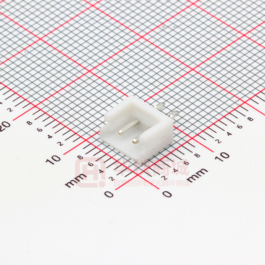

    线对板针座 1x2P 直插 间距:2.5mm
B2B-EH-A(LF)(SN) 数据手册
Radial Tape EH CONNECTOR 2.5mm pitch/Disconnectable Crimp style connectors 3 4 • Current rating: 3A AC, DC (AWG #22) • Voltage rating: 250V AC, DC • Temperature range: -25˚C to +85˚C (including temperature rise in applying electrical current) • Contact resistance: Initial value/ 10m Ω max. After environmental testing/ 20m Ω max. • Insulation resistance: 1,000M Ω min. • Withstanding voltage: 800V AC/minute • Applicable wire: AWG #32 to #22 • Applicable PC board thickness: 0.8 to 1.6mm 5 This, the thinnest, 2.5mm pitch connector, is 8.1mm in height after mounting and 3.8mm in width. It is designed to meet the demand for the high-density connection of internal wires to printed circuit boards. It is compact, highly reliable and low in cost. * Compliant with RoHS. * Refer to "General Instruction and Notice when using Terminals and Connectors" at the end of this catalog. * Contact JST for details. Standards –––––––––––––––––––––– 0 • Compact and slim • Highly reliable contact • Polarizing guides • Easy and effective crimping Top entry type 2.5 ±0.05 Recognized E60389 1 Certified LR20812 2 R50082349 Radial-tape Side entry type 2.5 min 2.5 ±0.05 3.8 +0.1 2.5 ±0.05 2.5 min +0.1  0 φ0.9 4.4 φ0.9 10.3 6.7 min 8.1 2.2 min 2.5 min +0.1  0 4.2 φ0.9 0 6.5 8.6 2 2.2 min H JST Specifications ––––––––––––––––––– Note: 1. The above figure is the figure viewed from soldering side. 2. Tolerances are non-cumulative: ±0.05mm for all centers. 3. Hole dimension differ according to the kind of PC board and piercing method. If PC boards made of hard material are used, the hole dimensions should be larger. The dimensions above should serve as a guideline. Contact JST for details. Contact Applicable wire mm2 AWG# Model No. SEH-001T-P0.6 *SEH-001T-P0.6L *SEH-002T-P0.6L *SEH-003T-P0.6L 5.7 2.85 2.05 1.1 Insulation O.D. (mm) 0.05 ∼0.33 30∼22 1.0∼1.9 0.13 ∼0.33 26∼22 0.9∼1.9 0.05 ∼0.13 30∼26 0.9∼1.3 0.032∼0.08 32∼28 0.5∼1.1 Q'ty / reel 9,000 10,000 2 Material and Finish Phosphor bronze, tin-plated (reflow treatment) RoHS compliance Note: 1. Contact JST for gold-plated products. 2. SEH-00( )T-P0.6L is low-insertion force type contact, for easier insertion/withdrawal, which would be less resistant to the vibration. The crimp height is different from the standard contact. 3. *Marked products are not TÜV approved. 4. Contact JST for details. 1.6 Contact Crimping machine Crimp applicator MKS-L SEH-001T-P0.6 AP-K2N SEH-001T-P0.6L *MKS-SC Applicator Dies Crimp applicator with dies MK/SEH-001-06 APLMK SEH001-06 SC/SEH-001-06 APLSC SEH001-06 MKS-L MK/SEH-001-06L APLMK SEH001-06L *MKS-SC SC/SEH-001-06L APLSC SEH001-06L Contact Crimping machine Crimp applicator MKS-L SEH-002T-P0.6L AP-K2N SEH-003T-P0.6L − Applicator Dies Crimp applicator with dies MK/SEH-002-06L APLMK SEH002-06L − − MKS-L-10 MK/SEH-003-06L APLMK SEH003-06L *MKS-SC-10 SC/SEH-003-06L APLSC SEH003-06L Note: *Strip-crimp applicator 1 EH CONNECTOR Housing Circuits Model No. 2 EHR-2 EHR-3 EHR-4 EHR-5 EHR-6 EHR-7 EHR-8 EHR-9 EHR-10 EHR-11 EHR-12 EHR-13 EHR-14 EHR-15 3 B 4 A 5 (2.25)(2.5) 6 3.8 0.6 7 8 H JST 2 3 6 9 7 10 6.5 11 12 13 14 15 Dimensions (mm) A B Q'ty / bag 2.5 7.0 1,000 5.0 9.5 1,000 7.5 12.0 1,000 10.0 14.5 1,000 12.5 17.0 1,000 15.0 19.5 1,000 17.5 22.0 1,000 20.0 24.5 1,000 22.5 27.0 1,000 25.0 29.5 1,000 27.5 32.0 1,000 30.0 34.5 1,000 32.5 37.0 1,000 35.0 39.5 1,000 0.7 Circuit No.1 Material PA 66, UL94V-0, natural (white) RoHS compliance As the color identification, the following alphabet shall be put in the underlined part. For availability, delivery and minimum order quantity, contact JST. ex. EHR-2-oo(blank)…natural (white) K…black R…red TR…tomato red E…blue Y…yellow L…lemon yellow M…green O…orange N…brown PL…purple PK…pink H…gray LE…light blue FY…vivid yellow Shrouded header The shrouded headers are interchangeable with those of the HR crimp style and insulation displacement connectors. Top entry type Circuits 3.3 3.2 6 3.8 0.64 Circuit No.1 (2.5) (1.6) A 3.8 5.1 3.3 6 (3 to 15 circuits) Dimensions (mm) Q'ty / box Top entry Side entry type type A B S2B-EH 2.5 7.5 1,000 1,000 S3B-EH 5.0 10.0 1,000 1,000 B4B-EH-A S4B-EH 7.5 12.5 1,000 1,000 5 B5B-EH-A S5B-EH 10.0 15.0 1,000 1,000 6 B6B-EH-A S6B-EH 12.5 17.5 1,000 500 7 B7B-EH-A S7B-EH 15.0 20.0 1,000 500 8 B8B-EH-A S8B-EH 17.5 22.5 500 500 9 B9B-EH-A S9B-EH 20.0 25.0 500 500 10 B10B-EH-A S10B-EH 22.5 27.5 500 500 11 B11B-EH-A S11B-EH 25.0 30.0 500 250 12 B12B-EH-A S12B-EH 27.5 32.5 500 250 13 B13B-EH-A S13B-EH 30.0 35.0 250 250 14 B14B-EH-A S14B-EH 32.5 37.5 250 250 15 B15B-EH-A S15B-EH 35.0 40.0 250 250 (2 circuits) B Model No. Top entry Side entry type type 2 B2B-EH-A 3 B3B-EH-A 4 3.2 Material and Finish 2.5 Post: Brass, copper-undercoated, tin-plated (reflow treatment) Wafer: PA 66, UL94V-0, natural (white) 0.64 Circuit No.1 (2.5) (1.6) A B Side entry type RoHS compliance This product displays (LF)(SN) on a label. Note: Also available and identified as model BxxB-EH is a top entry type having a post extension length of 4.0mm As the color identification, the following alphabet shall be put in the underlined part. For availability, delivery and minimum order quantity, contact JST. 4.2 6.7 5.2 2.2 6 4 ex. 0.64 2.5 Circuit No.1 (2.5) A B 2 3.2 B2B-EH-A-oo(blank)…natural (white) K…black R…red E…blue Y…yellow M…green ex. S2B-EH-oo(blank)…natural (white) K…black R…red TR…tomato red E…blue Y…yellow L…lemon yellow M…green O…orange N…brown P…purple PK…pink H…gray LE…light blue FY…vivid yellow EH CONNECTOR Shrouded header on radial-tape ●TS type 7.5 2.5 (2 circuits) 2.2 2 5.4 6.5 3 4 5 (1) 1.5 Model No. TS type TV4 type B2B-EH-TS − B3B-EH-TS B3B-EH-TV4 B4B-EH-TS B4B-EH-TV4 B5B-EH-TS B5B-EH-TV4 B6B-EH-TS B6B-EH-TV4 B7B-EH-TS B7B-EH-TV4 B8B-EH-TS B8B-EH-TV4 Circuits 4.4 φ0.64 6 7 8 Dimensions (mm) Q'ty / box A B − − 1,400 5.0 10.0 1,400 7.5 12.5 700 10.0 15.0 700 12.5 17.5 700 15.0 20.0 700 17.5 22.5 700 Material and Finish Pin/Post: Brass, copper-undercoated, tin-plated (reflow treatment) Wafer: PA 66, UL94V-0, natural (white) RoHS compliance This product displays (LF)(SN) on a label. (3 to 8 circuits) B A 4.4 2.5 2.5 2.2 φ0.64 As the color identification, the following alphabet shall be put in the underlined part. For availability, delivery and minimum order quantity, contact JST. 5.6 (1) B2B-EH-TS-oo(blank)…natural (white) K…black R…red E…blue Y…yellow M…green N…brown φ0.64 2.8 6.5 1.5 ex. Taping specifications 2 and 3 circuits: 12.7 4 to 8 circuits: 25.4 ●TV4 type B 4.4 2.5 20 2.2 0.64 18 5.6 6.5 9 6 A 2.5 φ4 2.8 (φ0.7 ) (φ0.7 ) 2 circuits: 5.1 3 to 8 circuits: 3.85 2 circuits: 2.5 3 to 8 circuits: 5 12.7 Note: Conforms to JIC C 0806 of "Tape packaging of components with unidirectional leads on continuous tapes". Packaging specifications Package type Distance between folds Box size D Distance between the end of the tape and the first connector’s center line (either end) H TERMIN ALS & CONN ECTORS Quantity 2, 3 circuits 4∼8 circuits Flat pack (zigzag folded) 24 indexing holes per fold (304.8mm) 316(W)×45(D)×330(H)mm 19.05mm 1,400 pcs. / box 700 pcs. / box Note: Products of different packaging specifications are also available. Contact JST for details. R W Distance between the end of the tape and the first connector's center line (either end) Tail tape Leader tape 3
