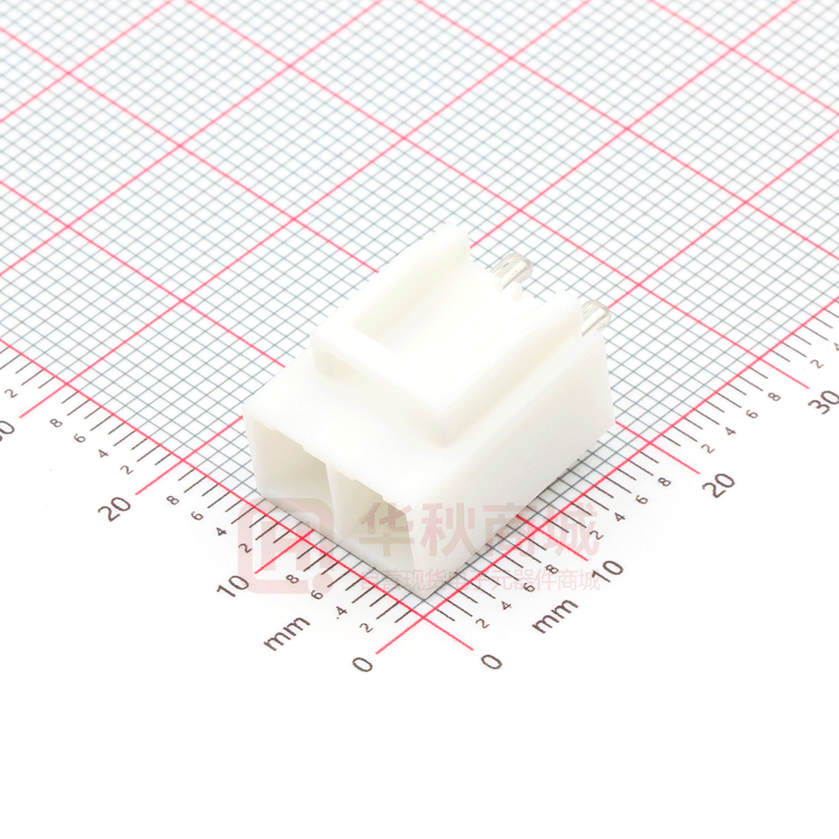

VL CONNECTOR 6.2mm pitch/Disconnectable Crimp style connectors (Combined use for both wire-to-board and wire-to-wire connections) Specifications ––––––––––––––––––– a L JS T 0 • Current rating: 20 A AC, DC (Refer to the following table.) • Voltage rating: 600 V AC, DC • Temperature range: -25˚C to +90˚C (including temperature rise in applying electrical current) • Contact resistance: Initial value/ 7 mΩ max. After environmental tests/ 10 mΩ max. • Insulation resistance: 1,000 MΩ min. • Withstanding voltage: 2,000 VAC/minute • Applicable wire: AWG #22 to #12 • Applicable PC board thickness: 1.6 mm * In using the products, refer to "Handling Precaution for Terminal and Connector" described on our website (Technical documents of Product information page). * Contact JST for details. * RoHS2 compliance Note: The current rating differs depending on the number of circuits and the wire size used in each connector. The table below lists the current rating as a function of the number of circuits and the wire size. Current unit: A This VL connector is 6.2 mm pitch wire-towire and wire-to-board connector, designed for large current. Secondary retainer, which prevents from insufficient insertion of contact and coming off contact, may use and large current circuit can be connected certainly and safety. • Housing lances • Retainer • Suited for large current • Compatible for both wire-to-wire and wire-toboard connections No. of circuits #12 #14 2 3 4 6 8 12 20 17 16 15 14 13 15 14 13 12 11 10 Wire size (AWG) #16 #18 10 9 9 8 7 7 #20 #22 6 6 6 5 5 4 4 4 4 3 3 3 8 8 7 7 6 6 Note: Do not branch in parallel current which exceeds the rated current (e.g. more than 17A in the case of 3 circuits with AWG #12). If branched in parallel, current imbalance or other problems may develop. If it is absolutely necessary to branch such a large current in parallel, design the circuits without causing any imbalance and provide an extra margin for each circuit. Standards –––––––––––––––––––––– 0 Recognized E60389 1 Certified LR20812 2 R9351103 PC board layout and Assembly layout (19.3) (13.2) ±0.05 A±0.1 6.2 ±0.05 φ2.1 ±0.05 3.6 min Inner-housing lock (15.6) 8.28 ±0.05 (21.7) (29.2) 6.84 min Inner-housing lock Outer-housing lock (29.2) 6.2 3.6 min 3.4 min A ±0.1 (29.2) 4 circuits (Single-row):φ1.8 ±0.05 2, 3 circuits:φ2.1 ±0.05 (29.2) Outer-housing lock Note: 1. The above figure is the figure viewed from soldering side. 2. Tolerances are non-cumulative: ±0.05 mm for all centers. 3. Hole dimensions differ according to the type of PC board and piercing method. The dimensions above should serve as a guideline. Contact JST for details. 1 VL CONNECTOR Contact Applicable wire AWG # mm2 4.1 Model No. SVF-42T-P2.0 SVF-61T-P2.0 SVF-81T-P2.0 16.7 3.6 2 Insulation O.D. (mm) Q'ty/ reel 0.3∼1.25 22∼16 1.7∼3.2 2,000 0.5∼2.0 20∼14 1.9∼3.4 2,000 3.5 12 4.1 2,000 1.7 3.1 Material and Finish Phosphor bronze, tin-plated (reflow treatment) RoHS2 compliance Applicator Crimping machine Crimp applicator Contact MKS-L SVF-42T-P2.0 Dies MK/SVF/M-42-20 APLMK SVF/M42-20 −− AP-K2N −− MKS-L SVF-61T-P2.0 SVF-81T-P2.0 −− −− Crimp applicator with dies MKS-L MK/SVF/M-81-20 AP-K2N APLMK SVF/M81-20 −− −− −− Note: Contact JST for fully automatic crimping applicator. MK/SVF/M-61-20 APLMK SVF/M61-20 −− Applicator Dies Crimping machine Crimp applicator Contact Crimp applicator with dies −− Housing (Inner-housing lock) 25.8 19.6 19.6 4 L JST 3 15.4 15.4 6 2 L JST L JST 15.4 5 L 2 1 1 3 4 2 3 2 6.2 6.2 6.2 2.8 11 13 11 13 13 13 13 11 11 11 2.8 2.8 2.8 2 1 1 2.8 1 JST 3 8.4 4 8 8.4 7 13.4 L JST 13.4 6 5 6.2 6.2 38.2 8 9 L JST 10 11 12 15.4 7 1 3 4 5 6 2.8 2 No. of circuits Model No. Q’ty/bag 2 VLP-02V VLP-03V VLP-04V VLP-06V VLP-08V VLP-12V 500 11 3 4 6 13 8 12 Material 6.2 PA 66, UL94V-0, natural (white) RoHS2 compliance Note: Contact JST for Glow Wire compliant connectors. 2 500 500 500 200 100 VL CONNECTOR Housing (Outer-housing lock) 15 25.8 19.6 3 4 L JST 8.4 15.4 4 1 1 5.2 1 5.2 3 2 8.4 1 3 13 11 13 13 13 11 11 11 5.2 2 5.2 8.4 L JST 2 L JST L JST 2 15 6.2 6.2 6.2 6.2 38.2 12 5 6 L JST 7 4 8 15.4 15.4 11 15.4 10 4 5 6 2 3 11 11 11 3 13 13 13 2 4 5.2 5.2 3 5.2 2 6 1 1 1 5 L JST L JST 6.2 9 25.8 8 19.6 7 6.2 6.2 No. of circuits 2 3 4 4 (Single-row) 6 8 12 Model No. VLP-02V-1 VLP-03V-1 VLP-04V-1 VLP-04VN-1 VLP-06V-1 VLP-08V-1 VLP-12V-1 Q’ty/bag 500 500 500 500 500 500 500 Material PA 66, UL94V-0, natural (white) RoHS 2compliance Note: Contact JST for Glow Wire compliant connectors. 3 VL CONNECTOR Retainer 11.4 17.6 No. of circuits Model No. Q’ty/bag 2, 4 VLS-02V VLS-03V VLS-08V VLS-12V 1,000 3, 6 9.4 9.4 4 (Single-row) , 8 12 1,000 1,000 1,000 Material 5.9 5.9 Glass-filled PA 66, UL94V-0, natural (ivory) RoHS2 compliance 23.8 5.9 5.9 9.4 9.4 36.2 Header 11.2 8.2 18 15 B 3.6 3.6 16.4 16.4 B 1.8 1.6 1.6 1.8 4.84 6.2 2 8.28 6.2 A A 11.2 18 15 B 8.2 1.54 6.2 3.6 3.6 16.4 16.4 B 1.33 1.6 1.8 5 8.28 6.2 2 A A No. of circuits Model No. 2 B02P-VL B03P-VL B04P-VL B04P-VL-VN-1.8 B06P-VL B08P-VL B12P-VL 3 4 4 (Single-row) 6 8 12 Dimensions (mm) A B 6.2 13.4 100 12.4 19.6 100 6.2 13.4 100 18.6 26.2 100 12.4 19.6 50 18.6 26.2 50 31.0 38.6 35 Material and Finish Post: Copper-alloy, tin-plated (reflow treatment) Wafer: PA 66, UL94V-0, natural (white) 4 Q’ty/ box RoHS 2compliance Note: Contact JST for Glow Wire compliant connectors. VL CONNECTOR Contact position location numbers Inner-housing lock 3 6 2 5 1 4 2 4 1 3 L JST 6 12 4 8 5 11 3 7 4 10 2 6 3 9 1 5 2 8 1 7 L JST L L JST 3 2 1 JST 2 1 L JST L JST Outer-housing lock 1 1 4 3 3 2 L JST 1 3 6 2 5 1 4 L JST 6 12 4 8 5 11 3 7 4 10 2 6 3 9 2 8 1 7 1 5 L JST 2 L JST 2 4 L JST 1 3 L JST 2 L JST L JST Model number identification Connector Housing Form: S --- Strip form, B --- Loose piece Series name Shape: F --- Socket contact Applicable wire: 42 --- AWG #22 to #16 61 --- AWG #20 to #14 81 --- AWG #12 Surface finish: T --- Tin-plated (Reflow treatment) Material: P --- Phosphor bronze Terminal size Header Series name Part name: Plug No. of circuits: 2, 3, 4, 6, 8, 12 Flammability: V --- UL94V-0 Shape: None --- Inner lock 1 --- Outer lock Retainer Series name Assembly style: B --- Top entry type Part name: Retainer No. of circuits: 2, 3, 4, 6, 8, 12 No. of circuits: 2, 3, 4, 6, 8, 12 Series name Flammability: V --- UL94V-0 5
