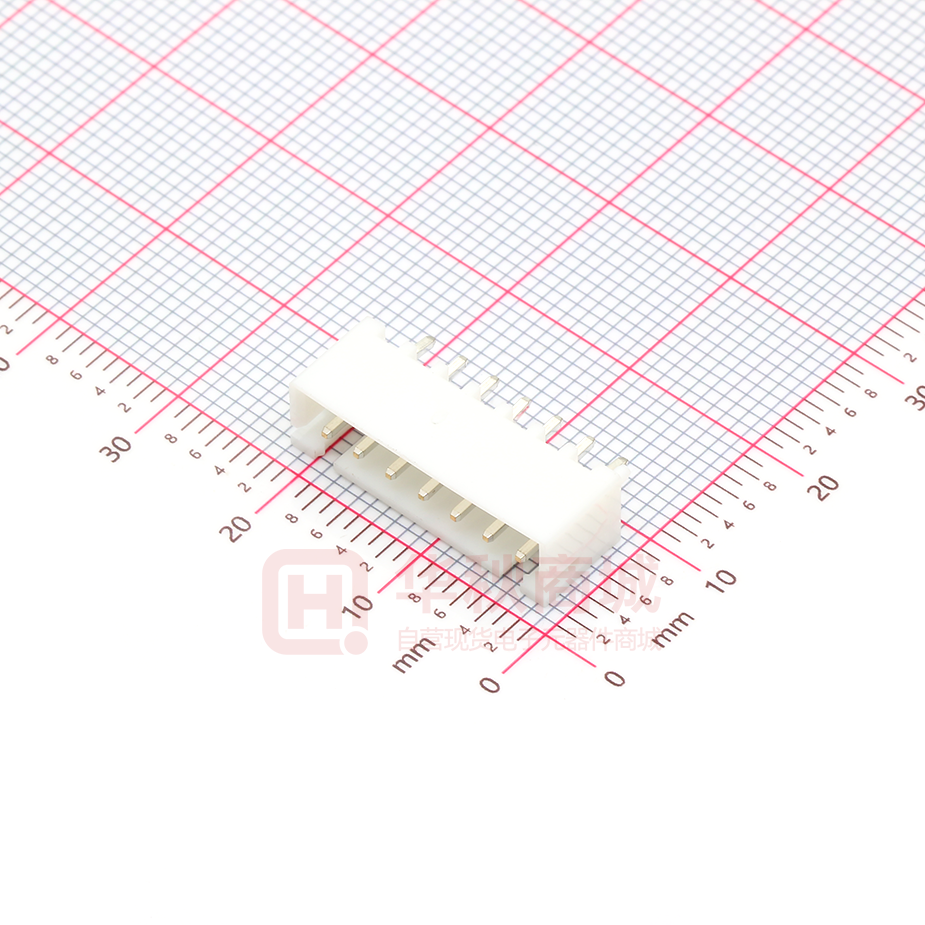

B7B-XH-AM(LF)(SN)
B7B-XH-AM(LF)(SN)
    JST
    插件,P=2.5mm
    线对板针座 1x7P 直插 间距:2.5mm
B7B-XH-AM(LF)(SN) 数据手册
Emboss Tape XH CONNECTOR Radial Tape 2.5mm pitch/Disconnectable Crimp style connectors Specifications ––––––––––––––––––– 1 • Current rating: 3 A AC, DC (AWG #22) • Voltage rating: 250 V AC, DC • Temperature range: -25˚C to +85˚C (including temperature rise in applying electrical current) • Contact resistance: Initial value/ 10 mΩ max. After environmental tests/ 20 mΩ max. • Insulation resistance: 1,000 MΩ min. • Withstanding voltage: 1,000 VAC/minute • Applicable wire: AWG #30 to #22 • Applicable PC board thickness: 1.6 mm 5 JS T The XH connector was developed based on the high reliability and versatility of our NH series connectors. The connector is very small with a mounting height of 9.8mm. * Refer to "General Instruction and Notice when using Terminals and Connectors" at the end of this catalog. * Contact JST for details. * Compliant with RoHS. • Original folded beam contact • Box-shaped shrouded header • Header with a boss • Interchangeability • Conforming to the HA terminal Standards –––––––––––––––––––––– 0 Recognized E60389 1 Certified LR20812 2 J50014297 PC board layout and Assembly layout 〈Through-hole type (viewed from soldening side)〉 Top entry type 5.75 2.5 ±0.05 Side entry type (2.5min) 2.5 ±0.05 (2.5min) 14.3 6.1 (9.2 min) 2 circuits:φ1 ±0.05 3 circuits or more:φ0.9 +0.1  0 7 (3.4min) 9.8 11.5 φ0.9 +0.1  0 Top entry type with a boss 2.5 ±0.05 5.75 1.6±0.05 9.8 4.35 ±0.05 2 ±0.05 3.4 min 2.5 min φ1.7 +0.1  0 7 φ1.1+0.2  0 ±0.05 2 circuits:φ1 +0.1 3 circuits or more:φ0.9 0 +0.1 φ0.9  0 Note: 1. Tolerances are non-cumulative: ±0.05 mm for all centers. 2. Hole dimensions differ according to the type of PC board and piercing method. If PC boards made of hard material are used, the hole dimensions should be larger. The dimensions above should serve as a guideline. Contact JST for details. 11 〈SMT type (viewed from component side)〉 Side entry type End face of wafer on the mating side 2.3 Note: 1. Tolerances are non-cumulative: ±0.05 mm for all centers. 2. The dimensions above should serve as a guideline. Contact JST for details. 1 1.8 3.9 0.2 6.5 1.3 2.5 XH CONNECTOR Contact ●Shape A 1.95 1.6 1.8 Model No. Shape SXH-001T-P0.6N SXH-001T-P0.6 SXH-002T-P0.6 A ●Shape B 2 B Applicable Wire AWG# mm2 Insulation O.D (mm) Q'ty/ reel 5,000 0.13∼0.33 26∼22 1.3∼1.9 0.08∼0.33 28∼22 0.9∼1.9 0.05∼0.13 30∼26 0.9∼1.3 8,000 2.4 2.35 Material and Finish Phosphor bronze, tin-plated (reflow treatment) 6.5 6.5 Contact Applicator Dies Crimping machine Crimp applicator SXH-001T-P0.6N AP-K2N SXH-001T-P0.6 RoHS compliance Note: 1. Contact JST if you require gold-plated contacts or contacts made of brass. 2. Contact JST also if you require shielded wires, thin wires or other special wires. 3. SXH-001T-P0.6N is low-insertion force type contact, for easier insertion/ withdrawal, which would be less resistant to the vibration. Crimp applicator with dies MKS-L MK/SXH-001-06N APLMK SXH001-06N *MKS-SC SC/SXH-001-06N APLSC SXH001-06N MKS-L MK/SXH-001-06 APLMK SXH001-06 *MKS-SC SC/SXH-001-06 APLSC SXH001-06 Applicator Dies Crimp applicator with dies MKS-L MK/SXH-002-06 APLMK SXH002-06 *MKS-SC SC/SXH-002-06 APLSC SXH002-06 Crimping machine Crimp applicator Contact SXH-002T-P0.6 AP-K2N Note: *Strip-crimp applicator Housing Circuits 7.75 1 2 2 4.1 3 5.7 4 5 6 Circuit No.1 mark 6 2.5 A 7 B C 8 9 10 ●Plugged up 11 12 13 7.75 14 15 16 20 4.1 Model No. XHP-1 XHP-2 XHP-2(10.0)-U  XHP-3 XHP-4 XHP-5 XHP-6 XHP-6(5.0)-U XHP-7 XHP-8 XHP-9 XHP-10 XHP-11 XHP-12 XHP-13 XHP-14 XHP-15 XHP-16 XHP-20 5.7 A Dimensions (mm) B C Q'ty/ bag ― 3.2 4.8 1,000 2.5 5.7 7.3 1,000 10.0 13.2 14.8 1,000 5.0 8.2 9.8 1,000 7.5 10.7 12.3 1,000 10.0 13.2 14.8 1,000 12.5 15.7 17.3 1,000 25.0 28.2 29.8 1,000 15.0 18.2 19.8 1,000 17.5 20.7 22.3 1,000 20.0 23.2 24.8 1,000 22.5 25.7 27.3 1,000 25.0 28.2 29.8 1,000 27.5 30.7 32.3 1,000 30.0 33.2 34.8 1,000 32.5 35.7 37.3 1,000 35.0 38.2 39.8 1,000 37.5 40.7 42.3 1,000 47.5 50.7 52.3 500 Material PA 6, UL94V-0, natural (white) Circuit No.1 mark RoHS compliance Note: 1. XHP-2(10.0)-U is 2 circuits 10.0mm pitch plugged up. ¨ V approved. Not UL/CSA/TU 2. XHP-6(5.0)-U is 6 circuits 5.0mm pitch plugged up. ¨ V approved. Not UL/CSA/TU A B C 7.75 As the color identification, the following alphabet shall be put in the underlined part. For availability, delivery and minimum order quantity, contact JST. ex. 4.1 5.7 Circuit No.1 mark XHP-1-oo(blank)…natural (white) BK…black R…red E…blue Y…yellow L…lemon yellow M…green D…orange N…brown FY…vivid yellow ex. A B XHP-2(10.0)-U-oo(blank)…natural (white) R…red E…blue C 2 XH CONNECTOR Through-hole type shrouded header The shrouded headers are interchangeable with those of the NR and NRD insulation displacement connectors, and JQ board-to-board connectors. Top entry type Circuits □0.64 2 ●plugged up 7 2 3 4 3.4 5 6 2.45 A 7 (2.35) B 8 5.75 9 Top entry type 10 11 0.64 12 0.64 13 14 7 7 15 16 3.4 3.4 20 (2.35) B (2.35) A 2.45 Side entry type RoHS compliance This product displays (LF)(SN) on a label. Note: B2(10.0)B-XH-A-U is 2 circuits 10.0mm pitch plugged up. ¨ V approved. Not UL/CSA/TU 0.64 11.5 7 2.5 2.45 Post: Brass, copper-undercoated, tin-plated (reflow treatment) Wafer: PA 66, UL94V-0, natural (white) 5.75 B 5.75 S( )B-XH-A-1: 7.6 S( )B-XH-A: 9.2 A Dimensions (mm) Model No. Q'ty/box A B Side entry type Top entry type Side entry type 7.4 2.5 1,000 1,000 S2B-XH-A-1 S2B-XH-A – 14.9 10.0 1,000 — — 1,000 9.9 5.0 1,000 S3B-XH-A-1 S3B-XH-A 500 12.4 7.5 500 S4B-XH-A-1 S4B-XH-A 500 14.9 10.0 500 S5B-XH-A-1 S5B-XH-A 500 17.4 12.5 500 S6B-XH-A-1 S6B-XH-A 250 19.9 15.0 500 S7B-XH-A-1 S7B-XH-A 250 22.4 17.5 250 S8B-XH-A-1 S8B-XH-A 250 24.9 20.0 250 S9B-XH-A-1 S9B-XH-A 250 27.4 22.5 250 S10B-XH-A-1 S10B-XH-A 250 29.9 25.0 250 S11B-XH-A-1 S11B-XH-A 200 32.4 27.5 250 S12B-XH-A-1 S12B-XH-A 200 34.9 30.0 250 S13B-XH-A-1 S13B-XH-A 200 37.4 32.5 250 S14B-XH-A-1 S14B-XH-A 100 39.9 35.0 250 S15B-XH-A-1 S15B-XH-A 100 42.4 37.5 200 — S16B-XH-A – 52.4 47.5 100 — — Material and Finish 2.5 2.45 Top entry type B2B-XH-A B2(10.0)B-XH-A-U B3B-XH-A B4B-XH-A B5B-XH-A B6B-XH-A B7B-XH-A B8B-XH-A B9B-XH-A B10B-XH-A B11B-XH-A B12B-XH-A B13B-XH-A B14B-XH-A B15B-XH-A B16B-XH-A B20B-XH-A (6.1) A As the color identification, the following alphabet shall be put in the underlined part. For availability, delivery and minimum order quantity, contact JST. ex. 3.4 B S3B-XH-A(-1)-oo(blank)…natural (white) BK…black R…red E…blue Y…yellow L…lemon yellow M…green D…orange N…brown FY…vivid yellow Through-hole type shrouded header Top entry type of glass-filled nylon 0.64 Circuits Model No. 2 B2B-XH-2 B3B-XH-2 B4B-XH-2 B5B-XH-2 B6B-XH-2 B7B-XH-2 B8B-XH-2 B9B-XH-2 B10B-XH-2 B11B-XH-2 B12B-XH-2 B13B-XH-2 B14B-XH-2 B15B-XH-2 3 7 4 5 3.4 6 2.45 7 8 5.75 A B 9 6.75 10 11 12 7 13 14 3.4 15 2.5 6.75 B 7.4 1,000 5.0 9.9 1,000 7.5 12.4 500 10.0 14.9 500 12.5 17.4 500 15.0 19.9 500 17.5 22.4 250 20.0 24.9 250 22.5 27.4 250 25.0 29.9 250 27.5 32.4 250 30.0 34.9 250 32.5 37.4 250 35.0 39.9 250 RoHS compliance This product displays (LF)(SN) on a label. As the color identification, the following alphabet shall be put in the underlined part. For availability, delivery and minimum order quantity, contact JST. 7 3.4 ex. 2.5 .45 0.64 A B 3 5.75 Q’ty/ bag 2.5 Post: Brass, copper-undercoated, tin-plated (reflow treatment) Wafer: Glass-filled PA 66, UL94V-0, natural (ivory) 5.75 A Dimensions (mm) B Material and Finish 0.64 2.45 A B2B-XH-2-oo(blank)…natural (ivory) C…black R…red E…blue Y…yellow M…green XH CONNECTOR Through-hole type shrouded header The shrouded headers are interchangeable with those of the NR and NRD insulation displacement connectors, and JQ board-to-board connectors. Top entry type with a boss Circuits Model No. 1 *B1B-XH-AM B2B-XH-AM B3B-XH-AM B4B-XH-AM B5B-XH-AM B6B-XH-AM B7B-XH-AM B8B-XH-AM B9B-XH-AM B10B-XH-AM B12B-XH-AM 2 0.64 3 4 7 5 6 2.7 3.4 7 8 1.5 (2.35) 4.9 9 4.35 10 5.75 12 A Dimensions (mm) B Q'ty/ box ― ― 1,000 2.5 7.4 1,000 5.0 9.9 1,000 7.5 12.4 500 10.0 14.9 500 12.5 17.4 500 15.0 19.9 500 17.5 22.4 250 20.0 24.9 250 22.5 27.4 250 27.5 32.4 250 Material and Finish 0.64 7 As the color identification, the following alphabet shall be put in the underlined part. For availability, delivery and minimum order quantity, contact JST. 1.5 RoHS compliance This product displays (LF)(SN) on a label. ¨ V standards. Note: *Marked product is not approved by UL/CSA/TU 3.4 Post: Brass, copper-undercoated, tin-plated (reflow treatment) Wafer: PA 66, UL94V-0, natural (white) φ1 2.45 (2.35) 1.6 A B 2 ex. 5.75 3.4 1.5 7 B1B-XH-AM-oo(blank)…natural (white) BK…black R…red E…blue Y…yellow L…lemon yellow M…green 0.64 2.5 φ1 1.6 A (2.35) 2.45 2 5.75 B SMT type shrouded header 0.64 B Q'ty/ reel S3B-XH-SM4-TB 5.0 12.5 500 S4B-XH-SM4-TB 7.5 15.0 500 S6B-XH-SM4-TB 12.5 20.0 500 Model No. 3 4 6 5.5 Material and Finish Post: Copper alloy, copper-undercoated, tin-plated (reflow treatment) Wafer: PA 6T, UL94V-0, natural (ivory) Solder tab: Brass, copper-undercoated, tin-plated (reflow treatment) 2.5 RoHS compliance This product displays (LF)(SN) on a label. Note: The products listed above are supplied on embossed-tape. A B 7 (3) As the color identification, the following alphabet shall be put in the underlined part. For availability, delivery and minimum order quantity, contact JST. ex. 6 3.75 Dimensions (mm) A Circuits S3B-XH-SM4-oo-TB(blank)…natural (ivory) M…green R…red E…blue L…lemon yellow 4 XH CONNECTOR Through-hole type shrouded header on radial-tape TV4 type 2-TV4 type 2-TV4 type B B A 6.75 2.45 Circuits 2 3 4 5 6 7 8 6.75 2.45 2.5 6.75 Model No. TV4 2-TV4 ― B2B-XH-2-TV4 B3B-XH-TV4 B3B-XH-2-TV4 B4B-XH-TV4 B4B-XH-2-TV4 ― B5B-XH-2-TV4 ― B6B-XH-2-TV4 ― B7B-XH-2-TV4 ― B8B-XH-2-TV4 7 7 φ0.7) (  2.8 0.64 A 2.5 φ0.7) (  0.64 Dimensions (mm) A B ― ― Q'ty/ box 1,000 5.0 9.9 1,000 7.5 12.4 500 10.0 14.9 500 12.5 17.4 500 15.0 19.9 500 17.5 22.4 500 2.8 2.5 7 2.45 7.4 0.64 φ0.7) (  RoHS compliance This product displays (LF)(SN) on a label. As the color identification, the following alphabet shall be put in the underlined part. For availability, delivery and minimum order quantity, contact JST. ex. B2B-XH-2-TV4-oo(blank)…natural (TV4 type/white, 2-TV4 type/ivory) C…black (glass-filled) BK…black R…red E…blue Y…yellow M…green Material and Finish Post: Brass, copper-undercoated, tin-plated (reflow treatment) Wafer: TV4 type/ PA 66, UL94V-0, natural (white) 2-TV4 type/ Glass-filled PA 66, UL94V-0, natural (ivory) Taping specification Packaging specifications D 2 and 3 circuits :12.7 4 to 8 circuits : 25.4 6.75 TERMIN H ALS & CONN ECTORS R 20 W 9 6 Distance between the end of the tape and the first connector's center line (either end) Leader tape 18 Tail tape φ4 2 circuits: 5.1 3 to 8 circuits: 3.85 2 circuits: 2.5 3 to 8 circuits: 5 12.7 Note: Conforms to JIC C 0806 of "Tape packaging of components with unidirectional leads on continuous tapes". 5 Package type Flat pack (zigzag folded) Distance between folds 24 indexing holes per fold (304.8 mm) Box size 316(W)×45(D)×330(H) mm Distance between the end of the tape and 19.05 mm the first connector’s center line (either end) 1,000 pcs. / box 2, 3 circuits Quantity 500 pcs. / box 4∼8 circuits Note: Products of different packaging specifications are also available. Contact JST for details.
