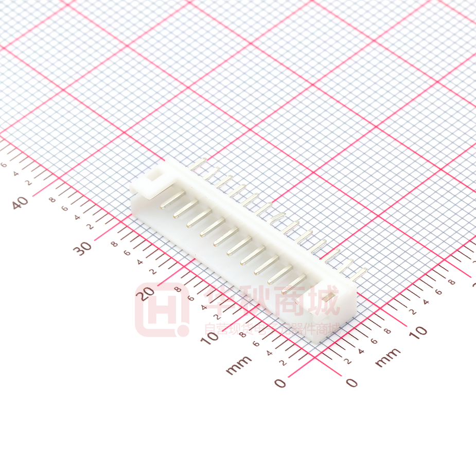

    线对板针座 1x15P 直插 间距:2mm
B15B-PH-K-S(LF)(SN) 数据手册
Emboss Tape PH CONNECTOR 2.0mm pitch/Disconnectable Crimp style connectors 6 5 Specifications ––––––––––––––––––– 4 3 2 This is a thin, low-profile 2.0mm pitch connector 8.0mm in height after mounting and 4.5mm in width. It is designed to meet the demand for high-density connection of internal wires to printed circuit boards. It is compact, highly reliable and low in cost. • Reliable contact • Fully shrouded header • Printed circuit board retention mechanism • Surface mount model (SMT) • Current rating: 2A AC, DC (AWG #24) • Voltage rating: 100V AC, DC • Temperature range: -25˚C to +85˚C (including temperature rise in applying electrical current) • Contact resistance: Initial value/ 10m Ω max. After environmental testing/ 20m Ω max. • Insulation resistance: 1,000M Ω min. • Withstanding voltage: 800V AC/ minute • Applicable wire: AWG #32 to #24 • Applicable PC board thickness: 0.8 to 1.6mm * Compliant with RoHS. * Refer to "General Instruction and Notice when using Terminals and Connectors" at the end of this catalog. * Contact JST for details. Standards –––––––––––––––––––––– 0 Recognized E60389 1 Certified LR20812 2 R75087 〈Through-hole type (viewed from soldering side) 〉 Side entry type Top entry type 4.5 2 ±0.05 2 ±0.05 9.6 +0.1 8 +0.1 φ0.7  0 6 φ0.7  0 4.8 7.6 6.25 Note: 1. Tolerances are non-cumulative: ±0.05mm for all centers. 2. Hole dimensions differ according to the kind of PC board and piercing method. If PC boards made of hard material are used, the hole dimensions should be larger. The dimensions above should serve as a guideline. Contact JST for details. 〈SMT type (viewed from component side) 〉 SM4 type Top entry type 1.6 ±0.1 2 ±0.05 5 1.5 (2) 1.6 1 min 2 ±0.05 5.5 max 3.4 9.6 7.6 1 5.5 6.6 8.6 2 max 7.5 min ±0.1 1 ±0.1 3 Circuit No.1 ±0.1 End face of wafer on the mating side 0.2 End face of wafer on the mating side ±0.1 9 min 1.6 ±0.1 SM4 type Side entry type 1 min Circuit No.1 Note: 1. Tolerances are non-cumulative: ±0.05mm for all centers. 2. The dimensions above should serve as a guideline. Contact JST for details. 1 PH CONNECTOR Contact Applicable wire Model No. 1.5 5.7 1 2.05 SPH-002T-P0.5S SPH-002T-P0.5L SPH-004T-P0.5S 2.08 2.85 mm2 AWG # Insulation O.D. (mm) 0.05 ∼ 0.22 30∼24 0.9∼1.5 0.08 ∼ 0.22 28∼24 0.8∼1.5 0.032∼0.08 32∼28 0.5∼0.9 Q'ty / reel 8,000 10,000 Material and Finish Phosphor bronze, tin-plated (reflow treatment) Crimping machine Contact Applicator Dies Crimp applicator MKS-L SPH-002T-P0.5S SPH-002T-P0.5L AP-K2N SPH-004T-P0.5S Crimp applicator with dies MK/SPH-002-05S APLMK SPH002-05S *MKS-SC SC/SPH-002-05S APLSC SPH002-05S MKS-L MK/SPH-002-05L APLMK SPH002-05L *MKS-SC SC/SPH-002-05L APLSC SPH002-05L MKS-L-10 MK/SPH-004-05S APLMK SPH004-05S *MKS-SC-10 SC/SPH-004-05S RoHS compliance Note: 1. Contact JST for gold-plated products. 2. SPH-002T-P0.5L is low-insertion force type contact, for easier insertion/ withdrawal, which would be less resistant to the vibration. The crimp height is different from the standard. 3. Contact JST for details. APLSC SPH004-05S Note: *Strip-crimp applicator Housing Circuits B 1.9 A 2 2 4.5 0.5 Circuit No.1 3 4 5 7 6.35 H JST 8 6 8 9 10 11 0.6 12 As the color identification, the following alphabet shall be put in the underlined part. For availability, delivery and minimum order quantity, contact JST. ex. 13 14 15 16 PHR-2-oo(blank)…natural (white) BK…black R…red TR…tomato red BL…blue Y…yellow L…lemon yellow M…green D…orange N…brown P…purple PK…pink H…gray LE…light blue FY…vivid yellow DPK...dark pink Model No. PHR-2 PHR-3 PHR-4 PHR-5 PHR-6 PHR-7 PHR-8 PHR-9 PHR-10 PHR-11 PHR-12 PHR-13 PHR-14 PHR-15 PHR-16 A Dimensions (mm) B Q'ty / box 2.0 5.8 1,000 4.0 7.8 1,000 6.0 9.8 1,000 8.0 11.8 1,000 10.0 13.8 1,000 12.0 15.8 1,000 14.0 17.8 1,000 16.0 19.8 1,000 18.0 21.8 1,000 20.0 23.8 1,000 22.0 25.8 1,000 24.0 27.8 1,000 26.0 29.8 1,000 28.0 31.8 1,000 30.0 33.8 1,000 Material PA 66, UL94V-0, natural (white) RoHS compliance Through-hole type shrouded header Top entry type Circuits 2 3 (2 circuits) (3 circuits or more) 4 4.5 4.5 1.7 B 5 1.7 B 6 7 8 6 6 9 10 1.95 A Circuit No.1 3.4 3.4 11 12 13 14 0.5 2 1.95 0.5 15 A Circuit No.1 16 Model No. Top entry type Side entry type B2B-PH-K-S S2B-PH-K-S B3B-PH-K-S S3B-PH-K-S B4B-PH-K-S S4B-PH-K-S B5B-PH-K-S S5B-PH-K-S B6B-PH-K-S S6B-PH-K-S B7B-PH-K-S S7B-PH-K-S B8B-PH-K-S S8B-PH-K-S B9B-PH-K-S S9B-PH-K-S B10B-PH-K-S S10B-PH-K-S B11B-PH-K-S S11B-PH-K-S B12B-PH-K-S S12B-PH-K-S B13B-PH-K-S S13B-PH-K-S B14B-PH-K-S S14B-PH-K-S B15B-PH-K-S S15B-PH-K-S B16B-PH-K-S S16B-PH-K-S Dimensions (mm) Q'ty / box A B Top entry type Side entry type 2.0 5.9 1,000 1,000 4.0 7.9 1,000 1,000 6.0 9.9 1,000 500 8.0 11.9 1,000 500 10.0 13.9 1,000 500 12.0 15.9 500 500 14.0 17.9 500 250 16.0 19.9 500 250 18.0 21.9 500 250 20.0 23.9 500 250 22.0 25.9 400 250 24.0 27.9 250 250 26.0 29.9 250 250 28.0 31.9 250 200 30.0 33.9 250 200 Material and Finish Side entry type Post: Brass, copper-undercoated, tin-plated (reflow treatment) Wafer: PA 66, UL94V-0, natural (white) 4.8 6 6.25 1.7 B RoHS compliance This product displays (LF)(SN) on a label. As the color identification, the following alphabet shall be put in the underlined part. For availability, delivery and minimum order quantity, contact JST. 2 1.95 2 0.5 A Circuit No.1 1.6 ex. 3.4 B2B-PH-K-ooS…natural (white) K…black R…red TR…tomato red E…blue Y…yellow L…lemon yellow M…green O…orange N…brown P…purple PK…pink H…gray LE…light blue FY…vivid yellow (blank)…ivory PH CONNECTOR Through-hole type shrouded header〈Low insertion force type〉 Top entry type Circuits (2 circuits) 2 (3 circuits or more) 3 4.5 B 4 4.5 1.7 B 5 1.7 6 6 6 7 8 9 1.95 A Circuit No.1 3.4 3.4 10 11 12 0.5 2 0.5 1.95 13 Circuit No.1 A 14 15 Side entry type 16 Model No. Top entry type Side entry type B2B-PH-KL S2B-PH-KL B3B-PH-KL S3B-PH-KL B4B-PH-KL S4B-PH-KL B5B-PH-KL S5B-PH-KL B6B-PH-KL S6B-PH-KL B7B-PH-KL S7B-PH-KL B8B-PH-KL S8B-PH-KL B9B-PH-KL S9B-PH-KL B10B-PH-KL S10B-PH-KL B11B-PH-KL S11B-PH-KL B12B-PH-KL S12B-PH-KL B13B-PH-KL S13B-PH-KL B14B-PH-KL S14B-PH-KL B15B-PH-KL S15B-PH-KL B16B-PH-KL S16B-PH-KL Q'ty / box Top entry type Side entry type 2.0 5.9 1,000 1,000 4.0 7.9 1,000 1,000 6.0 9.9 1,000 500 8.0 11.9 1,000 500 10.0 13.9 1,000 500 12.0 15.9 500 500 14.0 17.9 500 250 16.0 19.9 500 250 18.0 21.9 500 250 20.0 23.9 500 250 22.0 25.9 400 250 24.0 27.9 250 250 26.0 29.9 250 200 28.0 31.9 250 200 30.0 33.9 250 200 Material and Finish 4.8 Post: Copper alloy, copper-undercoated, tin-plated (reflow treatment) Wafer: PA 66, UL94V-0, gray 1.7 B Dimensions (mm) A B 6 6.25 RoHS compliance This product displays (LF)(SN) on a label. 0.5 A Circuit No.1 ex. 3.4 1.6 2 1.95 As the color identification, the following alphabet shall be put in the underlined part. For availability, delivery and minimum order quantity, contact JST. B2B-PH-KL-oo(blank)…gray R…red E…blue S…natural (white) SMT type shrouded header Model No. Top entry type Circuits Top entry type Side entry type B2B-PH-SM4-TB B3B-PH-SM4-TB B4B-PH-SM4-TB B5B-PH-SM4-TB B6B-PH-SM4-TB B7B-PH-SM4-TB B8B-PH-SM4-TB B9B-PH-SM4-TB B10B-PH-SM4-TB B11B-PH-SM4-TB B12B-PH-SM4-TB B13B-PH-SM4-TB B14B-PH-SM4-TB B15B-PH-SM4-TB B16B-PH-SM4-TB S2B-PH-SM4-TB S3B-PH-SM4-TB S4B-PH-SM4-TB S5B-PH-SM4-TB S6B-PH-SM4-TB S7B-PH-SM4-TB S8B-PH-SM4-TB S9B-PH-SM4-TB S10B-PH-SM4-TB S11B-PH-SM4-TB S12B-PH-SM4-TB S13B-PH-SM4-TB S14B-PH-SM4-TB S15B-PH-SM4-TB ― B 2.975 2 (2) 5 A 3 1.9 2 4 6.6 5 6 7 8 Circuit No.1 1.4 2.2 9 10 11 Side entry type 12 13 2.4 14 5.5 15 16 Dimensions (mm) B A Top entry type Side entry type Q'ty / reel 2.0 7.95 7.9 1,000 4.0 9.95 9.9 1,000 6.0 11.95 11.9 1,000 8.0 13.95 13.9 1,000 10.0 15.95 15.9 1,000 12.0 17.95 17.9 1,000 14.0 19.95 19.9 1,000 16.0 21.95 21.9 1,000 18.0 23.95 23.9 1,000 20.0 25.95 25.9 1,000 22.0 27.95 27.9 1,000 24.0 29.95 29.9 1,000 26.0 31.95 31.9 1,000 28.0 33.95 33.9 1,000 30.0 35.95 – 1,000 Material and Finish Circuit No.1 2.95 1.6 2 A 6 Post: Copper alloy, copper-undercoated, tin-plated (reflow treatment) Wafer: PA, UL94V-0, natural (ivory) Solder tab: Brass, copper-undercoated, tin-plated (reflow treatment) (2.6) B RoHS compliance This product displays (LF)(SN) on a label. Note: Contact JST for the top entry type headers with suction cap. As the color identification, the following alphabet shall be put in the underlined part. For availability, delivery and minimum order quantity, contact JST. ex. B2B-PH-SM4-oo-TB (blank)…natural (ivory) R…red E…blue M…green L…lemon yellow K…black DPK...dark pink 3
B15B-PH-K-S(LF)(SN)
物料型号:PH CONNECTOR
器件简介:这是一种薄型、低轮廓的2.0mm间距连接器,安装后高度为8.0mm,宽度为4.5mm,设计用于满足印刷电路板内部线缆的高密度连接需求。它紧凑、高可靠性且成本低廉。
引脚分配:文档中提供了详细的引脚分配图,包括直插型和SMT型的不同视图,以及公头和母头的尺寸数据。
参数特性: - 电流额定值:2A AC, DC (AWG #24) - 电压额定值:100V AC, DC - 温度范围:-25˚C 至 +85˚C - 接触电阻:初始值/10mΩ最大,环境测试后/20mΩ最大 - 绝缘电阻:1,000MΩ最小 - 耐电压:800V AC/分钟 - 适用线缆:AWG #32至#24 - 适用PC板厚度:0.8至1.6mm
功能详解:连接器具有可靠的接触,全屏蔽头,以及印刷电路板的固定机制。它还符合RoHS标准。
应用信息:适用于高密度连接,成本效益高,且符合环保要求。
封装信息:提供了不同电路数量的型号尺寸和每盒数量,例如PHR-2至PHR-16,以及SMT型的不同型号和尺寸。
