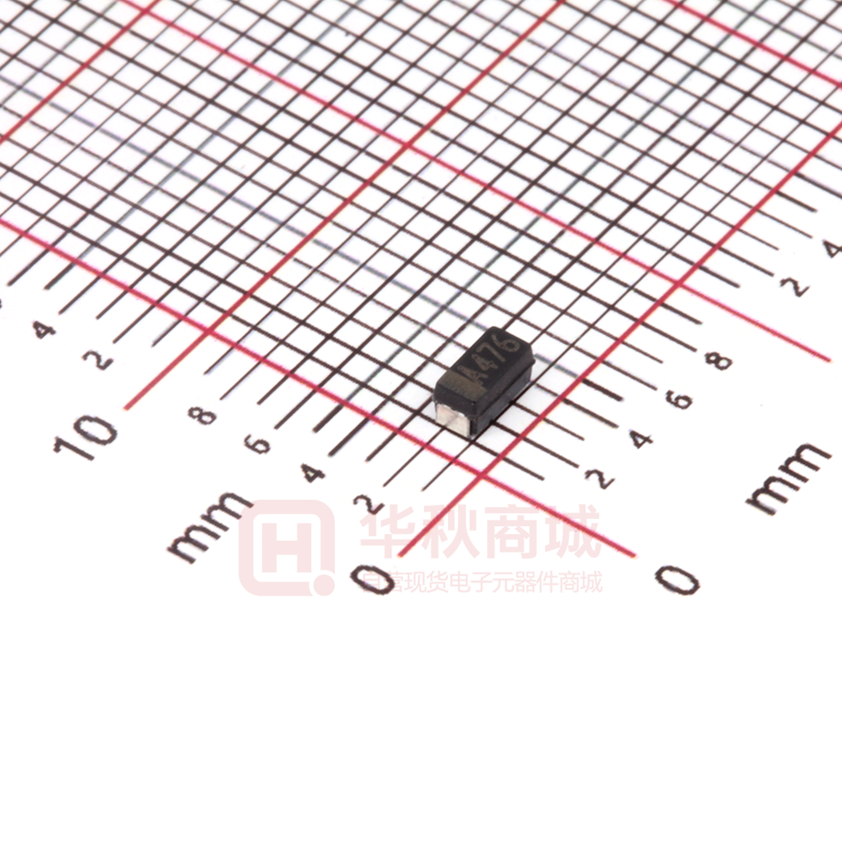

    钽电容 A3216-18 47µF ±10% 10V 4Ω 3.20 x 1.60mm 1.80mm
TC211A476K010B 数据手册
Chip Solid MnO2 Tantalum Capacitors – TC2 Series Operating Temp.: -55℃~+125℃ FEATURES Meets or exceeds EIA-535BAAC standard Self-healing capability, high reliability Excellent stability of capacitance during operating temperature range High volumetric efficiency 100% surge current test      APPLICATIONS Communication Consumer electronics Automotive electronics Instruments Medical electronics      PRODUCT IDENTIFICATION TC 212 B ① ① ② ③ 105 ④ ② Type TC ATC M 035 ⑤ ⑥ 211 212 214 ⑦ ③ Series Solid Tantalum Chip Capacitor B Industrial Low ESR Automotive Solid Tantalum Chip Cap. for Automotive (L×W) (mm) External Dimensions (L×W) (mm) A 3.2×1.6 B C D/E 3.5×2.8 6.0×3.2 7.3×4.3 ⑥ ④ Nominal Capacitance Example Nominal Value 105 1.0μF 106 10μF 002 004 006 010 016 020 025 035 050 ⑤ Capacitance Tolerance K M ±10% ±20% Rated DC Voltage 2.5Vdc 4Vdc 6.3Vdc 10Vdc 16Vdc 20Vdc 25Vdc 35Vdc 50Vdc ⑦ Internal Code B Y 、Black Molded Case, Laser Marking 、 Yellow Molded Case, Laser Marking SHAPE AND DIMENSIONS Unit: mm [inch] Sunlord Case EIA A 3216-18 B 3528-21 C 6032-28 D 7343-31 E 7343-43 L 3.20±0.20 [.126±.008] 3.50±0.20 [.138±.008] 6.00±0.30 [.236±.012] 7.30±0.30 [.287±.012] 7.30±0.30 [.287±.012] W 1.60±0.20 [.063±.008] 2.80±0.20 [.110±.008] 3.20±0.30 [.126±.012] 4.30±0.30 [.169±.012] 4.30±0.30 [.169±.012] H 1.60±0.20 [.063±.008] 1.90±0.20 [.075±.008] 2.50±0.30 [.098±.012] 2.80±0.30 [.110±.012] 4.00±0.30 [.161±.012] F 1.20±0.10 [.040±.004] 2.20±0.10 [.087±.004] 2.20±0.10 [.087±.004] 2.40±0.10 [.094±.004] 2.40±0.10 [.094±.004] Specifications subject to change without notice. Please check our website for latest information. S 0.80±0.30 [.031±.012] 0.80±0.30 [.030±.012] 1.30±0.30 [.051±.012] 1.30±0.30 [.051±.012] 1.30±0.30 [.051±.012] Revised 2017/04/15 Sunlord Industrial Park, Dafuyuan Industrial Zone, Guanlan, Shenzhen, China 518110 Tel: 0086-755-29832660 Fax: 0086-755-82269029 E-Mail: sunlord@sunlordinc.com TECHNICAL SPECIFICATION Item SPEC Operating Temp Test Condition -55℃~+125℃ CR Range CR Tolerance Rated Voltage (VR) Category Voltage (VC) Surge Voltage (VS) Surge Voltage (VS) 0.10μF~680μF 25℃, 120Hz ±10% or ±20% 25℃, 120Hz 2.5V 4V 6.3V 10V 16V 20V 25V 35V 50V 85℃ 1.6V 2.5V 4V 6.3V 10V 13V 16V 20V 32V 125℃ 3.3V 5.2V 8V 13V 20V 26V 32V 46V 65V 85℃ 2.2V 3.4V 5V 8V 13V 16V 20V 28V 40V 125℃ STANDARD C-V VALUE BY CASE CODE Rated Voltage (VR) Voltage Code 2.5 4 6.3 10 16 20 25 35 50 e G J A C D E V T CR (μF) C Code Case Code 0.15 154 B 0.22 224 B/A 0.33 334 A A B/A 0.47 474 A B/A C/B/A 0.68 684 A A B/A C/B/A 1.0 105 A A A A B/A B/A C/B 1.5 155 A A A B/A B/A C/B C/B 2.2 225 A A A B/A B/A C/B/A C/B/A D/C/B 3.3 335 A A A B/A B/A C/B/A C/B D/C/B 4.7 475 A A B/A C/B/A C/B/A C/B/A D/C/B D 6.8 685 A B/A B/A C/B/A D/C/B/A D/C/B D/C D 10 106 A B/A B/A C/B/A C/B/A D/C/B D/C/B E/D/C E/D 15 156 B/A B/A B/A C/B/A C/B D/C D/C/B E/D E 22 226 A B/A B/A C/B/A D/C/B/A D/C/B D/C E/D 33 336 A C/B/A C/B/A D/C/B/A D/C/B D/C E/D E 47 476 A C/B/A C/B/A D/C/B/A D/C/B E/D/C E/D E 68 686 B/A D/C/B D/C/B D/C/B D E/D E 100 107 B/A D/C/B/A D/C/B/A D/C/B D/C E/D D 150 157 B D/C/B D/C/B E/D/C E/D E 220 227 B D/C/B E/D/C/B E/D E/D 330 337 E/D/C/B E/D E/D E 470 477 E E/D E ※: The first case code is standard product and the others are expansion products. Sunlord Specifications subject to change without notice. Please check our website for latest information. Revised 2017/04/15 Sunlord Industrial Park, Dafuyuan Industrial Zone, Guanlan, Shenzhen, China 518110 Tel: 0086-755-29832660 Fax: 0086-755-82269029 E-Mail: sunlord@sunlordinc.com CONSTRUCTION Silver Adhesive Negative Termination Washer Polarity Stripe Tantalum Wire Molded Case Ta2O5 Ta2O5 Coat MnO2 MnO2 Coat Carbon Positive Termination Silver Paint MARKINGS VR (V) CR (µF) © 35V 0.47µF Polarity Stripe A/B/C/D/E Case Marking Rated Voltage Code Rated Voltage( VR) 2.5 4 6.3 10 16 20 25 35 50 Code e G J A C D E V T Capacitance Code Capacitance (µF) Code (A/B/C/D/E Case) Capacitance (µF) Code (A/B/C/D/E Case) Sunlord 0.1 0.15 0.22 0.33 0.47 0.68 1.0 1.5 2.2 3.3 4.7 6.8 104 154 224 334 474 684 105 155 225 335 475 685 10 15 22 33 47 68 100 150 220 330 470 680 106 156 226 336 476 686 107 157 227 337 477 687 Specifications subject to change without notice. Please check our website for latest information. Revised 2017/04/15 Sunlord Industrial Park, Dafuyuan Industrial Zone, Guanlan, Shenzhen, China 518110 Tel: 0086-755-29832660 Fax: 0086-755-82269029 E-Mail: sunlord@sunlordinc.com SPECIFICATIONS TC211 TYPE Capacitance Case Part Number (µF) 10.0 15.0 15.0 22.0 33.0 47.0 68.0 68.0 100.0 100.0 150.0 220.0 A A B A A A A B A B B B 2.2 3.3 4.7 6.8 10.0 10.0 15.0 15.0 22.0 22.0 33.0 33.0 33.0 47.0 47.0 47.0 68.0 68.0 68.0 100.0 100.0 100.0 100.0 150.0 150.0 150.0 220.0 220.0 220.0 330.0 330.0 330.0 330.0 470.0 680.0 A A A A A B A B A B A B C A B C B C D A B C D B C D B C D B C D E E E 1.0 A DCL (µA) +25℃ Max. DF (%) +25℃ 120Hz Max. 2.5V, +85℃ (1.6V @ +125℃) TC211A106◎002□ 0.5 6.0 TC211A156◎002□ 0.5 6.0 TC211B156◎002□ 0.5 6.0 TC211A226◎002□ 0.6 6.0 TC211A336◎002□ 0.8 6.0 TC211A476◎002□ 1.2 10.0 TC211A686◎002□ 1.7 10.0 TC211B686◎002□ 1.7 6.0 TC211A107◎002□ 2.5 20.0 TC211B107◎002□ 2.5 8.0 TC211B157◎002□ 3.8 10.0 TC211B227◎002□ 5.5 18.0 4V, +85℃ (2.5V @ +125℃) TC211A225◎004□ 0.5 6.0 TC211A335◎004□ 0.5 6.0 TC211A475◎004□ 0.5 6.0 TC211A685◎004□ 0.5 6.0 TC211A106◎004□ 0.5 6.0 TC211B106◎004□ 0.5 6.0 TC211A156◎004□ 0.6 6.0 TC211B156◎004□ 0.6 6.0 TC211A226◎004□ 0.9 6.0 TC211B226◎004□ 0.9 6.0 TC211A336◎004□ 1.3 6.0 TC211B336◎004□ 1.3 6.0 TC211C336◎004□ 1.3 6.0 TC211A476◎004□ 1.9 6.0 TC211B476◎004□ 1.9 6.0 TC211C476◎004□ 1.9 6.0 TC211B686◎004□ 2.7 6.0 TC211C686◎004□ 2.7 6.0 TC211D686◎004□ 2.7 6.0 TC211A107 ◎ 004□ 4.0 18.0 TC211B107 ◎ 004□ 4.0 8.0 TC211C107 ◎004□ 4.0 8.0 TC211D107 ◎004□ 4.0 8.0 TC211B157 ◎ 004□ 6.0 15.0 TC211C157 ◎004□ 6.0 8.0 TC211D157 ◎004□ 6.0 8.0 TC211B227 ◎ 004□ 8.8 18.0 TC211C227 ◎004□ 8.8 8.0 TC211D227 ◎004□ 8.8 8.0 TC211B337◎004□ 13.2 18.0 TC211C337 ◎004□ 13.2 8.0 TC211D337 ◎004□ 13.2 8.0 TC211E 337 ◎ 004□ 13.2 8.0 TC211E477 ◎ 004□ 18.8 8.0 TC211E687 ◎ 004□ 27.2 8.0 6.3V, +85℃ (4.0V @ +125℃) TC211A105◎006□ 0.5 6.0 Sunlord ESR(Ω) +25℃ 100kHz Max. 5.0 6.0 4.0 4.0 4.0 4.0 3.0 2.0 2.5 1.5 2.0 2.0 8.0 8.0 8.0 6.0 6.0 3.5 4.0 3.5 4.0 3.5 4.0 3.5 1.8 3.0 3.0 1.8 3.5 1.6 0.8 5.0 2.0 1.3 0.8 2.0 1.2 0.8 0.5 1.0 0.8 1.2 1.2 0.7 0.8 0.8 0.5 14.0 Capacitance Case (µF) 1.5 2.2 3.3 4.7 6.8 6.8 10.0 10.0 15.0 15.0 22.0 22.0 33.0 33.0 33.0 47.0 47.0 47.0 68.0 68.0 68.0 100.0 100.0 100.0 100.0 150.0 150.0 150.0 220.0 220.0 220.0 220.0 330.0 330.0 470.0 470.0 A A A A A B A B A B A B A B C A B C B C D A B C D B C D B C D E D E D E 1.0 1.5 2.2 3.3 4.7 4.7 6.8 6.8 10.0 10.0 10.0 15.0 15.0 15.0 A A A A A B A B A B C A B C Part Number DCL (µA) +25℃ Max. TC211A155◎006□ 0.5 TC211A225◎006□ 0.5 TC211A335◎006□ 0.5 TC211A475◎006□ 0.5 TC211A685◎006□ 0.5 TC211B685◎006□ 0.5 TC211A106◎006□ 0.6 TC211B106◎006□ 0.6 TC211A156◎006□ 0.9 TC211B156◎006□ 0.9 TC211A226◎006□ 1.3 TC211B226◎006□ 1.3 TC211A336◎006□ 2.1 TC211B336◎006□ 2.1 TC211C336◎006□ 2.1 TC211A476◎006□ 3.0 TC211B476◎006□ 3.0 TC211C476◎006□ 3.0 TC211B686◎006□ 4.3 TC211C686◎006□ 4.3 TC211D686◎006□ 4.3 TC211A107◎006□ 6.3 TC211B107◎006□ 6.3 TC211C107◎006□ 6.3 TC211D107◎006□ 6.3 TC211B157◎006□ 9.5 TC211C157◎006□ 9.5 TC211D157◎006□ 9.5 TC211B227◎006□ 13.9 TC211C227◎006□ 13.9 TC211D227◎006□ 13.9 TC211E227◎006□ 13.9 TC211D337◎006□ 20.8 TC211E337◎006□ 20.8 TC211D477◎006□ 29.6 TC211E477◎006□ 29.6 10V, +85℃ (6.3V @ +125℃) TC211A105◎010□ 0.5 TC211A155◎010□ 0.5 TC211A225◎010□ 0.5 TC211A335◎010□ 0.5 TC211A475◎010□ 0.5 TC211B475◎010□ 0.5 TC211A685◎010□ 0.7 TC211B685◎010□ 0.7 TC211A106◎010□ 1.0 TC211B106◎010□ 1.0 TC211C106◎010□ 1.0 TC211A156◎010□ 1.5 TC211B156◎010□ 1.5 TC211C156◎010□ 1.5 Specifications subject to change without notice. Please check our website for latest information. DF (%) +25℃ 120Hz Max. ESR(Ω) +25℃ 100kHz Max. 6.0 6.0 6.0 6.0 6.0 6.0 6.0 6.0 6.0 6.0 6.0 6.0 8.0 6.0 6.0 8.0 6.0 6.0 10.0 6.0 6.0 20.0 10.0 8.0 8.0 15.0 8.0 8.0 18.0 8.0 8.0 8.0 8.0 8.0 12.0 10.0 8.0 8.0 8.0 6.0 6.0 3.5 4.0 3.5 4.0 3.5 4.0 3.5 4.5 3.0 1.8 3.5 3.0 1.6 1.2 1.2 0.8 4.0 3.0 1.2 0.8 1.0 1.2 0.8 1.0 1.2 0.7 0.5 0.5 0.5 0.4 0.5 4.0 6.0 6.0 6.0 6.0 6.0 6.0 6.0 6.0 6.0 6.0 6.0 6.0 6.0 13.0 8.0 8.0 6.0 6.0 3.5 6.0 3.5 4.0 3.5 1.8 6.0 3.5 1.8 Revised 2017/04/15 Sunlord Industrial Park, Dafuyuan Industrial Zone, Guanlan, Shenzhen, China 518110 Tel: 0086-755-29832660 Fax: 0086-755-82269029 E-Mail: sunlord@sunlordinc.com SPECIFICATIONS TC211 TYPE Capacitance Case Part Number (µF) 22.0 22.0 22.0 33.0 33.0 33.0 33.0 47.0 47.0 47.0 47.0 68.0 68.0 68.0 100.0 100.0 100.0 150.0 150.0 150.0 220.0 220.0 330.0 330.0 470.0 A B C A B C D A B C D B C D B C D C D E D E D E E 1.0 1.5 2.2 2.2 3.3 3.3 4.7 4.7 4.7 6.8 6.8 6.8 10.0 10.0 10.0 15.0 15.0 22.0 22.0 22.0 22.0 33.0 33.0 33.0 47.0 A A A B A B A B C A B C A B C B C A B C D B C D B DCL (µA) +25℃ Max. DF (%) +25℃ 120Hz Max. TC211A226◎010□ 2.2 8.0 TC211B226◎010□ 2.2 6.0 TC211C226◎010□ 2.2 6.0 TC211A336◎010□ 3.3 15.0 TC211B336◎010□ 3.3 6.0 TC211C336◎010□ 3.3 6.0 TC211D336◎010□ 3.3 6.0 TC211A476◎010□ 4.7 15.0 TC211B476◎010□ 4.7 6.0 TC211C476◎010□ 4.7 6.0 TC211D476◎010□ 4.7 6.0 TC211B686◎010□ 6.8 10.0 TC211C686◎010□ 6.8 6.0 TC211D686◎010□ 6.8 6.0 TC211B107◎010□ 10.0 15.0 TC211C107◎010□ 10.0 8.0 TC211D107◎010□ 10.0 8.0 TC211C157◎010□ 15.0 10.0 TC211D157◎010□ 15.0 8.0 TC211E157◎010□ 15.0 8.0 TC211D227◎010□ 22.0 8.0 TC211E227◎010□ 22.0 8.0 TC211D337◎010□ 33.0 10.0 TC211E337◎010□ 33.0 10.0 TC211E477◎010□ 47.0 10.0 16V, +85℃ (10V @ +125℃) TC211A105◎016□ 0.5 4.0 TC211A155◎016□ 0.5 6.0 TC211A225◎016□ 0.5 6.0 TC211B225◎016□ 0.5 6.0 TC211A335◎016□ 0.52 6.0 TC211B335◎016□ 0.5 6.0 TC211A475◎016□ 0.8 6.0 TC211B475◎016□ 0.8 6.0 TC211C475◎016□ 0.8 6.0 TC211A685◎016□ 1.1 6.0 TC211B685◎016□ 1.1 6.0 TC211C685◎016□ 1.1 6.0 TC211A106◎016□ 1.6 8.0 TC211B106◎016□ 1.6 6.0 TC211C106◎016□ 1.6 6.0 TC211B156◎016□ 2.4 6.0 TC211C156◎016□ 2.4 6.0 TC211A226◎016□ 3.5 15.0 TC211B226◎016□ 3.5 8.0 TC211C226◎016□ 3.5 6.0 TC211D226◎016□ 3.5 6.0 TC211B336◎016□ 5.3 8.0 TC211C336◎016□ 5.3 6.0 TC211D336◎016□ 5.3 6.0 TC211B476◎016□ 7.5 18.0 Sunlord ESR(Ω) +25℃ 100kHz Max. 4.0 3.0 1.8 6.0 3.5 1.6 0.8 4.0 1.0 1.2 0.8 3.0 1.2 0.8 1.5 1.2 0.7 0.9 0.7 0.5 0.5 0.5 0.5 0.5 0.5 10.0 8.0 6.0 4.0 6.0 3.5 6.0 3.5 2.4 7.0 3.5 2.0 7.0 2.8 1.8 3.0 1.8 4.0 2.2 1.6 0.8 2.0 1.2 0.8 1.0 Capacitance Case (µF) 47.0 47.0 68.0 100.0 100.0 150.0 150.0 220.0 220.0 330.0 C D D C D D E D E E 0.68 1.0 1.5 1.5 2.2 2.2 3.3 3.3 4.7 4.7 4.7 6.8 6.8 6.8 6.8 10.0 10.0 10.0 15.0 15.0 22.0 22.0 22.0 33.0 33.0 47.0 47.0 47.0 68.0 68.0 100.0 100.0 150.0 A A A B A B A B A B C A B C D B C D C D B C D C D C D E D E D E E 0.33 0.47 0.68 1.0 1.0 1.5 A A A A B A Part Number DCL (µA) +25℃ Max. DF (%) +25℃ 120Hz Max. TC211C476◎016□ 7.5 TC211D476◎016□ 7.5 TC211D686◎016□ 10.8 TC211C107◎016□ 16.0 TC211D107◎016□ 16.0 TC211D157◎016□ 24.0 TC211E157◎016□ 24.0 TC211D227◎016□ 35.2 TC211E227◎016□ 35.2 TC211E337◎016□ 52.8 20V, +85℃ (13V @ +125℃) TC211A684◎020□ 0.5 TC211A105◎020□ 0.5 TC211A155◎020□ 0.5 TC211B155◎020□ 0.5 TC211A225◎020□ 0.5 TC211B225◎020□ 0.5 TC211A335◎020□ 0.7 TC211B335◎020□ 0.7 TC211A475◎020□ 0.9 TC211B475◎020□ 0.9 TC211C475◎020□ 0.9 TC211A685◎020□ 1.4 TC211B685◎020□ 1.4 TC211C685◎020□ 1.4 TC211D685◎020□ 1.4 TC211B106◎020□ 2.0 TC211C106◎020□ 2.0 TC211D106◎020□ 2.0 TC211C156◎020□ 3.0 TC211D156◎020□ 3.0 TC211B226◎020□ 4.4 TC211C226◎020□ 4.4 TC211D226◎020□ 4.4 TC211C336◎020□ 6.6 TC211D336◎020□ 6.6 TC211C476◎020□ 9.4 TC211D476◎020□ 9.4 TC211E476◎020□ 9.4 TC211D686◎020□ 13.6 TC211E686◎020□ 13.6 TC211D107◎020□ 20.0 TC211E107◎020□ 20.0 TC211E157◎020□ 30.0 25V, +85℃ (16V @ +125℃) TC211A334◎025□ 0.5 TC211A474◎025□ 0.5 TC211A684◎025□ 0.5 TC211A105◎025□ 0.5 TC211B105◎025□ 0.5 TC211A155◎025□ 0.5 Specifications subject to change without notice. Please check our website for latest information. ESR(Ω) +25℃ 100kHz Max. 6.0 6.0 6.0 10.0 8.0 12.0 8.0 15.0 10.0 10.0 1.2 0.8 0.8 1.0 0.7 0.7 0.5 0.9 0.5 0.5 4.0 4.0 6.0 6.0 6.0 6.0 6.0 6.0 6.0 6.0 6.0 8.0 6.0 6.0 6.0 6.0 6.0 6.0 6.0 6.0 8.0 6.0 6.0 6.0 6.0 10.0 6.0 6.0 6.0 6.0 8.0 8.0 8.0 12.0 10.0 8.0 5.0 7.0 3.5 7.0 3.5 4.0 3.5 2.4 6.0 3.5 2.0 1.9 3.0 1.8 1.0 1.7 1.0 4.0 1.2 0.8 1.2 0.8 1.0 0.8 0.8 0.8 0.8 0.6 0.5 0.5 4.0 4.0 4.0 4.0 4.0 6.0 15.0 14.0 10.0 8.0 5.0 10.0 Revised 2016/04/15 Sunlord Industrial Park, Dafuyuan Industrial Zone, Guanlan, Shenzhen, China 518110 Tel: 0086-755-29832660 Fax: 0086-755-82269029 E-Mail: sunlord@sunlordinc.com SPECIFICATIONS TC211 TYPE Capacitance Case Part Number (µF) 1.5 2.2 2.2 2.2 3.3 3.3 3.3 4.7 4.7 4.7 6.8 6.8 6.8 10.0 10.0 10.0 15.0 15.0 15.0 22.0 22.0 33.0 33.0 47.0 47.0 68.0 100.0 B A B C A B C A B C B C D B C D B C D C D D E D E E D 0.33 0.47 0.47 0.68 0.68 1.0 1.0 1.5 1.5 2.2 2.2 2.2 3.3 A A B A B A B B C A B C B DCL (µA) +25℃ Max. DF (%) +25℃ 120Hz Max. TC211B155◎025□ 0.5 6.0 TC211A225◎025□ 0.6 6.0 TC211B225◎025□ 0.6 6.0 TC211C225◎025□ 0.6 6.0 TC211A335◎025□ 0.8 6.0 TC211B335◎025□ 0.8 6.0 TC211C335◎025□ 0.8 6.0 TC211A475◎025□ 1.2 8.0 TC211B475◎025□ 1.2 6.0 TC211C475◎025□ 1.2 6.0 TC211B685◎025□ 1.7 6.0 TC211C685◎025□ 1.7 6.0 TC211D685◎025□ 1.7 6.0 TC211B106◎025□ 2.5 6.0 TC211C106◎025□ 2.5 6.0 TC211D106◎025□ 2.5 6.0 TC211B156◎025□ 3.8 8.0 TC211C156◎025□ 3.8 6.0 TC211D156◎025□ 3.8 6.0 TC211C226◎025□ 5.5 6.0 TC211D226◎025□ 5.5 6.0 TC211D336◎025□ 8.3 6.0 TC211E336◎025□ 8.3 6.0 TC211D476◎025□ 11.7 6.0 TC211E476◎025□ 11.7 6.0 TC211E686◎025□ 17.0 6.0 TC211D107◎025□ 25.0 10.0 35V, +85℃ (20V @ +125℃) TC211A334◎035□ 0.5 4.0 TC211A474◎035□ 0.5 4.0 TC211B474◎035□ 0.5 4.0 TC211A684◎035□ 0.5 4.0 TC211B684◎035□ 0.5 4.0 TC211A105◎035□ 0.5 4.0 TC211B105◎035□ 0.5 4.0 TC211B155◎035□ 0.5 6.0 TC211C155◎035□ 0.5 6.0 TC211A225◎035□ 0.8 6.0 TC211B225◎035□ 0.8 6.0 TC211C225◎035□ 0.8 6.0 TC211B335◎035□ 1.2 6.0 Sunlord ESR(Ω) +25℃ 100kHz Max. 5.0 6.0 4.5 3.5 7.0 3.5 2.5 6.0 2.0 2.4 3.0 1.9 1.2 3.0 1.5 1.0 4.0 1.5 1.0 1.4 0.8 0.8 0.7 0.8 0.7 0.7 1.2 15.0 14.0 8.0 10.0 6.5 10.0 5.0 5.0 4.5 6.0 4.0 3.5 3.5 Capacitance Case (µF) 3.3 4.7 4.7 4.7 6.8 6.8 10.0 10.0 10.0 15.0 15.0 22.0 22.0 33.0 47.0 C B C D C D C D E D E D E E E 0.15 0.22 0.22 0.33 0.33 0.47 0.47 0.47 0.68 0.68 0.68 1.0 1.0 1.5 1.5 2.2 2.2 2.2 3.3 3.3 3.3 4.7 6.8 10.0 10.0 15.0 B A B A B A B C A B C B C B C B C D B C D D D D E E Part Number DCL (µA) +25℃ Max. TC211C335◎035□ 1.2 TC211B475◎035□ 1.6 TC211C475◎035□ 1.6 TC211D475◎035□ 1.6 TC211C685◎035□ 2.4 TC211D685◎035□ 2.4 TC211C106◎035□ 3.5 TC211D106◎035□ 3.5 TC211E106◎035□ 3.5 TC211D156◎035□ 5.3 TC211E156◎035□ 5.3 TC211D226◎035□ 7.7 TC211E226◎035□ 7.7 TC211E336◎035□ 11.0 TC211E476◎035□ 16.5 50V, +85℃ (32V @ +125℃) TC211B154◎050□ 0.5 TC211A224◎050□ 0.5 TC211B224◎050□ 0.5 TC211A334◎050□ 0.5 TC211B334◎050□ 0.5 TC211A474◎050□ 0.5 TC211B474◎050□ 0.5 TC211C474◎050□ 0.5 TC211A684◎050□ 0.5 TC211B684◎050□ 0.5 TC211C684◎050□ 0.5 TC211B105◎050□ 0.5 TC211C105◎050□ 0.5 TC211B155◎050□ 0.8 TC211C155◎050□ 0.8 TC211B225◎050□ 1.1 TC211C225◎050□ 1.1 TC211D225◎050□ 1.1 TC211B335◎050□ 1.7 TC211C335◎050□ 1.7 TC211D335◎050□ 1.7 TC211D475◎050□ 2.4 TC211D685◎050□ 3.4 TC211D106◎050□ 5.0 TC211E106◎050□ 5.0 TC211E156◎050□ 7.5 Specifications subject to change without notice. Please check our website for latest information. DF (%) +25℃ 120Hz Max. ESR(Ω) +25℃ 100kHz Max. 6.0 6.0 6.0 6.0 6.0 6.0 6.0 6.0 6.0 6.0 6.0 6.0 6.0 6.0 8.0 2.5 3.0 2.5 1.5 2.0 1.5 2.0 1.0 1.0 1.0 0.9 0.8 0.7 0.6 0.6 4.0 4.0 4.0 4.0 4.0 4.0 4.0 4.0 4.0 4.0 4.0 6.0 4.0 6.0 6.0 6.0 6.0 6.0 6.0 6.0 6.0 6.0 6.0 6.0 6.0 6.0 16.0 18.0 14.0 15.0 10.0 12.0 9.0 8.0 10.0 8.0 7.0 6.0 5.5 4.5 3.5 2.0 3.5 2.5 5.0 3.0 2.0 1.5 1.2 1.0 0.7 0.7 Revised 2016/04/15 Sunlord Industrial Park, Dafuyuan Industrial Zone, Guanlan, Shenzhen, China 518110 Tel: 0086-755-29832660 Fax: 0086-755-82269029 E-Mail: sunlord@sunlordinc.com SPECIFICATIONS TC212 TYPE Capacitance Case Part Number (µF) 10.0 15.0 15.0 22.0 33.0 47.0 68.0 68.0 100.0 100.0 150.0 220.0 A A B A A A A B A B B B 2.2 3.3 4.7 6.8 10.0 10.0 15.0 15.0 22.0 22.0 33.0 33.0 33.0 47.0 47.0 47.0 68.0 68.0 68.0 100.0 100.0 100.0 100.0 150.0 150.0 150.0 220.0 220.0 220.0 330.0 330.0 330.0 330.0 470.0 680.0 A A A A A B A B A B A B C A B C B C D A B C D B C D B C D B C D E E E DCL (µA) +25℃ Max. DF (%) +25℃ 120Hz Max. 2.5V, +85℃ (1.6V @ +125℃) TC212A106 ◎ 002□ 0.5 6.0 TC212A156 ◎ 002□ 0.5 6.0 TC212B156 ◎ 002□ 0.5 6.0 TC212 A226 ◎ 002□ 0.6 6.0 TC212A336 ◎ 002□ 0.8 6.0 TC212A476 ◎ 002□ 1.2 10.0 TC212A686 ◎ 002□ 1.7 10.0 TC212B686 ◎ 002□ 1.7 6.0 TC212A107 ◎ 002□ 2.5 20.0 TC212B107 ◎ 002□ 2.5 8.0 TC212B157 ◎ 002□ 3.8 10.0 TC212B227 ◎ 002□ 5.5 18.0 4V, +85℃ (2.5V @ +125℃) TC212A225◎004□ 0.5 6.0 TC212A335◎004□ 0.5 6.0 TC212A475◎004□ 0.5 6.0 TC212A685◎004□ 0.5 6.0 TC212A106◎004□ 0.5 6.0 TC212B106◎004□ 0.5 6.0 TC212A156◎004□ 0.6 6.0 TC212B156◎004□ 0.6 6.0 TC212A226◎004□ 0.9 6.0 TC212B226◎004□ 0.9 6.0 TC212A336◎004□ 1.3 6.0 TC212B336◎004□ 1.3 6.0 TC212C336◎004□ 1.3 6.0 TC212A476◎004□ 1.9 6.0 TC212B476◎004□ 1.9 6.0 TC212C476◎004□ 1.9 6.0 TC212B686◎004□ 2.7 6.0 TC212C686◎004□ 2.7 6.0 TC212D686◎004□ 2.7 6.0 TC212A107◎004□ 4.0 18.0 TC212B107◎004□ 4.0 8.0 TC212C107◎004□ 4.0 8.0 TC212D107◎004□ 4.0 8.0 TC212B157◎004□ 6.0 15.0 TC212C157◎004□ 6.0 8.0 TC212D157◎004□ 6.0 8.0 TC212B227◎004□ 8.8 18.0 TC212C227◎004□ 8.8 8.0 TC212D227◎004□ 8.8 8.0 TC212B337◎004□ 13.2 18.0 TC212C337◎004□ 13.2 8.0 TC212D337◎004□ 13.2 8.0 TC212E337◎004□ 13.2 8.0 TC212E477◎004□ 18.8 8.0 TC212E687◎004□ 27.2 8.0 6.3V, +85℃ (4.0V @ +125℃) Sunlord ESR(Ω) +25℃ 100kHz Max. 4.0 4.0 3.0 3.0 3.0 3.0 2.5 1.8 2.0 1.0 1.5 1.5 6.0 6.0 5.0 4.0 3.0 1.5 1.5 1.2 1.5 0.6 2.5 0.5 0.8 2.0 0.8 1.0 2.5 0.5 0.5 3.0 1.0 0.35 0.2 1.0 0.3 0.2 0.4 0.5 0.3 0.7 0.8 0.2 0.2 0.2 0.2 Capacitance Case (µF) 1.0 1.5 2.2 3.3 4.7 6.8 6.8 10.0 10.0 15.0 15.0 22.0 22.0 33.0 33.0 33.0 47.0 47.0 47.0 68.0 68.0 68.0 100.0 100.0 100.0 100.0 150.0 150.0 150.0 220.0 220.0 220.0 220.0 330.0 330.0 470.0 470.0 A A A A A A B A B A B A B A B C A B C B C D A B C D B C D B C D E D E D E 1.0 1.5 2.2 3.3 4.7 4.7 6.8 6.8 10.0 10.0 10.0 15.0 A A A A A B A B A B C A Part Number DCL (µA) +25℃ Max. DF (%) +25℃ 120Hz Max. TC212A105◎006□ 0.5 6.0 TC212A155◎006□ 0.5 6.0 TC212A225◎006□ 0.5 6.0 TC212A335◎006□ 0.5 6.0 TC212A475◎006□ 0.5 6.0 TC212A685◎006□ 0.5 6.0 TC212B685◎006□ 0.5 6.0 TC212A106◎006□ 0.6 6.0 TC212B106◎006□ 0.6 6.0 TC212A156◎006□ 0.9 6.0 TC212B156◎006□ 0.9 6.0 TC212A226◎006□ 1.4 6.0 TC212B226◎006□ 1.4 6.0 TC212A336◎006□ 2.1 8.0 TC212B336◎006□ 2.1 6.0 TC212C336◎006□ 2.1 6.0 TC212A476◎006□ 2.9 8.0 TC212B476◎006□ 2.9 6.0 TC212C476◎006□ 2.9 6.0 TC212B686◎006□ 4.3 10.0 TC212C686◎006□ 4.3 6.0 TC212D686◎006□ 4.3 6.0 TC212A107◎006□ 6.3 20.0 TC212B107◎006□ 6.3 10.0 TC212C107◎006□ 6.3 8.0 TC212D107◎006□ 6.3 8.0 TC212B157◎006□ 9.5 15.0 TC212C157◎006□ 9.5 8.0 TC212D157◎006□ 9.5 8.0 TC212B227◎006□ 13.9 18.0 TC212C227◎006□ 13.9 8.0 TC212D227◎006□ 13.9 8.0 TC212E227◎006□ 13.9 8.0 TC212D337◎006□ 20.8 8.0 TC212E337◎006□ 20.8 8.0 TC212D477◎006□ 29.6 12.0 TC212E477◎006□ 29.6 10.0 10V, +85℃ (6.3V @ +125℃) TC212A105◎010□ 0.5 4.0 TC212A155◎010□ 0.5 6.0 TC212A225◎010□ 0.5 6.0 TC212A335◎010□ 0.5 6.0 TC212A475◎010□ 0.5 6.0 TC212B475◎010□ 0.5 6.0 TC212A685◎010□ 0.7 6.0 TC212B685◎010□ 0.7 6.0 TC212A106◎010□ 1.0 6.0 TC212B106◎010□ 1.0 6.0 TC212C106◎010□ 1.0 6.0 TC212A156◎010□ 1.5 6.0 Specifications subject to change without notice. Please check our website for latest information. ESR(Ω) +25℃ 100kHz Max. 10.0 6.0 6.0 6.0 4.0 3.5 3.0 2.0 1.0 2.0 0.7 2.5 0.8 1.5 0.8 0.3 2.5 0.5 0.3 0.65 0.3 0.2 2.0 1.5 0.3 0.2 0.6 0.3 0.2 0.7 0.3 0.15 0.15 0.15 0.15 0.15 0.12 8.0 6.0 6.0 4.0 3.0 1.5 3.0 1.2 1.8 0.8 0.6 4.0 Revised 2016/04/15 Sunlord Industrial Park, Dafuyuan Industrial Zone, Guanlan, Shenzhen, China 518110 Tel: 0086-755-29832660 Fax: 0086-755-82269029 E-Mail: sunlord@sunlordinc.com PECIFICATIONS TC212 TYPE Capacitance Case Part Number (µF) 15.0 15.0 22.0 22.0 22.0 33.0 33.0 33.0 33.0 47.0 47.0 47.0 47.0 68.0 68.0 68.0 100.0 100.0 100.0 150.0 150.0 150.0 220.0 220.0 330.0 330.0 470.0 B C A B C A B C D A B C D B C D B C D C D E D E D E E 1.0 1.5 2.2 2.2 3.3 3.3 4.7 4.7 4.7 6.8 6.8 6.8 10.0 10.0 10.0 15.0 15.0 22.0 22.0 22.0 22.0 33.0 33.0 A A A B A B A B C A B C A B C B C A B C D B C DCL (µA) +25℃ Max. DF (%) +25℃ 120Hz Max. TC212B156◎010□ 1.5 6.0 TC212C156◎010□ 1.5 6.0 TC212A226◎010□ 2.2 8.0 TC212B226◎010□ 2.2 6.0 TC212C226◎010□ 2.2 6.0 TC212A336◎010□ 3.3 15.0 TC212B336◎010□ 3.3 6.0 TC212C336◎010□ 3.3 6.0 TC212D336◎010□ 3.3 6.0 TC212A476◎010□ 4.7 15.0 TC212B476◎010□ 4.7 6.0 TC212C476◎010□ 4.7 6.0 TC212D476◎010□ 4.7 6.0 TC212B686◎010□ 6.8 10.0 TC212C686◎010□ 6.8 6.0 TC212D686◎010□ 6.8 6.0 TC212B107◎010□ 10.0 15.0 TC212C107◎010□ 10.0 8.0 TC212D107◎010□ 10.0 8.0 TC212C157◎010□ 15.0 10.0 TC212D157◎010□ 15.0 8.0 TC212E157◎010□ 15.0 8.0 TC212D227◎010□ 22.0 8.0 TC212E227◎010□ 22.0 8.0 TC212D337◎010□ 33.0 10.0 TC212E337◎010□ 33.0 10.0 TC212E477◎010□ 47.0 10.0 16V, +85℃ (10V @ +125℃) TC212A105◎016□ 0.5 4.0 TC212A155◎016□ 0.5 6.0 TC212A225◎016□ 0.5 6.0 TC212B225◎016□ 0.5 6.0 TC212A335◎016□ 0.5 6.0 TC212B335◎016□ 0.5 6.0 TC212A475◎016□ 0.8 6.0 TC212B475◎016□ 0.8 6.0 TC212C475◎016□ 0.8 6.0 TC212A685◎016□ 1.1 6.0 TC212B685◎016□ 1.1 6.0 TC212C685◎016□ 1.1 6.0 TC212A106◎016□ 1.6 8.0 TC212B106◎016□ 1.6 6.0 TC212C106◎016□ 1.6 6.0 TC212B156◎016□ 2.4 6.0 TC212C156◎016□ 2.4 6.0 TC212A226◎016□ 3.5 15.0 TC212B226◎016□ 3.5 8.0 TC212C226◎016□ 3.5 6.0 TC212D226◎016□ 3.5 6.0 TC212B336◎016□ 5.3 8.0 TC212C336◎016□ 5.3 6.0 Sunlord ESR(Ω) +25℃ 100kHz Max. 0.7 0.5 2.5 1.0 0.4 4.0 1.0 0.4 0.25 1.5 0.65 0.3 0.22 1.5 0.3 0.2 1.0 0.3 0.15 0.7 0.15 0.15 0.15 0.15 0.15 0.2 0.2 8.0 6.0 4.0 3.0 5.0 2.5 5.0 2.5 1.5 5.0 2.5 1.0 3.0 0.8 1.5 2.0 1.2 2.0 1.5 1.2 0.6 1.0 1.0 Capacitance Case (µF) 33.0 47.0 47.0 47.0 68.0 100.0 100.0 150.0 150.0 220.0 220.0 330.0 D B C D D C D D E D E E 0.68 1.0 1.5 1.5 2.2 2.2 3.3 3.3 4.7 4.7 4.7 6.8 6.8 6.8 6.8 10.0 10.0 10.0 15.0 15.0 22.0 22.0 22.0 33.0 33.0 47.0 47.0 47.0 68.0 68.0 100.0 100.0 150.0 A A A B A B A B A B C A B C D B C D C D B C D C D C D E D E D E E 0.33 0.47 0.68 1.0 A A A A Part Number DCL (µA) +25℃ Max. TC212D336◎016□ 5.3 TC212B476◎016□ 7.5 TC212C476◎016□ 7.5 TC212D476◎016□ 7.5 TC212D686◎016□ 10.8 TC212C107◎016□ 16.0 TC212D107◎016□ 16.0 TC212D157◎016□ 24.0 TC212E157◎016□ 24.0 TC212D227◎016□ 35.2 TC212E227◎016□ 35.2 TC212E337◎016□ 52.8 20V, +85℃ (13V @ +125℃) TC212A684◎020□ 0.5 TC212A105◎020□ 0.5 TC212A155◎020□ 0.5 TC212B155◎020□ 0.5 TC212A225◎020□ 0.5 TC212B225◎020□ 0.5 TC212A335◎020□ 0.7 TC212B335◎020□ 0.7 TC212A475◎020□ 0.9 TC212B475◎020□ 0.9 TC212C475◎020□ 0.9 TC212A685◎020□ 1.4 TC212B685◎020□ 1.4 TC212C685◎020□ 1.4 TC212D685◎020□ 1.4 TC212B106◎020□ 2.0 TC212C106◎020□ 2.0 TC212D106◎020□ 2.0 TC212C156◎020□ 3.0 TC212D156◎020□ 3.0 TC212B226◎020□ 4.4 TC212C226◎020□ 4.4 TC212D226◎020□ 4.4 TC212C336◎020□ 6.6 TC212D336◎020□ 6.6 TC212C476◎020□ 9.4 TC212D476◎020□ 9.4 TC212E476◎020□ 9.4 TC212D686◎020□ 13.6 TC212E686◎020□ 13.6 TC212D107◎020□ 20.0 TC212E107◎020□ 20.0 TC212E157◎020□ 30.0 25V, +85℃ (16V @ +125℃) TC212A334◎025□ 0.5 TC212A474◎025□ 0.5 TC212A684◎025□ 0.5 TC212A105◎025□ 0.5 Specifications subject to change without notice. Please check our website for latest information. DF (%) +25℃ 120Hz Max. ESR(Ω) +25℃ 100kHz Max. 6.0 18.0 6.0 6.0 6.0 10.0 8.0 12.0 8.0 15.0 10.0 10.0 0.5 0.7 0.8 0.5 0.5 0.7 0.5 0.4 0.15 0.6 0.2 0.2 4.0 4.0 6.0 6.0 6.0 6.0 6.0 6.0 6.0 6.0 6.0 8.0 6.0 6.0 6.0 6.0 6.0 6.0 6.0 6.0 8.0 6.0 6.0 6.0 6.0 10.0 6.0 6.0 6.0 6.0 8.0 8.0 8.0 10.0 8.0 4.5 1.5 4.0 3.0 6.0 2.5 3.5 2.5 1.2 3.0 2.5 1.2 0.8 2.0 1.2 0.8 1.2 0.8 3.0 0.4 0.5 0.6 0.4 0.8 0.6 0.3 0.4 0.3 0.2 0.2 0.2 4.0 4.0 4.0 4.0 12.0 10.0 6.0 6.0 Revised 2016/04/15 Sunlord Industrial Park, Dafuyuan Industrial Zone, Guanlan, Shenzhen, China 518110 Tel: 0086-755-29832660 Fax: 0086-755-82269029 E-Mail: sunlord@sunlordinc.com SPECIFICATIONS TC212 TYPE Capacitance Case Part Number (µF) 1.0 1.5 1.5 2.2 2.2 2.2 3.3 3.3 3.3 4.7 4.7 4.7 6.8 6.8 6.8 10.0 10.0 10.0 15.0 15.0 15.0 22.0 22.0 33.0 33.0 47.0 47.0 68.0 100.0 0.33 0.47 0.47 0.68 0.68 1.0 1.0 1.5 1.5 2.2 2.2 2.2 B A B A B C A B C A B C B C D B C D B C D C D D E D E E D DCL (µA) +25℃ Max. DF (%) +25℃ 120Hz Max. TC212B105◎025□ 0.5 4.0 TC212A155◎025□ 0.5 6.0 TC212B155◎025□ 0.5 6.0 TC212A225◎025□ 0.6 6.0 TC212B225◎025□ 0.6 6.0 TC212C225◎025□ 0.6 6.0 TC212A335◎025□ 0.8 6.0 TC212B335◎025□ 0.8 6.0 TC212C335◎025□ 0.8 6.0 TC212A475◎025□ 1.2 8.0 TC212B475◎025□ 1.2 6.0 TC212C475◎025□ 1.2 6.0 TC212B685◎025□ 1.7 6.0 TC212C685◎025□ 1.7 6.0 TC212D685◎025□ 1.7 6.0 TC212B106◎025□ 2.5 6.0 TC212C106◎025□ 2.5 6.0 TC212D106◎025□ 2.5 6.0 TC212B156◎025□ 3.8 8.0 TC212C156◎025□ 3.8 6.0 TC212D156◎025□ 3.8 6.0 TC212C226◎025□ 5.5 6.0 TC212D226◎025□ 5.5 6.0 TC212D336◎025□ 8.3 6.0 TC212E336◎025□ 8.3 6.0 TC212D476◎025□ 11.7 6.0 TC212E476◎025□ 11.7 6.0 TC212E686◎025□ 17.0 6.0 TC212D107◎025□ 25.0 10.0 35V, +85℃ (20V @ +125℃) A TC212A334◎035□ 0.5 4.0 A TC212A474◎035□ 0.5 4.0 B TC212B474◎035□ 0.5 4.0 A TC212A684◎035□ 0.5 4.0 B TC212B684◎035□ 0.5 4.0 A TC212A105◎035□ 0.5 4.0 B TC212B105◎035□ 0.5 4.0 B TC212B155◎035□ 0.5 6.0 C TC212C155◎035□ 0.5 6.0 A TC212A225◎035□ 0.8 6.0 B TC212B225◎035□ 0.8 6.0 C TC212C225◎035□ 0.8 6.0 Sunlord ESR(Ω) +25℃ 100kHz Max. 4.0 5.0 3.5 4.0 3.0 2.0 3.0 2.5 2.0 3.0 1.0 0.6 1.2 0.8 0.5 2.0 1.4 0.8 3.0 1.2 0.8 1.0 0.6 0.6 0.5 0.4 0.4 0.3 0.7 12.0 10.0 6.0 6.0 6.0 8.0 2.0 4.0 3.0 3.0 3.0 2.5 Capacitance Case (µF) 3.3 3.3 4.7 4.7 4.7 6.8 6.8 10.0 10.0 10.0 15.0 15.0 22.0 22.0 33.0 47.0 B C B C D C D C D E D E D E E E 0.15 0.22 0.22 0.33 0.33 0.47 0.47 0.47 0.68 0.68 0.68 1.0 1.0 1.5 1.5 2.2 2.2 2.2 3.3 3.3 3.3 4.7 6.8 10.0 10.0 15.0 B A B A B A B C A B C B C B C B C D B C D D D D E E Part Number DCL (µA) +25℃ Max. DF (%) +25℃ 120Hz Max. TC212B335◎035□ 1.2 TC212C335◎035□ 1.2 TC212B475◎035□ 1.6 TC212C475◎035□ 1.6 TC212D475◎035□ 1.6 TC212C685◎035□ 2.4 TC212D685◎035□ 2.4 TC212C106◎035□ 3.5 TC212D106◎035□ 3.5 TC212E106◎035□ 3.5 TC212D156◎035□ 5.25 TC212E156◎035□ 5.3 TC212D226◎035□ 7.7 TC212E226◎035□ 7.7 TC212E336◎035□ 11.0 TC212E476◎035□ 16.5 50V, +85℃ (32V @ +125℃) TC212B154◎050□ 0.5 TC212A224◎050□ 0.5 TC212B224◎050□ 0.5 TC212A334◎050□ 0.5 TC212B334◎050□ 0.5 TC212A474◎050□ 0.5 TC212B474◎050□ 0.5 TC212C474◎050□ 0.5 TC212A684◎050□ 0.5 TC212B684◎050□ 0.5 TC212C684◎050□ 0.5 TC212B105◎050□ 0.5 TC212C105◎050□ 0.5 TC212B155◎050□ 0.8 TC212C155◎050□ 0.8 TC212B225◎050□ 1.1 TC212C225◎050□ 1.1 TC212D225◎050□ 1.1 TC212B335◎050□ 1.7 TC212C335◎050□ 1.7 TC212D335◎050□ 1.7 TC212D475◎050□ 2.4 TC212D685◎050□ 3.4 TC212D106◎050□ 5.0 TC212E106◎050□ 5.0 TC212E156◎050□ 7.5 Specifications subject to change without notice. Please check our website for latest information. ESR(Ω) +25℃ 100kHz Max. 6.0 6.0 6.0 6.0 6.0 6.0 6.0 6.0 6.0 6.0 6.0 6.0 6.0 6.0 6.0 8.0 3.0 2.0 2.0 2.0 1.0 1.2 0.8 1.5 0.6 0.6 0.8 0.6 0.6 0.3 0.5 0.5 4.0 4.0 4.0 4.0 4.0 4.0 4.0 4.0 4.0 4.0 4.0 6.0 4.0 6.0 6.0 6.0 6.0 6.0 6.0 6.0 6.0 6.0 6.0 6.0 6.0 6.0 12.0 15.0 12.0 12.0 8.0 8.0 6.0 5.0 8.0 5.0 4.0 4.0 3.5 3.5 2.5 1.5 3.0 2.0 3.0 2.0 1.0 0.8 0.7 0.7 0.4 0.4 Revised 2016/04/15 Sunlord Industrial Park, Dafuyuan Industrial Zone, Guanlan, Shenzhen, China 518110 Tel: 0086-755-29832660 Fax: 0086-755-82269029 E-Mail: sunlord@sunlordinc.com SPECIFICATIONS ATC214 TYPE Capacitance Case Part Number (µF) 2.2 3.3 4.7 6.8 10.0 15.0 22.0 33.0 47.0 68.0 100 A A B B B C C D D D D 1.5 2.2 3.3 4.7 6.8 10.0 15.0 22.0 33.0 47.0 68.0 A A B B B C C D D D D 1.0 1.5 2.2 3.3 4.7 6.8 10.0 15.0 22.0 33.0 47.0 A A B B B C C C D D D 0.68 1.0 1.5 2.2 3.3 4.7 6.8 10.0 15.0 22.0 33.0 A A B B B C C C D D D 0.47 A DCL (µA) +25℃ Max. DF (%) +25℃ 120Hz Max. 4V, +85℃(2.5V @ +125℃) ATC214A225◎004□ 0.5 6.0 ATC214A335◎004□ 0.5 6.0 ATC214B475◎004□ 0.5 6.0 ATC214B685◎004□ 0.5 6.0 ATC214B106◎004□ 0.5 6.0 ATC214C156◎004□ 0.5 6.0 ATC214C226◎004□ 0.6 6.0 ATC214D336◎004□ 1.3 6.0 ATC214D476◎004□ 1.9 6.0 ATC214D686◎004□ 2.7 6.0 ATC214D107◎004□ 4.0 8.0 6.3V, +85℃(4.0V @ +125℃) ATC214A155◎006□ 0.5 6.0 ATC214A225◎006□ 0.5 6.0 ATC214B335◎006□ 0.5 6.0 ATC214B475◎006□ 0.5 6.0 ATC214B685◎006□ 0.5 6.0 ATC214C106◎006□ 0.6 6.0 ATC214C156◎006□ 0.9 6.0 ATC214D226◎006□ 1.3 6.0 ATC214D336◎006□ 2.1 6.0 ATC214D476◎006□ 3.0 6.0 ATC214D686◎006□ 4.3 6.0 10V, +85℃(6.3V @ +125℃) ATC214A105◎010□ 0.5 4.0 ATC214A155◎010□ 0.5 6.0 ATC214B225◎010□ 0.5 6.0 ATC214B335◎010□ 0.5 6.0 ATC214B475◎010□ 0.5 6.0 ATC214C685◎010□ 0.7 6.0 ATC214C106◎010□ 1.0 6.0 ATC214C156◎010□ 1.5 6.0 ATC214D226◎010□ 2.2 6.0 ATC214D336◎010□ 3.3 6.0 ATC214D476◎010□ 4.7 6.0 16V, +85℃(10V @ +125℃) ATC214A684◎016□ 0.5 6.0 ATC214A105◎016□ 0.5 4.0 ATC214B155◎016□ 0.5 6.0 ATC214B225◎016□ 0.5 6.0 ATC214B335◎016□ 0.5 6.0 ATC214C475◎016□ 0.8 6.0 ATC214C685◎016□ 1.1 6.0 ATC214C106◎016□ 1.6 6.0 ATC214D156◎016□ 2.4 6.0 ATC214D226◎016□ 3.5 6.0 ATC214D336◎016□ 5.3 6.0 20V, +85℃(13V @ +125℃ ATC214A474◎020□ 0.5 4.0 ESR(Ω) +25℃ 100kHz Max. 6.0 6.0 6.0 6.0 1.5 1.5 1.0 1.0 1.0 0.5 0.3 6.0 6.0 8.0 10.0 1.2 0.6 0.6 0.5 0.3 0.3 0.2 6.0 6.0 3.0 3.0 1.5 0.8 0.6 0.5 0.4 0.25 0.22 10.0 6.0 4.0 3.0 2.5 1.5 1.0 1.5 0.5 0.25 0.25 Capacitance Case (µF) 0.68 1.0 1.5 2.2 3.3 4.7 6.8 10.0 15.0 22.0 A B B B C C D D D D 0.33 0.47 0.68 1.0 1.5 2.2 3.3 4.7 6.8 10.0 15.0 A A B B B C C D D D D 0.1 0.15 0.22 0.33 0.47 0.68 1.0 1.5 1.5 2.2 3.3 4.7 6.8 10.0 A A A A B B B B C C D D D D 0.1 0.15 0.22 0.33 0.47 0.68 1.0 1.5 2.2 3.3 4.7 A B B B C C C D D D D Part Number DCL (µA) +25℃ Max. DF (%) +25℃ 120Hz Max. ATC214A684◎020□ 0.5 4.0 ATC214B105◎020□ 0.5 4.0 ATC214B155◎020□ 0.5 6.0 ATC214B225◎020□ 0.5 6.0 ATC214C335◎020 0.7 6.0 ATC214C475◎020 0.9 6.0 ATC214D685◎020 1.4 6.0 ATC214D106◎020 2.0 6.0 ATC214D156◎020 3.0 6.0 ATC214D226◎020 4.4 6.0 25V, +85℃(16V @ +125℃) ATC214A334◎025□ 0.5 4.0 ATC214A474◎025□ 0.5 4.0 ATC214B684◎025□ 0.5 4.0 ATC214B105◎025□ 0.5 4.0 ATC214B155◎025□ 0.5 6.0 ATC214C225◎025 0.6 6.0 ATC214C335◎025 0.8 6.0 ATC214D475◎025 1.2 6.0 ATC214D685◎025 1.7 6.0 ATC214D106◎025 2.5 6.0 ATC214D156◎025 3.8 6.0 35V, +85℃(20V @ +125℃) ATC214A104◎035□ 0.5 4.0 ATC214A154◎035□ 0.5 4.0 ATC214A224◎035□ 0.5 4.0 ATC214A334◎035□ 0.5 4.0 ATC214B474◎035□ 0.5 4.0 ATC214B684◎035□ 0.5 4.0 ATC214B105◎035□ 0.5 4.0 ATC214B155◎035□ 0.5 4.0 ATC214C155◎035 0.5 6.0 ATC214C225◎035 0.8 6.0 ATC214D335◎035 1.2 6.0 ATC214D475◎035 1.6 6.0 ATC214D685◎035 2.4 6.0 ATC214D106◎035 3.5 6.0 50V, +85℃(32V @ +125℃) ATC214A104◎050□ 0.5 4.0 ATC214B154◎050□ 0.5 4.0 ATC214B224◎050□ 0.5 4.0 ATC214B334◎050□ 0.5 4.0 ATC214C474◎050 0.5 4.0 ATC214C684◎050 0.5 4.0 ATC214C105◎050 0.5 4.0 ATC214D155◎050 0.8 6.0 ATC214D225◎050 1.1 6.0 ATC214D335◎050 1.7 6.0 ATC214D475◎050 2.4 6.0 ESR(Ω) +25℃ 100kHz Max. 8.0 6.0 1.5 3.0 1.5 1.2 0.8 0.8 0.8 0.5 12.0 10.0 6.0 4.0 3.5 2.0 2.0 1.5 1.0 0.8 0.8 15.0 12.0 12.0 12.0 2.5 2.5 2.0 2.0 2.5 1.5 1.5 1.0 0.8 0.6 15.0 12.0 12.0 8.0 5.0 4.0 3.5 2.5 2.0 1.0 0.8 10.0 ※◎:Capacitance tolerance code (K=±10%, M=±20%); □: Internal code (B=Black molded case, Laser marking; Y=Yellow molded case, Laser marking). Sunlord Specifications subject to change without notice. Please check our website for latest information. Revised 2016/04/15 Sunlord Industrial Park, Dafuyuan Industrial Zone, Guanlan, Shenzhen, China 518110 Tel: 0086-755-29832660 Fax: 0086-755-82269029 E-Mail: sunlord@sunlordinc.com
