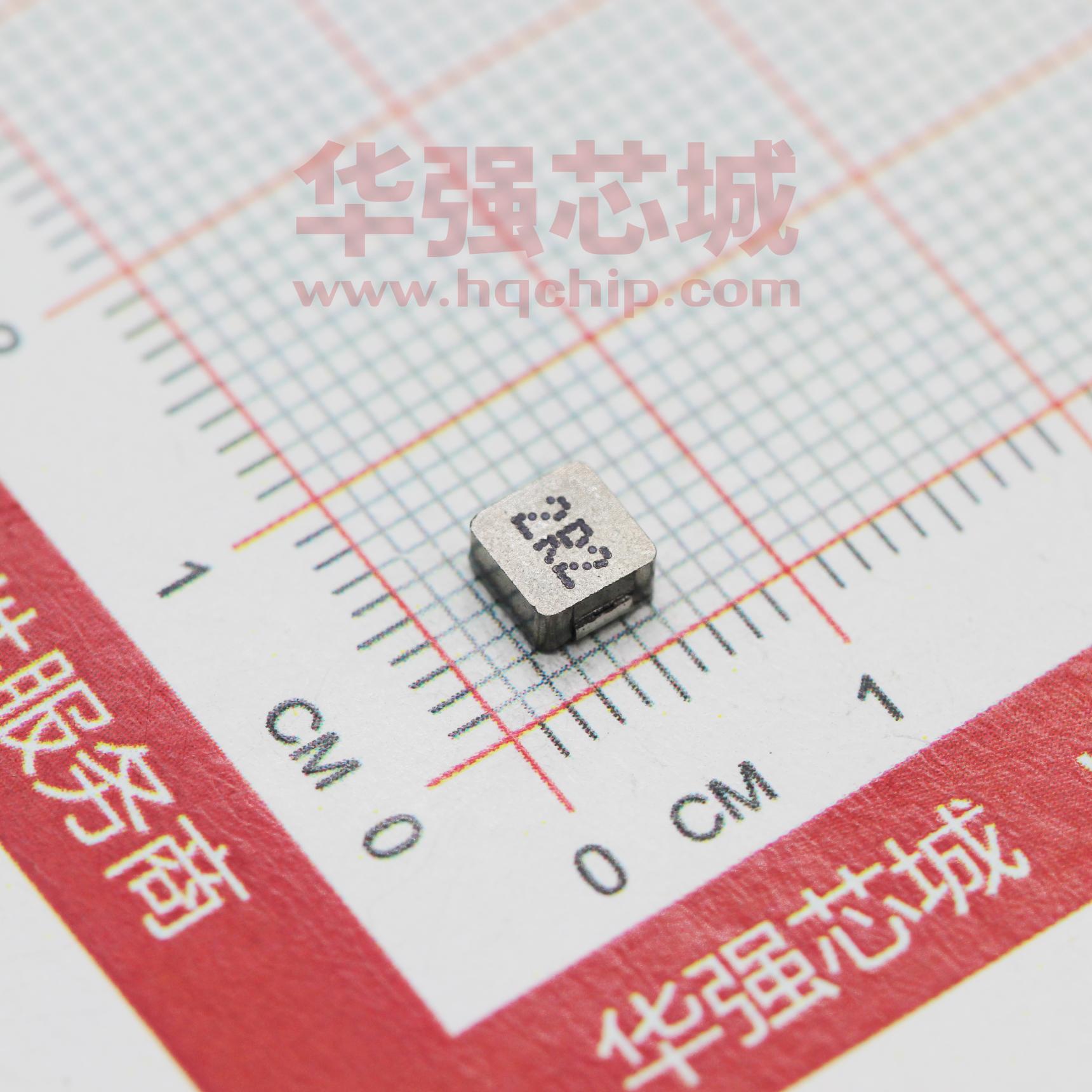

    贴片电感 CETC0420-B Ecriee 4.5mm*4.0mm*2.0mm
CETC0420-B 数据手册
COMPOSITE FORMING SMD INDUCTORS CETC-B TYPE Features RoHS compliant* and halogen free** lowest DCR/uH,in this package size. High saturation current Frequency range up to 3.0MHZ. Ultra low buzz noise,due to composite construction. Applications Notebook/Desktop/Server applications. low profile,high current power supplies. Battery powered devices. DC/DC converters. Product identification CETC XXXX - XXX M - B ① ② ③ ① Product Code ④ ⑤ ② Size: L×W (mm) ③ Inductance Value ⑤ Category ④ Tolerance: J±5%, K±10%, L±15% , M±20%, P± 25%, N±30% Recommended Layout [unit: mm] Product Dimensions(04、05) [unit: mm] E E A F B G C XXXX D H 型号 A B C D E F G H CETC 0420 4.45± 0.25 4.06± 0.25 2.0Max 1.5 ± 0.5 0.76± 0.3 5.2 2.5 2.2 CETC 0530 5.8 Max 5.18± 0.25 3.0Max 2.2 ± 0.3 1.2 ± 0.3 5.99 2.5 2.5 Recommended Layout [unit: mm] Product Dimensions(06、10、12) [unit: mm] G F H 型号 A B C D E F G H CETC 0624 7.4 Max 6.6± 0.2 2.4Max 3.0 ± 0.3 1.6 ± 0.4 8.0 3.6 3.6 CETC 0630 7.4 Max 6.6± 0.2 3.0Max 3.0 ± 0.3 1.6 ± 0.4 8.0 3.6 3.6 CETC 1030 11.5 Max 10± 0.5 3.1Max 3.0 ± 0.5 2.2 ± 0.4 13.6 4.1 5.4 CETC 1040 11.5 Max 10± 0.5 4.0Max 3.0 ± 0.5 2.2 ± 0.4 13.6 4.1 5.4 CETC 1250 14 Max 12.6± 0.2 5.0Max 3.8± 0.3 2.0± 0.5 14.5 5.0 8.0 CETC 1270 14 Max 12.6± 0.2 7.0Max 3.8± 0.3 2.0± 0.5 14.5 5.0 8.0 Specification table CETC0420-B series D.C.R (mΩ) 100KHz 0.25V P/N Heat Rating Current Saturation Current L0(μH) ±20% '@0A Typical Max Idc (Amp) Typical Isat (Amp) Typical CETC 0420-R10 M-B 0.1 4 4.5 12 26 CETC 0420-R22 M-B 0.22 5.50 6.05 9 12 CETC 0420-R47 M-B 0.47 10.5 11.55 7 10 CETC 0420-R56 M-B 0.56 14 16 6 9 CETC 0420-R68 M-B 0.68 17 19.0 7.5 9 CETC 0420-1R0 M-B 1.0 24.0 27 4.5 7 CETC 0420-1R5 M-B 1.5 37 42.0 5 6 CETC 0420-2R2 M-B 2.2 52 58.0 5 6 CETC 0420-3R3 M-B 3.3 74 87.0 3 5 CETC 0420-4R7 M-B 4.7 103 115 3 4 CETC 0420-6R8 M-B 6.8 110 123 2.5 3.5 CETC 0420-8R2 M-B 8.2 200 215 2 2 CETC 0420-100 M-B 10 235 258 2 2 CETC0530-B series 100KHz 0.25V P/N D.C.R (mΩ) Heat Rating Current Saturation Current L0(μH) ±20% '@0A Typical Max Idc (Amp) Typical Isat (Amp) Typical CETC 0530-R20 M-B 0.2 3.7 4.10 21 30 CETC 0530-R47 M-B 0.47 6.7 7.1 12 18 CETC 0530-R68 M-B 0.68 10.5 11.6 9 15 CETC 0530-1R0 M-B 1.0 12 13 9.2 12 CETC 0530-1R5 M-B 1.5 20 25 6 10 CETC 0530-2R2 M-B 2.2 25 29 6 8.5 CETC 0530-3R3 M-B 3.3 32.0 38 5 5 CETC 0530-4R7 M-B 4.7 49 54 4.5 5 Heat Rating Current Saturation Current Idc (Amp) Typical Isat (Amp) Typical CETC0624-B series 100KHz 0.25V P/N L0(μH) ±20% '@0A D.C.R (mΩ) Typical Max CETC 0624-R10 M-B 0.1 1.5 1.7 28 50 CETC 0624-R22 M-B 0.22 2.9 3.2 20 34 CETC 0624-R33 M-B 0.33 3.2 3.55 18 32 CETC 0624-R47 M-B 0.47 5.4 6.0 15 20 CETC 0624-R68 M-B 0.68 7.3 8.1 11 18 CETC 0624-R82 M-B 0.82 8.5 9.35 11 18 CETC 0624-1R0 M-B 1.0 11.5 12.5 10 16 CETC 0624-1R5 M-B 1.5 18 20.6 9 16 CETC 0624-2R2 M-B 2.2 23 25 6.5 14 CETC 0624-3R3 M-B 3.3 28.5 31.5 6 6 CETC 0624-4R7 M-B 4.7 53 63 4 7 CETC 0624-6R8 M-B 6.8 68 76 4 4 CETC 0624-100 M-B 10 112 125 3 3 Heat Rating Current Saturation Current CETC0630-B series 100KHz 0.25V P/N D.C.R (mΩ) L0(μH) ±20% '@0A Typical Max Idc (Amp) Typical Isat (Amp) Typical CETC 0630-R22 M-B 0.22 3.0 3.5 23 40 CETC 0630-R33 M-B 0.33 3.5 3.9 20 35 CETC 0630-R47 M-B 0.47 3.5 3.9 18 30 CETC 0630-R68 M-B 0.68 4.8 5.5 13.5 25 CETC 0630-1R0 M-B 1.0 8.0 10 11 22 CETC 0630-1R5 M-B 1.5 12.5 14.0 10 18 CETC 0630-2R2 M-B 2.2 15.6 18.0 9 14 CETC 0630-3R3 M-B 3.3 24 27.0 6 10 CETC 0630-4R7 M-B 4.7 33 37 6 8 CETC 0630-6R8 M-B 6.8 50 55 5 8 CETC 0630-8R2 M-B 8.2 64 68 4 6 CETC 0630-100 M-B 10 75 95 4 6 CETC 0630-150 M-B 15 120 130 3.5 4 CETC 0630-220 M-B 22 128 135 2 3 CETC1030-B series D.C.R (mΩ) 100KHz 0.25V P/N Heat Rating Current Saturation Current L0(μH) ±20% '@0A Typical Max Idc (Amp) Typical Isat (Amp) Typical CETC 1030-R16 M-B 0.16 0.85 0.95 36 60 CETC 1030-R30 M-B 0.30 1.55 1.7 28 45 CETC 1030-R47 M-B 0.47 2 2.2 28 32 CETC 1030-R56 M-B 0.56 2.5 2.75 25 20 CETC 1030-R68 M-B 0.68 2.8 3.1 25 20 CETC 1030-1R0 M-B 1.0 4.5 4.95 25 25 CETC 1030-1R5 M-B 1.5 7.0 7.8 13.5 20 CETC 1030-2R2 M-B 2.2 8.3 10 14 14 CETC 1030-3R3 M-B 3.3 13.5 15 9 10 CETC 1030-4R7 M-B 4.7 21 24.0 9 8 CETC 1030-6R8 M-B 6.8 32 36 7 7 CETC 1030-100 M-B 10 46 52 7 6 Heat Rating Current Saturation Current CETC1040-B series 100KHz 0.25V P/N D.C.R (mΩ) L0(μH) ±20% '@0A Typical Max Idc (Amp) Typical Isat (Amp) Typical CETC 1040-R22 M-B 0.22 0.85 1.0 30 50 CETC 1040-R30 M-B 0.3 0.95 1.1 30 50 CETC 1040-R47 M-B 0.47 1.6 1.8 28 40 CETC 1040-R68 M-B 0.68 1.7 1.9 24 28 CETC 1040-1R0 M-B 1.0 3 3.8 18 25 CETC 1040-1R5 M-B 1.5 4.5 6 12 24 CETC 1040-2R5 M-B 2.5 8.75 10.0 11 16 CETC 1040-4R7 M-B 4.7 15 16.5 10 16 CETC 1040-100 M-B 10 36 40 6 8 CETC 1040-150 M-B 15 45 50 5 8 CETC 1040-220 M-B 22 70 77 4 5 CETC 1040-330 M-B 33 50 55 2 3 CETC 1040-470 M-B 47 120 135 2 2.5 • All test data is referenced to 25°C ambient • DC current (Idc) that will cause an approximate △ T of 40℃ • DC current (Isat) that will cause Lo to drop approximately 20% • Operating temperature Range: –55°C to +125°C • The part temperature (ambient + temp rise) should not exceed125℃ under the worst operating conditions. Circuit design,component placement, PWB trace size and thickness, airflow and other cooling provisions all affect the part temperature. Part temperature should be verified in the end application. CETC1250-B series 100KHz 0.25V P/N D.C.R (mΩ) Heat Rating Current Saturation Current L0(μH) ±20% '@0A Typical Max Idc (Amp) Typical Isat (Amp) Typical CETC 1250-R36 M-B 0.36 0.86 1.0 41 65 CETC 1250-R47 M-B 0.47 1.1 1.3 38 65 CETC 1250-R68 M-B 0.68 1.5 1.7 34 54 CETC 1250-1R0 M-B 1.0 2 2.5 28 50 CETC 1250-1R5 M-B 1.5 3.2 4.0 20 43 CETC 1250-2R2 M-B 2.2 5 5.5 18 35 CETC 1250-3R3 M-B 3.3 7.7 9.2 15 30 CETC 1250-4R7 M-B 4.7 13 15 12 25 CETC 1250-5R6 M-B 5.6 14 16.5 11.5 22 CETC 1250-6R8 M-B 6.8 15.4 18.5 10 20 CETC 1250-100 M-B 10 21.4 25.5 9 14 CETC 1250-150 M-B 15 28 32 5 10 CETC 1250-220 M-B 22 45 52 4.5 7 CETC 1250-330 M-B 33 75 83 4.5 7 Heat Rating Current Saturation Current CETC1270-B series 100KHz 0.25V P/N D.C.R (mΩ) L0(μH) ±20% '@0A Typical Max Idc (Amp) Typical Isat (Amp) Typical CETC 1270-R47 M-B 0.47 0.85 1.1 33 63 CETC 1270-R56 M-B 0.56 1.2 1.4 35 60 CETC 1270-R68 M-B 0.68 1.4 1.6 32 50 CETC 1270-R82 M-B 0.82 1.2 2.0 30 50 CETC 1270-1R0 M-B 1.0 1.7 2.0 30 50 CETC 1270-2R2 M-B 2.2 3.5 4.2 25 50 CETC 1270-3R3 M-B 3.3 5.7 6.8 18 40 CETC 1270-3R6 M-B 3.6 6.3 7 16 35 CETC 1270-4R7 M-B 4.7 8 8.7 15 32 CETC 1270-6R8 M-B 6.8 12 13.5 11.5 30 CETC 1270-100 M-B 10 15.5 17 9 20 CETC 1270-150 M-B 15 31 34 6 14 CETC 1270-220 M-B 22 46 50 6 10 CETC 1270-330 M-B 33 75 81 5 8 CETC 1270-470 M-B 47 85 90 4.5 6 CETC 1270-680 M-B 68 103 116 4 6 CETC 1270-820 M-B 82 118 128 4 5 CETC 1270-101 M-B 100 143 160 2 4 • All test data is referenced to 25°C ambient • DC current (Idc) that will cause an approximate △ T of 40℃ • DC current (Isat) that will cause Lo to drop approximately 30% • Operating temperature Range: –55°C to +125°C • The part temperature (ambient + temp rise) should not exceed125℃ under the worst operating conditions. Circuit design,component placement, PWB trace size and thickness, airflow and other cooling provisions all affect the part temperature. Part temperature should be verified in the end application. http://www.ecthf.com
