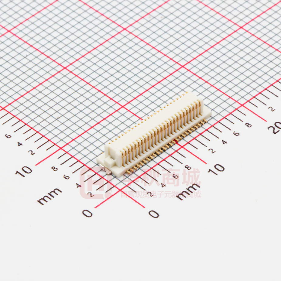

    板对板连接器 P=0.5mm 50Pin(2x25) 母 立贴
DF12B-50DS-0.5V(86) 数据手册
0.5mm Pitch SMT Board-to-Board Connector DF12 Series Correspond to automatic mounting The vacuum pick-up area secures the automatic mounting Jul.1.2018 Copyright 2018 HIROSE ELECTRIC CO., LTD. All Rights Reserved. machine for pick and place. Fig.1 ■Features 1. Broad Variations of Stacking Height In addition to 0.5mm pitch ultra-miniature size connector, the stacking height of 3mm, 3.5mm, 4mm, and 5mm are provided. Header/Receptacle DF12#(3.0)-*DS-0.5V DF12#-*DS-0.5V Combination stacking height Combination stacking height DF12#(3.0)-*DP-0.5V 3.0 ––––––– DF12#(3.5)-*DP-0.5V ––––––– 3.5 DF12#(4.0)-*DP-0.5V ––––––– 4.0 DF12#(5.0)-*DP-0.5V ––––––– 5.0 Note 1 : (**) of the product name DF12# (**) indicates the stacking height. Note 2 : The stacking height doesn't include the soldering paste thickness. [Stacking Height Variation] Stacking Height Number of Contacts 3.0mm 3.5mm 4.0mm 5.0mm 10 contacts K ––––––– ––––––– ––––––– 14 contacts K ––––––– ––––––– ––––––– 20 contacts K K K K 30 contacts K K K K 32 contacts K ––––––– K ––––––– 36 contacts K K K K 40 contacts K K K K 50 contacts K K K K 60 contacts K K K K K ––––––– ––––––– ––––––– 80 contacts 2. Corresponding to Automatic Mounting The connector has the vacuum pick-up area to enable automatic mounting with the embossed tape packaging.(Fig.1) 3. Metal Fitting Available The product including the metal fitting to prevent solder peeling is provided, considering the mounting on FPC. A193 DF12 Series●0.5mm Pitch SMT Board-to-Board Connector ■Product Specifications Voltage rating 50V AC Operating Humidity Range Item Jul.1.2018 Copyright 2018 HIROSE ELECTRIC CO., LTD. All Rights Reserved. Operating Temperature Range -45 to +125ç (Note 1) Storage Temperature Range Current rating 0.3A Rating -40 to 80% Storage Humidity Range Specification -10 to +60ç (Note 2) -40 to 70% (Note 2) Condition 1. Insulation Resistance 500MΩ min. 100V DC 2. Withstanding voltage No flashover or insulation breakdown. 150V AC/1 minute 3. Contact Resistance 50mΩ max. 100mA 4. Vibration No electrical discontinuity of 1μs or more Frequency : 10 to 55 Hz, single amplitude of 0.75mm, 2 hours in each of the 3 directions. 5. Humidity (Steady state) Contact resistance : 50mΩ max. Insulation resistance:500MΩ min 96 hours at temperature of 40±2ç and humidity of 90% to 95% 6. Temperature Cycle Contact resistance : 50mΩ max. Insulation resistance:500MΩ min (-65ç : 30 minutes 5 to 35ç : 10 minutes 125ç : 30 minutes 5 to 35ç : 10 minutes) 5 cycles 7. Durability (Mating/un-mating) Contact resistance : 50mΩ max. 8. Resistance to Soldering heat 50 cycles No deformation of components affecting performance. Reflow : At the recommended temperature profile Manual soldering : 350ç for 3 seconds Note 1: Includes temperature rise caused by current flow. Note 2: The term "storage" refers to products stored for long period of time prior to mounting and use. Operating Temperature Range and Humidity range covers non conducting condition of installed connectors in storage, shipment or during transportation. ■Material / Finish Product Part Receptacle/Header Material Finish Remarks Insulator Polyamide Beige UL94-V0 Contact Phosphor copper Gold plated ––––––– Fitting Brass Tin plated ––––––– ■Product Number Structure ●Receptacle DF12 q q Series Name # (**) - * DS - 0.5 V (**) w e t y e Stacking height : DF12 w Type 3.0 Fitting Boss K K A ∞ K B K ∞ C ∞ ∞ Blank r Blank u y Contact Pitch : 0.5mm u Contact Style : 3.0mm : 3.5 to 5.0mm V : Straight SMT r Number of Contacts : 10, 14, 20, 30, 32, i Packaging Type 36, 40, 50, 60, 80 (81) : Embossed tape packaging (1,000pcs/reel) (A, C type) t Connector Type (86) : Embossed tape packaging DS : Double-row receptacle ●Header DF12 q q Series Name (1,000pcs/reel) (Blank, B type) # (**) - * DP - 0.5 V (**) w e r t y e Stacking height : DF12 w Type i u i t Connector Type Indication Stacking Height DP : Double-row pin header Fitting Boss 3.0 3.0mm y Contact Pitch : 0.5mm Blank K K 3.5 3.5mm u Contact Style 4.0 4.0mm V : Straight SMT 5.0mm i Packaging Type B K ∞ D ∞ K E ∞ ∞ 5.0 (81) : Embossed tape packaging r Number of Contacts : 10, 14, 20, 30, 32, (1,000pcs/reel) (D, E type) 36, 40, 50, 60, 80 (86) : Embossed tape packaging (1,000pcs/reel) (Blank, B type) A194 DF12 Series●0.5mm Pitch SMT Board-to-Board Connector Jul.1.2018 Copyright 2018 HIROSE ELECTRIC CO., LTD. All Rights Reserved. ■Receptacle Without metal fitting ●Stacking Height: 3mm Product Unit : mm Part No. HRS No. No. of Contacts A B C D E DF12A (3.0)-10DS-0.5V (81) DF12A (3.0)-14DS-0.5V (81) DF12A (3.0)-20DS-0.5V (81) DF12A (3.0)-30DS-0.5V (81) DF12A (3.0)-32DS-0.5V (81) DF12A (3.0)-36DS-0.5V (81) DF12A (3.0)-40DS-0.5V (81) DF12A (3.0)-50DS-0.5V (81) DF12A (3.0)-60DS-0.5V (81) DF12A (3.0)-80DS-0.5V (81) DF12C (3.0)-10DS-0.5V (81) DF12C (3.0)-14DS-0.5V (81) DF12C (3.0)-20DS-0.5V (81) DF12C (3.0)-30DS-0.5V (81) DF12C (3.0)-32DS-0.5V (81) DF12C (3.0)-36DS-0.5V (81) DF12C (3.0)-40DS-0.5V (81) DF12C (3.0)-50DS-0.5V (81) DF12C (3.0)-60DS-0.5V (81) DF12C (3.0)-80DS-0.5V (81) 537-0626-9 81 537-0915-6 81 537-0628-4 81 537-0630-6 81 537-0637-5 81 537-0631-9 81 537-0632-1 81 537-0634-7 81 537-0636-2 81 537-0638-8 81 537-0686-0 81 537-0917-1 81 537-0688-6 81 537-0690-8 81 537-0697-7 81 537-0691-0 81 537-0692-3 81 537-0694-9 81 537-0696-4 81 537-0212-6 81 10 14 20 30 32 36 40 50 60 80 10 14 20 30 32 36 40 50 60 80 04.6 05.6 07.1 09.6 10.1 11.1 12.1 14.6 17.1 22.1 04.6 05.6 07.1 09.6 10.1 11.1 12.1 14.6 17.1 22.1 02.0 03.0 04.5 07.0 07.5 08.5 09.5 12.0 14.5 19.5 02.0 03.0 04.5 07.0 07.5 08.5 09.5 12.0 14.5 19.5 03.1 04.1 05.6 08.1 08.6 09.6 10.6 13.1 15.6 20.6 03.1 04.1 05.6 08.1 08.6 09.6 10.6 13.1 15.6 20.6 04.1 05.1 06.6 09.1 09.6 10.6 11.6 14.1 16.6 21.6 2.2 –––– 2.2 Remarks Without metal fitting With boss YES Without metal fitting Without boss ●Stacking Height: 3.5 to 5mm Product Part No. HRS No. RoHS Unit : mm No. of Contacts A B C D DF12A-20DS-0.5V (81) 537-0078-5 81 20 07.1 04.5 05.6 06.6 DF12A-30DS-0.5V (81) 537-0080-7 81 30 09.6 07.0 08.1 09.1 DF12A-32DS-0.5V (81) 537-0087-6 81 32 10.1 07.5 08.6 09.6 DF12A-36DS-0.5V (81) 537-0081-0 81 36 11.1 08.5 09.6 10.6 DF12A-40DS-0.5V (81) 537-0082-2 81 40 12.1 09.5 10.6 11.6 DF12A-50DS-0.5V (81) 537-0084-8 81 50 14.6 12.0 13.1 14.1 16.6 DF12A-60DS-0.5V (81) 537-0086-3 81 60 17.1 14.5 15.6 DF12C-20DS-0.5V (81) 537-0203-5 81 20 07.1 04.5 05.6 DF12C-30DS-0.5V (81) 537-0205-0 81 30 09.6 07.0 08.1 DF12C-32DS-0.5V (81) 537-0212-6 81 32 10.1 07.5 08.6 DF12C-36DS-0.5V (81) 537-0206-3 81 36 11.1 08.5 09.6 DF12C-40DS-0.5V (81) 537-0207-6 81 40 12.1 09.5 10.6 DF12C-50DS-0.5V (81) 537-0209-1 81 50 14.6 12.0 13.1 DF12C-60DS-0.5V (81) 537-0211-3 81 60 17.1 14.5 15.6 –––– E 2.7 Remarks RoHS Without metal fitting With boss YES 2.7 Without metal fitting Without boss Note 1: Please order the embossed tape packaging product per reel. (1000 pcs./reel) A195 DF12 Series●0.5mm Pitch SMT Board-to-Board Connector ■Receptacle With metal fitting F A B 1.5 4.6 2.4 1.5 3.6 0.5 P=0.5 0.2 Ø0.5 D 1.5 ●Stacking Height : 3mm Product Part No. DF12 (3.0)-10DS-0.5V (86) DF12 (3.0)-14DS-0.5V (86) DF12 (3.0)-20DS-0.5V (86) DF12 (3.0)-30DS-0.5V (86) DF12 (3.0)-32DS-0.5V (86) DF12 (3.0)-36DS-0.5V (86) DF12 (3.0)-40DS-0.5V (86) DF12 (3.0)-50DS-0.5V (86) DF12 (3.0)-60DS-0.5V (86) DF12 (3.0)-80DS-0.5V (86) DF12B (3.0)-10DS-0.5V (86) DF12B (3.0)-14DS-0.5V (86) DF12B (3.0)-20DS-0.5V (86) DF12B (3.0)-30DS-0.5V (86) DF12B (3.0)-32DS-0.5V (86) DF12B (3.0)-36DS-0.5V (86) DF12B (3.0)-40DS-0.5V (86) DF12B (3.0)-50DS-0.5V (86) DF12B (3.0)-60DS-0.5V (86) DF12B (3.0)-80DS-0.5V (86) HRS No. 537-0601-8 86 537-0914-3 86 537-0603-3 86 537-0605-9 86 537-0612-4 86 537-0606-1 86 537-0607-4 86 537-0609-0 86 537-0611-1 86 537-0613-7 86 537-0651-6 86 537-0916-9 86 537-0653-1 86 537-0655-7 86 537-0662-2 86 537-0656-0 86 537-0657-2 86 537-0659-8 86 537-0661-0 86 537-0663-5 86 Unit : mm No. of Contacts 10 14 20 30 32 36 40 50 60 80 10 14 20 30 32 36 40 50 60 80 A 4.6 5.6 7.1 9.6 10.1 11.1 12.1 14.6 17.1 22.1 4.6 5.6 7.1 9.6 10.1 11.1 12.1 14.6 17.1 22.1 B 2.0 3.0 4.5 7.0 7.5 8.5 9.5 12.0 14.5 19.5 2.0 3.0 4.5 7.0 7.5 8.5 9.5 12.0 14.5 19.5 C 3.1 4.1 5.6 8.1 8.6 9.6 10.6 13.1 15.6 20.6 3.1 4.1 5.6 8.1 8.6 9.6 10.6 13.1 15.6 20.6 D 4.1 5.1 6.6 9.1 9.6 10.6 11.6 14.1 16.6 21.6 –––– E 2.2 2.2 F 5.6 6.6 8.1 10.6 11.1 12.1 13.1 15.6 18.1 23.1 5.6 6.6 8.1 10.6 11.1 12.1 13.1 15.6 18.1 23.1 Remarks Part No. RoHS With metal fitting With boss YES With metal fitting Without boss ●Stacking Height : 3.5 to 5mm Product Unit : mm HRS No. No. of Contacts A B C D DF12-20DS-0.5V (86) 537-0003-6 86 20 07.1 04.5 05.6 06.6 08.1 DF12-30DS-0.5V (86) 537-0005-1 86 30 09.6 07.0 08.1 09.1 10.6 DF12-32DS-0.5V (86) 537-0012-7 86 32 10.1 07.5 08.6 09.6 DF12-36DS-0.5V (86) 537-0006-4 86 36 11.1 08.5 09.6 10.6 DF12-40DS-0.5V (86) 537-0007-7 86 40 12.1 09.5 10.6 DF12-50DS-0.5V (86) 537-0009-2 86 50 14.6 12.0 13.1 DF12-60DS-0.5V (86) 537-0011-4 86 60 17.1 14.5 15.6 16.6 DF12B-20DS-0.5V (86) 537-0303-0 86 20 07.1 04.5 05.6 DF12B-30DS-0.5V (86) 537-0305-5 86 30 09.6 07.0 08.1 10.6 DF12B-32DS-0.5V (86) 537-0312-0 86 32 10.1 7.5 8.6 11.1 E F Remarks 12.1 With metal fitting 11.6 13.1 With boss 14.1 15.6 18.1 YES 08.1 –––– RoHS 11.1 2.7 DF12B-36DS-0.5V (86) 537-0306-8 86 36 11.1 08.5 09.6 12.1 With metal fitting DF12B-40DS-0.5V (86) 537-0307-0 86 40 12.1 09.5 10.6 13.1 Without boss DF12B-50DS-0.5V (86) 537-0309-6 86 50 14.6 12.0 13.1 15.6 DF12B-60DS-0.5V (86) 537-0311-8 86 60 17.1 14.5 15.6 18.1 Note : Please order the embossed tape packaging product per reel. (1000 pcs./reel) A196 0.25 E 0.6 Jul.1.2018 Copyright 2018 HIROSE ELECTRIC CO., LTD. All Rights Reserved. C 2.7 DF12 Series●0.5mm Pitch SMT Board-to-Board Connector Jul.1.2018 Copyright 2018 HIROSE ELECTRIC CO., LTD. All Rights Reserved. ■Header Without metal fitting ●Stacking Height : 3mm Product Unit : mm Part No. HRS No. No. of Contacts A B C D DF12D (3.0)-10DP-0.5V (81) 537-0791-5 81 10 04.7 2.0 03.2 04.1 DF12D (3.0)-14DP-0.5V (81) 537-0920-6 81 14 05.7 3.0 04.2 05.1 DF12D (3.0)-20DP-0.5V (81) 537-0793-0 81 20 07.2 04.5 05.7 06.6 DF12D (3.0)-30DP-0.5V (81) 537-0795-6 81 30 09.7 07.0 08.2 09.1 DF12D (3.0)-32DP-0.5V (81) 537-0802-0 81 32 10.2 07.5 08.7 09.6 DF12D (3.0)-36DP-0.5V (81) 537-0796-9 81 36 11.2 08.5 09.7 10.6 DF12D (3.0)-40DP-0.5V (81) 537-0797-1 81 40 12.2 09.5 10.7 11.6 DF12D (3.0)-50DP-0.5V (81) 537-0799-7 81 50 14.7 12.0 13.2 14.1 DF12D (3.0)-60DP-0.5V (81) 537-0801-7 81 60 17.2 14.5 15.7 16.6 DF12D (3.0)-80DP-0.5V (81) 537-0803-2 81 80 22.2 19.5 20.7 21.6 DF12E (3.0)-10DP-0.5V (81) 537-0826-8 81 10 04.7 02.0 03.2 DF12E (3.0)-14DP-0.5V (81) 537-0921-9 81 14 05.7 03.0 04.2 DF12E (3.0)-20DP-0.5V (81) 537-0828-3 81 20 07.2 04.5 05.7 DF12E (3.0)-30DP-0.5V (81) 537-0830-5 81 30 09.7 07.0 08.2 DF12E (3.0)-32DP-0.5V (81) 537-0837-4 81 32 10.2 07.5 08.7 DF12E (3.0)-36DP-0.5V (81) 537-0831-8 81 36 11.2 08.5 09.7 DF12E (3.0)-40DP-0.5V (81) 537-0832-0 81 40 12.2 09.5 10.7 DF12E (3.0)-50DP-0.5V (81) 537-0834-6 81 50 14.7 12.0 13.2 DF12E (3.0)-60DP-0.5V (81) 537-0836-1 81 60 17.2 14.5 15.7 DF12E (3.0)-80DP-0.5V (81) 537-0838-7 81 80 22.2 19.5 20.7 –––– E Remarks 2.3 Without metal fitting RoHS With boss YES 2.3 Without metal fitting Without boss Note : Order the emboss package product per reel. (1000 pcs./reel) A197 DF12 Series●0.5mm Pitch SMT Board-to-Board Connector Jul.1.2018 Copyright 2018 HIROSE ELECTRIC CO., LTD. All Rights Reserved. ■Header Without metal fitting ●Stacking Height : 3.5 to 5mm Product Part No. DF12D (3.5)-20DP-0.5V (81) DF12D (3.5)-30DP-0.5V (81) DF12D (3.5)-36DP-0.5V (81) DF12D (3.5)-40DP-0.5V (81) DF12D (3.5)-50DP-0.5V (81) DF12D (3.5)-60DP-0.5V (81) DF12D (4.0)-20DP-0.5V (81) DF12D (4.0)-30DP-0.5V (81) DF12D (4.0)-32DP-0.5V (81) DF12D (4.0)-36DP-0.5V (81) DF12D (4.0)-40DP-0.5V (81) DF12D (4.0)-50DP-0.5V (81) DF12D (4.0)-60DP-0.5V (81) DF12D (5.0)-20DP-0.5V (81) DF12D (5.0)-30DP-0.5V (81) DF12D (5.0)-36DP-0.5V (81) DF12D (5.0)-40DP-0.5V (81) DF12D (5.0)-50DP-0.5V (81) DF12D (5.0)-60DP-0.5V (81) DF12E (3.5)-20DP-0.5V (81) DF12E (3.5)-30DP-0.5V (81) DF12E (3.5)-36DP-0.5V (81) DF12E (3.5)-40DP-0.5V (81) DF12E (3.5)-50DP-0.5V (81) DF12E (3.5)-60DP-0.5V (81) DF12E (4.0)-20DP-0.5V (81) DF12E (4.0)-30DP-0.5V (81) DF12E (4.0)-32DP-0.5V (81) DF12E (4.0)-36DP-0.5V (81) DF12E (4.0)-40DP-0.5V (81) DF12E (4.0)-50DP-0.5V (81) DF12E (4.0)-60DP-0.5V (81) DF12E (5.0)-20DP-0.5V (81) DF12E (5.0)-30DP-0.5V (81) DF12E (5.0)-36DP-0.5V (81) DF12E (5.0)-40DP-0.5V (81) DF12E (5.0)-50DP-0.5V (81) DF12E (5.0)-60DP-0.5V (81) HRS No. 537-0428-5 81 537-0430-7 81 537-0431-0 81 537-0432-2 81 537-0434-8 81 537-0436-3 81 537-0453-2 81 537-0455-8 81 537-0802-0 81 537-0456-0 81 537-0457-3 81 537-0459-9 81 537-0461-0 81 537-0478-3 81 537-0480-5 81 537-0481-8 81 537-0482-0 81 537-0484-6 81 537-0486-1 81 537-0528-0 81 537-0530-1 81 537-0531-4 81 537-0532-7 81 537-0534-2 81 537-0536-8 81 537-0553-7 81 537-0555-2 81 537-0929-0 81 537-0556-5 81 537-0557-8 81 537-0559-3 81 537-0561-5 81 537-0578-8 81 537-0580-0 81 537-0581-2 81 537-0582-5 81 537-0584-0 81 537-0586-6 81 Unit : mm No. of Contacts 20 30 36 40 50 60 20 30 32 36 40 50 60 20 30 36 40 50 60 20 30 36 40 50 60 20 30 32 36 40 50 60 20 30 36 40 50 60 A 7.2 9.7 11.2 12.2 14.7 17.2 7.2 9.7 10.2 11.2 12.2 14.7 17.2 7.2 9.7 11.2 12.2 14.7 17.2 7.2 9.7 11.2 12.2 14.7 17.2 7.2 9.7 10.2 11.2 12.2 14.7 17.2 7.2 9.7 11.2 12.2 14.7 17.2 Note : Plaese order the embossed tape packaging product per reel. (1000 pcs./reel) A198 B 4.5 7.0 8.5 9.5 12.0 14.5 4.5 7.0 7.5 8.5 9.5 12.0 14.5 4.5 7.0 8.5 9.5 12.0 14.5 4.5 7.0 8.5 9.5 12.0 14.5 4.5 7.0 7.5 8.5 9.5 12.0 14.5 4.5 7.0 8.5 9.5 12.0 14.5 C 5.7 8.2 9.7 10.7 13.2 15.7 5.7 8.2 8.7 9.7 10.7 13.2 15.7 5.7 8.2 9.7 10.7 13.2 15.7 5.7 8.2 9.7 10.7 13.2 15.7 5.7 8.2 8.7 9.7 10.7 13.2 15.7 5.7 8.2 9.7 10.7 13.2 15.7 D 06.6 09.1 10.6 11.6 14.1 16.6 06.6 09.1 09.6 10.6 11.6 14.1 16.6 06.6 09.1 10.6 11.6 14.1 16.6 E Remarks RoHS 2.8 3.3 Without metal fitting With boss 4.3 YES –––– 2.8 –––– 3.3 –––– 4.3 Without metal fitting Without boss DF12 Series●0.5mm Pitch SMT Board-to-Board Connector ■Header With metal fitting F A B 4.6 1.5 2.45 3.8 0.4 P=0.5 0.25 E 0.6 Jul.1.2018 Copyright 2018 HIROSE ELECTRIC CO., LTD. All Rights Reserved. 0.25 C Ø0.5 D 1.5 ●Stacking Height : 3mm Product Unit : mm Part No. NRS No. No. of Contacts A B C D DF12 (3.0)-10DP-0.5V (86) 537-0721-0 86 10 04.7 02.0 03.2 04.1 E 05.6 F DF12 (3.0)-14DP-0.5V (86) 537-0918-4 86 14 05.7 03.0 04.2 05.1 06.6 DF12 (3.0)-20DP-0.5V (86) 537-0723-5 86 20 07.2 04.5 05.7 06.6 08.1 DF12 (3.0)-30DP-0.5V (86) 537-0725-0 86 30 09.7 07.0 08.2 09.1 10.6 DF12 (3.0)-32DP-0.5V (86) 537-0732-6 86 32 10.2 07.5 08.7 09.6 DF12 (3.0)-36DP-0.5V (86) 537-0726-3 86 36 11.2 08.5 09.7 10.6 DF12 (3.0)-40DP-0.5V (86) 537-0727-6 86 40 12.2 09.5 10.7 11.6 13.1 DF12 (3.0)-50DP-0.5V (86) 537-0729-1 86 50 14.7 12.0 13.2 14.1 15.6 DF12 (3.0)-60DP-0.5V (86) 537-0731-3 86 60 17.2 14.5 15.7 16.6 18.1 DF12 (3.0)-80DP-0.5V (86) 537-0733-9 86 80 22.2 19.5 20.7 21.6 23.1 DF12B (3.0)-10DP-0.5V (86) 537-0756-4 86 10 04.7 02.0 03.2 05.6 DF12B (3.0)-14DP-0.5V (86) 537-0919-7 86 14 05.7 03.0 04.2 06.6 DF12B (3.0)-20DP-0.5V (86) 537-0758-0 86 20 07.2 04.5 05.7 08.1 DF12B (3.0)-30DP-0.5V (86) 537-0760-1 86 30 09.7 07.0 08.2 10.6 DF12B (3.0)-32DP-0.5V (86) 537-0767-0 86 32 10.2 07.5 08.7 DF12B (3.0)-36DP-0.5V (86) 537-0761-4 86 36 11.2 08.5 09.7 DF12B (3.0)-40DP-0.5V (86) 537-0762-7 86 40 12.2 09.5 10.7 13.1 DF12B (3.0)-50DP-0.5V (86) 537-0764-2 86 50 14.7 12.0 13.2 15.6 DF12B (3.0)-60DP-0.5V (86) 537-0766-8 86 60 17.2 14.5 15.7 18.1 DF12B (3.0)-80DP-0.5V (86) 537-0768-3 86 80 22.2 19.5 20.7 23.1 –––– 2.3 2.3 11.1 12.1 11.1 12.1 Remarks RoHS With metal fitting With boss YES With metal fitting Without boss Note : Please order the embossed tape packaging product per reel. (1000 pcs./reel) A199 DF12 Series●0.5mm Pitch SMT Board-to-Board Connector ■Header With metal fitting F A B 4.6 1.5 2.45 3.8 0.4 P=0.5 D 1.5 ●Stacking Height : 3.5 to 5mm Product Unit : mm Part No. HRS No. No. of Contacts A B C D DF12 (3.5)-20DP-0.5V (86) DF12 (3.5)-30DP-0.5V (86) DF12 (3.5)-36DP-0.5V (86) DF12 (3.5)-40DP-0.5V (86) DF12 (3.5)-50DP-0.5V (86) DF12 (3.5)-60DP-0.5V (86) DF12 (4.0)-20DP-0.5V (86) DF12 (4.0)-30DP-0.5V (86) DF12 (4.0)-32DP-0.5V (86) DF12 (4.0)-36DP-0.5V (86) DF12 (4.0)-40DP-0.5V (86) DF12 (4.0)-50DP-0.5V (86) DF12 (4.0)-60DP-0.5V (86) DF12 (5.0)-20DP-0.5V (86) DF12 (5.0)-30DP-0.5V (86) DF12 (5.0)-36DP-0.5V (86) DF12 (5.0)-40DP-0.5V (86) DF12 (5.0)-50DP-0.5V (86) DF12 (5.0)-60DP-0.5V (86) DF12B (3.5)-20DP-0.5V (86) DF12B (3.5)-30DP-0.5V (86) DF12B (3.5)-36DP-0.5V (86) DF12B (3.5)-40DP-0.5V (86) DF12B (3.5)-50DP-0.5V (86) DF12B (3.5)-60DP-0.5V (86) DF12B (4.0)-20DP-0.5V (86) DF12B (4.0)-30DP-0.5V (86) DF12B (4.0)-32DP-0.5V (86) DF12B (4.0)-36DP-0.5V (86) DF12B (4.0)-40DP-0.5V (86) DF12B (4.0)-50DP-0.5V (86) DF12B (4.0)-60DP-0.5V (86) DF12B (5.0)-20DP-0.5V (86) DF12B (5.0)-30DP-0.5V (86) DF12B (5.0)-36DP-0.5V (86) DF12B (5.0)-40DP-0.5V (86) DF12B (5.0)-50DP-0.5V (86) DF12B (5.0)-60DP-0.5V (86) 537-0028-7 86 537-0030-9 86 537-0031-1 86 537-0032-4 86 537-0034-0 86 537-0036-5 86 537-0053-4 86 537-0055-0 86 537-0926-2 86 537-0056-2 86 537-0057-5 86 537-0059-0 86 537-0061-2 86 537-0153-9 86 537-0155-4 86 537-0156-7 86 537-0157-0 86 537-0159-5 86 537-0161-7 86 537-0328-0 86 537-0330-2 86 537-0331-5 86 537-0332-8 86 537-0334-3 86 537-0336-9 86 537-0353-8 86 537-0355-3 86 537-0927-5 86 537-0356-6 86 537-0357-9 86 537-0359-4 86 537-0361-6 86 537-0378-9 86 537-0380-0 86 537-0381-3 86 537-0382-6 86 537-0384-1 86 537-0386-7 86 20 30 36 40 50 60 20 30 32 36 40 50 60 20 30 36 40 50 60 20 30 36 40 50 60 20 30 32 36 40 50 60 20 30 36 40 50 60 7.2 9.7 11.2 12.2 14.7 17.2 7.2 9.7 10.2 11.2 12.2 14.7 17.2 7.2 9.7 11.2 12.2 14.7 17.2 7.2 9.7 11.2 12.2 14.7 17.2 7.2 9.7 10.2 11.2 12.2 14.7 17.2 7.2 9.7 11.2 12.2 14.7 17.2 4.5 7.0 8.5 9.5 12.0 14.5 4.5 7.0 7.5 8.5 9.5 12.0 14.5 4.5 7.0 8.5 9.5 12.0 14.5 4.5 7.0 8.5 9.5 12.0 14.5 4.5 7.0 7.5 8.5 9.5 12.0 14.5 4.5 7.0 8.5 9.5 12.0 14.5 5.7 8.2 9.7 10.7 13.2 15.7 5.7 8.2 8.7 9.7 10.7 13.2 15.7 5.7 8.2 9.7 10.7 13.2 15.7 5.7 8.2 9.7 10.7 13.2 15.7 5.7 8.2 8.7 9.7 10.7 13.2 15.7 5.7 8.2 9.7 10.7 13.2 15.7 06.6 09.1 10.6 11.6 14.1 16.6 06.6 09.1 09.6 10.6 11.6 14.1 16.6 06.6 09.1 10.6 11.6 14.1 16.6 Note : Please order the embossed tape packaging product per reel. (1000 pcs./reel) A200 0.25 E Ø0.5 0.6 Jul.1.2018 Copyright 2018 HIROSE ELECTRIC CO., LTD. All Rights Reserved. 0.25 C E 2.8 3.3 4.3 –––– 2.8 –––– 3.3 –––– 4.3 F 8.1 10.6 12.1 13.1 15.6 18.1 8.1 10.6 11.1 12.1 13.1 15.6 18.1 8.1 10.6 12.1 13.1 15.6 18.1 8.1 10.6 12.1 13.1 15.6 18.1 8.1 10.6 11.1 12.1 13.1 15.6 18.1 8.1 10.6 12.1 13.1 15.6 18.1 Remarks RoHS With metal fitting With boss YES With metal fitting Without boss DF12 Series●0.5mm Pitch SMT Board-to-Board Connector BEmbossed Carrier tape Dimensions Jul.1.2018 Copyright 2018 HIROSE ELECTRIC CO., LTD. All Rights Reserved. ●Receptacle ●Header Connector DF12#(3.0)-10DS-0.5V DF12#(3.0)-14DS-0.5V DF12#(3.0)-20DS-0.5V DF12#(3.0)-30DS-0.5V DF12#(3.0)-32DS-0.5V DF12#(3.0)-36DS-0.5V DF12#(3.0)-40DS-0.5V DF12#(3.0)-50DS-0.5V DF12#(3.0)-60DS-0.5V DF12#(3.0)-80DS-0.5V DF12#(3.0)-10DP-0.5V DF12#(3.0)-14DP-0.5V DF12#(3.0)-20DP-0.5V DF12#(3.0)-30DP-0.5V DF12#(3.0)-32DP-0.5V DF12#(3.0)-36DP-0.5V DF12#(3.0)-40DP-0.5V DF12#(3.0)-50DP-0.5V DF12#(3.0)-60DP-0.5V DF12#(3.0)-80DP-0.5V DF12#-20DS-0.5V DF12#-30DS-0.5V DF12#-32DS-0.5V DF12#-36DS-0.5V DF12#-40DS-0.5V DF12#-50DS-0.5V DF12#-60DS-0.5V A B 16 7.5 24 32 44 16 24 C D F G 17.5 21.5 11.5 0.38 25.5 29.5 14.2 20.2 7.5 E 0.30 2.6 33.5 37.5 45.5 49.5 0.30 12 17.5 21.5 11.5 25.5 29.5 0.38 32 44 16 14.2 20.2 7.5 24 11.5 32 8 12 8 14.2 12 33.5 37.5 45.5 49.5 17.5 21.5 3.1 Connector DF12#(3.5)-20DP-0.5V DF12#(3.5)-30DP-0.5V DF12#(3.5)-36DP-0.5V DF12#(3.5)-40DP-0.5V DF12#(3.5)-50DP-0.5V DF12#(3.5)-60DP-0.5V DF12#(3.5)-20DP-0.5V DF12#(4.0)-30DP-0.5V DF12#(4.0)-32DP-0.5V DF12#(4.0)-36DP-0.5V DF12#(4.0)-40DP-0.5V DF12#(4.0)-50DP-0.5V DF12#(4.0)-60DP-0.5V DF12#(5.0)-20DP-0.5V DF12#(5.0)-30DP-0.5V DF12#(5.0)-36DP-0.5V DF12#(5.0)-40DP-0.5V DF12#(5.0)-50DP-0.5V DF12#(5.0)-60DP-0.5V A 16 B 7.5 24 11.5 32 16 14.2 7.5 24 11.5 32 16 C D 12 8 12 8 0.38 3.1 12 8 12 8 E 3.6 0.30 25.5 29.5 0.38 0.30 33.5 37.5 0.38 17.5 21.5 0.30 33.5 37.5 17.5 21.5 12 11.5 32 14.2 25.5 29.5 0.38 0.30 14.2 7.5 24 F G 17.5 21.5 0.38 4.6 8 12 25.5 29.5 0.30 0.38 33.5 37.5 0.30 25.5 29.5 0.38 0.30 0.38 33.5 37.5 A201 DF12 Series●0.5mm Pitch SMT Board-to-Board Connector Ø1 3± Product name label 0.2 ●Reel Dimensions Jul.1.2018 Copyright 2018 HIROSE ELECTRIC CO., LTD. All Rights Reserved. A202 Ø330±2 Ø80±1 PS Lead hole depth F±0.5 G±1 Refer to former page for F, G dimensions. BRecommended PCB mounting pattern ■DF12 with metal fitting ■DF12 without metal fitting Note 1 : Refer to A195 to A200 for sides A, B, and D. Note 2 : If the boss isn't included, the boss shown in the above figure isn't required. Note 3 : If the pattern is included in the shaded area, and not treated with resist, it could touch the connector contact . DF12 Series●0.5mm Pitch SMT Board-to-Board Connector BPrecautions for Use 1.Recommended Temperature Profile (SMT) Temperature (ç) 250 250ç 220ç 200 60sec max Soldering 180ç Jul.1.2018 Copyright 2018 HIROSE ELECTRIC CO., LTD. All Rights Reserved. 150 Powered by TCPDF (www.tcpdf.org) 150ç 90 to 120sec Preheating 100 50 Room temperature 0 50 100 150 200 250 300 Time (sec) Note1 : UP to 2 cycles of Reflow soldering are possible under the same conditions, provided that there is a return to normal temperature between the first and second cycle. Note2 : The temperature profile indicates the board surface temperature at the point of contacts with the connector terminals. 2.Recommended Manual Soldering Condition (SMT) Soldering iron temperature : 350ç, Soldering time : Within 3 seconds 3.Recommended Screen Thickness and 0.12mm open area ratio(Pattern area ratio) Open area ratio : 70% 4.Board Warp(SMT) Maxmum 0.02mm in the connector center area, based on both connector edges 5.Cleaning Condition Refer to "Nylon Connector Use Hand book". 6.Cautions ■ The receptacle is designed in a structure where contacts are exposed. Touching it with bare hands would cause contact failure or electrostatic element damage. ■ Where no board is mounted, the insertion or extraction will cause damage or contact deformation. ■ Avoid retaining the board with the connector only, and fix the board by any other means than the connector. ■ Excessive scoop insertion or extraction may result in damage. ■ In the manual soldering process, don't carry out the flux coating which will cause a flux blister on the connector. ■ The color phase of this product may be slightly different from that of the formed product according to the manufacturing lot. However, the difference doesn't affect the performance. A203
DF12B-50DS-0.5V(86)
物料型号: - 型号遵循一定的命名规则,例如DF12#()-DS-0.5V或DF12#()DP-0.5V,其中#()代表堆叠高度,DS代表双排插座,DP代表双排针头。
器件简介: - DF12系列连接器提供0.5mm间距的超小型尺寸,支持3mm、3.5mm、4mm和5mm的堆叠高度。 - 连接器设计用于自动贴装,具有真空拾取区域,以适应自动贴装机的拾取和放置。
引脚分配: - 引脚分配根据堆叠高度和接触点数量变化,提供10、14、20、30、32、36、40、50、60、80等不同接触点数量的选项。
参数特性: - 额定电流:0.3A - 工作温度范围:-45°C至+125°C - 电压等级:50V AC - 接触电阻:最大50mΩ - 绝缘电阻:最小500MΩ - 振动测试:在10至55赫兹的频率下,单振幅0.75mm,每个方向2小时,无电气不连续性。
功能详解: - 提供金属配件以防止焊接剥离,特别适用于FPC(柔性印刷电路)的安装。
应用信息: - 适用于需要自动贴装和多种堆叠高度选择的应用场景。
封装信息: - 提供不同的封装类型,如带金属配件和不带金属配件的插座和针头,以及不同的包装类型,如压花胶带包装。
