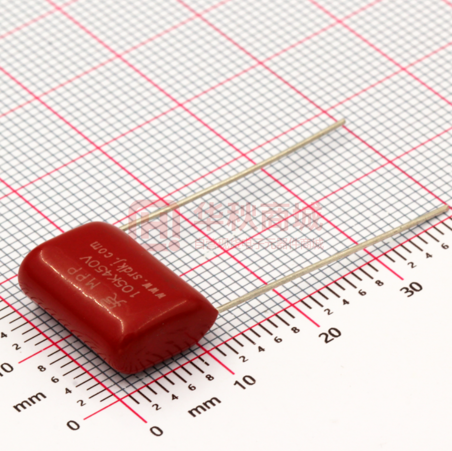

    薄膜电容 CAP_19X6MM_TM 1µF ±10% 19.00 x 6.00mm 450V
