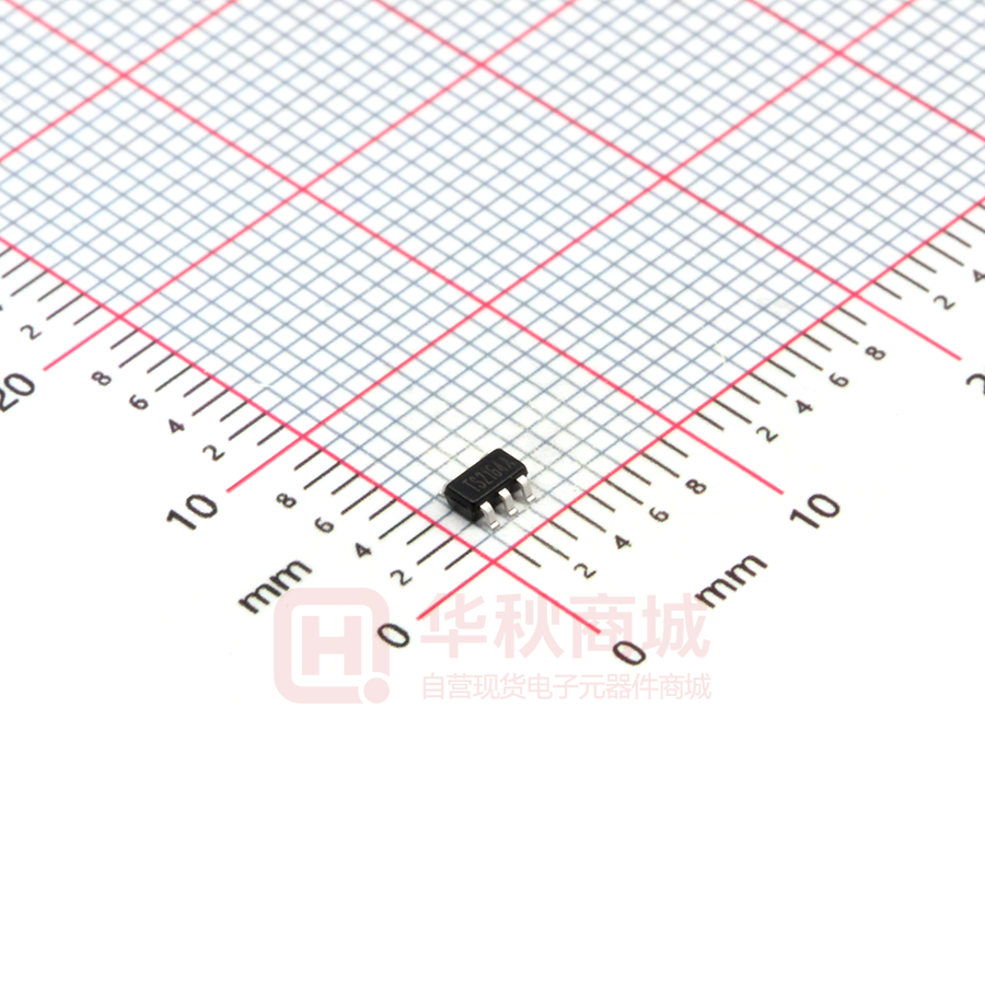

TS2164A
TS2164A
    TRUSIGNAL(坤元微电子)
    SOT23-5
    6.5MHz,轨对轨输入/输出CMOS运算放大器
TS2164A 数据手册
TS2163A/TS2164A TS2263A/TS2264A TS2464A Trusignal Microelectronics Datasheet July 2018 6.5MHz, Rail-to-Rail I/O CMOS Operational Amplifier Features         Product Description Low Offset Voltage: 1mV (typ) High Gain: 105dB (typ) High Gain Bandwidth Product: 6.5MHz Rail-to-rail Input/Output Low IB: 5pA (typ) Low supply voltage: +2.7 V to +5.5 V Low Power Consumption: 580μA at 5 V (per amplifer) Extended Temperature : -40°C to +125°C Applications         Signal Conditioning Current Sensor Amplifier Battery-Powered Applications Portable Devices Active Filtering Weight Scale Sensor Medical/Industrial Instrumentation Power Converter/Inverter The TS2163A/TS2164A families of products are low noise, low voltage and low power operational amplifiers with high gain-bandwidth product of 6.5MHz and slew rate of 5V/μs. The maximum input offset voltage is only 3.5mV and the input common mode range extends beyond the supply rails. TS2163A/TS2164A families of operational amplifiers are specified at the full temperature range of −40C to +125C under single or dual power supplies of 2.7V to 5.5V, however these products will operate under an extended supply range from 2.7V to 5.5V at a reduced temperatures range. The TS2163A and TS2263A have a power-down feature that reduces the supply current to 1uA. TS2163A TS2164A 5 V+ OUT 1 5 Enable V- 2 V- 2 + - +IN 3 +IN 3 4 -IN NC 1 + V- 4 8 NC NC 1 7 V+ -IN 2 14 OUTD - + + - +INA 3 V+ 13 -IND 12 +IND V- 11 4 8 Enable +INB 5 7 V+ 6 OUT +IN 3 6 OUT 5 NC V- 4 5 NC -INB 6 10 +INC - + + - OUTB 7 SO-8 SO-8 OUTA 1 -INA 2 TS2163A TS2164A +IN 3 4 -IN SOT23-6 SOT23-5 -IN 2 TS2464A 6 V+ OUT 1 9 -INC 8 OUTC SO-14,TSSOP-14 TS2263A TS2264A OUTA 1 -INA 2 8 - +INA 3 V- + + 4 - 7 OUTB 6 -INB 10 V+ -INA 2 9 OUTB +INA 3 8 -INB V- 5 S0-8 V+ +INB TS2263A OUTA 1 4 7 +INB OUTA -INA +INA V- 6 EnableB EnableA 5 V+ Underside die pad must be connected to V- www.kunyuanic.com -INB +INB EnableB EnableA MSOP-10 DFN-10 REV KY.1.0.2B1 OUTB TS2163A/TS2164A TS2263A/TS2264A TS2464A Trusignal Microelectronics Datasheet July 2018 ORDERING INFORMATION Model Part Number Eco Plan Package AMP Shutdown Container, Pack Qty TS2164A TS2164ASOT235R Rohs SOT23-5 1 NO Reel,3000 TS2164A TS2164ASO8R Rohs SO-8 1 NO Reel,2500 TS2163A TS2163ASOT236R Rohs SOT23-6 1 YES Reel,3000 TS2163A TS2163ASO8R Rohs SO-8 1 YES Reel,2500 TS2263A TS2263AMSOP10R Rohs MSOP-10 2 YES Reel,4000 TS2264A TS2264ASO8R Rohs SO-8 2 NO Reel,2500 TS2264A TS2264AMSO8R Rohs MSOP-8 2 NO Reel,4000 TS2264A TS2264ATSSO8R Rohs TSSOP-8 2 NO Reel,4000 TS2464A TS2464ASO14R Rohs SO-14 4 NO Reel,2500 TS2464A TS2464ATSSOP14R Rohs TSSOP-14 4 NO Reel,3000 TS2263A TS2263ADFN10R Rohs DFN-10 2 YES Reel,2500 ABSOLUTE MAXIMUM RATINGS Parameter Supply Voltage Signal Input Terminal voltage Operating Temperature Junction Temperature Storage Temperature Range Lead Temperature (Soldering, 10s) Min Max 7 Unit V (V-)-0.5 (V+)+0.5 V -50 150 150 C C -65 150 C 260 C ESD HBM ±3000 V ESD MM ±400 V ESC CDM ±1000 V ESD CAUTION ESD (electrostatic discharge) sensitive device Charged devices and circuit boards can discharge without detection. Although this product features patented or proprietary protection circuitry, damage may occur on devices subjects to high energy ESD. Therefore, proper ESD precautions should be taken to avoid performance degradation or loss of functionality. REV KY.1.0.2B1 2 www.kunyuanic.com TS2163A/TS2164A TS2263A/TS2264A TS2464A Trusignal Microelectronics Datasheet July 2018 ELECTRICAL CHARACTERISTICS: VS = +2.7V to +5.5V Boldface limits apply over the specified temperature range, TA = −40C to +125C. At TA = +25C, RL = 10kΩ connected to VS/2, and VOUT = VS/2, unless otherwise noted. Symbol Parameter VS VIN +/IS Power Supply Voltage Input Voltage Range Supply Current(per amplifer) Power Supply Rejection Ratio PSRR TA = −40C to +125C Operating Conditions Min Typ 2.7 (V-)-0.2 IO=0 580 VS =2.7 to VS =5.5V, VCM
