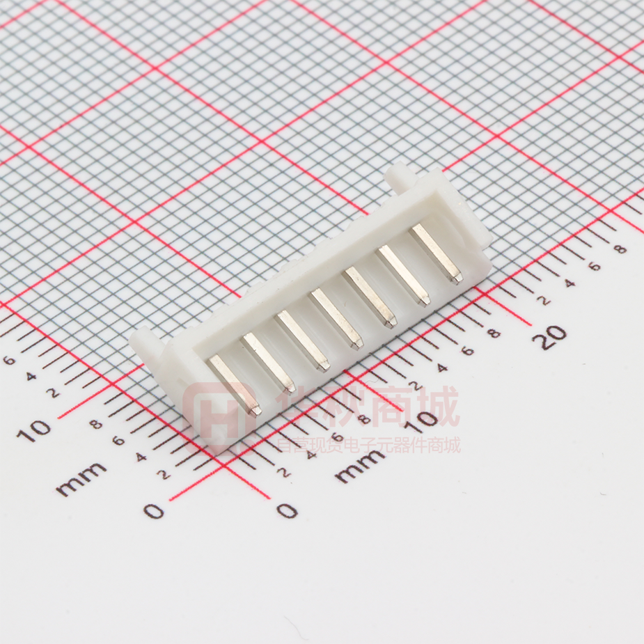

    线对板连接器 7Pin(1x7) P=2.50mm 弯插
A2502WR-7P 数据手册
A2502 SERIES 2.50mm pitch wire to board connector Specifications Current rating:3A AC,DC Voltage rating:250V AC,DC Temperature range:-40°C~+105°C Contact resistance:10mΩMax. Insulation resistance:1000MΩMin. Withstanding voltage:800V AC/minute *Compliant with RoHS and REACH* *Meet the HF/Halogen Free,need to customize* *Contact CJT for details* Standards E326732 E326732 1.60 1.60 4.20 8.05.REF 3.80 8.72.REF CHANGJIANG CONNECTORS TEL:+86-755-29959119 29959129 FAX:+86-755-29959139 Http://www.CJT.cn A-290 A2502 SERIES A2502-T 2.50mm pitch wire to board connector 2.50mm pitch Crimp Terminal Reference Informations: *Used in CJT A2502H-XP,A2511H-XP series Housing 2.60±0.25 0.40 1.90±0.25 1.08±0.25 1.30±0.25 1.60±0.25 B 2.05±0.25 B SEC:A-A 1.45±0.25 A 5.65±0.25 A 2.80±0.25 0.80 1.38±0.25 0.20 SEC:B-B 0.80 1.55±0.25 Unit:mm Ordering information & Specifications Part NO. Wire Range Insulation O.D. Material Finish Qty/reel A2502-TP AWG#22-#30 1.90mm(max) Phosphor Bronze Tin over Nickel 10,000 PCS AWG#22-#30 1.90mm(max) Phosphor Bronze Gold over Nickel 10,000 PCS A2502-GP Optional Gold plating available but MOQ requested A2502H-XP 2.50mm pitch Housing Ordering Information: A2502H-XP - *** - ** 1 2 3 1.Part No. 2.Material: (Blank):Nylon 66,UL94V-0 GWT:Nylon 66,UL94V-0,GWT 750 ℃ 3.Color: (Blank):White RD:Red OR:Orange YL:Yellow GY:Gray BL:Blue PK:Pink BK:Black BR:Brown GN:Green VI:Violet TR:Tomato red LY:Lemon yellow LE:Light blue VY:Vivid yellow Reference Informations: *Material:Nylon 66,UL94V-0 *Suitable CJT A2502-T series Terminal *Mates with CJT A2502WV,WR-XP series Wafer *Color:White 2.50±0.10 Circuit 1 Ordering Information & Dimensions A±0.20 PART NO. B±0.25 6.45±0.25 7.05±0.25 3.40±0.25 3.80±0.25 2P 3P 4P 5P 6P 7P 8P 9P 10P 11P 12P 13P 14P 15P Dimensions A B 2.50 7.00 5.00 9.50 7.50 12.00 10.00 14.50 12.50 17.00 15.00 19.50 17.50 22.00 20.00 24.50 22.50 27.00 25.00 29.50 27.50 32.00 30.00 34.50 32.50 37.00 35.00 39.50 Unit: mm CHANGJIANG CONNECTORS TEL:+86-755-29959119 29959129 FAX:+86-755-29959139 Http://www.CJT.cn A-291 A2502 SERIES A2502HWV-XP 2.50mm pitch wire to board connector 2.50mm pitch Housing 5.00±0.25 Reference Informations: *Material:Pin:Phosphor Bronze/Tin over Nickel Insulator:PBT,UL94V-0 *Mates with CJT A2502WVA,WRA-XP,A2502WVB,WRB-XP, A2502WVA-N,WRA-N-XP,A2502WVB-N,WRB-N-XP series Wafer *Color:Gray A±0.20 2P~7P 6.90±0.25 2.50±0.10 17.50±0.25 Circuit 1 B±0.25 16P~20P Ordering Information: A2502HWV-XP - *** - ** 1 2 3 1.Part No. 2.Material: (Blank):PBT,UL94V-0 GWT:PBT,UL94V-0,GWT 750 ℃ 3.Finish: (blank):Tin over Nickel G:Gold over Nickel Ordering Information & Dimensions PART NO. 2P 3P 4P 5P 6P 7P 8P 9P 10P 11P 12P 13P 14P 15P 16P 17P 18P 19P 20P 14.85±0.25 6.00±0.25 8P~15P Dimensions A B 2.50 7.40 5.00 9.90 7.50 12.40 10.00 14.90 12.50 17.40 15.00 19.90 17.50 22.40 20.00 24.90 22.50 27.40 25.00 29.90 27.50 32.40 30.00 34.90 32.50 37.40 35.00 39.90 37.50 42.40 40.00 44.90 42.50 47.40 45.00 49.90 47.50 52.40 Unit: mm A2502WV-XP 2.50mm pitch 180° Wafer Ordering Information: A2502WV-XP - * - *** - ** - ** 1 2 3 4 5 1.Part No. 2.Style (blank):Type 1 2:Type 2 3.Material: (Blank):Nylon 66,UL94V-0 GWT:Nylon 66,UL94V-0,GWT 750 ℃ 4.Color: (Blank):White RD:Red YL:Yellow BL:Blue BK:Black GN:Green 5.Finish: (blank):Tin over Nickel G:Gold over Nickel 1.60 Reference Informations: *Material:Pin:Brass/Tin over Nickel Insulator:Nylon 66,UL94V-0 *Mates with CJT A2502H-XP series Housing *Color:White 2.50±0.10 A±0.20 P.C.B LAYOUT PART NO. 6.05±0.25 5.20±0.25 5.20±0.25 3.20±0.20 3.80±0.25 6.05±0.25 3.80±0.25 0.80 PIN 0.64 SQ Circuit 1 Ø0.90+0.10 -0.00 Ordering Information & Dimensions 3.20±0.20 B±0.25 2.50±0.05 TYPE 1 TYPE 2 2P 3P 4P 5P 6P 7P 8P 9P 10P 11P 12P 13P 14P 15P Dimensions A B 2.50 7.50 5.00 10.00 7.50 12.50 10.00 15.00 12.50 17.50 15.00 20.00 17.50 22.50 20.00 25.00 22.50 27.50 25.00 30.00 27.50 32.50 30.00 35.00 32.50 37.50 35.00 40.00 Unit: mm CHANGJIANG CONNECTORS TEL:+86-755-29959119 29959129 FAX:+86-755-29959139 Http://www.CJT.cn A-292 A2502 SERIES A2502WR-XP 2.50mm pitch wire to board connector 2.50mm pitch 90° Wafer Reference Informations: *Material:Pin:Brass/Tin over Nickel Insulator:Nylon 66,UL94V-0 *Mates with CJT A2502H-XP series Housing *Color:White Ordering Information: A2502WR-XP - * - *** - ** - ** 1 2 3 4 5 1.Part No. 2.Style (blank):Type 1 2:Type 2 3.Material: (Blank):Nylon 66,UL94V-0 GWT:Nylon 66,UL94V-0,GWT 750 ℃ 4.Color: (Blank):White RD:Red OR:Orange YL:Yellow GY:Gray BL:Blue PK:Pink BK:Black BR:Brown GN:Green VI:Violet TR:Tomato red LY:Lemon yellow LE:Light blue VY:Vivid yellow 5.Finish: Ordering (blank):Tin over Nickel G:Gold over Nickel 2.50±0.05 Ø0.90+0.10 -0.00 PIN 0.64 SQ P.C.B LAYOUT 2.50±0.10 Information & Dimensions PART NO. A±0.20 TYPE 2 4.20±0.25 6.70±0.25 0.80 5.20±0.25 8.20±0.25 B±0.25 3.20±0.20 Circuit 1 TYPE 1 2P 3P 4P 5P 6P 7P 8P 9P 10P 11P 12P 13P 14P 15P Dimensions A B 2.50 7.50 5.00 10.00 7.50 12.50 10.00 15.00 12.50 17.50 15.00 20.00 17.50 22.50 20.00 25.00 22.50 27.50 25.00 30.00 27.50 32.50 30.00 35.00 32.50 37.50 35.00 40.00 Unit: mm A2502WVA-XP 2.50mm pitch 180° Wafer Reference Informations: *Material:Pin:Brass/Tin over Nickel Insulator:PBT+15%GF,UL94V-0 *Mates with CJT A2502HWV-XP series Housing *Color:Gray Ordering Information: A2502WVA-XP - *** - ** 1 2 3 1.Part No. 2.Material: (Blank):PBT,UL94V-0 GWT:PBT,UL94V-0,GWT 750 ℃ 3.Finish: (blank):Tin over Nickel G:Gold over Nickel A±0.10 2.50±0.05 Ø1.00±0.05 P.C.B LAYOUT 2.50±0.10 Ordering Information & Dimensions A±0.20 PART NO. 7.50±0.25 23.10±0.25 3.10±0.20 6.55±0.25 14.00±0.25 5.50±0.25 0.60 0.65 B±0.25 2P 3P 4P 5P 6P 7P 8P 9P 10P 11P 12P 13P 14P 15P 16P 17P 18P 19P 20P Dimensions A B 2.50 9.70 5.00 12.20 7.50 14.70 10.00 17.20 12.50 19.70 15.00 22.20 17.50 24.70 20.00 27.20 22.50 29.70 25.00 32.20 27.50 34.70 30.00 37.20 32.50 39.70 35.00 42.20 37.50 44.70 40.00 47.20 42.50 49.70 45.00 52.20 47.50 54.70 Unit: mm CHANGJIANG CONNECTORS TEL:+86-755-29959119 29959129 FAX:+86-755-29959139 Http://www.CJT.cn A-293 A2502 SERIES A2502WRA-XP 2.50mm pitch wire to board connector 2.50mm pitch 90° Wafer Reference Informations: *Material:Pin:Brass/Tin over Nickel Insulator:PBT+15%GF,UL94V-0 *Mates with CJT A2502HWV-XP series Housing *Color:Gray Ordering Information: A2502WRA-XP - *** - ** 1 2 3 1.Part No. 2.Material: (Blank):PBT,UL94V-0 GWT:PBT,UL94V-0,GWT 750 ℃ 3.Finish: (blank):Tin over Nickel G:Gold over Nickel A±0.10 2.50±0.05 ∅1.00±0.05 P.C.B LAYOUT Ordering Information & Dimensions 2.50±0.10 PART NO. A±0.20 7.50±0.25 0.60 0.65 14.00±0.25 6.55±0.25 23.10±0.25 5.50±0.25 3.10±0.20 B±0.25 2P 3P 4P 5P 6P 7P 8P 9P 10P 11P 12P 13P 14P 15P 16P 17P 18P 19P 20P Dimensions A B 2.50 9.70 5.00 12.20 7.50 14.70 10.00 17.20 12.50 19.70 15.00 22.20 17.50 24.70 20.00 27.20 22.50 29.70 25.00 32.20 27.50 34.70 30.00 37.20 32.50 39.70 35.00 42.20 37.50 44.70 40.00 47.20 42.50 49.70 45.00 52.20 47.50 54.70 Unit: mm A2502WVA-N-XP 2.50mm pitch 180° Wafer Reference Informations: *Material:Pin:Brass/Tin over Nickel Insulator:PBT+15%GF,UL94V-0 *Mates with CJT A2502HWV-XP series Housing *Color:Gray Ordering Information: A2502WVA-N-XP - *** - ** 1 2 3 1.Part No. 2.Material: (Blank):PBT,UL94V-0 GWT:PBT,UL94V-0,GWT 750 ℃ 3.Finish: (blank):Tin over Nickel G:Gold over Nickel A±0.10 2.50±0.05 ∅1.00±0.05 Ordering Information & Dimensions P.C.B LAYOUT 2.50±0.10 PART NO. A±0.20 3.10±0.20 14.00±0.25 6.55±0.25 14.00±0.25 7.50±0.25 B±0.25 0.60 0.65 2P 3P 4P 5P 6P 7P 8P 9P 10P 11P 12P 13P 14P 15P 16P 17P 18P 19P 20P Dimensions A B 2.50 9.70 5.00 12.20 7.50 14.70 10.00 17.20 12.50 19.70 15.00 22.20 17.50 24.70 20.00 27.20 22.50 29.70 25.00 32.20 27.50 34.70 30.00 37.20 32.50 39.70 35.00 42.20 37.50 44.70 40.00 47.20 42.50 49.70 45.00 52.20 47.50 54.70 Unit: mm CHANGJIANG CONNECTORS TEL:+86-755-29959119 29959129 FAX:+86-755-29959139 Http://www.CJT.cn A-294 A2502 SERIES A2502WRA-N-XP 2.50mm pitch wire to board connector 2.50mm pitch 90° Wafer Reference Informations: *Material:Pin:Brass/Tin over Nickel Insulator:PBT+15%GF,UL94V-0 *Mates with CJT A2502HWV-XP series Housing *Color:Gray Ordering Information: A2502WRA-N-XP - *** - ** 1 2 3 1.Part No. 2.Material: (Blank):PBT,UL94V-0 GWT:PBT,UL94V-0,GWT 750 ℃ 3.Finish: (blank):Tin over Nickel G:Gold over Nickel A±0.10 2.50±0.05 Ordering Information & Dimensions ∅1.00±0.05 2.50±0.10 2P 3P 4P 5P 6P 7P 8P 9P 10P 11P 12P 13P 14P 15P 16P 17P 18P 19P 20P A±0.20 B±0.25 0.65 6.55±0.25 14.00±0.25 7.50±0.25 0.60 Dimensions A B 2.50 9.70 5.00 12.20 7.50 14.70 10.00 17.20 12.50 19.70 15.00 22.20 17.50 24.70 20.00 27.20 22.50 29.70 25.00 32.20 27.50 34.70 30.00 37.20 32.50 39.70 35.00 42.20 37.50 44.70 40.00 47.20 42.50 49.70 45.00 52.20 47.50 54.70 PART NO. P.C.B LAYOUT 3.10±0.20 Unit: mm Ordering Information: A2502WVB-XP - *** - *** - ** 1 2 3 4 1.Part No. 2.Style: (Blank):TYPE 1 2:TYPE 2 3.Material: (Blank):PBT,UL94V-0 GWT:PBT,UL94V-0,GWT 750 ℃ 4.Finish: (blank):Tin over Nickel G:Gold over Nickel A A 2.50 P.C.B LAYOUT (TYPE 1) A±0.20 PART NO. 7.50±0.25 23.10±0.25 3.10±0.20 14.00±0.25 6.55±0.25 0.60 0.65 3.75±0.20 B±0.25 ∅1.00 P.C.B LAYOUT (TYPE 2) Ordering Information & Dimensions 2.50±0.10 5.50±0.25 2.50 ∅1.00 3.75 Reference Informations: *Material:Pin:Brass/Tin over Nickel Insulator:PBT+15%GF,UL94V-0 *Mates with CJT A2502HWV-XP series Housing *Color:Gray 2.50mm pitch 180° Wafer 3.75 A2502WVB-XP 2P 3P 4P 5P 6P 7P 8P 9P 10P 11P 12P 13P 14P 15P 16P 17P 18P 19P 20P Dimensions A B 2.50 9.70 5.00 12.20 7.50 14.70 10.00 17.20 12.50 19.70 15.00 22.20 17.50 24.70 20.00 27.20 22.50 29.70 25.00 32.20 27.50 34.70 30.00 37.20 32.50 39.70 35.00 42.20 37.50 44.70 40.00 47.20 42.50 49.70 45.00 52.20 47.50 54.70 Unit: mm CHANGJIANG CONNECTORS TEL:+86-755-29959119 29959129 FAX:+86-755-29959139 Http://www.CJT.cn A-295 A2502 SERIES A2502WRB-XP 2.50mm pitch wire to board connector 2.50mm pitch 90° Wafer A A Ordering Information: A2502WRB-XP - *** - *** - ** 1 2 3 4 1.Part No. 2.Style: (Blank):TYPE 1 2:TYPE 2 3.Material: (Blank):PBT,UL94V-0 GWT:PBT,UL94V-0,GWT 750 ℃ 4.Finish: (blank):Tin over Nickel G:Gold over Nickel 3.75 2.50±0.10 ∅1.00 P.C.B LAYOUT (TYPE 2) P.C.B LAYOUT (TYPE 1) Ordering Information & Dimensions A±0.20 Dimensions A B 2.50 9.70 5.00 12.20 7.50 14.70 10.00 17.20 12.50 19.70 15.00 22.20 17.50 24.70 20.00 27.20 22.50 29.70 25.00 32.20 27.50 34.70 30.00 37.20 32.50 39.70 35.00 42.20 37.50 44.70 40.00 47.20 42.50 49.70 45.00 52.20 47.50 54.70 PART NO. 7.50±0.25 3.75±0.20 0.65 14.00±0.25 3.57 2.65 6.55±0.25 23.10±0.25 5.50±0.25 0.60 3.10±0.20 B±0.25 ∅1.00 2.50 2.50 3.75 Reference Informations: *Material:Pin:Brass/Tin over Nickel Insulator:PBT+15%GF,UL94V-0 *Mates with CJT A2502HWV-XP series Housing *Color:Gray 2P 3P 4P 5P 6P 7P 8P 9P 10P 11P 12P 13P 14P 15P 16P 17P 18P 19P 20P Unit: mm Ordering Information: A2502WVB-N-XP - *** - *** - ** 1 2 3 4 1.Part No. 2.Style: (Blank):TYPE 1 2:TYPE 2 3.Material: (Blank):PBT,UL94V-0 GWT:PBT,UL94V-0,GWT 750 ℃ 4.Finish: (blank):Tin over Nickel G:Gold over Nickel A A 2.50 P.C.B LAYOUT (TYPE 1) PART NO. A±0.20 7.50±0.25 14.00±0.25 3.10±0.20 14.00±0.25 6.55±0.25 0.60 ∅1.00 P.C.B LAYOUT (TYPE 2) Ordering Information & Dimensions 2.50±0.10 B±0.25 2.50 ∅1.00 3.75 Reference Informations: *Material:Pin:Brass/Tin over Nickel Insulator:PBT+15%GF,UL94V-0 *Mates with CJT A2502HWV-XP series Housing *Color:Gray 2.50mm pitch 180° Wafer 3.75 A2502WVB-N-XP 0.65 3.75±0.20 2P 3P 4P 5P 6P 7P 8P 9P 10P 11P 12P 13P 14P 15P 16P 17P 18P 19P 20P Dimensions A B 2.50 9.70 5.00 12.20 7.50 14.70 10.00 17.20 12.50 19.70 15.00 22.20 17.50 24.70 20.00 27.20 22.50 29.70 25.00 32.20 27.50 34.70 30.00 37.20 32.50 39.70 35.00 42.20 37.50 44.70 40.00 47.20 42.50 49.70 45.00 52.20 47.50 54.70 Unit: mm CHANGJIANG CONNECTORS TEL:+86-755-29959119 29959129 FAX:+86-755-29959139 Http://www.CJT.cn A-296 A2502 SERIES A2502WRB-N-XP 2.50mm pitch wire to board connector 2.50mm pitch 90° Wafer A A ∅1.00 P.C.B LAYOUT (TYPE 2) P.C.B LAYOUT (TYPE 1) Ordering Information & Dimensions 2.50±0.10 PART NO. A±0.20 B±0.25 3.10±0.20 3.75±0.20 0.65 3.57 2.65 6.55±0.25 14.00±0.25 7.50±0.25 0.60 ∅1.00 2.50 2.50 3.75 Ordering Information: A2502WRB-N-XP - *** - *** - ** 1 2 3 4 1.Part No. 2.Style: (Blank):TYPE 1 2:TYPE 2 3.Material: (Blank):PBT,UL94V-0 GWT:PBT,UL94V-0,GWT 750 ℃ 4.Finish: (blank):Tin over Nickel G:Gold over Nickel 3.75 Reference Informations: *Material:Pin:Brass/Tin over Nickel Insulator:PBT +15%GF,UL94V-0 *Mates with CJT A2502HWV-XP series Housing *Color:Gray 2P 3P 4P 5P 6P 7P 8P 9P 10P 11P 12P 13P 14P 15P 16P 17P 18P 19P 20P Dimensions A B 2.50 9.70 5.00 12.20 7.50 14.70 10.00 17.20 12.50 19.70 15.00 22.20 17.50 24.70 20.00 27.20 22.50 29.70 25.00 32.20 27.50 34.70 30.00 37.20 32.50 39.70 35.00 42.20 37.50 44.70 40.00 47.20 42.50 49.70 45.00 52.20 47.50 54.70 Unit: mm CHANGJIANG CONNECTORS TEL:+86-755-29959119 29959129 FAX:+86-755-29959139 Http://www.CJT.cn A-297
