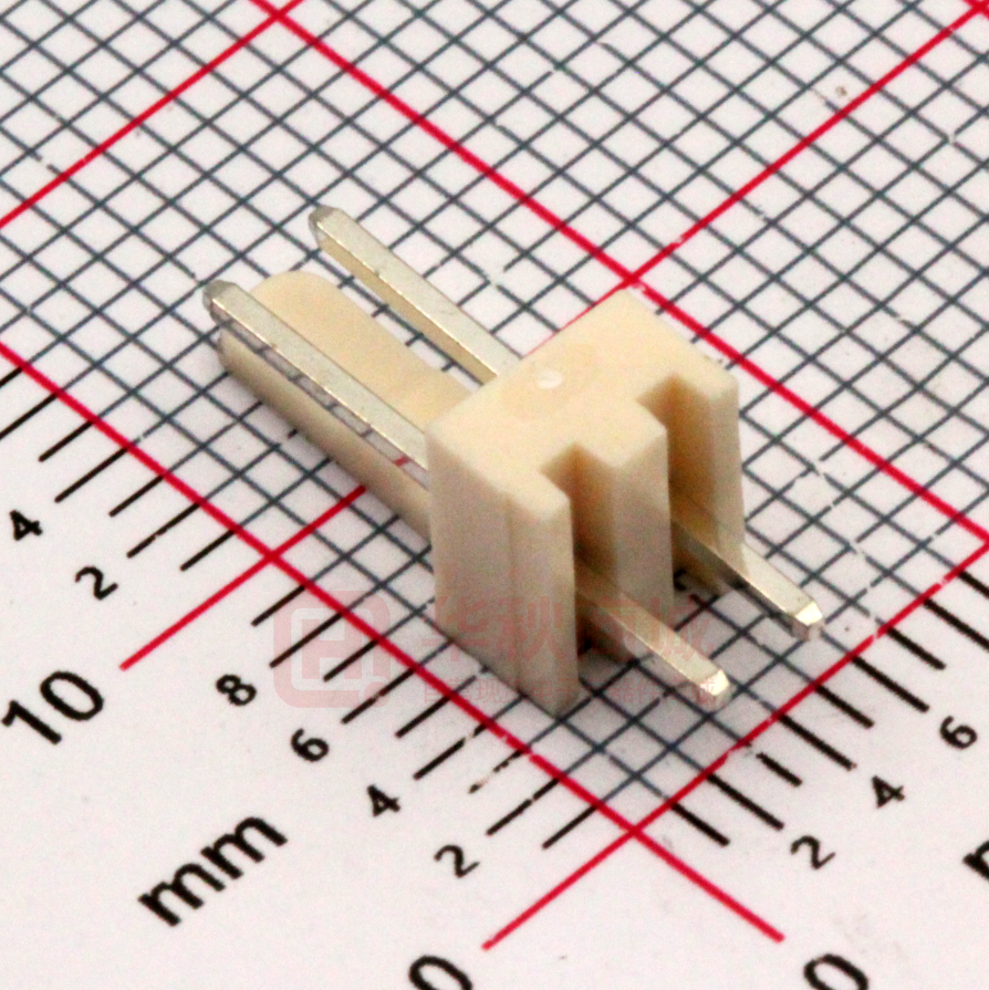

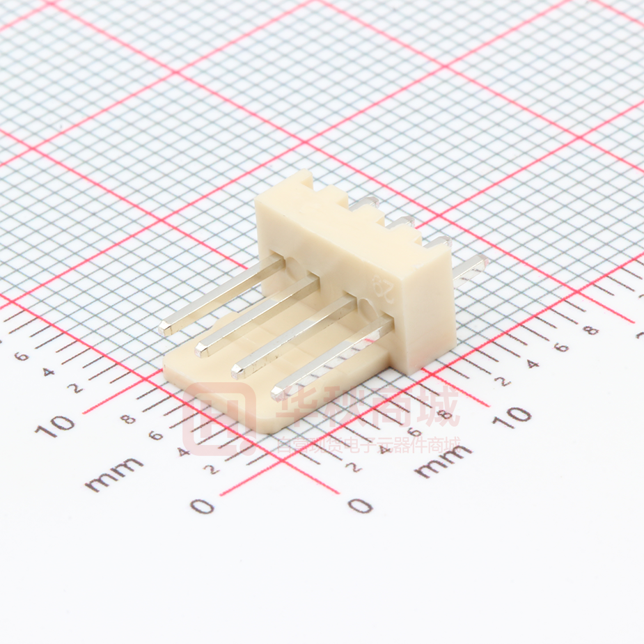

A2543 SERIES 2.54mm pitch wire to board connector Specifications Current rating:4A AC,DC Voltage rating:250V AC,DC Temperature range:-40°C~+105°C Contact resistance:10mΩMax. Insulation resistance:1000MΩMin. Withstanding voltage:1000V AC/minute *Compliant with RoHS and REACH* *Meet the HF/Halogen Free,need to customize* *Contact CJT for details* Standards E326732 6.70 16.15.REF 6.15 1.80 1.60 1.80 17.83.REF 6.15 6.70 1.60 1.80 1.60 16.03.REF 1.60 1.80 E326732 17.95.REF CHANGJIANG CONNECTORS TEL:+86-755-29959119 29959129 FAX:+86-755-29959139 Http://www.CJT.cn A-399 A2543 SERIES A2543-T 2.54mm pitch wire to board connector 2.54mm Pitch Crimp Terminal 2.00±0.25 Reference Informations: *Used in CJT A2543H-XP,A2543HA,HB-XP-WH,A2543HC-4P,C2504AH-XP series Housing 0.20 1.50 2.15±0.25 SEC:A-A 1.60±0.25 2.00 1.90±0.25 3.60±0.25 B 3.30±0.20 B A 9.40±0.25 A 2.90±0.20 1.25±0.20 SEC:B-B 0.80±0.05 1.92±0.20 Unit:mm Ordering information & Specifications: Wire Range Part NO. A2543-TB A2543-TP A2543-GB A2543-GP AWG#22-#28 AWG#22-#28 AWG#22-#28 AWG#22-#28 Insulation O.D. 1.90mm(max) 1.90mm(max) 1.90mm(max) 1.90mm(max) Material Brass Phosphor Bronze Brass Phosphor Bronze Finish Tin over Nickel Tin over Nickel Gold over Nickel Gold over Nickel Qty/reel 10,000 PCS 10,000 PCS 10,000 PCS 10,000 PCS Optional Gold plating available but MOQ requested A2543H-XP 2.54mm Pitch Housing Reference Informations: *Material:Nylon 66,UL94V-0 *Suitable CJT A2543-T series Terminal *Mates with CJT A2543WV,WR-XP,A2543WR-XP-L, A2543WR-S-XP series Wafer *Color:Beige or White Ordering Information & Dimensions: PART NO. Ordering Information: A2543H-XP - * - *** 1 2 3 1.Part No. 2.Style: (blank) :Type 1/Beige 2 :Type 2/White 3.Material: (Blank):Nylon 66,UL94V-0 GWT:Nylon 66,UL94V-0,GWT 750 ℃ Circuit 1 2.54±0.10 A±0.20 B±0.25 8.00±0.20 12.85±0.25 CJTCONN 6.15±0.25 4.90±0.25 4.90±0.25 TYPE 1 TYPE 2 2P 3P 4P 5P 6P 7P 8P 9P 10P 11P 12P 13P 14P 15P 16P 17P 18P 19P 20P 21P 22P 23P 24P 25P Dimensions A B 2.54 5.68 5.08 8.22 7.62 10.76 10.16 13.30 12.70 15.84 15.24 18.38 17.78 20.92 20.32 23.46 22.86 26.00 25.40 28.54 27.94 31.08 30.48 33.62 33.02 36.16 35.56 38.70 38.10 41.24 40.64 43.78 43.18 46.32 45.72 48.86 48.26 51.40 50.80 53.94 53.34 56.48 55.88 59.02 58.42 61.56 60.96 64.10 Unit: mm CHANGJIANG CONNECTORS TEL:+86-755-29959119 29959129 FAX:+86-755-29959139 Http://www.CJT.cn A-400 A2543 SERIES A2543HA-XP-WH 2.54mm pitch wire to board connector 2.54mm Pitch Housing Reference Informations: *Material:Nylon 66,UL94V-0 *Suitable CJT A2543-T series Terminal *Mates with CJT A2543WVA,WRA-XP-WH, A2543WRD-XP,A2543WVB-S-XP, D2541WVA(-F)-XP,WRA-XP(-2) series Wafer *Color: White Ordering Information & Dimensions: PART NO. Ordering Information: A2543HA-XP-WH - *** 1 2 1.Part No. 2.Material: (Blank):Nylon 66,UL94V-0 GWT:Nylon 66,UL94V-0,GWT 750 ℃ Circuit 1 2P 3P 4P 5P 6P 7P 8P 9P 10P 11P 12P 13P 14P 15P 16P 17P 18P 19P 20P 21P 22P 23P 24P 25P 2.54±0.10 A±0.20 6.70±0.25 B±0.25 CJTCONN 12.85±0.25 2.20±0.20 4.90±0.25 Dimensions A B 2.54 5.68 5.08 8.22 7.62 10.76 10.16 13.30 12.70 15.84 15.24 18.38 17.78 20.92 20.32 23.46 22.86 26.00 25.40 28.54 27.94 31.08 30.48 33.62 33.02 36.16 35.56 38.70 38.10 41.24 40.64 43.78 43.18 46.32 45.72 48.86 48.26 51.40 50.80 53.94 53.34 56.48 55.88 59.02 58.42 61.56 60.96 64.10 Unit: mm A2543HB-XP-WH 2.54mm Pitch Housing Reference Informations: *Material:Nylon 66,UL94V-0 *Suitable CJT A2543-T series Terminal *Mates with CJT A2543WVA,WRA-XP-WH, A2543WRD-XP,A2543WVB-S-XP , D2541WVA(-F)-XP,WRA-XP(-2) series Wafer *Color:White Ordering Information & Dimensions: PART NO. Ordering Information: A2543HB-XP-WH - *** 1 2 1.Part No. 2.Material: (Blank):Nylon 66,UL94V-0 GWT:Nylon 66,UL94V-0,GWT 750 ℃ Circuit 1 2.54±0.10 A±0.20 5.40±0.25 B±0.25 2.20±0.20 12.85±0.25 CJTCONN 4.90±0.25 2P 3P 4P 5P 6P 7P 8P 9P 10P 11P 12P 13P 14P 15P 16P 17P 18P 19P 20P 21P 22P 23P 24P 25P Dimensions A B 2.54 5.68 5.08 8.22 7.62 10.76 10.16 13.30 12.70 15.84 15.24 18.38 17.78 20.92 20.32 23.46 22.86 26.00 25.40 28.54 27.94 31.08 30.48 33.62 33.02 36.16 35.56 38.70 38.10 41.24 40.64 43.78 43.18 46.32 45.72 48.86 48.26 51.40 50.80 53.94 53.34 56.48 55.88 59.02 58.42 61.56 60.96 64.10 Unit: mm CHANGJIANG CONNECTORS TEL:+86-755-29959119 29959129 FAX:+86-755-29959139 Http://www.CJT.cn A-401 A2543 SERIES A2543HC-4P 2.54mm pitch wire to board connector 2.54mm Pitch Housing Reference Informations: *Material:Nylon 66,UL94V-0 *Suitable CJT A2543-T series Terminal *Mates with CJT A2543WVC-4P series Wafer *Color:Beige Circuit 1 2.54±0.10 Ordering Information: A2543H-4P - *** 1 2 1.Part No. 2.Material: (Blank):Nylon 66,UL94V-0 GWT:Nylon 66,UL94V-0,GWT 750 ℃ 7.62±0.20 7.38±0.20 5.38±0.20 6.15±0.25 8.00±0.20 12.85±0.25 CJTCONN 10.76±0.25 4.90±0.25 A2543WV-XP Unit: mm 2.54mm pitch 180° Wafer Ordering Information: A2543WV-XP - *** - ** 1 2 3 1.Part No. 2.Material: (Blank):Nylon 66,UL94V-0 GWT:Nylon 66,UL94V-0,GWT 750 ℃ 3.Finish: (blank):Tin over Nickel G:Gold over Nickel Reference Informations: *Material:Pin:Brass/Tin over Nickel Insulator:Nylon 66,UL94V-0 *Mates with CJT A2543H-XP series Housing *Color:Beige Circuit 1 Ordering Information & Dimensions: PART NO. 2.54±0.10 2.54±0.10 ∅1.20±0.05 A±0.20 P.C.B LAYOUT 5.80±0.25 B±0.25 PIN 0.64 SQ 11.40±0.25 3.40±0.20 14.20±0.20 3.30±0.20 3.20±0.20 2P 3P 4P 5P 6P 7P 8P 9P 10P 11P 12P 13P 14P 15P 16P 17P 18P 19P 20P 21P 22P 23P 24P 25P 26P 27P 28P Dimensions A B 2.54 5.08 5.08 7.62 7.62 10.16 10.16 12.70 12.70 15.24 15.24 17.78 17.78 20.32 20.32 22.86 22.86 25.40 25.40 27.94 27.94 30.48 30.48 33.02 33.02 35.56 35.56 38.10 38.10 40.64 40.64 43.18 43.18 45.72 45.72 48.26 48.26 50.80 50.80 53.34 53.34 55.88 55.88 58.42 58.42 60.96 60.96 63.50 63.50 66.04 66.04 68.58 68.58 71.12 Unit: mm CHANGJIANG CONNECTORS TEL:+86-755-29959119 29959129 FAX:+86-755-29959139 Http://www.CJT.cn A-402 A2543 SERIES A2543WR-XP 2.54mm pitch wire to board connector 2.54mm pitch 90° Wafer Ordering Information: A2543WR-XP - * - *** - ** 1 2 3 4 1.Part No. 2.Style: (blank) :Type 1 2 :Type 2 3.Material: (Blank):Nylon 66,UL94V-0 GWT:Nylon 66,UL94V-0,GWT 750 ℃ 4.Finish: (blank):Tin over Nickel G:Gold over Nickel Reference Informations: *Material:Pin:Brass/Tin over Nickel Insulator:Nylon 66,UL94V-0 *Mates with CJT A2543H-XP series Housing *Color:Beige Ordering Information & Dimensions: PART NO. 2.54±0.10 2.54±0.10 ∅1.20±0.05 Circuit 1 P.C.B LAYOUT A±0.20 5.80±0.25 5.80±0.25 6.90±0.20 13.20±0.20 13.20±0.20 3.20±0.20 7.50±0.20 3.30±0.20 B±0.25 11.40±0.25 3.20±0.20 3.40±0.20 PIN 0.64 SQ 3.40±0.20 TYPE 1 A2543WR-XP-L TYPE 2 Ordering Information: A2543WR-XP-L - * - *** - ** 1 2 3 4 1.Part No. 2.Style: (blank) :Type 1 2 :Type 2 3.Material: (Blank):Nylon 66,UL94V-0 GWT:Nylon 66,UL94V-0,GWT 750 ℃ 4.Finish: (blank):Tin over Nickel G:Gold over Nickel Ordering Information & Dimensions: PART NO. 2.54±0.10 Circuit 1 ∅1.20±0.05 P.C.B LAYOUT A±0.20 5.80±0.25 5.80±0.25 11.34±0.25 11.40±0.25 3.30±0.20 7.50±0.25 3.40±0.20 6.90±0.25 3.20±0.20 3.20±0.20 11.34±0.25 B±0.25 PIN 0.64 SQ Unit: mm 2.54mm pitch 90° Wafer Reference Informations: *Material:Pin:Brass/Tin over Nickel Insulator:Nylon 66,UL94V-0 *Mates with CJT A2543H-XP series Housing *Color:Beige 2.54±0.10 2P 3P 4P 5P 6P 7P 8P 9P 10P 11P 12P 13P 14P 15P 16P 17P 18P 19P 20P 21P 22P 23P 24P 25P 26P 27P 28P Dimensions A B 2.54 5.08 5.08 7.62 7.62 10.16 10.16 12.70 12.70 15.24 15.24 17.78 17.78 20.32 20.32 22.86 22.86 25.40 25.40 27.94 27.94 30.48 30.48 33.02 33.02 35.56 35.56 38.10 38.10 40.64 40.64 43.18 43.18 45.72 45.72 48.26 48.26 50.80 50.80 53.34 53.34 55.88 55.88 58.42 58.42 60.96 60.96 63.50 63.50 66.04 66.04 68.58 68.58 71.12 3.40±0.20 TYPE 1 TYPE 2 2P 3P 4P 5P 6P 7P 8P 9P 10P 11P 12P 13P 14P 15P 16P 17P 18P 19P 20P 21P 22P 23P 24P 25P 26P 27P 28P Dimensions A B 2.54 5.08 5.08 7.62 7.62 10.16 10.16 12.70 12.70 15.24 15.24 17.78 17.78 20.32 20.32 22.86 22.86 25.40 25.40 27.94 27.94 30.48 30.48 33.02 33.02 35.56 35.56 38.10 38.10 40.64 40.64 43.18 43.18 45.72 45.72 48.26 48.26 50.80 50.80 53.34 53.34 55.88 55.88 58.42 58.42 60.96 60.96 63.50 63.50 66.04 66.04 68.58 68.58 71.12 Unit: mm CHANGJIANG CONNECTORS TEL:+86-755-29959119 29959129 FAX:+86-755-29959139 Http://www.CJT.cn A-403 A2543 SERIES A2543WVA-XP-WH 2.54mm pitch wire to board connector 2.54mm pitch 180° Wafer Reference Informations: *Material:Pin:Brass/Tin over Nickel Insulator:Nylon 66,UL94V-0 *Mates with CJT A2543HA,HB-XP-WH series Housing *Color:White Ordering Information & Dimensions: PART NO. Ordering Information: A2543WVA-XP-WH - *** - ** 1 2 3 1.Part No. 2.Material: (Blank):Nylon 66,UL94V-0 GWT:Nylon 66,UL94V-0,GWT 750 ℃ 3.Finish: (blank):Tin over Nickel G:Gold over Nickel Circuit 1 2.54±0.10 A±0.20 2.54±0.10 ∅1.02±0.05 6.35±0.25 3.25±0.20 8.18±0.25 P.C.B LAYOUT 3.40±0.20 14.20±0.25 3.18±0.20 B±0.20 2P 3P 4P 5P 6P 7P 8P 9P 10P 11P 12P 13P 14P 15P 16P 17P 18P 19P 20P 21P 22P 23P 24P 25P 26P 27P 28P PIN 0.64 SQ Unit: mm A2543WRA-XP-WH 2.54mm Pitch 90° Wafer Reference Informations: *Material:Pin:Brass/Tin over Nickel Insulator:Nylon 66,UL94V-0 *Mates with CJT A2543HA,HB-XP-WH series Housing *Color:White Ordering Information & Dimensions: PART NO. Ordering Information: A2543WRA-XP-WH - * - *** - ** 1 2 3 4 1.Part No. 2.Style: (blank) :Type 1 2 :Type 2 3.Material: (Blank):Nylon 66,UL94V-0 GWT:Nylon 66,UL94V-0,GWT 750 ℃ 4.Finish: (blank):Tin over Nickel G:Gold over Nickel Circuit 1 2.54±0.10 2.54±0.10 ∅1.02±0.05 P.C.B LAYOUT A±0.20 6.35±0.25 6.35±0.25 3.25±0.20 8.18±0.25 1.80 1.80 8.18±0.25 6.97±0.25 3.25±0.20 7.12±0.25 3.18±0.20 B±0.25 Dimensions A B 2.54 5.08 5.08 7.62 7.62 10.16 10.16 12.70 12.70 15.24 15.24 17.78 17.78 20.32 20.32 22.86 22.86 25.40 25.40 27.94 27.94 30.48 30.48 33.02 33.02 35.56 35.56 38.10 38.10 40.64 40.64 43.18 43.18 45.72 45.72 48.26 48.26 50.80 50.80 53.34 53.34 55.88 55.88 58.42 58.42 60.96 60.96 63.50 63.50 66.04 66.04 68.58 68.58 71.12 3.40±0.20 3.40±0.20 PIN 0.64 SQ TYPE 1 TYPE 2 2P 3P 4P 5P 6P 7P 8P 9P 10P 11P 12P 13P 14P 15P 16P 17P 18P 19P 20P 21P 22P 23P 24P 25P 26P 27P 28P Dimensions A B 2.54 5.08 5.08 7.62 7.62 10.16 10.16 12.70 12.70 15.24 15.24 17.78 17.78 20.32 20.32 22.86 22.86 25.40 25.40 27.94 27.94 30.48 30.48 33.02 33.02 35.56 35.56 38.10 38.10 40.64 40.64 43.18 43.18 45.72 45.72 48.26 48.26 50.80 50.80 53.34 53.34 55.88 55.88 58.42 58.42 60.96 60.96 63.50 63.50 66.04 66.04 68.58 68.58 71.12 Unit: mm CHANGJIANG CONNECTORS TEL:+86-755-29959119 29959129 FAX:+86-755-29959139 Http://www.CJT.cn A-404 A2543 SERIES A2543WVC-4P 2.54mm pitch wire to board connector 2.54mm pitch 180° Wafer Ordering Information: A2543WVC-4P - *** - ** 1 2 3 1.Part No. 2.Material: (Blank):Nylon 66,UL94V-0 GWT:Nylon 66,UL94V-0,GWT 750 ℃ 3.Finish: (blank):Tin over Nickel G:Gold over Nickel Reference Informations: *Material:Pin:Brass/Tin over Nickel Insulator:Nylon 66,UL94V-0 *Mates with CJT A2543HC-4P series Housing *Color:Beige Circuit 1 2.54±0.10 ∅1.02±0.05 2.54±0.10 P.C.B LAYOUT 7.62±0.20 5.80±0.25 10.16±0.25 8.00±0.20 2.50±0.20 3.50±0.20 13.50±0.25 2.54±0.20 PIN 0.64 SQ Unit: mm A2543WRD-XP 2.54mm Pitch 90° Wafer Ordering Information: A2543WRD-XP - *** - ** 1 2 3 1.Part No. 2.Material: (Blank):Nylon 66,UL94V-0 GWT:Nylon 66,UL94V-0,GWT 750 ℃ 3.Finish: (blank):Tin over Nickel G:Gold over Nickel Reference Informations: *Material:Pin:Brass/Tin over Nickel Insulator:Nylon 66,UL94V-0 *Mates with CJT A2543HA,HB-XP-WH series Housing *Color:White 2.54±0.10 Ordering Information & Dimensions: Circuit 1 P.C.B LAYOUT 2.54±0.10 A±0.20 6.35±0.25 8.18±0.25 3.56±0.20 3.18±0.20 7.50±0.25 3.25±0.20 B±0.25 PIN 0.64 SQ PART NO. 2.80~4.00 ∅1.02±0.05 3.56±0.20 2P 3P 4P 5P 6P 7P 8P 9P 10P 11P 12P 13P 14P 15P 16P 17P 18P 19P 20P Dimensions A B 2.54 5.08 5.08 7.62 7.62 10.16 10.16 12.70 12.70 15.24 15.24 17.78 17.78 20.32 20.32 22.86 22.86 25.40 25.40 27.94 27.94 30.48 30.48 33.02 33.02 35.56 35.56 38.10 38.10 40.64 40.64 43.18 43.18 45.72 45.72 48.26 48.26 50.80 Unit: mm CHANGJIANG CONNECTORS TEL:+86-755-29959119 29959129 FAX:+86-755-29959139 Http://www.CJT.cn A-405 A2543 SERIES A2543WR-S-XP 2.54mm pitch wire to board connector 2.54mm Pitch 90° Wafer - SMT TYPE Reference Informations: *Material:Pin:Brass/Tin over Nickel Insulator:Nylon 9T,UL94V-0 *Mates with CJT A2543H-XP series Housing *Color:Natural 1.20 3.40 2.50±0.10 6.00 4.00 2.54±0.10 Ordering Information: A2543WR-S-XP - *** - ** 1 2 3 1.Part No. 2.Material: (Blank):Nylon 9T,UL94V-0 GWT:Nylon 9T,UL94V-0,GWT 750 ℃ 3.Finish: (blank):Tin over Nickel G:Gold over Nickel 1.10 2.54±0.10 1.73 1.73 A±0.20 B±0.25 13.55±0.25 4.25 11.30±0.25 7.00±0.20 P.C.B LAYOUT Ordering Information & Dimensions: PART NO. 2P 4P 5P 5.51±0.20 PIN 0.64 SQ Dimensions A B 2.54 7.62 7.62 12.70 10.16 15.24 Unit: mm A2543WVB-S-XP 2.54mm pitch 180° Wafer - SMT TYPE TYPICAL END VIEW FOR 2P THRU 7P 6.35±0.20 2.87±0.20 C±0.20 D±0.20 Odering Information: A2543WVB-S-XP - *** - ** - * 1 2 3 4 1.Part No. 2.Material: (Blank):LCP,UL94V-0 GWT:LCP,UL94V-0,GWT 750 ℃ 3.Color: (blank):Ivory BK:Black 4.Finish: (blank):Tin over Nickel G:Gold over Nickel 1.40 Reference Informations: *Material:Pin:Brass/Tin over Nickel Insulator:LCP,UL94V-0 *Mates with CJT A2543HA,HB-XP-WH series Housing *Color:Ivory 1.78±0.20 Circuit 1 Ordering Information & Dimensions: A±0.20 5.97±0.20 1.52±0.20 2.54±0.10 P.C.B LAYOUT B±0.25 6.40±0.20 7.37±0.20 8.81±0.20 3.18±0.20 1.27±0.20 4.04±0.20 10.70±0.25 5.00±0.20 Circuit 1 PART NO. 2P 3P 4P 5P 6P 7P 8P 9P 10P 11P 12P 13P 14P 15P 16P 17P 18P A 2.54 5.08 7.62 10.16 12.70 15.24 17.78 20.32 22.86 25.40 27.94 30.48 33.02 35.56 38.10 40.64 43.18 Dimensions B C 5.08 ---7.62 ---10.16 ---12.70 ------15.24 ---17.78 20.32 2.54 22.86 5.08 25.40 7.62 27.94 10.16 30.48 12.70 33.02 15.24 35.56 17.78 38.10 20.32 40.64 22.86 43.18 25.40 45.72 27.94 D ------------------------------- 7.62 7.62 12.70 12.70 12.70 12.70 12.70 Unit: mm CHANGJIANG CONNECTORS TEL:+86-755-29959119 29959129 FAX:+86-755-29959139 Http://www.CJT.cn A-406
