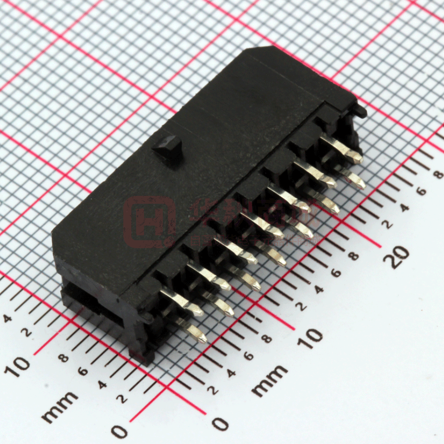

C3030 SERIES 3.00mm pitch wire to wire and wire to board connector Specifications Current rating:5A AC,DC Voltage rating:250V AC,DC Temperature range:-40°C~+105°C Contact resistance:10mΩ Max. Insulation resistance:1000MΩ Min. Withstanding voltage:1500V AC/minute *Compliant with RoHS and REACH* *Meet the HF/Halogen Free,GWT/Glow wire Test (IEC60335-1) request,need to customize* *Contact CJT for details* Standards E326732 E326732 CHANGJIANG CONNECTORS TEL:+86-755-29959119 29959129 FAX:+86-755-29959139 Http://www.CJT.cn C-72 C3030 SERIES 5.29 1.60 1.60 0.74 17.54 REF. 1.60 1.60 1.60 7.68 17.71 REF. 18.42 REF. 7.68 0.74 17.49 REF. 24.56 REF. 24.49 REF. 7.05 1.60 10.24 7.05 3.00mm pitch wire to wire and wire to board connector WIRE TO WIRE 7.68 5.29 7.68 17.71 REF. 17.66 REF. 17.54 REF. 17.51 REF. 1.60 16.86 REF. 5.29 1.96 1.60 BOARD TO BOARD 1.60 1.60 1.60 1.60 0.74 1.60 WIRE TO BOARD 0.69 4.20±0.10 3.05±0.10 5.50±0.20 3.20±0.20 A±0.10 +0.05 B-0.10 SINGLE ROW RECOMMENDED PANEL CUT-OUT (DESIGNED FOR 1.57mm TO 2.30mm THICK STAMPED PANEL OR PRINTED CIRCUIT BOARD) PART NO. 4.05±0.10 SINGLE ROW DUAL ROW C3030HM-2X1P(-A) --------------C3030HM-2X2P(-A) C3030HM-2P C3030HM-2X3P(-A) C3030HM-3P C3030HM-2X4P(-A) C3030HM-4P C3030HM-2X5P(-A) C3030HM-5P C3030HM-2X6P(-A) C3030HM-6P C3030HM-2X7P(-A) C3030HM-7P C3030HM-2X8P(-A) C3030HM-8P C3030HM-2X9P(-A) C3030HM-9P C3030HM-10P C3030HM-2X10P(-A) C3030HM-11P C3030HM-2X11P(-A) C3030HM-12P C3030HM-2X12P(-A) 8.70±0.20 7.10±0.10 2.00±0.20 A±0.10 B±0.10 DUAL ROW RECOMMENDED PANEL CUT-OUT (DESIGNED FOR 1.40mm TO 2.54mm THICK STAMPED PANEL OR PRINTED CIRCUIT BOARD) Dimensions A 4.20 7.20 10.20 13.20 16.20 19.20 22.20 25.20 28.20 31.20 34.20 37.20 B 7.90 10.90 13.90 16.90 19.90 22.90 25.90 28.90 31.90 34.90 37.90 40.90 Unit:mm CHANGJIANG CONNECTORS TEL:+86-755-29959119 29959129 FAX:+86-755-29959139 Http://www.CJT.cn C-73 C3030 SERIES 3.00mm pitch wire to wire and wire to board connector C3030HF 2P 3P 4P 5P 9P C3030HF 6P 10P 7P 8P 11P 12P C3030HM C3030HMA 7P C3030HM C3030HMA 6P 5P 4P 3P 2P 9P 8P 12P 11P 10P C3030WV C3030WV-S C3030WV-S-F 2P 3P 4P 7P C3030WV 8P 10P C3030WV-S 5P 6P 9P 11P 12P C3030WV-S-F C3030WR C3030WR-S C3030WR-S-F 2P 3P 4P 5P 6P C3030WR 7P 8P 9P C3030WR-S 10P 11P 12P C3030WR-S-F CHANGJIANG CONNECTORS TEL:+86-755-29959119 29959129 FAX:+86-755-29959139 Http://www.CJT.cn C-74 C3030 SERIES 3.00mm pitch wire to wire and wire to board connector C3030HF-2 2x1P C3030HF-2 2x2P 2x3P 2x7P 2x4P 2x5P 2x8P 2x6P 2x9P 2x10P 2x11P 2x12P C3030HM-2 C3030HMA-2 C3030HMC-2 2x1P 2x2P 2x3P 2x7P C3030HM-2 2x5P 2x8P 2x10P C3030HMC-2 2x4P 2x6P 2x9P 2x11P 2x12P C3030HMA-2 C3030WV-2 C3030WV-S-2 C3030WV-S-F-2 2x1P 2x2P 2x3P 2x7P C3030WV-2 2x4P 2x8P 2x10P C3030WV-S-2 2x5P 2x6P 2x9P 2x11P 2x12P C3030WV-S-F-2 C3030WR-2 C3030WRA-2 C3030WRA-F-2 C3030WR-S-2 C3030WR-S-F-2 2x1P C3030WR-2 C3030WRA-2 2x2P 2x7P 2x3P 2x4P 2x8P 2x6P 2x9P C3030WRA-F-2 2x10P C3030WR-S-2 2x5P 2x11P 2x12P C3030WR-S-F-2 CHANGJIANG CONNECTORS TEL:+86-755-29959119 29959129 FAX:+86-755-29959139 Http://www.CJT.cn C-75 C3030 SERIES 3.00mm pitch wire to wire and wire to board connector C3030HFB-2 2x1P 2x12P 2x2P 2x11P 2x3P 2x10P 2x4P 2x9P 2x5P 2x8P 2x6P 2x7P 2x1P 2x12P 2x2P 2x11P 2x3P 2x10P 2x4P 2x9P 2x5P 2x8P 2x6P 2x7P C3030HFB-2 C3030HMB-2 C3030HMB-2 CHANGJIANG CONNECTORS TEL:+86-755-29959119 29959129 FAX:+86-755-29959139 Http://www.CJT.cn C-76 C3030 SERIES C3030F-T-A 3.00mm pitch wire to wire and wire to board connector 3.00mm pitch Crimp Terminal Ordering Information: C3030F-GP-A (-L) - *** 1 2 1.Part No. 2.Finish: (blank): Gold-flash 100μin (2.54μm) MIN.Select Tin G15:15μin (0.38μm) MIN.Select Gold 100μin (2.54μm) MIN.Select Tin G30:30μin (0.76μm) MIN.Select Gold 100μin (2.54μm) MIN.Select Tin Reference Informations: *Used in CJT C3030HF-2P~12P,C3030HF-2x1P~2x6P series Housing 0.80±0.20 0.20 0.56±0.05 Gold-flash SEC:A-A SEC:B-B Minmum Area Of Select Gold Plating 2 Places (Inside Only) (Plating G15 and G30 Only) 1.35±0.10 1.12±0.10 Ordering information & Specifications: Wire Range Insulation O.D. Part NO. C3030F-TP-A AWG#20-#24 1.85mm(max) C3030F-GP-A AWG#20-#24 1.85mm(max) C3030F-TP-A-L AWG#26-#30 1.27mm(max) C3030F-GP-A-L AWG#26-#30 1.27mm(max) E±0.20 C±0.20 F±0.20 2.18±0.20 D±0.20 B 11.00±0.25 B 2.05 A 6.70±0.20 A Unit:mm Material Finish Phosphor Bronze Tin over Nickel Phosphor Bronze Gold-flash Phosphor Bronze Tin over Nickel Phosphor Bronze Gold-flash C 2.54 2.54 2.10 2.10 D 2.30 2.30 1.90 1.90 E 2.08 2.08 1.65 1.65 Qty/reel 10,000 PCS 10,000 PCS 10,000 PCS 10,000 PCS F 1.90 1.90 1.46 1.46 Optional Gold plating available but MOQ requested C3030F-T-C 3.00mm pitch Crimp Terminal Reference Informations: *Used in CJT C3030HF-2x7P~2x12P,C3030HFB-2xXP series Housing Gold-flash 2.50±0.25 SEC:A-A 0.30±0.10 1.12±0.10 1.75±0.25 2.20±0.25 Optional Lubed Contact Area 2.05 B 7.00±0.25 B A 11.50±0.25 A Select Gold Area(Inside Only) 1.00 0.15 2.30±0.25 Ordering Information: C3030F-GP-C - *** 1 2 1.Part No. 2.Finish: (blank): Gold-flash 100μin (2.54μm) MIN.Select Tin G15:15μin (0.38μm) MIN.Select Gold 100μin (2.54μm) MIN.Select Tin G30:30μin (0.76μm) MIN.Select Gold 100μin (2.54μm) MIN.Select Tin 1.90±0.25 SEC:B-B 1.35±0.10 Unit:mm Ordering information & Specifications: Part NO. Wire Range Insulation O.D. Material Finish Qty/reel C3030F-TP-C AWG#20-#24 1.85mm(max) Phosphor Bronze Tin over Nickel 10,000 PCS C3030F-GP-C AWG#20-#24 1.85mm(max) Phosphor Bronze Gold-flash 10,000 PCS Optional Gold plating available but MOQ requested CHANGJIANG CONNECTORS TEL:+86-755-29959119 29959129 FAX:+86-755-29959139 Http://www.CJT.cn C-77 C3030 SERIES C3030M-T 3.00mm pitch wire to wire and wire to board connector 3.00mm pitch Crimp Terminal Reference Informations: *Used in CJT C3030HM,HMA-XP,C3030HM,HMA,HMC-2xXP, C3030HM-2xXP-A,C3030HMB-2xXP series Housing Ordering Information: C3030M-GP(-L) - *** 1 2 1.Part No. 2.Finish: (blank): Gold-flash 100μin (2.54μm) MIN.Select Tin G15: 15μin (0.38μm) MIN.Select Gold 100μin (2.54μm) MIN.Select Tin G30: 30μin (0.76μm) MIN.Select Gold 100μin (2.54μm) MIN.Select Tin 0.90±0.20 0.20 Gold-flash SEC:A-A 0.67±0.05 Ordering information & Specifications: Wire Range Insulation O.D. Part NO. C3030M-TP AWG#20-#24 1.85mm(max) C3030M-GP AWG#20-#24 1.85mm(max) C3030M-TP-L AWG#26-#30 1.27mm(max) C3030M-GP-L AWG#26-#30 1.27mm(max) F±0.20 E±0.20 C±0.20 D±0.20 2.48±0.25 8.41±0.20 B 12.46±0.25 B Select Gold Area (Outsde Only) A 2.07±0.20 A SEC:B-B 0.67±0.05 Unit:mm Material Finish Phosphor Bronze Tin over Nickel Phosphor Bronze Gold-flash Phosphor Bronze Tin over Nickel Phosphor Bronze Gold-flash C 2.54 2.54 2.10 2.10 D 2.30 2.30 1.90 1.90 E 2.08 2.08 1.65 1.65 F 1.90 1.90 1.46 1.46 Qty/reel 10,000 PCS 10,000 PCS 10,000 PCS 10,000 PCS Optional Gold plating available but MOQ requested CHANGJIANG CONNECTORS TEL:+86-755-29959119 29959129 FAX:+86-755-29959139 Http://www.CJT.cn C-78 C3030 SERIES C3030HF-XP 3.00mm pitch wire to wire and wire to board connector 3.00mm Pitch Single Row Housing Reference Informations: *Material:Nylon 66,UL94V-0 *Suitable CJT C3030F-T-A(-L) series Terminal *Mates with CJT C3030HM,HMA-XP series Housing or C3030WV,WR-XP,C3030WV-S,WR-S-XP,C3030WV-F,WR-F-XP, C3030WV-S-F,WR-S-F-XP series Single Row Wafer *Color:Black Ordering Information: C3030HF-XP(-A) - *** 1 2 1.Part No. 2.Material: (blank):Nylon 66,UL94V-0 GWT:Nylon 66,UL94V-0,GWT 750 ℃ Circuit 1 5.26±0.25 Circuit 1 3.00±0.10 3.00±0.10 A±0.20 8.20±0.25 Ordering Information & Dimensions: B±0.25 6.80±0.25 2P 3P 4P 5P 6P 7P 8P 9P 10P 11P 12P 14.00±0.25 14.00±0.25 PART NO. C3030HF-2P~12P C3030HF-2P-A C3030HM-XP Reference Informations: *Material:Nylon 66,UL94V-0 *Suitable CJT C3030M-T(-L) series Terminal *Mates with CJT C3030HF-XP,C3030HF-2P-A series Housing *Color:Black Circuit 1 Dimensions A B 3.00 6.80 6.00 9.80 9.00 12.80 12.00 15.80 15.00 18.80 18.00 21.80 21.00 24.80 24.00 27.80 27.00 30.80 30.00 33.80 33.00 36.80 Unit: mm 3.00mm Pitch Single Row Housing Ordering Information: C3030HM-XP - *** 1 2 1.Part No. 2.Material: (blank):Nylon 66,UL94V-0 GWT:Nylon 66,UL94V-0,GWT 750 ℃ 3.00±0.10 A±0.20 3.90±0.25 B±0.25 2.54 Ordering Information & Dimensions: 16.89±0.25 PART NO. 5.25±0.25 2P 3P 4P 5P 6P 7P 8P 9P 10P 11P 12P Dimensions A B 3.00 6.85 6.00 9.85 9.00 12.85 12.00 15.85 15.00 18.85 18.00 21.85 21.00 24.85 24.00 27.85 27.00 30.85 30.00 33.85 33.00 36.85 Unit: mm CHANGJIANG CONNECTORS TEL:+86-755-29959119 29959129 FAX:+86-755-29959139 Http://www.CJT.cn C-79 C3030 SERIES C3030HMA-XP 3.00mm pitch wire to wire and wire to board connector 3.00mm pitch Single Row Housing Reference Informations: *Material:Nylon 66,UL94V-0 *Suitable CJT C3030M-T(-L) series Terminal *Mates with CJT C3030HF-XP,C3030HF-2P-A series Housing *Color:Black Ordering Information: C3030HMA-XP - *** 1 2 1.Part No. 2.Material: (blank):Nylon 66,UL94V-0 GWT:Nylon 66,UL94V-0,GWT 750 ℃ Circuit 1 3.00±0.10 A±0.20 3.90±0.25 B±0.25 Ordering Information & Dimensions: PART NO. 16.89±0.25 2P 3P 4P 5P 6P 7P 8P 9P 10P 11P 12P 5.25±0.25 Dimensions A B 3.00 6.85 6.00 9.85 9.00 12.85 12.00 15.85 15.00 18.85 18.00 21.85 21.00 24.85 24.00 27.85 27.00 30.85 30.00 33.85 33.00 36.85 Unit: mm C3030HF-2xXP 3.00mm pitch Dual Row Housing 6.96±0.25 3.00±0.10 Last Circuit Circuit 1 Circuit 2 Circuit 1 3.00±0.10 6.85±0.25 6.90±0.25 14.10±±0.25 3.85±0.20 14.10±0.25 7.65±0.25 B±0.25 C3030HF-2x1P~2x12P Mates with CJT C3030 series Housing or Wafer : Housing C3030HM-2xXP,C3030HMA-2xXP,C3030HM-2xXP-A,C3030HMC-2xXP C3030WV-2xXP,C3030WV-S-2xXP,C3030WV-F-2xXP C3030WV-S-F-2xXP,C3030WR-2xXP,C3030WR-S-2xXP C3030WR-F-2xXP,C3030WR-S-F-2xXP,C3030WVA-2xXP Wafer C3030WVA-S-2xXP,C3030WRA-F-2xXP,C3030WRA-F1-2xXP C3030WRA-S-2xXP,C3030WRA-S-F-2xXP C3030WRA-S-F1-2xXP,C3030WVC-2xXP Circuit 2 3.00±0.10 3.00±0.10 A±0.20 Ordering Information: C3030HF-2xXP(-A) - *** 1 2 1.Part No. 2.Material: (blank):Nylon 66,UL94V-0 GWT:Nylon 66,UL94V-0,GWT 750 ℃ 6.96±0.25 Circuit 1 Circuit 2 6.96±0.25 Last Circuit 3.00±0.10 Reference Informations: *Material:Nylon 66,UL94V-0 *Suitable CJT C3030F-T-A(-L), C3030F-T-C series Terminal *Mates with CJT C3030HM series Housing or C3030 series dual row Wafer *Color:Black C3030HF-2x1P~2x2P-A Ordering Information & Dimensions: PART NO. 2x1P 2x2P 2x3P 2x4P 2x5P 2x6P 2x7P 2x8P 2x9P 2x10P 2x11P 2x12P Dimensions A B ---3.85 3.00 6.85 6.00 9.85 9.00 12.85 12.00 15.85 15.00 18.85 18.00 21.85 21.00 24.85 24.00 27.85 27.00 30.85 30.00 33.85 33.00 36.85 Unit: mm CHANGJIANG CONNECTORS TEL:+86-755-29959119 29959129 FAX:+86-755-29959139 Http://www.CJT.cn C-80 C3030 SERIES C3030HM-2xXP 3.00mm pitch wire to wire and wire to board connector 3.00mm pitch Dual Row Housing Reference Informations: *Material:Nylon 66,UL94V-0 *Suitable CJT C3030M-T(-L) series Terminal *Mates with CJT C3030HF-2xXP, C3030HF-2xXP-A series Housing *Color:Black Last Circuit Circuit 1 Circuit 2 3.00±0.10 A±0.20 3.00±0.10 Ordering Information: C3030HM-2xXP - *** 1 2 1.Part No. 2.Material: (blank):Nylon 66,UL94V-0 GWT:Nylon 66,UL94V-0,GWT 750 ℃ 6.90±0.25 B±0.25 3.56 Ordering Information & Dimensions: PART NO. 17.10±0.25 2x1P 2x2P 2x3P 2x4P 2x5P 2x6P 2x7P 2x8P 2x9P 2x10P 2x11P 2x12P 8.25±0.25 Dimensions A B ---3.85 3.00 6.85 6.00 9.85 9.00 12.85 12.00 15.85 15.00 18.85 18.00 21.85 21.00 24.85 24.00 27.85 27.00 30.85 30.00 33.85 33.00 36.85 Unit: mm C3030HM-2xXP-A 3.00mm pitch Dual Row Housing Reference Informations: *Material:Nylon 66,UL94V-0 *Suitable CJT C3030M-T(-L) series Terminal *Mates with CJT C3030HF-2xXP, C3030HF-2xXP-A series Housing *Color:Black Last Circuit Circuit 1 Circuit 2 3.00±0.10 A±0.20 3.00±0.10 Ordering Information: C3030HM-2xXP-A - *** 1 2 1.Part No. 2.Material: (blank):Nylon 66,UL94V-0 GWT:Nylon 66,UL94V-0,GWT 750 ℃ 6.90±0.25 B±0.25 3.56 Ordering Information & Dimensions: 17.10±0.25 PART NO. 8.25±0.25 2x1P 2x2P 2x3P 2x4P 2x5P 2x6P 2x7P 2x8P 2x9P 2x10P 2x11P 2x12P Dimensions A B ---3.85 3.00 6.85 6.00 9.85 9.00 12.85 12.00 15.85 15.00 18.85 18.00 21.85 21.00 24.85 24.00 27.85 27.00 30.85 30.00 33.85 33.00 36.85 Unit: mm CHANGJIANG CONNECTORS TEL:+86-755-29959119 29959129 FAX:+86-755-29959139 Http://www.CJT.cn C-81 C3030 SERIES C3030HMA-2xXP 3.00mm pitch wire to wire and wire to board connector 3.00mm pitch Dual Row Housing Reference Informations: *Material:Nylon 66,UL94V-0 *Suitable CJT C3030M-T(-L) series Terminal *Mates with CJT C3030HF-2xXP, C3030HF-2xXP-A series Housing *Color:Black Last Circuit A±0.20 3.00±0.10 Circuit 1 Circuit 2 3.00±0.10 Ordering Information: C3030HMA-2xXP - *** 1 2 1.Part No. 2.Material: (blank):Nylon 66,UL94V-0 GWT:Nylon 66,UL94V-0,GWT 750 ℃ 6.90±0.25 B±0.25 Ordering Information & Dimensions: PART NO. 17.10±0.25 2x1P 2x2P 2x3P 2x4P 2x5P 2x6P 2x7P 2x8P 2x9P 2x10P 2x11P 2x12P 8.25±0.25 Dimensions A B ---3.85 3.00 6.85 6.00 9.85 9.00 12.85 12.00 15.85 15.00 18.85 18.00 21.85 21.00 24.85 24.00 27.85 27.00 30.85 30.00 33.85 33.00 36.85 Unit: mm C3030HMC-2xXP 3.00mm pitch Dual Row Housing Reference Informations: *Material:Nylon 66,UL94V-0 *Suitable CJT C3030M-T(-L) series Terminal *Mates with CJT C3030HF-2xXP, C3030HF-2xXP-A series Housing *Color:Black A±0.20 Circuit 2 3.00±0.10 3.00±0.10 Circuit 1 B±0.25 B±0.25 Ordering Information: C3030HMC-2xXP - *** 1 2 1.Part No. 2.Material: (blank):Nylon 66,UL94V-0 GWT:Nylon 66,UL94V-0,GWT 750 ℃ Last Circuit B±0.25 6.85±0.25 Ordering Information & Dimensions: 16.90±0.25 PART NO. 2x1P 2x2P 8.30±0.25 2x3P~2x12P 2x1P 2x2P 2x3P 2x4P 2x5P 2x6P 2x7P 2x8P 2x9P 2x10P 2x11P 2x12P Dimensions A B ---3.85 3.00 6.85 6.00 9.85 9.00 12.85 12.00 15.85 15.00 18.85 18.00 21.85 21.00 24.85 24.00 27.85 27.00 30.85 30.00 33.85 33.00 36.85 Unit: mm CHANGJIANG CONNECTORS TEL:+86-755-29959119 29959129 FAX:+86-755-29959139 Http://www.CJT.cn C-82 C3030 SERIES C3030HFB-2xXP 3.00mm pitch wire to wire and wire to board connector 3.00mm pitch Dual Row Housing Ordering Information: C3030HFB-2xXP - *** 1 2 1.Part No. 2.Material: (blank):Nylon 66,UL94V-0 GWT:Nylon 66,UL94V-0,GWT 750 ℃ Reference Informations: *Material:Nylon 66,UL94V-0 *Suitable CJT C3030F-T-C series Terminal *Mates with CJT C3030HMB-2xXP series Housing or C3030WVB,WRB-2xXP Series Wafer *Color:Black 4.52 R0.38 A±0.25 FACE 2.65 9.78±0.20 3.00±0.10 3.00±0.10 Last Circuit PANEL 16.30±0.25 B±0.20 3.76 C±0.20 D±0.25 PANEL OPENING RECOMMENDED PANEL THICKNESS 1.57/1.27 Circuit 1 Circuit 2 15.20±0.25 16.03±0.25 6.86±0.20 Ordering Information & Dimensions: PART NO. 2x2P 2x3P 2x4P 2x5P 2x6P 2x7P 2x8P 2x9P 2x10P 2x11P 2x12P A 24.70 27.70 30.70 33.70 36.70 39.70 42.70 45.70 48.70 51.70 54.70 Dimensions B C 3.00 13.46 6.00 16.46 9.00 19.46 12.00 22.46 15.00 25.46 18.00 28.46 21.00 31.46 24.00 34.46 27.00 37.46 30.00 40.46 33.00 43.46 D 22.10 25.10 28.10 31.10 34.10 37.10 40.10 43.10 46.10 49.10 52.10 Unit: mm C3030HMB-2xXP 3.00mm pitch Dual Row Housing Ordering Information: C3030HMB-2xXP - *** 1 2 1.Part No. 2.Material: (blank):Nylon 66,UL94V-0 GWT:Nylon 66,UL94V-0,GWT 750 ℃ Reference Informations: *Material:Nylon 66,UL94V-0 *Suitable CJT C3030M-T(-L) series Terminal *Mates with CJT C3030HFB-2xXP series Housing or C3030HFWV,HFWR-2xXP Receptacle Header *Color:Black A±0.25 D±0.25 B±0.20 C±0.20 3.00±0.10 4.45 2.39 PANEL 17.13±0.25 13.34±0.20 16.20±0.25 3.00±0.10 Last Circuit FACE 3.05 Circuit 2 Circuit 1 R0.38 R0.25 PANEL OPENING RECOMMENDED PANEL THICKNESS 1.57/1.27 19.10±0.25 19.86±0.25 Ordering Information & Dimensions: PART NO. 2x2P 2x3P 2x4P 2x5P 2x6P 2x7P 2x8P 2x9P 2x10P 2x11P 2x12P A 22.84 25.84 28.84 31.84 34.84 37.84 40.84 43.84 46.84 49.84 52.84 Dimensions B C 3.00 14.85 6.00 17.85 9.00 20.85 12.00 23.85 15.00 26.85 18.00 29.85 21.00 32.85 24.00 35.85 27.00 38.85 30.00 41.85 33.00 44.85 D 20.85 23.85 26.85 29.85 32.85 35.85 38.85 41.85 44.85 47.85 50.85 Unit: mm CHANGJIANG CONNECTORS TEL:+86-755-29959119 29959129 FAX:+86-755-29959139 Http://www.CJT.cn C-83 C3030 SERIES C3030WV-XP 3.00mm pitch wire to wire and wire to board connector 3.00mm pitch 180° Single Row Wafer Optional Voided CKT See Chart For Location 1.96±0.05 Reference Informations: *Material:Pin:Brass/Tin over Nickel Insulator:Nylon 66,UL94V-0 *Mates with CJT C3030HF-XP, C3030HF-2P-A series Housing *Color:Black A±0.05 A±0.05 3.00±0.05 3.01±0.05 Ø1.02±0.05 Circuit 1 Ø1.02±0.05 3.00±0.05 Ø1.27±0.05 P.C.B LAYOUT (Type 3) P.C.B LAYOUT (Type 1~Type 2) 4.37±0.25 4.37±0.25 Ordering Information & Dimensions: 4.37±0.25 3.20±0.20 3.20±0.20 11.00±0.25 PART NO. 1.10 B±0.25 3.20±0.20 Gold(G15,G30) A±0.20 9.90±0.25 3.00±0.10 0.65 0.96 Type 1 PIN 0.64 SQ Ordering Information: C3030WV-XP - * - *** - *** 1 2 3 4 1.Part No. 2.Style: (blank) :Type 1 2 :Type 2 3 :Type 3 3.Material: (blank):Nylon 66,UL94V-0 LCP:LCP,UL94V-0 GWT:LCP,UL94V-0,GWT 750 ℃ 4.Finish (blank):Tin over Nickel G:Gold-flash G15:15μin (0.38μm) MIN.Select Gold 100μin (2.54μm) MIN.Select Tin G30:30μin (0.76μm) MIN.Select Gold 100μin (2.54μm) MIN.Select Tin Type 2 Type 3 2P 3P 4P 5P 6P 7P 8P 9P 10P 11P 12P Dimensions A B 3.00 9.65 6.00 12.65 9.00 15.65 12.00 18.65 15.00 21.65 18.00 24.65 21.00 27.65 24.00 30.65 27.00 33.65 30.00 36.65 33.00 39.65 Unit: mm C3030WR-XP 3.00mm pitch 90° Single Row Wafer 4.32±0.08 Optional Voided CKT See Chart For Location 4.32±0.08 Reference Informations: *Material:Pin:Brass/Tin over Nickel Insulator:Nylon 66,UL94V-0 *Mates with CJT C3030HF-XP, C3030HF-2P-A series Housing *Color:Black 3.00±0.05 3.00±0.05 Ø1.02±0.05 Ø1.02±0.05 Circuit 1 Ø3.00±0.05 3.00±0.10 Ø3.00±0.05 1.50±0.05 A±0.20 Ordering Information: C3030WR-XP - *** - *** 1 2 3 1.Part No. 2.Material: (blank):Nylon 66, UL94V-0 LCP:LCP,UL94V-0 GWT:LCP,UL94V-0,GWT 750 ℃ 3.Finish (blank):Tin over Nickel G:Gold-flash G15:15μin (0.38μm) MIN.Select Gold 100μin (2.54μm) MIN.Select Tin G30:30μin (0.76μm) MIN.Select Gold 100μin (2.54μm) MIN.Select Tin 3P 2P P.C.B LAYOUT PIN 0.64 SQ A±0.05 3.20±0.20 PART NO. 3.00±0.05 Ø1.02±0.05 Ø3.00±0.05 4.32±0.08 4.60±0.25 1.80 Gold(G15,G30) 4.37±0.25 9.80±0.25 B±0.20 Ordering Information & Dimensions: 2.15±0.05 4~12P P.C.B LAYOUT 2P 3P 4P 5P 6P 7P 8P 9P 10P 11P 12P Dimensions A B 3.00 9.65 6.00 12.65 9.00 15.65 12.00 18.65 15.00 21.65 18.00 24.65 21.00 27.65 24.00 30.65 27.00 33.65 30.00 36.65 33.00 39.65 Unit: mm CHANGJIANG CONNECTORS TEL:+86-755-29959119 29959129 FAX:+86-755-29959139 Http://www.CJT.cn C-84 C3030 SERIES C3030WV-F-XP 3.00mm pitch wire to wire and wire to board connector 3.00mm pitch 180° Single Row Wafer Reference Informations: *Material:Pin:Brass/Tin over Nickel Insulator:Nylon 66,UL94V-0 *Mates with CJT C3030HF-XP, C3030HF-2P-A series Housing *Color:Black A±0.10 A±0.20 Circuit 1 3.00±0.10 2.15±0.05 3.00±0.05 Ø1.02±0.05 Ø2.41±0.05 Ordering Information: C3030WV-F-XP - *** - *** 1 2 3 1.Part No. 2.Material: (blank):Nylon 66, UL94V-0 LCP:LCP,UL94V-0 GWT:LCP, UL94V-0,GWT 750 ℃ 3.Finish (blank):Tin over Nickel G:Gold-flash G15:15μin (0.38μm) MIN.Select Gold 100μin (2.54μm) MIN.Select Tin G30:30μin (0.76μm) MIN.Select Gold 100μin (2.54μm) MIN.Select Tin 4.37±0.25 B±0.25 Ordering Information & Dimensions: PART NO. 2P 3P 4P 5P 6P 7P 8P 9P 10P 11P 12P 2.00 3.20±0.20 9.90±0.25 1.20 Gold(G15,G30) P.C.B LAYOUT Optional Voided CKT See Chart For Location PIN 0.64 SQ Dimensions A B 3.00 9.65 6.00 12.65 9.00 15.65 12.00 18.65 15.00 21.65 18.00 24.65 21.00 27.65 24.00 30.65 27.00 33.65 30.00 36.65 33.00 39.65 Unit: mm C3030WR-F-XP 3.00mm pitch 90° Single Row Wafer Reference Informations: *Material:Pin:Brass/Tin over Nickel Insulator:Nylon 66,UL94V-0 *Mates with CJT C3030HF-XP, C3030HF-2P-A series Housing *Color:Black 3.00±0.10 A±0.05 4.32±0.08 A±0.20 3.00±0.05 Ø1.02±0.05 2.15±0.05 Optional Voided CKT See Chart For Location Ø2.41±0.05 P.C.B LAYOUT 4.37±0.25 1.20 9.90±0.25 B±0.25 Ordering Information & Dimensions: 2.00±0.20 4.60±0.20 Gold(G15,G30) Circuit 1 Ordering Information: C3030WR-F-XP - *** - *** 1 2 3 1.Part No. 2.Material: (blank):Nylon 66, UL94V-0 LCP:LCP,UL94V-0 GWT:LCP, UL94V-0,GWT 750 ℃ 3.Finish (blank):Tin over Nickel G:Gold-flash G15:15μin (0.38μm) MIN.Select Gold 100μin (2.54μm) MIN.Select Tin G30:30μin (0.76μm) MIN.Select Gold 100μin (2.54μm) MIN.Select Tin 3.20±0.20 PART NO. 2P 3P 4P 5P 6P 7P 8P 9P 10P 11P 12P Dimensions A B 3.00 9.65 6.00 12.65 9.00 15.65 12.00 18.65 15.00 21.65 18.00 24.65 21.00 27.65 24.00 30.65 27.00 33.65 30.00 36.65 33.00 39.65 Unit: mm CHANGJIANG CONNECTORS TEL:+86-755-29959119 29959129 FAX:+86-755-29959139 Http://www.CJT.cn C-85 C3030 SERIES C3030WV-S-XP 3.00mm pitch wire to wire and wire to board connector 3.00mm pitch 180° Single Row Wafer-SMT TYPE Ordering Information: C3030WV-S-XP - *** - *** 1 2 3 1.Part No. 2.Material: (blank):LCP,UL94V-0 GWT:LCP,UL94V-0,GWT 750 ℃ 3.Finish (blank):Tin over Nickel G:Gold-flash G15:15μin (0.38μm) MIN.Select Gold 100μin (2.54μm) MIN.Select Tin G30:30μin (0.76μm) MIN.Select Gold 100μin (2.54μm) MIN.Select Tin Reference Informations: *Material:Pin:Brass/Tin over Nickel Insulator:LCP,UL94V-0 *Mates with CJT C3030HF-XP, C3030HF-2P-A series Housing *Color:Black A±0.10 A±0.20 3.00±0.10 2.54 2.15 4.10±0.25 3.00±0.10 Circuit 1 3.43 5.60±0.05 1.65 1.50 1.27 C±0.10 Optional Voided CKT See Chart For Location P.C.B LAYOUT Ordering Information & Dimensions: B±0.25 PART NO. Gold(G15,G30) 4.37±0.25 2P 3P 4P 5P 6P 7P 8P 9P 10P 11P 12P 9.90±0.25 1.20 1.70 A 3.00 6.00 9.00 12.00 15.00 18.00 21.00 24.00 27.00 30.00 33.00 Dimensions B 9.65 12.65 15.65 18.65 21.65 24.65 27.65 30.65 33.65 36.65 39.65 C 14.20 17.20 20.20 23.20 26.20 29.20 32.20 35.20 38.20 41.20 44.20 Unit: mm C3030WR-S-XP 3.00mm pitch 90° Single Row Wafer-SMT TYPE Reference Informations: *Material:Pin:Brass/Tin over Nickel Insulator:LCP,UL94V-0 *Mates with CJT C3030HF-XP, C3030HF-2P-A series Housing *Color:Black Ordering Information: C3030WR-S-XP - *** - *** 1 2 3 1.Part No. 2.Material: (blank):LCP,UL94V-0 GWT:LCP,UL94V-0,GWT 750 ℃ 3.Finish (blank):Tin over Nickel G:Gold-flash G15:15μin (0.38μm) MIN.Select Gold 100μin (2.54μm) MIN.Select Tin G30:30μin (0.76μm) MIN.Select Gold 100μin (2.54μm) MIN.Select Tin A±0.10 3.00±0.10 Circuit 1 1.27 3.43 5.60±0.05 Optional Voided CKT See Chart For Location C±0.10 P.C.B LAYOUT 1.20 4.37±0.25 9.90±0.25 Ordering Information & Dimensions: Gold(G15,G30) 1.70 1.50 B±0.25 1.65 6.93±0.10 3.00±0.10 2.92 A±0.20 PART NO. 2P 3P 4P 5P 6P 7P 8P 9P 10P 11P 12P A 3.00 6.00 9.00 12.00 15.00 18.00 21.00 24.00 27.00 30.00 33.00 Dimensions B 9.65 12.65 15.65 18.65 21.65 24.65 27.65 30.65 33.65 36.65 39.65 C 14.20 17.20 20.20 23.20 26.20 29.20 32.20 35.20 38.20 41.20 44.20 Unit: mm CHANGJIANG CONNECTORS TEL:+86-755-29959119 29959129 FAX:+86-755-29959139 Http://www.CJT.cn C-86 C3030 SERIES C3030WV-S-F-XP 3.00mm pitch 180° Single Row Wafer-SMT TYPE Reference Informations: *Material:Pin:Brass/Tin over Nickel Insulator:LCP,UL94V-0 *Mates with CJT C3030HF-XP, C3030HF-2P-A series Housing *Color:Black Ordering Information: C3030WV-S-F-XP - *** - *** 1 2 3 1.Part No. 2.Material: (blank):LCP,UL94V-0 GWT:LCP,UL94V-0,GWT 750 ℃ 3.Finish (blank):Tin over Nickel G:Gold-flash G15:15μin (0.38μm) MIN.Select Gold 100μin (2.54μm) MIN.Select Tin G30:30μin (0.76μm) MIN.Select Gold 100μin (2.54μm) MIN.Select Tin A±0.10 3.00±0.10 2.15 3.00±0.10 2.54 A±0.20 Circuit 1 3.00mm pitch wire to wire and wire to board connector 1.27 Ø2.41±0.05 2.15±0.05 C±0.10 Optional Voided CKT See Chart For Location P.C.B LAYOUT B±0.25 Ordering Information & Dimensions: Gold(G15,G30) 4.37±0.25 PART NO. 2P 3P 4P 5P 6P 7P 8P 9P 10P 11P 12P 2.00 9.90±0.25 1.20 A 3.00 6.00 9.00 12.00 15.00 18.00 21.00 24.00 27.00 30.00 33.00 Dimensions B 9.65 12.65 15.65 18.65 21.65 24.65 27.65 30.65 33.65 36.65 39.65 C 7.30 10.30 13.30 16.30 19.30 22.30 25.30 28.30 31.30 34.30 37.30 Unit: mm C3030WR-S-F-XP 3.00mm pitch 90° Single Row Wafer-SMT TYPE Reference Informations: *Material:Pin:Brass/Tin over Nickel Insulator:LCP,UL94V-0 *Mates with CJT C3030HF-XP, C3030HF-2P-A series Housing *Color:Black Ordering Information: C3030WR-S-F-XP - *** - ** 1 2 3 1.Part No. 2.Material: (blank):LCP,UL94V-0 GWT:LCP,UL94V-0,GWT 750 ℃ 3.Finish (blank):Tin over Nickel G:Gold-flash G15:15μin (0.38μm) MIN.Select Gold 100μin (2.54μm) MIN.Select Tin G30:30μin (0.76μm) MIN.Select Gold 100μin (2.54μm) MIN.Select Tin A±0.10 3.00±0.10 6.92±0.10 A±0.20 2.92 3.00±0.10 1.27 Ø2.41±0.05 2.15±0.05 C±0.10 Circuit 1 Optional Voided CKT See Chart For Location Gold(G15,G30) P.C.B LAYOUT 4.37±0.25 1.20 2.00±0.20 4.60±0.20 9.90±0.25 B±0.25 Ordering Information & Dimensions: 0.64 PART NO. 2P 3P 4P 5P 6P 7P 8P 9P 10P 11P 12P A 3.00 6.00 9.00 12.00 15.00 18.00 21.00 24.00 27.00 30.00 33.00 Dimensions B 9.65 12.65 15.65 18.65 21.65 24.65 27.65 30.65 33.65 36.65 39.65 C 7.30 10.30 13.30 16.30 19.30 22.30 25.30 28.30 31.30 34.30 37.30 Unit: mm CHANGJIANG CONNECTORS TEL:+86-755-29959119 29959129 FAX:+86-755-29959139 Http://www.CJT.cn C-87 C3030 SERIES C3030WV-2xXP 3.00mm pitch wire to wire and wire to board connector 3.00mm pitch 180° Dual Row Wafer Reference Informations: *Material:Pin:Brass/Tin over Nickel Insulator:Nylon 66,UL94V-0 *Mates with CJT C3030HF-2xXP, C3030HF-2xXP-A series Housing *Color:Black 3.00±0.10 PART NO. 3.20±0.25 1.10 Ø0.65 Type 1 PIN 0.64 SQ C3030WR-2xXP B±0.25 3.00±0.10 4.32±0.08 3.00±0.10 Ø1.02 Ø3.00 Unit: mm Ordering Information: C3030WR-2xXP - *** - *** 1 2 3 1.Part No. 2.Material: (blank):Nylon 66,UL94V-0 LCP:LCP,UL94V-0 GWT:LCP,UL94V-0,GWT 750 ℃ 3.Finish (blank) :Tin over Nickel G:Gold-flash G15:15μin (0.38μm) MIN.Select Gold 100μin (2.54μm) MIN.Select Tin 3.00±0.10 G30:30μin (0.76μm) MIN.Select Gold 100μin (2.54μm) MIN.Select Tin Ø1.02 Ø3.00 1.50±0.05 2x1P 2x2P 2x3P A±0.10 7.36±0.25 3.00±0.10 1.80 3.20±0.20 4.32±0.08 3.00±0.10 9.89±0.25 3.00±0.20 11.88±0.25 Ø1.02±0.05 PIN 0.64 SQ Ordering Information & Dimensions: PART NO. P.C.B LAYOUT 4.60 A±0.20 3.00±0.10 Ø3.00 Gold(G15,G30) 3.00±0.10 4.32±0.08 3.00±0.10 4.32±0.08 6.85±0.25 Ø1.02 3.00±0.10 Circuit 2 Dimensions A B ---6.65 3.00 9.65 6.00 12.65 9.00 15.65 12.00 18.65 15.00 21.65 18.00 24.65 21.00 27.65 24.00 30.65 27.00 33.65 30.00 36.65 33.00 39.65 3.00mm pitch 90° Dual Row Wafer With Foot Optional Voided CKT See Chart For Location Circuit 1 2x1P 2x2P 2x3P 2x4P 2x5P 2x6P 2x7P 2x8P 2x9P 2x10P 2x11P 2x12P Type 2 Reference Informations: *Material:Pin:Brass/Tin over Nickel Insulator:Nylon 66,UL94V-0 *Mates with CJT C3030HF-2xXP, C3030HF-2xXP-A series Housing *Color:Black Last Circuit Ordering Information & Dimensions: 7.36±0.25 3.20±0.25 7.36±0.25 A±0.10 P.C.B LAYOUT (Type 1~Type 2) 9.90±0.25 Type 3 B±0.25 0.94±0.05 9.90±0.25 Gold(G15,G30) A±0.20 3.20±0.25 6.85±0.25 Circuit 2 3.00±0.10 Circuit 1 3.00±0.10 3.00±0.10 7.36±0.25 Optional Voided CKT See Chart For Location Last Circuit Ordering Information: C3030WV-2xXP - * - *** - *** 1 2 3 4 1.Part No. 3.00±0.10 2.Style: (blank) :Type 1 A±0.10 2 :Type 2 P.C.B LAYOUT 3.Material: (Type 3) (blank):Nylon 66,UL94V-0 LCP:LCP,UL94V-0 3.00±0.08 Ø1.02±0.05 GWT:LCP,UL94V-0,GWT 750 ℃ 4.Finish (blank) :Tin over Nickel G:Gold-flash G15:15μin (0.38μm) MIN.Select Gold 100μin (2.54μm) MIN.Select Tin G30:30μin (0.76μm) MIN.Select Gold 3.00±0.10 100μin (2.54μm) MIN.Select Tin Ø1.02±0.05 Ø3.00±0.05 2.15±0.05 2x4~2x12P P.C.B LAYOUT 2x1P 2x2P 2x3P 2x4P 2x5P 2x6P 2x7P 2x8P 2x9P 2x10P 2x11P 2x12P Dimensions A B ---6.85 3.00 9.85 6.00 12.85 9.00 15.85 12.00 18.85 15.00 21.85 18.00 24.85 21.00 27.85 24.00 30.85 27.00 33.85 30.00 36.85 33.00 39.85 Unit: mm CHANGJIANG CONNECTORS TEL:+86-755-29959119 29959129 FAX:+86-755-29959139 Http://www.CJT.cn C-88 C3030 SERIES C3030WVC-2xXP 3.00mm pitch wire to wire and wire to board connector 3.00mm pitch Dual Row 180° Compliant Pin Interface Wafer Ordering Information: C3030WVC-2xXP - *** - *** 1 2 3 1.Part No. 2.Material: (blank):LCP,UL94V-0 GWT:LCP,UL94V-0,GWT 750 ℃ 3.Finish (blank):Tin over Nickel G:Gold-flash G15:15μin (0.38μm) MIN.Select Gold 100μin (2.54μm) MIN.Select Tin G30:30μin (0.76μm) MIN.Select Gold 100μin (2.54μm) MIN.Select Tin A 0.94±0.05 Ø1.02±0.10 0.94/1.07 DIA FINESHED PLATED HOLE 0.01 Max Tin Plate Ø1.09±0.10 0.03 Min ELECTRO-DEPOSITED COPPER 3.00±0.10 A±0.10 P.C.B LAYOUT Ø1.02±0.10 7.36±0.25 2x1P 2x2P 2x3P 2x4P 2x5P 2x6P 2x7P 2x8P 2x9P 2x10P 2x11P 2x12P 0.94±0.05 3.00±0.10 2x1P P.C.B LAYOUT Ø0.65 Dimensions A B ---6.65 3.00 9.65 6.00 12.65 9.00 15.65 12.00 18.65 15.00 21.65 18.00 24.65 21.00 27.65 24.00 30.65 27.00 33.65 30.00 36.65 33.00 39.65 PART NO. Ø1.09±0.10 1.10 SEC:A-A Ordering Information & Dimensions: 2x2P~2x12P 3.20±0.25 B±0.25 A 3.00±0.10 Circuit 2 3.00±0.08 3.00±0.10 Circuit 1 A±0.20 Gold-flash(G15,G30) 3.00±0.10 3.00±0.10 6.85±0.25 Optional Voided CKT See Chart For Location 9.90±0.25 Last Circuit 1.09 DIA DRILLED HOLE 2.36 Reference Informations: *Material:Pin:Brass/Tin over Nickel Insulator:LCP,UL94V-0 *Mates with CJT C3030HF-2xXP, C3030HF-2xXP-A series Housing *Color:Black 0.64 Unit: mm C3030WV-S-2xXP 3.00mm pitch 180° Dual Row Wafer-SMT TYPE Reference Informations: *Material:Pin:Brass/Tin over Nickel Insulator:LCP,UL94V-0 *Mates with CJT C3030HF-2xXP, C3030HF-2xXP-A series Housing *Color:Black A±0.10 3.00±0.10 A±0.20 5.61±0.10 3.43±0.10 Circuit 2 Last Circuit 0.64 2.54 1.65±0.10 1.50 Circuit 1 1.27±0.10 C±0.10 P.C.B LAYOUT Optional Voided CKT See Chart For Location 1.40 1.70 7.37±0.25 9.91±0.25 B±0.25 11.25±0.25 Gold(G15,G30) 3.00±0.10 Ordering Information: C3030WV-S-2xXP - *** - *** 1 2 3 1.Part No. 2.Material: (blank):LCP,UL94V-0 GWT:LCP,UL94V-0,GWT 750 ℃ 3.Finish (blank):Tin over Nickel G:Gold-flash G15:15μin (0.38μm) MIN.Select Gold 100μin (2.54μm) MIN.Select Tin G30:30μin (0.76μm) MIN.Select Gold 100μin (2.54μm) MIN.Select Tin PART NO. 2x1P 2x2P 2x3P 2x4P 2x5P 2x6P 2x7P 2x8P 2x9P 2x10P 2x11P 2x12P A ---3.00 6.00 9.00 12.00 15.00 18.00 21.00 24.00 27.00 30.00 33.00 Dimensions B 6.65 9.65 12.65 15.65 18.65 21.65 24.65 27.65 30.65 33.65 36.65 39.65 C 11.20 14.20 17.20 20.20 23.20 26.20 29.20 32.20 35.20 38.20 41.20 44.20 Unit: mm CHANGJIANG CONNECTORS TEL:+86-755-29959119 29959129 FAX:+86-755-29959139 Http://www.CJT.cn C-89 C3030 SERIES C3030WR-S-2xXP 3.00mm pitch 90° Dual Row Wafer-SMT TYPE 11.56±0.10 3.43 P.C.B LAYOUT Last Circuit A±0.20 B±0.25 1.70 Ordering Information & Dimensions: PART NO. 2x1P 2x2P 2x3P 2x4P 2x5P 2x6P 2x7P 2x8P 2x9P 2x10P 2x11P 2x12P 9.90±0.25 15.40±0.25 1.50 7.37±0.25 Gold(G15,G30) 3.00±0.10 C±0.10 1.65 1.27 5.60±0.05 3.00±0.10 3.00±0.10 2.92 Circuit 2 A±0.10 6.93±0.10 Ordering Information: C3030WR-S-2xXP - *** - *** 1 2 3 1.Part No. 2.Material: (blank):LCP,UL94V-0 GWT:LCP,UL94V-0,GWT 750 ℃ 3.Finish Optional Voided CKT (blank):Tin over Nickel See Chart For Location G:Gold-flash G15:15μin (0.38μm) MIN.Select Gold 100μin (2.54μm) MIN.Select Tin G30:30μin (0.76μm) MIN.Select Gold 100μin (2.54μm) MIN.Select Tin Reference Informations: *Material:Pin:Brass/Tin over Nickel Insulator:LCP,UL94V-0 *Mates with CJT C3030HF-2xXP, C3030HF-2xXP-A series Housing *Color:Black Circuit 1 3.00mm pitch wire to wire and wire to board connector A ---3.00 6.00 9.00 12.00 15.00 18.00 21.00 24.00 27.00 30.00 33.00 Dimensions B 6.65 9.65 12.65 15.65 18.65 21.65 24.65 27.65 30.65 33.65 36.65 39.65 C 11.20 14.20 17.20 20.20 23.20 26.20 29.20 32.20 35.20 38.20 41.20 44.20 Unit: mm C3030WV-F-2xXP 3.00mm pitch 180° Dual Row Wafer With Foot Reference Informations: *Material:Pin:Brass/Tin over Nickel Insulator:Nylon 66,UL94V-0 *Mates with CJT C3030HF-2xXP, C3030HF-2xXP-A series Housing *Color:Black C±0.10 Optional Voided CKT See Chart For Location 2.15±0.05 1.50 Last Circuit Circuit 2 3.00±0.10 A±0.10 P.C.B LAYOUT B±0.25 3.20±0.25 2.00 9.90±0.25 7.36±0.25 PIN 0.64 SQ Gold(G15,G30) A±0.20 Ø2.41±0.05 3.00±0.10 Circuit 1 3.00±0.10 3.00±0.10 6.85±0.25 Ø1.02±0.05 Ordering Information: C3030WV-F-2xXP - *** - *** 1 2 3 1.Part No. 2.Material: (blank):Nylon 66, UL94V-0 LCP:LCP,UL94V-0 GWT:LCP,UL94V-0,GWT 750 ℃ 3.Finish (blank):Tin over Nickel G:Gold-flash G15:15μin (0.38μm) MIN.Select Gold 100μin (2.54μm) MIN.Select Tin G30:30μin (0.76μm) MIN.Select Gold 100μin (2.54μm) MIN.Select Tin Ordering Information & Dimensions: PART NO. 2x1P 2x2P 2x3P 2x4P 2x5P 2x6P 2x7P 2x8P 2x9P 2x10P 2x11P 2x12P A ---3.00 6.00 9.00 12.00 15.00 18.00 21.00 24.00 27.00 30.00 33.00 Dimensions B 6.65 9.65 12.65 15.65 18.65 21.65 24.65 27.65 30.65 33.65 36.65 39.65 C 4.30 7.30 10.30 13.30 16.30 19.30 22.30 25.30 28.30 31.30 34.30 37.30 Unit: mm CHANGJIANG CONNECTORS TEL:+86-755-29959119 29959129 FAX:+86-755-29959139 Http://www.CJT.cn C-90 C3030 SERIES C3030WR-F-2xXP 3.00mm pitch 90° Dual Row Wafer With Foot Reference Informations: *Material:Pin:Brass/Tin over Nickel Insulator:Nylon 66,UL94V-0 *Mates with CJT C3030HF-2xXP, C3030HF-2xXP-A series Housing *Color:Black Ordering Information: C3030WR-F-2xXP - *** - *** 1 2 3 1.Part No. 2.Material: (blank):Nylon 66, UL94V-0 LCP:LCP,UL94V-0 GWT:LCP,UL94V-0,GWT 750 ℃ 3.Finish (blank):Tin over Nickel G:Gold-flash G15:15μin (0.38μm) MIN.Select Gold 100μin (2.54μm) MIN.Select Tin G30:30μin (0.76μm) MIN.Select Gold 100μin (2.54μm) MIN.Select Tin A±0.10 3.00±0.10 PIN 0.64 SQ 3.00 4.32±0.10 Circuit 2 Circuit 1 3.00mm pitch wire to wire and wire to board connector Ø1.02±0.05 Ø2.41±0.05 C±0.10 Optional Voided CKT See Chart For Location A±0.20 7.37±0.25 2.00 Ordering Information & Dimensions: PART NO. 3.00±0.20 9.91±0.25 B±0.25 P.C.B LAYOUT 11.92±0.25 3.00±0.10 Gold(G15,G30) Last Circuit 4.60±0.20 3.00±0.10 2.15±0.05 2x1P 2x2P 2x3P 2x4P 2x5P 2x6P 2x7P 2x8P 2x9P 2x10P 2x11P 2x12P A ---3.00 6.00 9.00 12.00 15.00 18.00 21.00 24.00 27.00 30.00 33.00 Dimensions B 6.65 9.65 12.65 15.65 18.65 21.65 24.65 27.65 30.65 33.65 36.65 39.65 C 4.30 7.30 10.30 13.30 16.30 19.30 22.30 25.30 28.30 31.30 34.30 37.30 Unit: mm C3030WV-S-F-2xXP 3.00mm pitch 180° Dual Row Wafer-SMT TYPE Reference Informations: *Material:Pin:Brass/Tin over Nickel Insulator:LCP,UL94V-0 *Mates with CJT C3030HF-2xXP, C3030HF-2xXP-A series Housing *Color:Black A±0.10 3.00±0.10 2.54 6.85 3.00±0.10 Circuit 1 3.43 A±0.20 Circuit 2 Ordering Information: C3030WV-S-F-2xXP - *** - *** 1 2 3 1.Part No. 2.Material: (blank):LCP,UL94V-0 GWT:LCP,UL94V-0,GWT 750 ℃ 3.Finish (blank):Tin over Nickel G:Gold-flash G15:15μin (0.38μm) MIN.Select Gold 100μin (2.54μm) MIN.Select Tin G30:30μin (0.76μm) MIN.Select Gold 100μin (2.54μm) MIN.Select Tin 2.54 Ø2.41±0.05 2.15±0.05 1.27 C±0.10 Last Circuit Optional Voided CKT See Chart For Location Ordering Information & Dimensions: 7.37±0.25 B±0.25 2.00 9.90±0.25 1.40 11.25±0.25 Gold(G15,G30) 0.64 P.C.B LAYOUT PART NO. 2x1P 2x2P 2x3P 2x4P 2x5P 2x6P 2x7P 2x8P 2x9P 2x10P 2x11P 2x12P A ---3.00 6.00 9.00 12.00 15.00 18.00 21.00 24.00 27.00 30.00 33.00 Dimensions B 6.65 9.65 12.65 15.65 18.65 21.65 24.65 27.65 30.65 33.65 36.65 39.65 C 4.30 7.30 10.30 13.30 16.30 19.30 22.30 25.30 28.30 31.30 34.30 37.30 Unit: mm CHANGJIANG CONNECTORS TEL:+86-755-29959119 29959129 FAX:+86-755-29959139 Http://www.CJT.cn C-91 C3030 SERIES 3.00mm pitch wire to wire and wire to board connector Unit: mm C3030WR-S-F-2xXP Optional Voided CKT See Chart For Location 2.92 Circuit 2 A±0.10 3.00±0.10 6.92±0.10 Circuit 1 Ordering Information: C3030WR-S-F-2xXP - *** - *** 1 2 3 1.Part No. 2.Material: (blank):LCP,UL94V-0 GWT:LCP,UL94V-0,GWT 750 ℃ 3.Finish (blank):Tin over Nickel G:Gold-flash G15:15μin (0.38μm) MIN.Select Gold 100μin (2.54μm) MIN.Select Tin G30:30μin (0.76μm) MIN.Select Gold 100μin (2.54μm) MIN.Select Tin 11.56±0.10 Reference Informations: *Material:Pin:Brass/Tin over Nickel Insulator:LCP,UL94V-0 *Mates with CJT C3030HF-2xXP, C3030HF-2xXP-A series Housing *Color:Black 3.00mm pitch 90° Dual Row Wafer-SMT TYPE 1.27 Ø2.41±0.05 C±0.10 P.C.B LAYOUT Last Circuit A±0.20 2.00 7.37±0.25 9.91±0.25 15.40±0.25 PART NO. 2x1P 2x2P 2x3P 2x4P 2x5P 2x6P 2x7P 2x8P 2x9P 2x10P 2x11P 2x12P 4.60 B±0.25 Ordering Information & Dimensions: 0.64±0.05 C3030WR-S-F1-2xXP C 4.30 7.30 10.30 13.30 16.30 19.30 22.30 25.30 28.30 31.30 34.30 37.30 3.00mm pitch 90° Dual Row Wafer-SMT TYPE Ordering Information: C3030WR-S-F1-2xXP - *** - *** 1 2 3 1.Part No. 2.Material: (blank):LCP,UL94V-0 GWT:LCP,UL94V-0,GWT 750 ℃ 3.Finish (blank):Tin over Nickel G:Gold-flash G15:15μin (0.38μm) MIN.Select Gold 100μin (2.54μm) MIN.Select Tin G30:30μin (0.76μm) MIN.Select Gold 100μin (2.54μm) MIN.Select Tin A±0.10 3.00 1.50 3.00 2.92 Circuit 2 Dimensions B 6.65 9.65 12.65 15.65 18.65 21.65 24.65 27.65 30.65 33.65 36.65 39.65 Unit: mm 11.56±0.10 Circuit 1 3.00±0.05 Reference Informations: *Material:Pin:Brass/Tin over Nickel Insulator:LCP,UL94V-0 *Mates with CJT C3030HF-2xXP, C3030HF-2xXP-A series Housing *Color:Black A ---3.00 6.00 9.00 12.00 15.00 18.00 21.00 24.00 27.00 30.00 33.00 6.92±0.10 3.00±0.10 Gold(G15,G30) 3.00±0.10 2.15±0.05 2.15±0.05 2x1P 2x2P 1.27 Ø3.00±0.05 C±0.10 2x3P Optional Voided CKT See Chart For Location 7.36±0.25 3.20±0.20 PART NO. 1.35 9.90±0.25 15.90±0.25 9.90±0.25 B±0.25 4.60 Last Circuit A±0.20 0.64±0.05 6.00±0.25 3.00±0.05 Gold(G15,G30) P.C.B LAYOUT (2x4P~2x12P) 2x1P 2x2P 2x3P 2x4P 2x5P 2x6P 2x7P 2x8P 2x9P 2x10P 2x11P 2x12P A ---3.00 6.00 9.00 12.00 15.00 18.00 21.00 24.00 27.00 30.00 33.00 Dimensions B 6.65 9.65 12.65 15.65 18.65 21.65 24.65 27.65 30.65 33.65 36.65 39.65 C 4.30 7.30 10.30 13.30 16.30 19.30 22.30 25.30 28.30 31.30 34.30 37.30 Unit: mm CHANGJIANG CONNECTORS TEL:+86-755-29959119 29959129 FAX:+86-755-29959139 Http://www.CJT.cn C-92 C3030 SERIES C3030WVA-2xXP A±0.20 3.00mm pitch 180° Dual Row Wafer Optional Voided CKT See Chart For Location A±0.10 3.00 3.00 3.00±0.10 0.94 3.00 Last Circuit Circuit 2 Circuit 1 3.00±0.10 Ø1.02 P.C.B LAYOUT 7.36±0.25 B±0.25 Type 1 Dimensions A B ---6.70 3.00 9.70 6.00 12.70 9.00 15.70 12.00 18.70 15.00 21.70 18.00 24.70 21.00 27.70 24.00 30.70 27.00 33.70 30.00 36.70 33.00 39.70 PART NO. 3.20±0.20 1.40 Gold(G15,G30) 3.20±0.20 9.90±0.25 ∅0.65 Ordering Information & Dimensions: 7.36±0.25 1.40 1.10 PIN 0.64 SQ Ordering Information: C3030WVA-2xXP - * - *** - *** 1 2 3 4 1.Part No. 2.Style: (blank): Type 1 3: Type 3 3.Material: (blank):Nylon 66,UL94V-0 GWT:Nylon 66,UL94V-0,GWT 750 ℃ 4.Finish: (blank):Tin over Nickel G:Gold-flash G15:15μin (0.38μm) MIN.Select Gold 100μin (2.54μm) MIN.Select Tin G30:30μin (0.76μm) MIN.Select Gold 100μin (2.54μm) MIN.Select Tin 9.90±0.25 Reference Informations: *Material:Pin:Brass/Tin over Nickel Insulator:Nylon 66,UL94V-0 *Mates with CJT C3030HF-2xXP, C3030HF-2xXP-A series Housing *Color:Black 3.00mm pitch wire to wire and wire to board connector Type 3 2x1P 2x2P 2x3P 2x4P 2x5P 2x6P 2x7P 2x8P 2x9P 2x10P 2x11P 2x12P Unit: mm C3030WVA-S-2xXP 3.00mm pitch 180° Dual Row Wafer - SMT TYPE Reference Informations: *Material:Pin:Brass/Tin over Nickel Insulator:LCP,UL94V-0 *Mates with CJT C3030HF-2xXP, C3030HF-2xXP-A series Housing *Color:Black A±0.10 3.00 Optional Voided CKT See Chart For Location 3.43 Last Circuit 1.65 3.00±0.10 2.54 1.27 A±0.20 Ordering Information: C3030WVA-S-2xXP - *** - *** 1 2 3 1.Part No. 2.Material: (blank):LCP,UL94V-0 GWT:LCP,UL94V-0,GWT 750 ℃ 3.Finish (blank):Tin over Nickel G:Gold-flash G15:15μin (0.38μm) MIN.Select Gold 100μin (2.54μm) MIN.Select Tin G30:30μin (0.76μm) MIN.Select Gold 100μin (2.54μm) MIN.Select Tin Gold-flash(G15,G30) 5.61 B±0.25 1.70 Ordering Information & Dimensions: PART NO. 7.36±0.25 1.40 0.70 C P.C.B LAYOUT 11.40±0.20 9.90±0.25 Circuit 1 Circuit 2 3.00±0.10 1.50 3.43 2x1P 2x2P 2x3P 2x4P 2x5P 2x6P 2x7P 2x8P 2x9P 2x10P 2x11P 2x12P A ---3.00 6.00 9.00 12.00 15.00 18.00 21.00 24.00 27.00 30.00 33.00 Dimensions B 6.70 9.70 12.70 15.70 18.70 21.70 24.70 27.70 30.70 33.70 36.70 39.70 C 6.60 6.60 6.60 6.60 6.60 6.60 6.60 12.00 12.00 12.00 12.00 12.00 Unit: mm CHANGJIANG CONNECTORS TEL:+86-755-29959119 29959129 FAX:+86-755-29959139 Http://www.CJT.cn C-93 C3030 SERIES C3030WVA-F-2xXP 3.00mm pitch wire to wire and wire to board connector 3.00mm pitch 180° Dual Row Wafer Reference Informations: *Material:Pin:Brass/Tin over Nickel Insulator:LCP,UL94V-0 *Mates with CJT C3030HF-2xXP, C3030HF-2xXP-A series Housing *Color:Black Ordering Information: C3030WVA-F-2xXP - *** - *** 1 2 3 1.Part No. 2.Material: (blank):LCP,UL94V-0 GWT:LCP,UL94V-0,GWT 750 ℃ 3.Finish (blank):Tin over Nickel G:Gold-flash G15:15μin (0.38μm) MIN.Select Gold 100μin (2.54μm) MIN.Select Tin G30:30μin (0.76μm) MIN.Select Gold 100μin (2.54μm) MIN.Select Tin A±0.20 A 3.00±0.10 3.00±0.10 Last Circuit 2.15 3.00 Ø2.41 Circuit 2 Circuit 1 Ø1.02 P.C.B LAYOUT Ordering Information & Dimensions: 1.40 PIN 0.64 SQ C3030WVA-S-F-2xXP 2x1P 2x2P 2x3P 2x4P 2x5P 2x6P 2x7P 2x8P 2x9P 2x10P 2x11P 2x12P Unit: mm 3.00mm pitch 180° Dual Row Wafer - SMT TYPE Reference Informations: *Material:Pin:Brass/Tin over Nickel Insulator:LCP,UL94V-0 *Mates with CJT C3030HF-2xXP, C3030HF-2xXP-A series Housing *Color:Black A±0.10 3.00 3.43 Optional Voided CKT See Chart For Location 1.27 2.54 2.15 A±0.20 3.00±0.10 Last Circuit Gold-flash(G15,G30) 7.36±0.25 11.40±0.20 Ordering Information & Dimensions: PART NO. 9.90±0.25 1.40 0.70 C Ordering Information: C3030WVA-S-F-2xXP - *** - *** 1 2 3 1.Part No. 2.Material: (blank):LCP,UL94V-0 GWT:LCP,UL94V-0,GWT 750 ℃ 3.Finish (blank):Tin over Nickel G:Gold-flash G15:15μin (0.38μm) MIN.Select Gold 100μin (2.54μm) MIN.Select Tin G30:30μin (0.76μm) MIN.Select Gold 100μin (2.54μm) MIN.Select Tin P.C.B LAYOUT 3.10 B±0.25 Circuit 1 3.00±0.10 Ø2.41 Circuit 2 Dimensions A B ---6.70 3.00 9.70 6.00 12.70 9.00 15.70 12.00 18.70 15.00 21.70 18.00 24.70 21.00 27.70 24.00 30.70 27.00 33.70 30.00 36.70 33.00 39.70 PART NO. Gold-flash(G15,G30) 3.10 9.90±0.25 7.36±0.25 3.20±0.20 B±0.25 2x1P 2x2P 2x3P 2x4P 2x5P 2x6P 2x7P 2x8P 2x9P 2x10P 2x11P 2x12P A ---3.00 6.00 9.00 12.00 15.00 18.00 21.00 24.00 27.00 30.00 33.00 Dimensions B 6.70 9.70 12.70 15.70 18.70 21.70 24.70 27.70 30.70 33.70 36.70 39.70 C 6.60 6.60 6.60 6.60 6.60 6.60 6.60 12.00 12.00 12.00 12.00 12.00 Unit: mm CHANGJIANG CONNECTORS TEL:+86-755-29959119 29959129 FAX:+86-755-29959139 Http://www.CJT.cn C-94 C3030 SERIES C3030WRA-F-2xXP 3.00mm pitch wire to wire and wire to board connector 3.00mm pitch 90° Dual Row Wafer Reference Informations: *Material:Pin:Brass/Tin over Nickel Insulator:Nylon 66,UL94V-0 *Mates with CJT C3030HF-2xXP, C3030HF-2xXP-A series Housing *Color:Black C±0.10 A±0.10 A±0.20 3.0±0.05 3.00±0.05 2.15 Ordering Information & Dimensions: P.C.B LAYOUT 3.10 B±0.25 Ø1.02 7.36±0.25 2x1P 2x2P 2x3P 2x4P 2x5P 2x6P 2x7P 2x8P 2x9P 2x10P 2x11P 2x12P 4.60 3.00±0.10 1.40 9.90±0.25 PART NO. Gold(G15,G30) Optional Voided CKT See Chart For Location Circuit 1 Circuit 2 Ø2.41 3.00±0.05 3.00±0.05 4.32±0.05 Last Circuit 3.20±0.20 PIN 0.64 SQ Ordering Information: C3030WRA-F-2xXP - *** - *** 1 2 3 1.Part No. 2.Material: (blank):Nylon 66,UL94V-0 GWT:Nylon 66,UL94V-0,GWT 750 ℃ 3.Finish (blank):Tin over Nickel G:Gold-flash G15:15μin (0.38μm) MIN.Select Gold 100μin (2.54μm) MIN.Select Tin G30:30μin (0.76μm) MIN.Select Gold 100μin (2.54μm) MIN.Select Tin A ---3.00 6.00 9.00 12.00 15.00 18.00 21.00 24.00 27.00 30.00 33.00 Dimensions B 6.65 9.65 12.65 15.65 18.65 21.65 24.65 27.65 30.65 33.65 36.65 39.65 C 4.30 7.30 10.30 13.30 16.30 19.30 22.30 25.30 28.30 31.30 34.30 37.30 Unit: mm C3030WRA-F1-2xXP Optional Voided CKT See Chart For Location 3.00±0.10 2x4P~2x12P Circuit 1 Circuit 2 1.80 3.00±0.10 9.90±0.25 Ø1.02 2.15±0.05 Ø3.00 Ordering Information & Dimensions: 2x1P~2x3P C±0.25 PIN 0.64 SQ 3.00±0.05 P.C.B LAYOUT 2x4P~2x12P 7.36±0.25 1.40 PART NO. A 3.00 4.60 Last Circuit 3.00±0.10 A±0.20 Gold(G15,G30) B±0.30 A±0.10 4.30±0.05 Ordering Information: C3030WRA-F1-2xXP - *** - *** 1 2 3 1.Part No. 2.Material: (blank):Nylon 66,UL94V-0 GWT:Nylon 66,UL94V-0,GWT 750 ℃ 3.Finish (blank):Tin over Nickel G:Gold-flash G15:15μin (0.38μm) MIN.Select Gold 100μin (2.54μm) MIN.Select Tin G30:30μin (0.76μm) MIN.Select Gold 100μin (2.54μm) MIN.Select Tin Reference Informations: *Material:Pin:Brass/Tin over Nickel Insulator:Nylon 66,UL94V-0 *Mates with CJT C3030HF-2xXP, C3030HF-2xXP-A series Housing *Color:Black 3.00±0.05 3.00mm pitch 90° Dual Row Wafer 3.20±0.20 P.C.B LAYOUT 2x1P~2x3P 2x1P 2x2P 2x3P 2x4P 2x5P 2x6P 2x7P 2x8P 2x9P 2x10P 2x11P 2x12P A ---3.00 6.00 9.00 12.00 15.00 18.00 21.00 24.00 27.00 30.00 33.00 Dimensions B 6.65 9.65 12.65 15.65 18.65 21.65 24.65 27.65 30.65 33.65 36.65 39.65 C 2.90 2.90 2.90 7.60 10.60 13.60 16.60 19.60 22.60 25.60 28.60 31.60 Unit: mm CHANGJIANG CONNECTORS TEL:+86-755-29959119 29959129 FAX:+86-755-29959139 Http://www.CJT.cn C-95 C3030 SERIES C3030WRA-S-2xXP 3.00mm pitch wire to wire and wire to board connector 3.00mm pitch 90° Dual Row Wafer - SMT TYPE Reference Informations: *Material:Pin:Brass/Tin over Nickel Insulator:LCP,UL94V-0 *Mates with CJT C3030HF-2xXP, C3030HF-2xXP-A series Housing *Color:Black 2.92±0.05 A±0.10 0.64±0.05 1.70±0.10 3.00±0.05 11.56 1.65±0.05 0.90 1.27±0.05 3.43 5.61 Ordering Information: C3030WRA-S-2xXP - *** - *** 1 2 3 1.Part No. 2.Material: (blank):LCP,UL94V-0 GWT:LCP,UL94V-0,GWT 750 ℃ 3.Finish (blank):Tin over Nickel G:Gold-flash G15:15μin (0.38μm) MIN.Select Gold 100μin (2.54μm) MIN.Select Tin G30:30μin (0.76μm) MIN.Select Gold 100μin (2.54μm) MIN.Select Tin Ordering Information & Dimensions: P.C.B LAYOUT PART NO. Last Circuit 3.00±0.10 A±0.20 3.00±0.10 1.70 Gold(G15,G30) 1.35 Circuit 1 Optional Voided CKT See Chart For Location 2x1P 2x2P 2x3P 2x4P 2x5P 2x6P 2x7P 2x8P 2x9P 2x10P 2x11P 2x12P 9.90±0.25 1.40 7.36±0.25 B±0.30 6.00±0.20 Circuit 2 Dimensions A B ---6.70 3.00 9.70 6.00 12.70 9.00 15.70 12.00 18.70 15.00 21.70 18.00 24.70 21.00 27.70 24.00 30.70 27.00 33.70 30.00 36.70 33.00 39.70 Unit: mm C3030WRA-S-F-2xXP 3.00mm pitch 90° Dual Row Wafer - SMT TYPE Reference Informations: *Material:Pin:Brass/Tin over Nickel Insulator:LCP,UL94V-0 *Mates with CJT C3030HF-2xXP, C3030HF-2xXP-A series Housing *Color:Black 11.56 1.27±0.05 1.70±0.10 3.00±0.05 2.92±0.05 A±0.10 0.64±0.05 Ordering Information: C3030WRA-S-F-2xXP - *** - *** 1 2 3 1.Part No. 2.Material: (blank):LCP,UL94V-0 GWT:LCP,UL94V-0,GWT 750 ℃ 3.Finish (blank):Tin over Nickel G:Gold-flash G15:15μin (0.38μm) MIN.Select Gold 100μin (2.54μm) MIN.Select Tin G30:30μin (0.76μm) MIN.Select Gold 100μin (2.54μm) MIN.Select Tin 2.15 Ø2.41 Ordering Information & Dimensions: P.C.B LAYOUT PART NO. B±0.30 9.90±0.25 7.36±0.25 Gold(G15,G30) 1.35 2.14 Optional Voided CKT See Chart For Location Circuit 1 Circuit 2 3.10 3.00±0.10 Last Circuit 1.40 A±0.20 3.00±0.10 4.60 6.00±0.20 2x1P 2x2P 2x3P 2x4P 2x5P 2x6P 2x7P 2x8P 2x9P 2x10P 2x11P 2x12P Dimensions A B ---6.70 3.00 9.70 6.00 12.70 9.00 15.70 12.00 18.70 15.00 21.70 18.00 24.70 21.00 27.70 24.00 30.70 27.00 33.70 30.00 36.70 33.00 39.70 Unit: mm CHANGJIANG CONNECTORS TEL:+86-755-29959119 29959129 FAX:+86-755-29959139 Http://www.CJT.cn C-96 C3030 SERIES C3030WRA-S-F1-2xXP 3.00mm pitch wire to wire and wire to board connector 0.64±0.05 2.92±0.05 A±0.10 3.00±0.05 1.27±0.05 11.56 Ordering Information: C3030WRA-S-F1-2xXP - *** - *** 1 2 3 1.Part No. 2.Material: (blank):LCP,UL94V-0 GWT:LCP,UL94V-0,GWT 750 ℃ 3.Finish (blank):Tin over Nickel G:Gold-flash G15:15μin (0.38μm) MIN.Select Gold 100μin (2.54μm) MIN.Select Tin G30:30μin (0.76μm) MIN.Select Gold 100μin (2.54μm) MIN.Select Tin Reference Informations: *Material:Pin:Brass/Tin over Nickel Insulator:LCP,UL94V-0 *Mates with CJT C3030HF-2xXP, C3030HF-2xXP-A series Housing *Color:Black 1.70±0.10 3.00mm pitch 90° Dual Row Wafer - SMT TYPE 2.15 3.00±0.05 Ø3.00 P.C.B LAYOUT (2x4P~2x12P) Ø3.00 Ordering Information & Dimensions: 2x1P~2x3P A±0.20 3.00±0.10 9.90±0.25 Gold-flash(G15,G30) 1.35 Circuit 1 3.20 3.00±0.10 Last Circuit 1.40 7.36±0.25 B±0.30 Circuit 2 2x4P~2x12P 6.00±0.20 4.60 Dimensions A B ---6.70 3.00 9.70 6.00 12.70 9.00 15.70 12.00 18.70 15.00 21.70 18.00 24.70 21.00 27.70 24.00 30.70 27.00 33.70 30.00 36.70 33.00 39.70 PART NO. P.C.B LAYOUT (2x1P~2x3P) 2x1P 2x2P 2x3P 2x4P 2x5P 2x6P 2x7P 2x8P 2x9P 2x10P 2x11P 2x12P Unit: mm C3030HFWV-2xXP 3.00mm pitch Dual Row Receptacle Header 3.00±0.10 Reference Informations: *Material:LCP,UL94V-0 *Mates with CJT C3030HMB-2xXP series Housing or C3030WVB,WRB-2xXP Series Wafer *Color:Black 3.00±0.05 Circuit 1 Circuit 2 3.00 Ø2.36±0.05 3.00±0.10 P.C.B LAYOUT 6.25±0.20 6.50±0.25 A±0.20 3.00±0.10 Ø1.02±0.05 Ordering Information: C3030HFWV-2xXP - *** - *** 1 2 3 1.Part No. 2.Material: (blank):LCP,UL94V-0 GWT:LCP,UL94V-0,GWT 750 ℃ 3.Finish: (blank):Tin over Nickel G:Gold-flash G15:15μin (0.38μm) MIN.Select Gold 100μin (2.54μm) MIN.Select Tin G30:30μin (0.76μm) MIN.Select Gold 100μin (2.54μm) MIN.Select Tin B±0.25 8.40±0.25 Ordering Information & Dimensions: 2x3~2x12P 2x2P 13.60±0.25 3.40±0.20 2.25 Max Gold(G15,G30) C±0.25 6.50±0.25 2.30±0.20 PART NO. 2x2P 2x3P 2x4P 2x5P 2x6P 2x7P 2x8P 2x9P 2x10P 2x11P 2x12P A 3.00 6.00 9.00 12.00 15.00 18.00 21.00 24.00 27.00 30.00 33.00 Dimensions B 12.00 15.00 18.00 21.00 24.00 27.00 30.00 33.00 36.00 39.00 42.00 C 9.00 12.00 15.00 18.00 21.00 24.00 27.00 30.00 33.00 36.00 39.00 Unit: mm CHANGJIANG CONNECTORS TEL:+86-755-29959119 29959129 FAX:+86-755-29959139 Http://www.CJT.cn C-97 C3030 SERIES C3030HFWR-2xXP 3.00mm pitch wire to wire and wire to board connector Ø1.02±0.05 Ø1.02±0.05 1.50±0.05 C±0.10 1.50±0.05 2x4~2x12P 21.00±0.25 2x2P 2x3P 2x4P 2x5P 2x6P 2x7P 2x8P 2x9P 2x10P 2x11P 2x12P 10.20±0.25 3.95±0.20 14.50±0.25 0.25 Terminal positioning strip 2.29 A±0.20 5.00 3.05 3.00±0.10 2x4~2x12P A 3.00 6.00 9.00 12.00 15.00 18.00 21.00 24.00 27.00 30.00 33.00 3.05±0.08 3.00±0.10 Dimensions B 6.70 9.70 12.70 15.70 18.70 21.70 24.70 27.70 30.70 33.70 36.70 C ------6.00 9.00 12.00 15.00 18.00 21.00 24.00 27.00 30.00 Unit: mm C3030WVB-2xXP 3.00mm pitch Dual Row 180° Wafer Reference Informations: *Material:Pin:Brass/Tin over Nickel Insulator:LCP,UL94-V0 *Mates with CJT C3030HFB-2xXP Series Housing or C3030HFWV,HFWR-2xXP Receptacle Header *Color:Black Ordering Information: C3030WVB-2xXP - *** - *** 1 2 3 1.Part No. 2.Material: (blank):LCP,UL94V-0 GWT:LCP,UL94V-0,GWT 750 ℃ 3.Finish: (blank):Tin over Nickel G:Gold-flash G15:15μin (0.38μm) MIN.Select Gold 100μin (2.54μm) MIN.Select Tin G30:30μin (0.76μm) MIN.Select Gold 100μin (2.54μm) MIN.Select Tin Optional Voided CKT See Chart For Location Last Circuit 4.50±0.08 A±0.20 Ø1.02±0.05 3.00±0.10 Circuit 2 P.C.B LAYOUT 11.90±0.25 11.60±0.25 3.30±0.20 B±0.30 PIN 0.64 SQ 1.45±0.08 Circuit 1 3.00±0.10 3.00±0.10 Ø1.57±0.05 Gold(G15,G30) 3.00±0.10 2x2P Information & Dimensions: PART NO. Circuit 1 Circuit 2 3.00±0.10 Ø1.02±0.05 2x3P Gold(G15,G30) 4.44±0.20 3.00±0.10 B±0.25 3.00±0.10 Ø2.36±0.05 Ordering Information: P.C.B LAYOUT C3030HFWR-2xXP - *** - *** 1 2 3 1.Part No. 2.Material: (blank):LCP,UL94V-0 GWT:LCP,UL94V-0,GWT 750°C 3.Finish: (blank):Tin over Nickel G:Gold-flash G15:15μin (0.38μm) MIN.Select Gold 100μin (2.54μm) MIN.Select Tin Ordering G30:30μin (0.76μm) MIN.Select Gold 100μin (2.54μm) MIN.Select Tin 2x2P 2x3P A±0.10 3.05±0.08 3.00±0.10 3.00±0.10 A±0.10 3.00±0.10 3.05±0.08 Reference Informations: *Material:LCP,UL94V-0 *Mates with CJT C3030HMB-2xXP series Housing or C3030WVB,WRB-2xXP Series Wafer *Color:Black 3.00±0.10 3.00mm pitch Dual Row Receptacle Header Ordering Information & Dimensions: PART NO. 2x2P 2x3P 2x4P 2x5P 2x6P 2x7P 2x8P 2x9P 2x10P 2x11P 2x12P Dimensions A B 3.00 13.00 6.00 16.00 9.00 19.00 12.00 22.00 15.00 25.00 18.00 28.00 21.00 31.00 24.00 34.00 27.00 37.00 30.00 40.00 33.00 43.00 Unit: mm CHANGJIANG CONNECTORS TEL:+86-755-29959119 29959129 FAX:+86-755-29959139 Http://www.CJT.cn C-98 C3030 SERIES C3030WRB-2xXP 3.00mm pitch wire to wire and wire to board connector 3.00mm pitch Dual Row 90° Wafer Ordering Information: C3030WRB-2xXP - *** - *** 1 2 3 1.Part No. 2.Material: (blank):LCP,UL94V-0 GWT:LCP,UL94V-0,GWT 750 ℃ 3.Finish (blank):Tin over Nickel G:Gold-flash G15:15μin (0.38μm) MIN.Select Gold 100μin (2.54μm) MIN.Select Tin G30:30μin (0.76μm) MIN.Select Gold 100μin (2.54μm) MIN.Select Tin Reference Informations: *Material:Pin:Brass/Tin over Nickel Terminal positioning strip:Mylar(Natural) Insulator:LCP,UL94V-0 *Mates with CJT C3030HFB-2xXP Series Housing or C3030HFWV,HFWR-2xXP Receptacle Header *Color:Black Circuit 2 3.35 3.50±0.20 3.00±0.10 Gold(G15,G30) Circuit 1 Circuit 2 3.00±0.10 A±0.20 B±0.25 6.10 14.43±0.20 Ø1.02±0.05 6.00±0.20 2x2P 7.11±0.20 5.60±0.20 7.11±0.20 2x3P 5.60±0.20 Terminal positioning strip 8.53±0.08 Terminal positioning strip 3.00±0.10 8.53±0.08 11.60±0.25 11.60±0.25 3.00±0.10 3.00±0.10 B±0.25 A±0.10 9.00±0.20 3.00±0.10 3.00±0.10 3.00±0.10 3.00±0.10 11.90±0.25 Circuit 1 Last Circuit 11.90±0.25 Optional Voided CKT See Chart For Location Last Circuit Ø1.02±0.05 2x3P 2x2P P.C.B LAYOUT Circuit 2 3.50±0.20 6.10 14.43±0.20 A±0.20 3.00±0.10 3.00±0.10 3.00±0.10 3.35 11.90±0.25 Circuit 1 3.00±0.10 Optional Voided CKT Gold(G15,G30) See Chart For Location Last Circuit A±0.10 B±0.25 3.00±0.10 Terminal positioning strip Ø1.02±0.05 8.53±0.08 11.60±0.25 Ordering Information & Dimensions: 2.16±0.05 7.11±0.20 2x4~2x12P 5.60±0.20 C±0.10 12.00±0.20 2x4~2x12P P.C.B LAYOUT PART NO. 2x2P 2x3P 2x4P 2x5P 2x6P 2x7P 2x8P 2x9P 2x10P 2x11P 2x12P A 3.00 6.00 9.00 12.00 15.00 18.00 21.00 24.00 27.00 30.00 33.00 Dimensions B 13.00 16.00 19.00 22.00 25.00 28.00 31.00 34.00 37.00 40.00 43.00 C ------4.68 7.68 10.68 13.68 16.68 19.68 22.68 25.68 28.68 Unit: mm CHANGJIANG CONNECTORS TEL:+86-755-29959119 29959129 FAX:+86-755-29959139 Http://www.CJT.cn C-99
