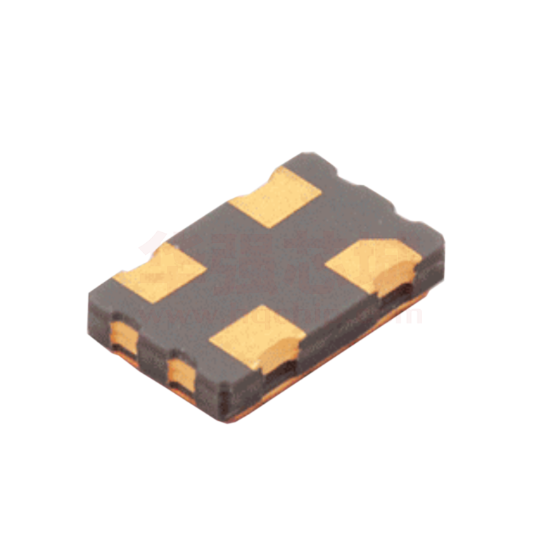

5x7 SMDSMD Crystal 5.0x3.2 OSCILLATOR 深圳市星通时频电子有限公司 SHENZHEN SCTF ELECTRONICS CO.,LTD FEATURE ● ● ● ● ● ● ● ● Tight frequence tolerance. Pin-compatible with standard 5.0×3.2mm packages. Low power standby mode. surface mounting and automatically loaded. Reflow solder is possible. Lower noise and current with reduced power consumption. Built-in C-MOS IC with tri-state function. Pb-free and RoHS/Green compliant. APPLICATIONS ● Ideally suited designed for use in Ethernet, fiber channel,PCs, NB, PCMCIA Cards, Palmtop Computer, Portable Applications. Pb Free ●Electrical Specifications 电气参数 总频差 Frequency Stability ±20ppm to ±50ppm 输入电压 Supply Voltage 5.0V or 3.3V ±10%※(See Notes) 工作温度范围 Operating Temperature Range -20℃ - +70℃ / -40℃ - +85℃ 储存温度范围 Storage Temperature Range -40℃ - +85℃/-55℃ - +125℃ 占空比 Symmetry(Duty Cycle) 40/60 Standard 输出 Output Load 10 TTL or 15pF Hcmos 消耗电流 Current Consumption(15pf only) 1.000Mhz - 35.999Mhz=25mA max (5.0V) 36.000Mhz - 69.999Mhz=60mA max UNIT(单位):mm(毫米) 5±0.1 4 3 1 2 0.75 5.0x3.2mm SMD OSCILLATOR 32.768KHz, 1.000 Mhz to 125.000 MHz 3.2±0.1 Holder Type Frequency Range 1.2MAX 型号 频率范围 0.8 70.000Mhz - 100.000Mhz=80mA max Current Consumption(15pf only) 1.000Mhz - 35.999Mhz=20mA max ( 1.8V 2.5V 2.85V 3.3V) 36.000Mhz - 69.999Mhz=40mA max 2.54 1 2 5 nS max Rise/Fall Time 1.2 1.3 ※Notes:The supply voltage 1.8V,2.5V,2.85V also can be made by customer. 2.3 上升/下降时间 1 70.000Mhz - 125.000Mhz=60mA max 1.2 21 ●Mechanical Dimensions 外型尺寸 4 3 1.8 2.54 suggested solder pad layout ●Test Circuit(测试电路) Frequency Counter +Vs A Oscillator 4 3 +Vs Power Supply 1 V 2 0.1μF Oscilloscope 15pF * PIN FUNCTION 1 Tri-state※(See Notes) 2 Ground 3 Output 4 Vdd ※Notes: Tri-state: PIN 1 connected to Vdd or floating, the product is working properly;connected to GND,stops working. The above specifications are standard for SCTF product If you have special requirement please Contact SCTF sales with your enquiries Tel:0086-0755-86097430,0086-0755-86097250 The above specifications are standard for HLX product Fax:0086-0755-86097259 If you have special requirement please Contact HLX sales with your en E-mail:sales@ sctf-crystal.com http://www.sctf-crystal.com Tel:0086-25-85238320,0086-25-85320830(Direct) Fax:0086-25-85315213,85301856
S5D2.500000A20F30T
物料型号:5.0x3.2mm SMD振荡器
器件简介: - 具有严格的频率容差。 - 引脚兼容标准5.0×3.2mm封装。 - 低功耗待机模式。 - 可进行表面贴装和自动装载。 - 可进行回流焊。 - 降低功耗和噪声。 - 内置具有三态功能的C-MOS IC。 - 无铅且符合RoHS/绿色标准。
引脚分配: - 引脚1:三态(见注释) - 引脚2:地 - 引脚3:输出
参数特性: - 频率范围:32.768KHz至125.000MHz - 频率稳定性:±20ppm至±50ppm - 输入电压:5.0V或3.3V±10%(见注释) - 工作温度范围:-20°C至+70°C或-40°C至+85°C - 储存温度范围:-40°C至+85°C或-55°C至+125°C - 占空比:40/60标准 - 输出负载:10 TTL或15pF HCMOS - 消耗电流:在不同频率和电压下有所不同,最大值从25mA至80mA不等 - 上升/下降时间:最大5ns
功能详解: - 三态功能:引脚1连接到Vdd或悬浮时,产品正常工作;连接到GND时,停止工作。
应用信息: - 适用于以太网、光纤通道、个人电脑、笔记本电脑、PCMCIA卡、掌上电脑、便携式应用等。
封装信息: - 封装类型:5.0x3.2mm SMD
