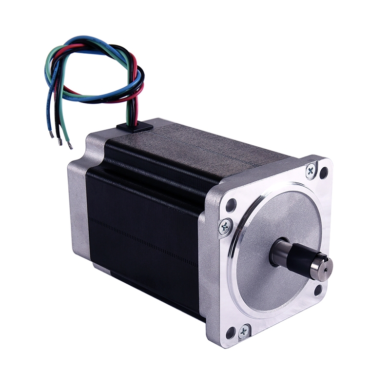

ML34HD2L8500
ML34HD2L8500
    MOONS'(鸣志)
    MOTOR_86X126.5MM
    Stepper Motors 1.8° 34 86.00 x 126.50mm Wire Leads - 4"
ML34HD2L8500 数据手册
