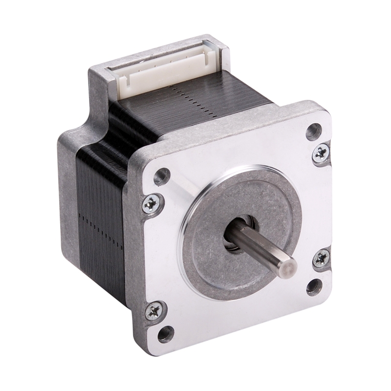

MS24HS3L4420
MS24HS3L4420
    MOONS'(鸣志)
    MOTOR_60X67.5MM
    1.8° Stepper Motors 60.00 x 67.50mm
MS24HS3L4420 数据手册
