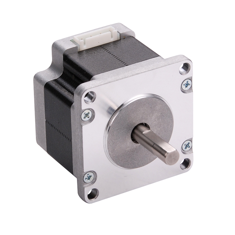

ML24HCAP3220
ML24HCAP3220
    MOONS'(鸣志)
    MOTOR_60X77.5MM
    Stepper Motors 1.2° 60.00 x 77.50mm
ML24HCAP3220 数据手册
