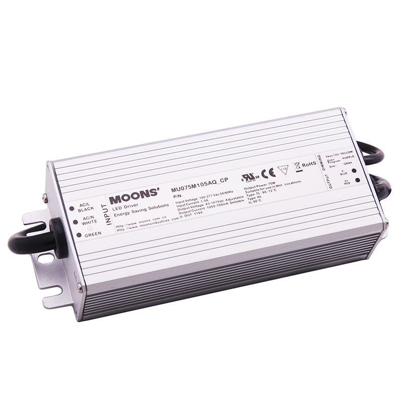

    LED/照明驱动器 90~305V 75W
MU075M210AQ_CP 数据手册
MU075MxxxAQ_CP General-Outdoor ■ Features◆ Input voltage: 90-305Vac ◆Built-in active PFC function 0.98 Typ. ◆ High efficiency: up to 90% Typ. ◆ Built-in Lightning protection ◆ Waterproof (IP67) ◆Constant Current / 0-10V Dimming / Clock Dimming(CLK)/PWM Dimming ◆Protection: OVP, SCP, OTP ◆Full Power at 65%Iomax~100%Iomax (Constant Power) ■ Specification Model (MU075MxxxAQ_CP ) 105 Efficiency(120Vac) Efficiency(220Vac) Voltage Range (Vac) Rated Input Voltage (Vac) Frequency Range (Hz) Power Factor THD AC Current(Typ.) 150 210 300 420 86.0% 86.0% 85.0% 88.0% 88.0% 87.0% 90~305 100-277 47~63 Input 0.98(Typical)at 230Vac; >0.9 with 60%~100% load, at 100~277Vac =50 KHrs lifetime (continous) at Tcase = 75 ℃ Dimension 173x67.5 x 37mm(LxWxH) 0.8kg Weight Note.1: refer to V/I curve Note.2: At Rated Current ,Includes set up tolerance, line regulation and load regulation. 88.0% 90.0% 87.0% 89.0% subject to change without notice Page 1 of 5 SHANGHAI MOONS' AUTOMATION CONTROL CO., LTD. Add: No.168, Mingjia Road, Shanghai 201107, P.R.China Tel: +86 (0)21 52634688 Website: www.moons.com.cn MU075MxxxAQ_CP General-Outdoor Derating Curve THD Curve V/I Curve 0.2 0.18 0.16 0.14 THD 0.12 0.1 176Vac 0.08 220Vac 0.06 277Vac 0.04 0.02 0 0.6 0.7 0.8 0.9 1 Load Efficiency VS. Load Curve 0.92 1 0.99 0.98 0.97 0.96 0.95 0.94 0.93 0.92 0.91 0.9 0.91 0.9 176Vac 220Vac 277Vac Efficiency PF Power Factor VS. Load Curve 0.89 0.88 176Vac 0.87 220Vac 0.86 277Vac 0.85 0.84 0.55 0.6 0.7 0.8 0.9 1 0.6 0.7 Load 0.8 0.9 1 Load Life Time VS. Tcase (Ref.) Page 4 of 7 subject to change without notice SHANGHAI MOONS' AUTOMATION CONTROL CO., LTD. Add: No.168, Mingjia gj Road, Shanghai g 201107, P.R.China Tel: +86 (0)21 52634688 Website: www.moons.com.cn MU075MxxxAQ_CP General-Outdoor ■ Instruction 1.Field Programmable Topology Programmable Diver cable Programmer USB cable The programmable driver can be programmed by using special PC software and the programmer module. 2.Dimming Interface Description Pin description Pin Name Value Description 1 Vaux 12V 10.8V-13.2V Passive dimmers power supply 2 Dim+/Program 0-10V Dimming/Programming input 3 Dim- 0V DC Ground 3.Dimming Software Function Instruction Adjustable Output Current(AOC) ■ Users can set the rated current between 7%*Max Current and 100%*Max Current. Adjustable Startup Time(AST) PWM Input a PWM signal from the 2nd pin(Dim+/Program) of the dimming interface to change the output current.User can set “Positive Logic” or “Negative Logic” of the PWM signal. PWM duty circle: 1%~99%(it has both positive and negative logics ), frequency: 500Hz~5kHz, 3V~10V is high,-0.3V~0.8V is low. Set driver’s “Start Fade up Time”. It means how much time the driver costs to achieve the “Module Current” that the user set. The valid value is 0s, 1s, 2s, 5s, 5s 10s, 10s 20s, 20s 40s. 40s Fade Time(FT) Set driver’s “Fade up Time”. This function is available in the Smart Midnight ClockDIM and Fixed ClockDIM mode; It means how much time the driver costs to achieve another dimming level from previous dimming level. The valid value is 0s, 1s, 2s, 5s, 10s, 20s, 40s. 1-10V Allow users to set the max and min output current and corresponding output voltage to clarify the 1-10V dimming curve. Input a 0~10V signal from 2nd pin of the dimming interface. Default: input ≤1V, output current 10%; input ≥ 8.5V, output current 100%. Page 3 of 5 subject to change without notice SHANGHAI MOONS' AUTOMATION CONTROL CO., LTD. Add: No.168, Mingjia gj Road, Shanghai g 201107, P.R.China Tel: +86 (0)21 52634688 Website: www.moons.com.cn MU075MxxxAQ_CP General-Outdoor ■ Instruction Smart Midnight ClockDIM Fixed ClockDIM Smart Midnight ClockDIM allows dimming to predefined light levels based on the nightly operating time. With flexibility in setting time and light levels, the user can configure the driver for specific locations and application needs. Using Smart Midnight ClockDIM, it is possible to set up to 5 dim levels and time intervals. The driver does not have a real time clock. Instead it runs a virtual clock, determined by the length of nightly operating hours. After 3 ONOFF cycles, the driver will calculate the virtual clock time. A valid ON-time is defined as a period during which the driver operates continuously for ≥4 hours to ≤24 hours. For example, if the requirement in summer is: 23:00-00:00: 75%, 00:00-04:00: 50%, 04:00-05:00: 75% (other time 100% or Off). The driver should be powered on for 7h, so it can calculate the virtual clock time as 22:00. 22:00~23:00: 100%, 22 00 Then we can set the dimming plan: 22 00 23 00 100% 23:00-00:00: 75%, 00:00-04:00: 50%, 04:00-05:00: 75%. From summer to winter, the valid ON-time changes day by day. The driver should be powered on for 17h in winter, and it also can calculate the virtual clock time as 17:00. Then the dimming plan is 17:00~23:00: 100%, 23:00-00:00: 75%, 00:00-04:00: 50%, 04:0005:00: 75%, 05:00~10:00: 100%. From the above, if we set the dimming plan as shown in the picture, after repeating the driver ON-time for 3 consecutive days, the dimming plan takes effect from the 4th day onwards. Each day the driver powered on, it has a different start time according to the virtual clock time. So the driver can satisfy different requirements for different seasons. Constant Light Output(CLO) Allow users to separate 24hrs into 5 sections and corresponding output current. No Dimming The driver will be in constant output mode. Set Module Working hrs(SMW) User can check how much time the driver works through this function. Traditional light sources suffer from depreciation in light output over time. This applies to LED light sources as well. The CLO feature enables LED solutions to deliver constant lumen output through the life of the light engine. Based on the type of LEDs used, heat sinking and driver current, it is possible to estimate the depreciation of light output for specific LEDs and this information can be entered into the driver. The driver counts the number of light source working hours and will increase output current based on this input to enable CLO. When the CLO feature is enabled, the driver nominal output current will be defined by the CLO percentage as shown by the equation below: Driver target nominal output current = CLO percentage * AOC. For example, in the CLO profile shown in Figure, between 52,000-60,000 working hours, the CLO percentage is set at 98%. Assuming the nominal AOC is set to 500mA, the driver output current with CLO enabled will be 0.98 x 500 = 600 mA. The CLO percentage can be set to a value between 85%-100%, in increments of 1%. The LED module working hours can be set at any value between (0-100,000 hours). Page 4 of 5 subject to change without notice SHANGHAI MOONS' AUTOMATION CONTROL CO., LTD. Add: No.168, Mingjia gj Road, Shanghai g 201107, P.R.China Tel: +86 (0)21 52634688 Website: www.moons.com.cn MU075MxxxAQ_CP General-Outdoor ■ Mechanical Specification Dimensions (Unit: mm) RoHS Compliance: Our products comply with the European Directive 2002/95/EC, calling for the elimination of lead and other hazardous substances from electronic products. subject to change without notice Page 5 of 5 SHANGHAI MOONS' AUTOMATION CONTROL CO., LTD. Add: No.168, Mingjia Road, Shanghai 201107, P.R.China Tel: +86 (0)21 52634688 Website: www.moons.com.cn www moons com cn
