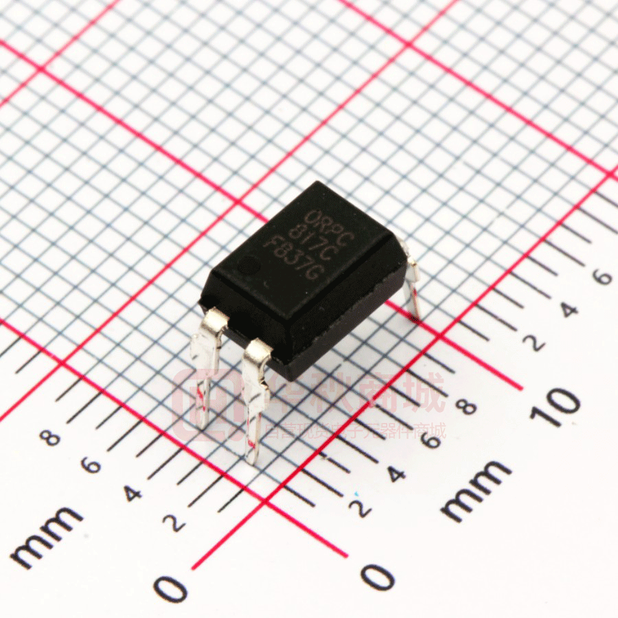

    DIP-4 单向光耦 Viso=5000Vrms VF(typ)=1.2V IF=60mA Vo=80V CTR=200-400%
ORPC-817C 数据手册
产品规格书 Specification Sheet 品 名(P/N): 光电耦合器 Photocoupler 客户名称(Customer): 本厂型号(Mfg P/N): 日 ORPC-817 期(Date): 深圳市奥伦德科技股份有限公司(股票代码:832016) Shenzhen Orient Tech Ltd.Co(Ticker Symbol:832016) Web: www.orient-opto.com 地址:广东深圳龙岗区黄阁路天安数码城 4 栋 3 楼 A 座 518172 Add:Block A 3rd Floor No.4 Building Tian'an Cyber Park Huangge Rd, LongGang Dist, Shenzhen, GD,518172 版本版次:A/3 第 1 页 共 15 页 ● 特点(Features) 1. 电流转换比(CTR: 最小. 50% 工作条件 IF=5mA, VCE=5V) Current conversion ratio (Min 50% Working condition IF=5mA, VCE=5V) 2. 绝缘电压:(VISO=5,000Vrms) Insulation Voltage = 5,000Vrms, 3. 响应时间 (tr: TYP. 4μs;tf: TYP. 5μs)工作条件 VCE=2V, IC=2mA, RL=100 Ω) Response Time (tr: TYP. 4μs;tf: TYP. 5μs)working condition VCE=2V, IC=2mA, RL=100 Ω) 4. UL approved(No.E323844) VDE approved(No.40029733) CQC approved(No.CQC09001029446 CQC13001086898) CE approved(No.AC/0431008) 国网 approved(No.SGCM013420170152 ) ● 说明 (Instructions) 1. ORPC-817 系列光耦合器的组成是:由一个 GaAs 的发射管和一个 NPN 的晶体管组成 ORPC-817 photocoupler consist of one piece of GaAs emitter and one piece of NPN transistor 2. ORPC-817 的引脚中心距是 2.54mm Pin pitch of ORPC-817 is 2.54mm ● 应用范围 (Application Range) 1. 开关电源.Switching power supply 2. 电表.Ammeter 3. 电脑. Computer 4. 器具的应用, 测量机. Instrumental application, measurement machine 5. 贮存器, 复印机, 自动售货机. Imbursement equipments, duplicating machine, automat 6. 家用电器, 如风扇等. Family-use electric equipments, such as fans 7. 信号传输系统. Signal transforming systems ● 最大绝对额定值 (常温=25℃) Max Absolute rated Value (Normal Temperature=25℃) 参数 Parameter 符号 Symbol 额定值 Rated Value 单位 Unit IF 60 mA IFP 1 A VR P 6 70 V mW VCEO 80 顺向电流 Forward Current 顺向电流峰 Peak forward current(1us pulse) 输入 Inout 逆向电压 Reverse Voltage 功消耗率 Consume Power 集极与射极电压 Collector and emitter Voltage 射极与集极电压 输出 Output Emitter and collector Voltage 集极电流 Collector Current 消耗功率 Consume Power 总功率消耗 Total Consume Power *1 绝缘电压 Insulation Voltage 最大绝缘电压(绝缘油中) Max Insulation Voltage VECO 6 IC PC Ptot Viso VIOTM 50 150 200 5,000 10,000 mA mW mW Vrms V 额定脉冲绝缘电压 Rated Impulse Insulation Voltage VIORM 630 V 工作温度 Working Temperature 存贮温度 Deposit Temperature *2 焊锡温度 Soldering Temperature Topr Tstg Tsol -55 to + 110 -55 to + 125 260 ℃ 第 2 页 共 15 页 V *1. 交流测试, 时间 1 分钟,湿度. =40~60% AC Test, 1 minute, humidity = 40~60% 如下是绝缘测试的方法. Insulation test method as below: (1) 将产品的两端短路。 Short circuit both terminals of photocoupler (2) 测试绝缘电压时无电流通过。No Current when testing insulation voltage (3) 测试时加正弦波形电压。Adding sine wave voltage when testing *2. 锡焊时间为 10 秒 soldering time is 10 seconds ● 光电特性(常温=25℃) Opto-electronic Characteristics 符号 Symbol 条件 Condition 顺向电压 Forward Current VF IF=20mA --- 1.2 1.4 V 逆向电流 Reverse Voltage IR VR=4V --- --- 10 μA Ct V=0, f=1KHz --- 30 250 pF ICEO VCE=20V, IF=0mA --- --- 100 nA 80 --- --- V 6 --- --- V 50 --- 600 % 2.5 --- 50 mA --- 0.1 0.2 V --- 1×1012 --- Ω 参数 Parameter 输入 Input 集极电容 Collector capacitance 集极至射极电流 Collector to emitter Current 输出 Output 集极 与射极 衰减电 压 Collector and Emitter attenuation Voltage BVCEO 射极与集极衰减电压 Emitter and Collector attenuation Voltage *1 电流转换比 Current conversion ratio 集极电流 BVECO CTR IC Collector Current 集极 与射极 饱和电 压 Collector and Emitter Saturation Voltage VCE(sat) IC=0.1mA IF=0mA IE=0.1mA IF=0mA IF=5mA VCE=5V IF=20mA IC= 1mA DC500V 最小 中.Mid 最 大 单位 Min ium Max Unit 传输特性 Transforming 绝缘阻抗 Characteristics Insulation Impedance Riso 电容量 capacotance Cf V=0, f=1MHz --- 0.6 1.0 pF fc VCE=5V, IC=2mA --- 80 --- kHz 转换频率 Transforming Frequency 40~60%R.H. RL=100Ω, -3dB 上升时间 Risetime tr VCE=2V, IC=2mA --- 4 18 μs 下降时间 Descend Time tf RL=100Ω --- 3 18 μs  电流转换比 Current Conversion Ratio = IC / IF × 100% 第 3 页 共 15 页 ● 电流转换比的等级分类 Grades of Current conversion ratio 1.ORPC-817 等级标示 Grade Sign 最 小 .Min (% ) 最 大 .Max (% ) 80 130 200 300 50 80 100 600 120 140 180 50 220 260 300 340 380 420 440 460 480 500 520 540 160 260 400 600 80 100 120 1000 140 180 220 100 260 300 340 380 420 440 460 480 500 520 540 560 580 600 ORPC-817A ORPC-817B ORPC-817C ORPC-817D ORPC-817E ORPC-817F ORPC-817G ORPC-817H ORPC-817I ORPC-817J ORPC-817K ORPC-817L ORPC-817M ORPC-817N ORPC-817O ORPC-817P ORPC-817Q ORPC-817R ORPC-817S ORPC-817T ORPC-817U ORPC-817V ORPC-817W ORPC-817X ORPC-817Y ORPC-817Z 560 580 说 明 : 工作条件: IF=5mA, VCE=5V, Ta=25℃. Note: Working condition: IF=5mA, VCE=5V, Ta=25℃. 第 4 页 共 15 页 2.ORPC-817M 等级标示 Grade Sign 最 小 .Min (% ) 最 大 .Max (% ) 80 130 200 300 50 80 100 600 120 140 180 50 220 260 300 340 380 420 440 460 480 500 520 540 160 260 400 600 80 100 120 1000 140 180 220 100 260 300 340 380 420 440 460 480 500 520 540 560 580 600 ORPC-817MA ORPC-817MB ORPC-817MC ORPC-817MD ORPC-817ME ORPC-817MF ORPC-817MG ORPC-817MH ORPC-817MI ORPC-817MJ ORPC-817MK ORPC-817ML ORPC-817MM ORPC-817MN ORPC-817MO ORPC-817MP ORPC-817MQ ORPC-817MR ORPC-817MS ORPC-817MT ORPC-817MU ORPC-817MV ORPC-817MW ORPC-817MX ORPC-817MY ORPC-817MZ 560 580 说 明 : 工作条件: IF=5mA, VCE=5V, Ta=25℃. Note: Working condition: IF=5mA, VCE=5V, Ta=25℃. 第 5 页 共 15 页 3. ORPC-817S 等级标示 Grade Sign 最 小 .Min (% ) 最 大 .Max (% ) 80 130 200 300 300 50 80 100 600 120 140 180 50 220 260 300 340 380 420 440 460 480 500 520 540 160 260 400 600 450 80 100 120 1000 140 180 220 100 260 300 340 380 420 440 460 480 500 520 540 560 580 600 ORPC-817SA ORPC-817SB ORPC-817SC ORPC-817SD ORPC-817SD3 ORPC-817SE ORPC-817SF ORPC-817SG ORPC-817SH ORPC-817SI ORPC-817SJ ORPC-817SK ORPC-817SL ORPC-817SM ORPC-817SN ORPC-817SO ORPC-817SP ORPC-817SQ ORPC-817SR ORPC-817SS ORPC-817ST ORPC-817SU ORPC-817SV ORPC-817SW ORPC-817SX ORPC-817SY ORPC-817SZ 560 580 说 明 : 工作条件: IF=5mA, VCE=5V, Ta=25℃. Note: Working condition: IF=5mA, VCE=5V, Ta=25℃. 第 6 页 共 15 页 ● 命名规则 1、型号代码 Type Code:817 代表产品型号. 2、年代码 year Code: 例如:F7 或C7,其中F表铁支架/C表铜支架,7代表2017年、依此 类推. 3、制造商名称:ORPC 代表制造商 Shenzhen Orient Components Co., Ltd. 4、外形代码 Shape Code:空白--代表外形ORPC-817;M--代表ORPC-817M;S--代表ORPC-817S。 5、等级代码:Rank:有A、B、C、D、......X、Y、Z二十六种形式 6、周代码:Week Code: 01代表第一周、02代表第二周、依此类推 7、Anode: 阳极 第 7 页 共 15 页 ● 外形尺寸 Outer Dimension (单位:mm) 1. ORPC-817 2. ORPC-817M 第 8 页 共 15 页 3. ORPC-817S ● 编带尺寸 (Taping Dimensions) 1.OR-817S-TA 第 9 页 共 15 页 2.OR-817S-TA1 类型 符号 尺寸:毫米(英寸) 带宽 W 16±0.3 (.63) 孔距 P0 4±0.1 (.15) F 7.5±0.1 (.295) P2 2±0.1 (.0079) P1 12±0.1 (.472) 孔距 间隔 封装类型 数量(个) TA/TA1 1000 第 10 页 共 15 页 3.OR-817S-TP ● 焊接温度曲线图 (Temperature Profile Of Soldering) 类型 符号 尺寸:毫米(英寸) 带宽 W 16±0.3 (.63) 孔距 P0 4±0.1 (.15) F 7.5±0.1 (.295) P2 2±0.1 (.0079) P1 8±0.1 (.472) 孔距 间隔 封装类型 数量(个) TP 2000 第 11 页 共 15 页 ● 焊接温度曲线 (Temperature Profile Of Soldering) 1.红外回流焊(jedec-std-020c 兼容)(IR Reflow soldering (JEDEC-STD-020C compliant)) 注意:一次焊接回流建议在温度和时间配置文件如下所示的条件下。不要焊接超过三次。 配置项 条件 预热(Preheat) -最低温度(TSmin ) 150˚C -最高温度(TSmax ) 200˚C -时间(最小到最大(TS) 90±30 sec 焊接区(Soldering zone) -温度(TL) 217˚C -时间(tL) 60 sec 峰值温度(Peak Temperature) 260˚C 爬升率(Ramp-up rate) 3˚C / sec max. 下降率(3˚C / sec max.) 3~6˚C / sec 第 12 页 共 15 页 2.波峰焊接(jedec22a111 兼容)(Wave soldering (JEDEC22A111 compliant) 建议在温度条件下一次性焊接。 温度(Temperature) 260+0/-5˚C 时间(Time) 10 sec 预热温度(Preheat temperature) 5 to 140˚C 预热时间(Preheat time) 30 to 80 sec 3.电烙铁手工焊接(Hand soldering by soldering iron) 允许单铅焊接在每一个过程中,建议一次性焊接。 温度(Temperature) 380+0/-5˚C 时间(Time) 3 sec max 第 13 页 共 15 页 ● 特性曲线 Characteristics Curve 第 14 页 共 15 页 ● 特性曲线 Characteristics Curve OR-FOR-070 第 15 页 共 15 页
