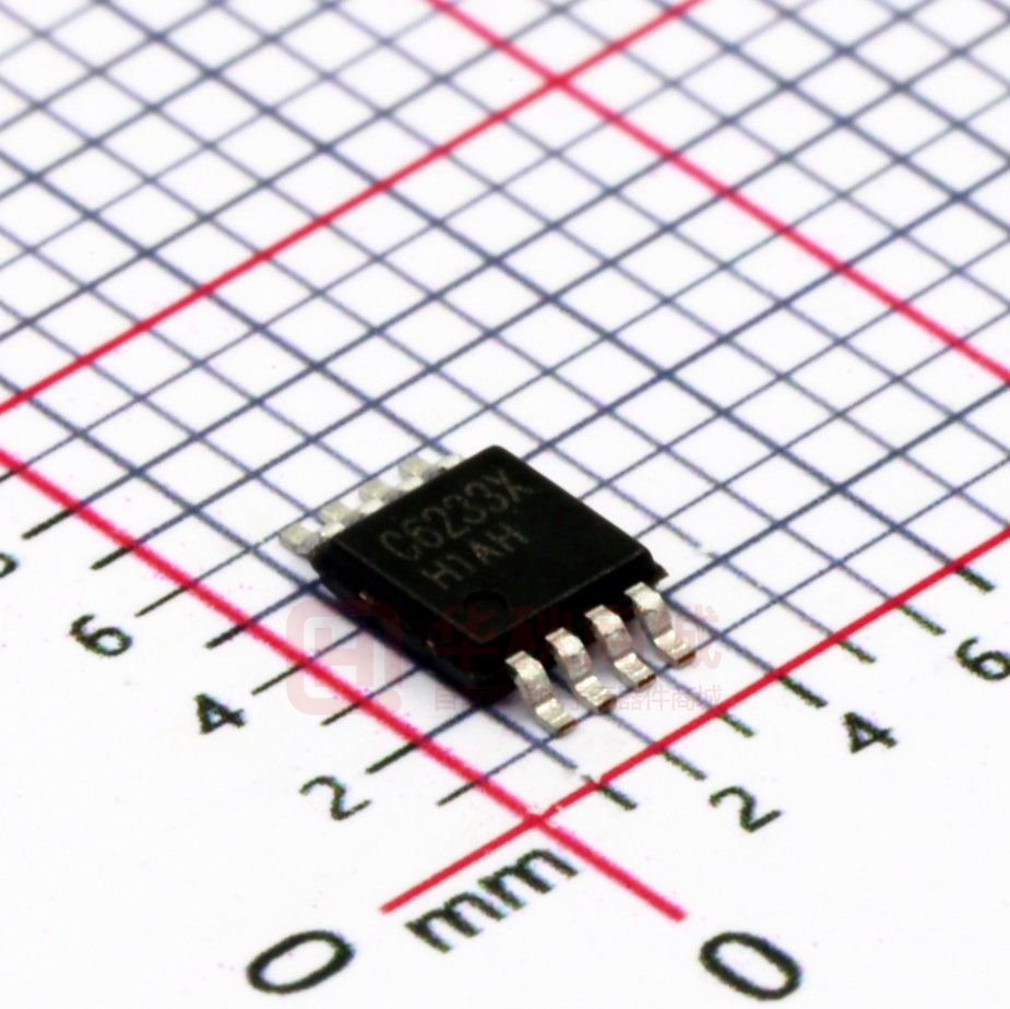

HTC6133,HTC6233 Data Sheet High-Precision, Rail-to-Rail I/O Operational Amplifier General Description The HTC6133(single) and HTC6233(dual) are high-precision, low-quiescent current amplifier which can offer high input impedance and rail-to-rail input and output. The amplifier uses auto-zeroing techniques to provide low offset voltage(2 μV type) and near zero-drift over time and temperature. Either single or dual supplies can be used in the range from 2.3V to 5.5V (±1.15V to ±2.75V) The HTC6133 is available in SC70-5,SOT23-5, MSOP-8 and SOP-8.The HTC6233 is available in MSOP-8 and SOP-8. All versions ae specified for operation from -40 ℃ to +125 ℃. Features  Low Offset Voltage:2 μV(Type)  Zero-Drift:0.03 μV/℃  Low Noise:48 nV/ 𝐻𝐻𝐻𝐻  0.1-Hz to 10-Hz Noise:0.8 μVpp  Excellent DC Precision:  Open-Loop Gain: 135dB  PSRR: 110dB  CMRR: 110dB  Gain Bandwidth: 0.4 MHz  Quiescent Current: 20 μA(Type)  Supply Range: ±1.15V to ±2.75V  Rail-to-Rail Input and Output Application         Bridge Amplifier Strain Gauges Transducer Applications Temperature Measurement Electronic Scales Medical Instrumentation Resistance Temperature Detectors Handheld Test Equipment Pin Configurations HTC6133 HTC6133 SC70-5/SOT23-5 OUT 1 ﹣VS 2 ﹢IN 3 5 4 1 HTC6233 MSOP-8/SO-8 ﹢VS ﹣IN HUATECH SEMICONDUCTOR MSOP-8/SO-8 NC 1 8 NC OUT A 1 ﹣IN 2 7 ﹢VS ﹣IN A 2 ﹢IN 3 6 OUT ﹢IN A 3 ﹣VS 4 5 NC ﹣VS 4 A B 8 ﹢VS 7 OUT B 6 ﹣IN B 5 ﹢IN B CAUTION: These devices are sensitive to electrostatic discharge; follow proper IC Handling Procedures. Huatech (and design) is a registered trademark of Huatech Semiconductor Inc. Copyright Huatech Semiconductor Inc. All Rights Reserved. All other trademarks mentioned are the property of their respective owners. FN1618-19.1.C HTC6133,HTC6233 Data Sheet High-Precision, Rail-to-Rail I/O Operational Amplifier Pin Description Symbol Description –IN Inverting Input of the Amplifier. The Voltage can go from (VS-) to (VS+). +IN Non-Inverting Input of Amplifier. This pin has the same voltage range as –IN. +VS Positive Power Supply. The Voltage is from 2.3V to 5.5V(±1.15V to ±2.75V). –VS Negative Power Supply. It is normally tied to ground. OUT Amplifier Output. N/C No Connection. Ordering Information Type Number Package Name Package Quantity Marking Code HTC6133XC5/R6 SC70-5 Tape and Reel,3000 C13XX HTC6133XT5/R6 SOT23-5 Tape and Reel,3000 C13XX HTC6133XS8/R8 SOP-8 Tape and Reel,4000 C6133X HTC6133XV8/R6 MSOP-8 Tape and Reel,3000 C6133X HTC6233XS8/R8 SOP-8 Tape and Reel,4000 C6233X HTC6233XV8/R6 MSOP-8 Tape and Reel,3000 C6233X Recommended Operating Conditions  Operating voltage range: 2.1V to 5.5V(±1.05V to ±2.75V)  Specified temperature range: -40℃ to 125℃ 2 HUATECH SEMICONDUCTOR CAUTION: These devices are sensitive to electrostatic discharge; follow proper IC Handling Procedures. Huatech (and design) is a registered trademark of Huatech Semiconductor Inc. Copyright Huatech Semiconductor Inc. All Rights Reserved. All other trademarks mentioned are the property of their respective owners. FN1618-19.1.C HTC6133,HTC6233 Data Sheet High-Precision, Rail-to-Rail I/O, 45-V Operational Amplifier Absolute Maximum Ratings Attention: Stresses beyond those listed under Absolute Maximum Ratings may cause permanent damage to the device. Exposure to absolute-maximum-rated conditions for extended periods may affect device reliability. Parameter Symbol Absolute Maximum Rating Supply Voltage Input terminal Temperature Electrostatic Discharge Voltage Unit ±3,+6(Single) V Voltage VS--0.5 to VS++0.5 V Differential Voltage ±5 V Operating(2),TA -55 to 150 ℃ Storage , Tstg -65 to 150 ℃ Junction , TJ 150 ℃ HBM 8 kV (1) Stresses beyond those listed under Absolute Maximum Ratings may cause permanent damage to the device. These are stress ratings only, which do not imply functional operation of the device at these or any other conditions beyond those indicated under Recommended Operating Conditions. Exposure to absolute-maximum-rated conditions for extended periods may affect device reliability. (2) Provided device does not exceed maximum junction temperature (TJ) at any time. 3 HUATECH SEMICONDUCTOR CAUTION: These devices are sensitive to electrostatic discharge; follow proper IC Handling Procedures. Huatech (and design) is a registered trademark of Huatech Semiconductor Inc. Copyright Huatech Semiconductor Inc. All Rights Reserved. All other trademarks mentioned are the property of their respective owners. FN1618-19.1.C HTC6133,HTC6233 Data Sheet High-Precision, Rail-to-Rail I/O Operational Amplifier Electrical Characteristics VS=+5V,TA=25℃,VCM=VS/2,VO=VS/2,RL=10kΩ connected to VS/2,unless otherwise noted. Symbol Parameter Conditions Min. Typ. Max. Unit 15 μV INPUT CHARACTERISTICS VOS Input offset Voltage VOS TC Offset voltage drift TA=-40℃ to﹢125℃ 0.03 μV/℃ IB Input bias current VCM=VS/2 ±100 pA IOS Input offset current ±100 pA VCM Common-mode Voltage range CMRR AVOL 2 TA=-40℃ to﹢125℃ VS- Common-mode rejection ratio VS-
