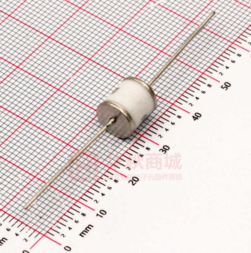

2R-8*8 SERIES Gas Discharge Tube (GDT) Data Sheet Features ■ Provide ultra-fast response to surge voltage from slow-rising surge of 100V/s to rapid-rising surge of 1KV/μs. ■ Stable breakdown voltage. ■ High insulation resistance. ■ Low capacitance (≤1.5pF) ■ High holdover voltage ■ Large absorbing transient current capability. ■ Micro-Gap Design ■ Size: 8.0mm*8.0mm ■ Storage and operating temperature: -40℃ ~ +85℃ ■ Meets MSL level 1, per J-STD-020 ■ Safety certification: UL: E327997 Applications ■ ■ ■ ■ Repeaters, Modems. Telephone Interface, Line cards. Data communication equipment. Line test equipment Part Number Code 2 8 R H: 2.5KA K: 3KA L: 5KA 2R: 2 Electrodes L: Lead M: SMD No suffix: Bulk TR: Tape & Reel packing 8: 8.0mm×8.0mm Marking Revision:08-Oct-15 www.brightking.com 2R-8*8 SERIES Dimensions L Type Dimension (mm) Symbol Spec. Tolerance D 8.0 +0.3, -0.5 T 8.0 +0.6, -0.1 0.8 ±0.1 1.0 ±0.1 L 30.0 Max. D 8.0 +0.3, -0.5 T 8.0 +0.6, -0.1 B 1.1 ±0.4 d M Type Electrical Characteristics DC Spark-over Part Voltage Maximum Nominal Impulse Impulse Spark-over Discharge Voltage Current Number 8/20μs 100V/s 1000V/μs (V) (V) (KA) 10times Alternating Discharge Current Impulse Life Minimum Insulation Resistance Maximum Capacitance Device Marking 10/1000μs Test 100A Voltage (A) (times) DC(V) 50Hz,1sec (GΩ) 1MHz Code (pF) 2RH1400L-8 2RH1400M-8 1400±20% 2200 2.5 2.5 100 500 1.0 1.5 2RH1400-8 2RH1600L-8 2RH1600M-8 1600±20% 2400 2.5 2.5 100 500 1.0 1.5 2RH1600-8 2RH2000L-8 2RH2000M-8 2000±20% 2800 2.5 2.5 100 500 1.0 1.5 2RH2000-8 2RH2500L-8 2RH2500M-8 2500±20% 3600 2.5 2.5 100 500 1.0 1.5 2RH2500-8 2RH2700L-8 2RH2700M-8 2700±20% 3800 2.5 2.5 300* 1000 1.0 1.5 2RH2700-8 2RH3000L-8 2RH3000M-8 3000±20% 4200 2.5 2.5 100 1000 1.0 1.5 2RH3000-8 2RH3500L-8 2RH3500M-8 3500±20% 5000 2.5 2.5 100 1000 1.0 1.5 2RH3500-8 2RK2700L-8 2RK2700M-8 2700±20% 3800 3.0 3.0 300* 1000 1.0 1.5 2RK2700-8 2RK3000L-8 2RK3000M-8 3000±20% 4200 3.0 3.0 300* 1000 1.0 1.5 2RK3000-8 2RK3500L-8 2RK3500M-8 3500±20% 5000 3.0 3.0 100 1000 1.0 1.5 2RK3500-8 2RK4000L-8 2RK4000M-8 4000±20% 5500 3.0 3.0 100 1000 1.0 1.5 2RK4000-8 2RK5000L-8 2RK5000M-8 5000±20% 6400 3.0 3.0 100 1000 1.0 1.5 2RK5000-8 2RK6000L-8 2RK6000M-8 6000±20% 7800 3.0 3.0 100 1000 1.0 1.5 2RK6000-8 * Measured with an 8/20μs waveform, 100A Revision:08-Oct-15 www.brightking.com 2R-8*8 SERIES Electrical Characteristics DC Spark-over Part Voltage Maximum Nominal Impulse Impulse Spark-over Discharge Voltage Current Number 8/20μs 100V/s 1000V/μs (V) (V) (KA) 10times Alternating Discharge Current Impulse Life Minimum Insulation Resistance Maximum Capacitance Device Marking 10/1000μs Test 100A Voltage (A) (times) DC(V) 50Hz,1sec 1MHz (GΩ) Code (pF) 2RL1000L-8 2RL1000M-8 1000±20% 1400 5.0 5.0 100 500 1.0 1.5 2RL1000-8 2RL1400L-8 2RL1400M-8 1400±20% 2200 5.0 5.0 100 500 1.0 1.5 2RL1400-8 2RL1600L-8 2RL1600M-8 1600±20% 2400 5.0 5.0 100 500 1.0 1.5 2RL1600-8 2RL2000L-8 2RL2000M-8 2000±20% 2800 5.0 5.0 100 500 1.0 1.5 2RL2000-8 2RL2500L-8 2RL2500M-8 2500±20% 3600 5.0 5.0 100 1000 1.0 1.5 2RL2500-8 Notes: The surface for 2RXXXXXM-8 series products is default for nickel plating, please change to use tin plating if used on PCB boards while soldering, and adding the code “Sn” as suffix of the part number to distinguish. Electrical Ratings Items DC Spark-over Voltage Maximum Impulse Spark-over Voltage Test Condition/Description Requirement The voltage is measured with voltage ramp dv/dt=100V/s. The maximum impulse spark-over voltage is measured with voltage ramp dv/dt=1000V/μs. Maximum 8/20μs surge current that can be applied between two electrodes, 5 positive and 5 negative surges, with 3 minutes interval time, without causing the DC spark-over voltage to change more than 25% from its initial value. Impulse Discharge Current Alternating Discharge Current Insulation Resistance Capacitance Revision:08-Oct-15 To meet the specified value Rated RMS value of AC current at 50Hz, 1 sec. for 10 times with interval time 3 min. DC spark-over voltage shall not change more than ±25% from its initial value. IR>108 ohms (-20%, +30% for 70~90V). The resistance of gas tube shall be measured between two electrodes. The capacitance of gas tube shall be measured between two electrodes. Test frequency: 1MHz www.brightking.com 2R-8*8 SERIES Recommended Soldering Conditions Wave Soldering Item Conditions Peak Temperature 265℃ Dipping Time 10 seconds Soldering 1 time Reflow Soldering Profile Feature Average ramp-up rate (TL to TP) Preheat -Temperature Min (TS min) -Temperature Max (TS max) -Time (min to max) (ts) TS max to TL -Ramp-up Rate Time maintained above: -Temperature (TL) -Time (tL) Peak Temperature (TP) Time within 5℃ of actual Peak Temperature (tP) Ramp-down Rate Time 25℃ to Peak Temperature Revision:08-Oct-15 Pb-Free Assembly 3℃/second max. 150℃ 200℃ 60-180 seconds 3℃/second max. 217℃ 60-150 seconds 260℃ 20-40 seconds 6℃/second max. 8 minutes max. www.brightking.com 2R-8*8 SERIES Packaging Axial Packing (Bulk) Skin packing Symbol Dimension (mm) Tolerance A 264.0 ±1.0 B 145.0 ±1.0 H 6.5 ±0.5 B Spec. A H Quantity: 100pcs Inner box B0 H0 A0 A0 270.0 ±2.0 B0 150.0 ±1.0 H0 50.0 ±1.0 Quantity: 500pcs Axial Packing (Tape & Reel) Tape Dimension (mm) Symbol Spec. Tolerance P 10.0 ±0.1 W 65.0 ±0.1 E 6.0 ±0.1 F 26.5 ±0.1 d 0.8/1.0 ±0.05 A1 330.0 ±1.0 B1 70.0 ±1.0 C1 82.0 ±1.0 D 25.0 ±0.2 t 2.0 ±0.2 P E F W d Reel B1 D A1 C1 t Revision:08-Oct-15 Quantity: 500pcs www.brightking.com 2R-8*8 SERIES Packaging SMD Packing (Tape & Reel) Tape Symbol P2 D0 t0 B0 W F E P0 P1 Dimension (mm) Spec. Tolerance W 16.00 ±0.20 P0 4.00 ±0.10 P1 12.00 ±0.20 P2 4.00 ±0.10 D0 1.45 ±0.1 E 1.75 ±0.10 F 7.50 ±0.10 A0 8.80 ±0.10 K0 8.30 ±0.10 B0 8.30 ±0.10 t0 0.50 ±0.10 D 330.00 ±1.00 d 13.00 ±0.50 L 20.00 ±0.50 t 2.00 ±0.20 K0 A0 Reel Quantity: 500pcs Revision:08-Oct-15 www.brightking.com
