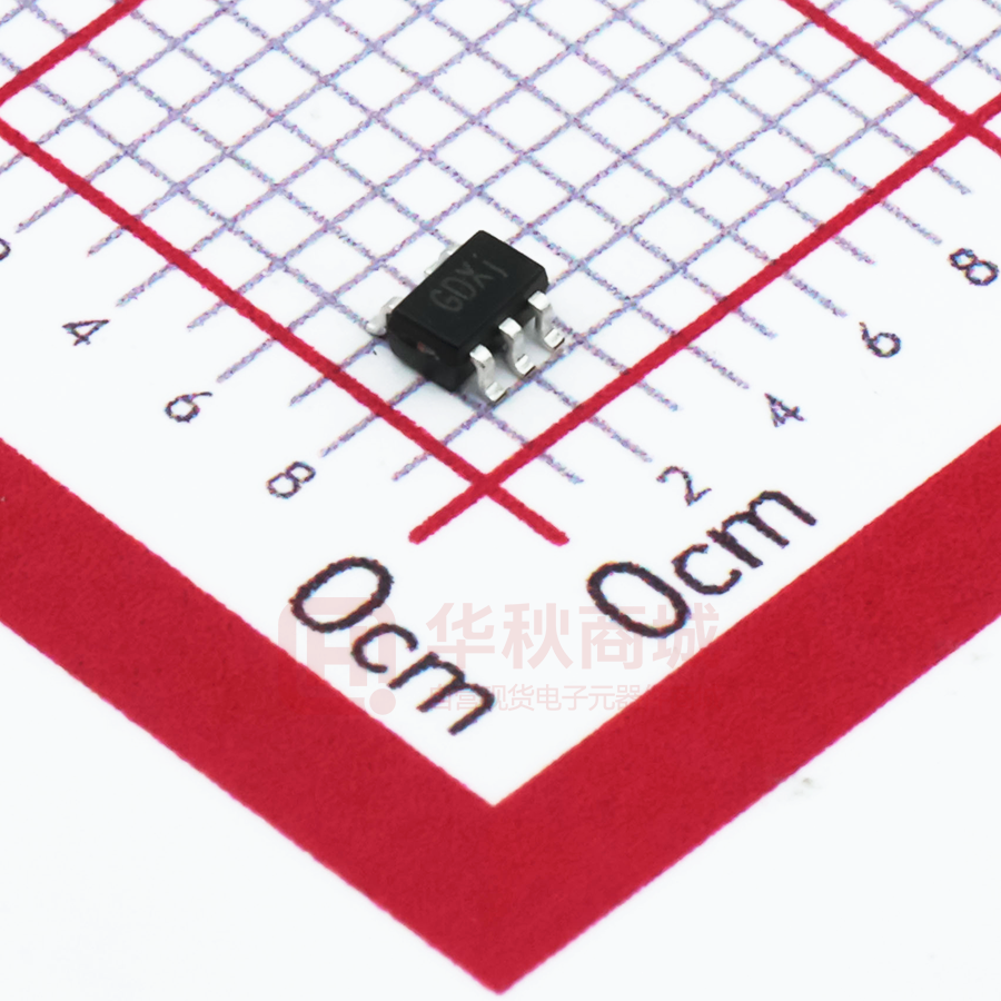

    输出类型:固定 输出极性:正 最大输入电压:6V 输出电压:3.3V 输出电压精度:±1%
ME6211C33R5G 数据手册
ME6211 High Speed LDO Regulators, High PSRR, Low noise, ME6211 Series General Description Features The ME6211 series are highly accurate, low  noise, CMOS LDO Voltage Regulators. Offering low output noise, high ripple rejection ratio, low dropout and very fast turn-on times, the ME6211 series is ideal for today’s cutting edge mobile phone. Internally the ME6211 includes a reference voltage source, error amplifiers, driver transistors, current limiters and phase compensators. The ME6211’s (VIN=4.3V,VOUT=3.3V)  Dropout Voltage: 100mV@ IOUT =100mA  Operating Voltage Range: 1.2V~6.0V  Highly Accuracy: ±1%  Low Power Consumption: 30uA(TYP.)  Standby Current: 0.1uA(TPY.)  High Ripple Rejection: 70dB@1KHz current limiters' foldback circuit also operates as a short protect for the output current limiter and. the output pin. The ME6211 series is also fully Maximum Output Current: 500mA (ME6211C33)  Low output noise: 50uVrms  Line Regulation: 0.05%(TYP.) compatible with low ESR ceramic capacitors, reducing cost and improving output stability. This high level of output stability is maintained even during frequent load fluctuations, due to the excellent transient response performance and high PSRR achieved across a broad range of frequencies.The CE function allows the output of regulator to be turned off, resulting in greatly reduced power consumption. Typical Application  Mobile phones  Cordless phones, radio communication equipment  Portable games  Cameras, Video cameras  Reference voltage sources  Battery powered equipment Package ● 3-pin SOT89-3,SOT23-3 ● 4-pin SOT343R,FBP1*1-4L ● 5-pin SOT23-5,SOT353 ● 6-pin DFN2*2-6L V20 www.microne.com.cn Page 1 of 23 ME6211 Typical Application Circuit Fig1. ME6211A series Fig2. ME6211C series Fig3. ME6211H series V20 www.microne.com.cn Page 2 of 23 ME6211 Selection Guide product series product function Output voltage Package Enable the internal connection of high 1.2V SOT89-3 ME6211C33M5G-N Enable can be set 3.3V SOT23-5 ME6211C33R4G-N Enable can be set 3.3V SOT343R ME6211C33U4AG-N Enable can be set 3.3V FBP1*1-4L (0.37) ME6211C25N6AG-N Enable can be set 2.5V DFN2*2-6L(0.75) ME6211H15M5G-N Enable connected to a low 1.5V SOT23-5 ME6211A12PG-N NOTE: At present ,there are twelve kinds of voltage value: 1.0、1.2V、1.5V、1.8V、2.1V、2.5V、2.7V、2.8V、2.9V、3.0V、3.3V、5.0V。 If you need other voltage and package, please contact our sales staff。 V20 www.microne.com.cn Page 3 of 23 ME6211 Pin Configuration Pin Assignment ME6211AXXG Pin Number M3 P P1 SOT23-3 SOT89-3 SOT89-3 1 1 2 3 Pin Name Functions 2 VSS Ground 3 1 VOUT Output 2 3 VIN Power Input The difference of printing on the chip between P and P1 is : P: ME6211AXXG-DS Pin Number , P1: Pin Name Functions 1 VIN Power Input 2 VOUT Output 3 VSS Ground SOT23-3 ME6211CXXG/ ME6211HXXG Pin Number Pin Name Functions 4 VIN Power Input 2 2 VSS Ground 1 1 3 CE ON / OFF Control 4 5,6 - - NC No Connect 5 4 3 1 VOUT Output SOT343R SOT23-5/SOT353 DFN2*2-6L 1 3 4 2 2 3 V20 FBP1*1-4L www.microne.com.cn Page 4 of 23 ME6211 Block Diagram Absolute Maximum Ratings Parameter Symbol Ratings Units Input Voltage VIN 6.5 V Output Current IOUT 600 mA Output Voltage VOUT Vss-0.3~VIN +0.3 V CE Pin Voltage VCE Vss-0.3~VIN +0.3 V Power Dissipation SOT23-3 300 SOT353 250 DFN2*2-6L SOT89 PD 300 mW 500 SOT343R 250 FBP1*1-4L 250 Operating Temperature Range TOPR -40~+150 ℃ Storage Temperature Range TSTG -40~+150 ℃ V20 www.microne.com.cn Page 5 of 23 ME6211 Electrical Characteristics ME6211C10 (VIN= VOUT+1V,VCE = VIN,CIN=CL=1uF,Ta=25OC ,unless otherwise noted) Parameter Symbol Conditions Min. Typ. Max. Units Output Voltage VOUT(E) (Note 2) IOUT=30mA, VIN= VOUT+1V X 0.99 VOUT (T) (Note 1) X 1.01 V Maximum Output Current IOUTMAX VIN= VOUT+1V 300 mA Load Regulation ∆VOUT VIN= VOUT+1V , 1mA≤IOUT≤100mA 5 mV Dropout Voltage (Note 1) VDIF1 IOUT =100mA 400 mV VDIF2 IOUT =200mA 650 mV Supply Current ISS VIN= VOUT+1V 30 60 μA Stand-by Current ICEL VCE=0V 0.1 1.0 μA ∆VOUT ∆VIN • VOUT IOUT =30mA VOUT+1V ≤VIN≤6.5V 0.035 CE “High” Voltage VCEH Start up CE “Low” Voltage VCEL Shut down EN IOUT =40mA,300Hz~50kHz 50 IOUT=10mA, 1kHZ 70 IOUT=100mA, 10kHZ 62 Line Regulation Output noise Ripple Rejection Rate VIN = [VOUT +1]V +1Vp-pAC PSRR %/V 1.0 V 0.5 V uVrms dB ME6211C12 (VIN= VOUT+1V,VCE = VIN,CIN=CL=1uF,Ta=25OC ,unless otherwise noted) Parameter Symbol Conditions Min. Typ. Max. Units Output Voltage VOUT(E) (Note 2) IOUT=30mA, VIN= VOUT+1V X 0.99 VOUT (T) (Note 1) X 1.01 V Maximum Output Current IOUTMAX VIN= VOUT+1V 300 mA Load Regulation ∆VOUT VIN= VOUT+1V , 1mA≤IOUT≤100mA 8 mV Dropout Voltage (Note 1) VDIF1 IOUT =100mA 280 mV VDIF2 IOUT =200mA 500 mV Supply Current ISS VIN= VOUT+1V 30 60 μA Stand-by Current ICEL VCE=0V 0.1 1.0 μA ∆VOUT ∆VIN • VOUT IOUT =30mA VOUT+1V ≤VIN≤6.5V 0.03 CE “High” Voltage VCEH Start up CE “Low” Voltage VCEL Shut down EN IOUT =40mA,300Hz~50kHz 50 IOUT=10mA, 1kHZ 70 IOUT=100mA, 10kHZ 62 Line Regulation Output noise Ripple Rejection Rate V20 PSRR VIN = [VOUT +1]V +1Vp-pAC www.microne.com.cn %/V 1.0 V 0.5 V uVrms dB Page 6 of 23 ME6211 ME6211C18 (VIN= VOUT+1V,VCE = VIN,CIN=CL=1uF,Ta=25OC, unless otherwise noted) Parameter Symbol Conditions Min. Typ. Max. Units Output Voltage VOUT(E) (Note 2) IOUT=30mA, VIN= VOUT+1V X 0.99 VOUT (T) (Note 1) X 1.01 V Maximum Output Current IOUTMAX VIN= VOUT+1V 300 mA Load Regulation ∆VOUT VIN= VOUT+1V , 1mA≤IOUT≤100mA 9 mV Dropout Voltage (Note 1) VDIF1 IOUT =100mA 200 mV VDIF2 IOUT =200mA 400 mV Supply Current ISS VIN= VOUT+1V 30 60 μA Stand-by Current ICEL VCE=0V 0.1 1.0 μA ∆VOUT ∆VIN • VOUT IOUT =30mA VOUT+1V ≤VIN≤6.5V 0.05 CE “High” Voltage VCEH Start up CE “Low” Voltage VCEL Shut down EN IOUT =40mA,300Hz~50kHz 50 IOUT=10mA, 1kHZ 70 IOUT=100mA, 10kHZ 62 Line Regulation Output noise Ripple Rejection Rate VIN = [VOUT +1]V+1Vp-pAC PSRR %/V 1.0 V 0.5 V uVrms dB ME6211C25 (VIN= VOUT+1V,VCE = VIN,CIN=CL=1uF,Ta=25OC, unless otherwise noted) Parameter Symbol Conditions Min. Typ. Max. Units Output Voltage VOUT(E) (Note 2) IOUT=30mA, VIN= VOUT+1V X 0.99 VOUT (T) (Note 1) X 1.01 V Maximum Output Current IOUTMAX VIN= VOUT+1V 400 mA Load Regulation ∆VOUT VIN= VOUT+1V , 1mA≤IOUT≤100mA 9 mV Dropout Voltage (Note 1) VDIF1 IOUT =100mA 110 mV VDIF2 IOUT =200mA 220 mV Supply Current ISS VIN= VOUT+1V 30 60 μA Stand-by Current ICEL VCE=0V 0.1 1.0 μA Line Regulation ∆VOUT ∆VIN • VOUT IOUT =30mA VOUT+1V ≤VIN≤6.5V 0.04 CE“High”Voltage VCEH Start up CE “Low” Voltage VCEL Shut down EN IOUT =40mA,300Hz~50kHz Output noise Ripple Rejection Rate Short-circuit Current V20 PSRR ISHORT VIN=[VOUT+1]V +1Vp-pAC www.microne.com.cn 1.0 V 0.5 50 IOUT=10mA, 1kHZ 70 IOUT=100mA, 10kHZ 62 IOUT=200mA, 10kHZ 62 VIN= VOUT+1V, VCE=VIN, VOUT =0V %/V 60 Page 7 of 23 V uVrms dB mA ME6211 ME6211C28 (VIN= VOUT+1V,VCE = VIN,CIN=CL=1uF,Ta=25OC, unless otherwise noted) Parameter Symbol Conditions Min. Typ. Max. Units Output Voltage VOUT(E) (Note 2) IOUT=30mA, VIN= VOUT+1V X 0.99 VOUT (T) (Note 1) X 1.01 V Maximum Output Current IOUTMAX VIN= VOUT+1V 450 mA Load Regulation ∆VOUT VIN= VOUT+1V , 1mA≤IOUT≤100mA 7 mV Dropout Voltage (Note 1) VDIF1 IOUT =100mA 110 mV VDIF2 IOUT =200mA 220 mV Supply Current ISS VIN= VOUT+1V 30 60 μA Stand-by Current ICEL VCE=0V 0.1 1.0 μA Line Regulation ∆VOUT ∆VIN • VOUT IOUT =30mA VOUT+1V ≤VIN≤6.5V 0.04 CE“High”Voltage VCEH Start up CE “Low” Voltage VCEL Shut down EN IOUT =40mA,300Hz~50kHz Output noise Ripple Rejection Rate Short-circuit Current VIN=[VOUT+1]V +1Vp-pAC PSRR 1.0 V 0.5 50 IOUT=10mA, 1kHZ 70 IOUT=100mA, 10kHZ 62 IOUT=200mA, 10kHZ 62 VIN= VOUT+1V, VCE=VIN, VOUT =0V ISHORT %/V V uVrms dB 65 mA ME6211C30 (VIN= VOUT+1V,VCE = VIN,CIN=CL=1uF,Ta=25OC, unless otherwise noted) Parameter Symbol Conditions Min. Typ. Max. Units Output Voltage VOUT(E) (Note 2) IOUT=30mA, VIN= VOUT+1V X 0.99 VOUT (T) (Note 1) X 1.01 V Maximum Output Current IOUTMAX VIN= VOUT+1V 500 mA Load Regulation ∆VOUT VIN= VOUT+1V , 1mA≤IOUT≤100mA 8 mV Dropout Voltage (Note 1) VDIF1 IOUT =100mA 100 mV VDIF2 IOUT =200mA 210 mV Supply Current ISS VIN= VOUT+1V 30 60 μA Stand-by Current ICEL VCE=0V 0.1 1.0 μA ∆VOUT ∆VIN • VOUT IOUT =30mA VOUT+1V ≤VIN≤6.5V 0.05 CE “High” Voltage VCEH Start up CE “Low” Voltage VCEL Shut down EN IOUT =40mA,300Hz~50kHz Line Regulation Output noise Ripple Rejection Rate V20 PSRR VIN = [VOUT +1]V +1Vp-pAC www.microne.com.cn %/V 1.0 V 0.5 50 IOUT=10mA, 1kHZ 70 IOUT=100mA, 62 V uVrms dB Page 8 of 23 ME6211 10kHZ Short-circuit Current ISHORT IOUT=200mA, 10kHZ 62 VIN= VOUT+1V, VCE=VIN, VOUT =0V 65 mA ME6211C33 (VIN= VOUT+1V,VCE = VIN,CIN=CL=1uF,Ta=25OC, unless otherwise noted) Parameter Symbol Conditions Min. Typ. Max. Units Output Voltage VOUT(E) (Note 2) IOUT=30mA, VIN= VOUT+1V X 0.99 VOUT (T) (Note 1) X 1.01 V Maximum Output Current IOUTMAX VIN= VOUT+1V 500 mA Load Regulation ∆VOUT VIN= VOUT+1V , 1mA≤IOUT≤100mA 9 mV Dropout Voltage (Note 1) VDIF1 IOUT =100mA 120 mV VDIF2 IOUT =200mA 260 mV Supply Current ISS VIN= VOUT+1V 30 60 μA Stand-byCurrent ICEL VCE=0V 0.1 1.0 μA Line Regulation ∆VOUT ∆VIN • VOUT IOUT =30mA VOUT+1V ≤VIN≤6.5V 0.05 CE “High” Voltage VCEH Start up CE “Low” Voltage VCEL Shut down EN IOUT =40mA,300Hz~50kHz Output noise Ripple Rejection Rate Short-circuit Current ISHORT 1.0 V 0.5 50 IOUT=10mA ,1kHZ 70 IOUT=100m A,10kHZ 62 IOUT=200m A,10kHZ 62 VIN= VOUT+1V, VCE=VIN, VOUT =0V 70 VIN = [VOUT +1]V +1Vp-pAC PSRR %/V V uVrms dB mA ME6211C33 (SOT343R,FBP1*1-4L,SOT353) (VIN= VOUT+1V,VCE = VIN,CIN=CL=1uF,Ta=25OC, unless otherwise noted) Parameter Symbol Conditions Min. Typ. Max. Units Output Voltage VOUT(E) (Note 2) IOUT=30mA, VIN= VOUT+1V X 0.99 VOUT (T) (Note 1) X 1.01 V Maximum Output Current IOUTMAX VIN= VOUT+1V 400 mA Load Regulation ∆VOUT VIN= VOUT+1V , 1mA≤IOUT≤100mA 9 mV Dropout Voltage (Note 1) VDIF1 IOUT =100mA 120 mV VDIF2 IOUT =200mA 260 mV Supply Current ISS VIN= VOUT+1V 30 60 μA Stand-byCurrent ICEL VCE=0V 0.1 1.0 μA Line Regulation ∆VOUT ∆VIN • VOUT IOUT =30mA VOUT+1V ≤VIN≤6.5V 0.05 VCEH Start up CE “High” Voltage V20 www.microne.com.cn 1.0 %/V V Page 9 of 23 ME6211 CE “Low” Voltage Output noise Ripple Rejection Rate Short-circuit Current VCEL Shut down EN IOUT =40mA,300Hz~50kHz ISHORT 50 IOUT=10mA ,1kHZ 70 IOUT=100m A,10kHZ 62 IOUT=200m A,10kHZ 62 VIN= VOUT+1V, VCE=VIN, VOUT =0V 70 VIN = [VOUT +1]V +1Vp-pAC PSRR 0.5 V uVrms dB mA ME6211C50 (VIN= VOUT+1V,VCE = VIN,CIN=CL=1uF,Ta=25OC, unless otherwise noted) Parameter Symbol Conditions Min. Typ. Max. Units Output Voltage VOUT(E) (Note 2) IOUT=30mA, VIN= VOUT+1V X 0.99 VOUT (T) (Note 1) X 1.01 V Maximum Output Current IOUTMAX VIN= VOUT+1V 500 mA Load Regulation ∆VOUT VIN= VOUT+1V , 1mA≤IOUT≤100mA 8 mV Dropout Voltage (Note 1) VDIF1 IOUT =100mA 100 mV VDIF2 IOUT =200mA 200 mV Supply Current ISS VIN= VOUT+1V 40 60 μA Stand-by Current ICEL VCE=0V 0.1 1.0 μA ∆VOUT ∆VIN • VOUT IOUT =30mA VOUT+1V ≤VIN≤6.5V 0.05 CE “High” Voltage VCEH Start up CE “Low” Voltage VCEL Shut down EN IOUT =40mA,300Hz~50kHz 50 IOUT=10mA, 1kHZ 70 IOUT=100mA, 10kHZ 62 IOUT=200mA, 10kHZ 62 Line Regulation Output noise Ripple Rejection Rate Short-circuit Current ME6211A30 PSRR ISHORT VIN = [VOUT +1]V +1Vp-pAC %/V 1.0 V 0.7 VIN= VOUT+1V, VCE=VIN, VOUT =0V V uVrms dB 100 mA (VIN= VOUT+1V,CIN=CL=1uF,Ta=25OC, unless otherwise noted) Parameter Symbol Conditions Min. Typ. Max. Units Output Voltage VOUT(E) (Note 2) IOUT=30mA, VIN= VOUT+1V X 0.99 VOUT (T) (Note 1) X 1.01 V Maximum Output Current IOUTMAX VIN= VOUT+1V 500 mA Load Regulation ∆VOUT VIN= VOUT+1V , 1mA≤IOUT≤100mA 8 mV Dropout Voltage VDIF1 IOUT =100mA 100 mV V20 www.microne.com.cn Page 10 of 23 ME6211 (Note 1) VDIF2 IOUT =200mA 210 Supply Current ISS VIN= VOUT+1V 30 Line Regulation ∆VOUT ∆VIN • VOUT IOUT =30mA VOUT+1V ≤VIN≤6.5V 0.05 %/V EN IOUT =40mA,300Hz~50kHz 50 uVrms IOUT=10mA, 1kHZ 70 IOUT=100mA, 10kHZ 62 IOUT=200mA, 10kHZ 62 Output noise Ripple Rejection Rate Short-circuit Current ME6211A33 VIN = [VOUT +1]V +1Vp-pAC PSRR VIN= VOUT+1V, VCE=VIN, VOUT =0V ISHORT mV 60 μA dB 65 mA (VIN= VOUT+1V,CIN=CL=1uF,Ta=25OC,unless otherwise noted) Parameter Symbol Conditions Min. Typ. Max. Units Output Voltage VOUT(E) (Note 2) IOUT=30mA, VIN= VOUT+1V X 0.99 VOUT (T) (Note 1) X 1.01 V Maximum Output Current IOUTMAX VIN= VOUT+1V 500 mA Load Regulation ∆VOUT VIN= VOUT+1V , 1mA≤IOUT≤100mA 9 mV Dropout Voltage (Note 1) VDIF1 IOUT =100mA 120 mV VDIF2 IOUT =200mA 260 mV Supply Current ISS VIN= VOUT+1V 30 60 μA Line Regulation ∆VOUT ∆VIN • VOUT IOUT =30mA VOUT+1V ≤VIN≤6.5V 0.1 1.0 %/V Output noise EN IOUT =40mA,300Hz~50kHz 50 IOUT=10mA, 1kHZ 70 IOUT=100mA, 10kHZ 62 IOUT=200mA, 10kHZ 62 Ripple Rejection Rate Short-circuit Current ME6211A25 PSRR ISHORT VIN = [VOUT +1]V +1Vp-pAC VIN= VOUT+1V,, VOUT=0V uVrms dB 70 mA (VIN= VOUT+1V,CIN=CL=1uF,Ta=25OC,unless otherwise noted) Parameter Symbol Conditions Min. Typ. Max. Units Output Voltage VOUT(E) (Note 2) IOUT=30mA, VIN= VOUT+1V X 0.99 VOUT (T) (Note 1) X 1.01 V Maximum Output Current IOUTMAX VIN= VOUT+1V 400 mA Load Regulation ∆VOUT VIN= VOUT+1V , 1mA≤IOUT≤100mA 9 mV Dropout Voltage (Note 1) VDIF1 IOUT =100mA 80 mV VDIF2 IOUT =200mA 180 mV Supply Current ISS VIN= VOUT+1V 30 V20 www.microne.com.cn 60 Page 11 of 23 μA ME6211 Line Regulation ∆VOUT ∆VIN • VOUT IOUT =30mA VOUT+1V ≤VIN≤6.5V 0.1 Output noise EN IOUT =40mA,300Hz~50kHz 50 Ripple Rejection Rate Short-circuit Current VIN = [VOUT +1]V +1Vp-pAC PSRR IOUT=10mA ,1kHZ 70 IOUT=100m A,10kHZ 62 IOUT=200m A,10kHZ 62 VIN= VOUT+1V,, VOUT=0V ISHORT 1.0 %/V uVrms dB 60 mA ME6211H15 (VIN= VOUT+1V,VCE = GND,CIN=CL=1uF,Ta=25OC, unless otherwise noted) Parameter Symbol Conditions Min. Typ. Max. Units Output Voltage VOUT(E) (Note 2) IOUT=30mA, VIN= VOUT+1V X 0.98 VOUT (T) (Note 1) X 1.02 V Maximum Output Current IOUTMAX VIN= VOUT+1V 300 mA Load Regulation ∆VOUT VIN= VOUT+1V , 1mA≤IOUT≤100mA 9 mV Dropout Voltage (Note 1) VDIF1 IOUT =100mA 200 mV VDIF2 IOUT =200mA 400 mV Supply Current ISS VIN= VOUT+1V 30 60 μA ICEL VCE=VIN 0.1 1.0 μA Line Regulation ∆VOUT ∆VIN • VOUT IOUT =30mA VOUT+1V ≤VIN≤6.5V 0.05 CE “High” Voltage VCEH Shut down CE “Low” Voltage VCEL Start up Output noise EN IOUT =40mA,300Hz~50kHz Stand-by Current Ripple Rejection Rate PSRR VIN = [VOUT +1]V+1Vp-pA C IOUT=10mA,1k HZ %/V 1.0 V 0.4 V 50 uVrms 70 dB Note : 1. VOUT (T) :Specified Output Voltage 2.VOUT (E) :Effective Output Voltage ( le. The output voltage when “VOUT (T)+1.0V”is provided at the Vin pin while maintaining a certain Iout value.) 3.VDIF:VIN1 –VOUT (E)’ VIN1 :The input voltage when VOUT(E)’ appears as input voltage is gradually decreased. VOUT (E)’=A voltage equal to 98% of the output voltage whenever an amply stabilized Iout {VOUT (T)+1.0V} is input. V20 www.microne.com.cn Page 12 of 23 ME6211 Type Characteristics (1)Output CurrentVS.Output Voltage(VIN=Vout+1, Ta = 25 °C) ME6211C33M5G ME6211C30M5G Output CurrentVS.Output Voltage Output CurrentVS.Output Voltage 3.4 4 3.35 Output Voltage(V) 3.8 Output Voltage(V) 3.3 3.25 3.2 3.15 3.1 3.6 3.4 3.2 3 2.8 2.6 3.05 2.4 2.2 3 0 100 200 300 400 500 600 0 100 200 Output Current(mA) 400 500 600 Output Current(mA) ME6211C28M5G ME6211C18M5G Output CurrentVS.Output Voltage Output CurrentVS.Output Voltage 4 2 3.6 1.9 Output Voltage(V) Output Voltage(V) 300 3.2 2.8 2.4 1.8 1.7 1.6 1.5 2 0 100 200 300 400 500 0 600 100 200 300 400 500 600 Output Current(mA) Output Current(mA) (2)Input VoltageVS.Output Voltage(Ta = 25 °C) ME6211C33M5G ME6211C30M5G Input Voltage VS.Output Voltage Input Voltage VS.Output Voltage 3.8 3.5 3 Output Voltage(V) Output Voltage(V) 3.4 1mA 2.6 50mA 2.2 1.8 1mA 2.5 50mA 2 100mA 100mA 1.5 1.4 1.5 2 2.5 3 3.5 4 4.5 5 5.5 6 6.5 Input Voltage(V) V20 3 1.5 2 2.5 3 3.5 4 4.5 5 5.5 Input Voltage(V) www.microne.com.cn Page 13 of 23 6 6.5 ME6211 ME6211C28M5G ME6211C18M5G Input Voltage VS.Output Voltage Input Voltage VS.Output Voltage 1.9 Output Voltage(V) Output Voltage(V) 3.2 2.8 1mA 2.4 2 50mA 1.6 100mA 1.8 1.7 1mA 1.6 1.5 50mA 1.4 1.3 100mA 1.2 1.2 1.1 1.5 2.5 3.5 4.5 5.5 6.5 1.5 2.5 3.5 Input Voltage(V) 4.5 5.5 6.5 400 500 Input Voltage(V) (3)Output Current VS.Droput Voltage(VIN=Vout+1V,Ta = 25 °C) ME6211C33M5G ME6211C30M5G Output Current VS.Droput Voltage 800 700 700 Droput Voltage(mV) Droput Voltage(mV) Output Current VS.Droput Voltage 800 600 500 400 300 200 600 500 400 300 200 100 100 0 0 0 100 200 300 400 0 500 100 200 300 Output Current(mA) Output Current(mA) ME6211C28M5G ME6211C18M5G Output Current VS.Droput Voltage Output Current VS.Droput Voltage 700 1200 Droput Voltage(mV) Droput Voltage(mV) 600 500 400 300 200 100 1000 800 600 400 200 0 0 0 100 200 300 400 500 V20 0 100 200 300 400 Output Current(mA) Output Current(mA) www.microne.com.cn Page 14 of 23 500 ME6211 (4)Input Voltage VS. Supply Current(Ta = 25 °C) ME6211C33M5G ME6211C30M5G Supply Current VS.Input Voltage 100 Supply Current(uA) Supply Current(uA) 100 Supply Current VS.Input Voltage 80 60 40 20 80 60 40 20 0 0 0 0.5 1 1.5 2 2.5 3 3.5 4 4.5 5 5.5 6 6.5 0 0.5 1 1.5 2 2.5 3 3.5 4 4.5 5 5.5 6 6.5 Input Voltage(V) Input Voltage(V) ME6211C28M5G ME6211C18M5G Supply Current VS.Input Voltage Supply Current VS.Input Voltage 100 Supply Current(uA) Supply Current(uA) 100 80 60 40 20 60 40 20 0 0 0 0.5 1 1.5 2 2.5 3 3.5 4 4.5 5 5.5 6 6.5 0 0.5 1 1.5 2 2.5 3 3.5 4 4.5 5 5.5 6 6.5 Input Voltage(V) Input Voltage(V) V20 80 www.microne.com.cn Page 15 of 23 ME6211 Packaging Information ● SOT23-3 DIM A A1 A2 A3 b c D E E1 e L L1 θ c1 V20 Millimeters Min 1 0 0.9 0.6 0.25 0.1 2.8 2.6 1.5 Inches Max 1.5 0.15 1.3 0.7 0.5 0.25 3.1 3.1 1.8 Min 0.0394 0 0.0354 0.0236 0.0098 0.0039 0.1102 0.1023 0.0591 0.95(TYP) 0.25 0.0374(TYP) 0.6 0.0098 0.59(TYP) 0 Max 0.0591 0.0059 0.0512 0.0276 0.0197 0.0098 0.122 0.122 0.0709 0.0236 0.0232(TYP) 8° 0.2(TYP) www.microne.com.cn 0 8° 0.0079(TYP) Page 16 of 23 ME6211 ● SOT89-3 DIM A b b1 c D D1 D2 e1 E E1 E2 e L θ V20 Millimeters Min 1.4 0.32 0.4 0.35 4.4 Inches Max 1.6 0.52 0.58 0.45 4.6 Min 0.0551 0.0126 0.0157 0.0138 0.1732 1.55(TYP) 1.75(TYP) 3(TYP) 2.3 3.94 0.061(TYP) 0.0689(TYP) 0.1181(TYP) 2.6 4.4 0.0906 0.1551 1.9(TYP) 1.5(TYP) 0.8 Max 0.063 0.0205 0.0228 0.01772 0.1811 0.1023 0.1732 0.0748(TYP) 0.0591(TYP) 1.2 45° www.microne.com.cn 0.0315 0.0472 45° Page 17 of 23 ME6211 ● SOT343R DIM Millimeters Inches Min Max Min Max A 0.900 1.100 0.035 0.043 A1 0.000 0.100 0.000 0.004 A2 0.900 1.000 0.035 0.039 b 0.150 0.350 0.006 0.014 b1 0.350 0.500 0.014 0.020 b2 0.075 0.175 0.003 0.007 c 0.080 0.150 0.003 0.006 D 2.000 2.200 0.079 0.087 E 1.100 1.400 0.043 0.055 E1 2.100 2.500 0.083 0.098 e e1 0.65TYP 1.200 L 0.260 θ 0° V20 1.400 0.047 0.525REF L1 c1 0.026TYP 0.055 0.021REF 0.460 8° 0.200 www.microne.com.cn 0.010 0.018 8° 0° 0.008 Page 18 of 23 ME6211 ● FBP1*1-4L DIM Millimeters Inches Min Max Min Max A 0.330 0.410 0.013 0.016 D 0.950 1.100 0.037 0.043 E 0.950 1.100 0.037 0.043 D1 0.370 0.470 0.015 0.019 E1 0.370 0.470 0.015 0.019 k 0.170MIN 0.007MIN b 0.160 0.260 0.060 0.010 c 0.010 0.090 0.000 0.004 e 0.600 0.700 0.024 0.028 L1 0.185 0.255 0.007 0.010 L2 0.030REF L3 0.185 V20 0.001REF 0.255 www.microne.com.cn 0.007 0.010 Page 19 of 23 ME6211 ● SOT23-5 Millimeters Inches DIM Min Max Min Max A 1.05 1.45 0.0413 0.0570 A1 0 0.15 0 0.0059 A2 0.9 1.3 0.0354 0.0511 B 0.25 0.5 0.0098 0.0196 C 0.10 0.23 0.0039 0.0090 D 2.82 3.05 0.1110 0.1200 E 2.60 3.05 0.1023 0.1200 E1 1.50 1.75 0.0590 0.0688 e 0.95REF 0.0374REF e1 1.90REF 0.0748REF V20 L 0.10 0.60 0.0039 0.0236 a0 00 300 00 300 www.microne.com.cn Page 20 of 23 ME6211 ● SOT353 Millimeters Inches DIM Min Max Min Max A 0.9 1.1 0.035 0.043 A1 0.0 0.10 0.00 0.004 A2 0.9 1.0 0.035 0.039 B 0.15 0.35 0.006 0.014 C 0.08 0.15 0.003 0.006 D 2.0 2.2 0.079 0.087 E 2.15 2.45 0.085 0.096 E1 1.15 1.35 0.045 0.096 e 0.65 REF 0.026 REF e1 1.20 1.4 0.047 L 0.26 0.46 0.01 0.018 a0 00 80 00 80 V20 www.microne.com.cn 0.055 Page 21 of 23 ME6211 ● DFN2*2-6L Dimension (mm) DIM Min Typ Max A 0.70 0.75 0.80 A1 0.00 0.02 0.05 A2 0.203 REF b 0.20 0.25 0.30 D 1.95 2.00 2.05 D1 1.20 1.30 1.40 E 1.95 2.00 2.05 E1 0.70 0.80 0.90 e L V20 0.65 REF 0.30 0.35 K 0.20 min N 6 aaa 0.08 bbb 0.10 www.microne.com.cn 0.40 Page 22 of 23 ME6211      The information described herein is subject to change without notice. Nanjing Micro One Electronics Inc is not responsible for any problems caused by circuits or diagrams described herein whose related industrial properties, patents, or other rights belong to third parties. The application circuit examples explain typical applications of the products, and do not guarantee the success of any specific mass-production design. Use of the information described herein for other purposes and/or reproduction or copying without the express permission of Nanjing Micro One Electronics Inc is strictly prohibited. The products described herein cannot be used as part of any device or equipment affecting the human body, such as exercise equipment, medical equipment, security systems, gas equipment, or any apparatus installed in airplanes and other vehicles, without prior written permission of Nanjing Micro One Electronics Inc. Although Nanjing Micro One Electronics Inc exerts the greatest possible effort to ensure high quality and reliability, the failure or malfunction of semiconductor products may occur. The user of these products should therefore give thorough consideration to safety design, including redundancy, fire-prevention measures, and malfunction prevention, to prevent any accidents, fires, or community damage that may ensue. V20 www.microne.com.cn Page 23 of 23
