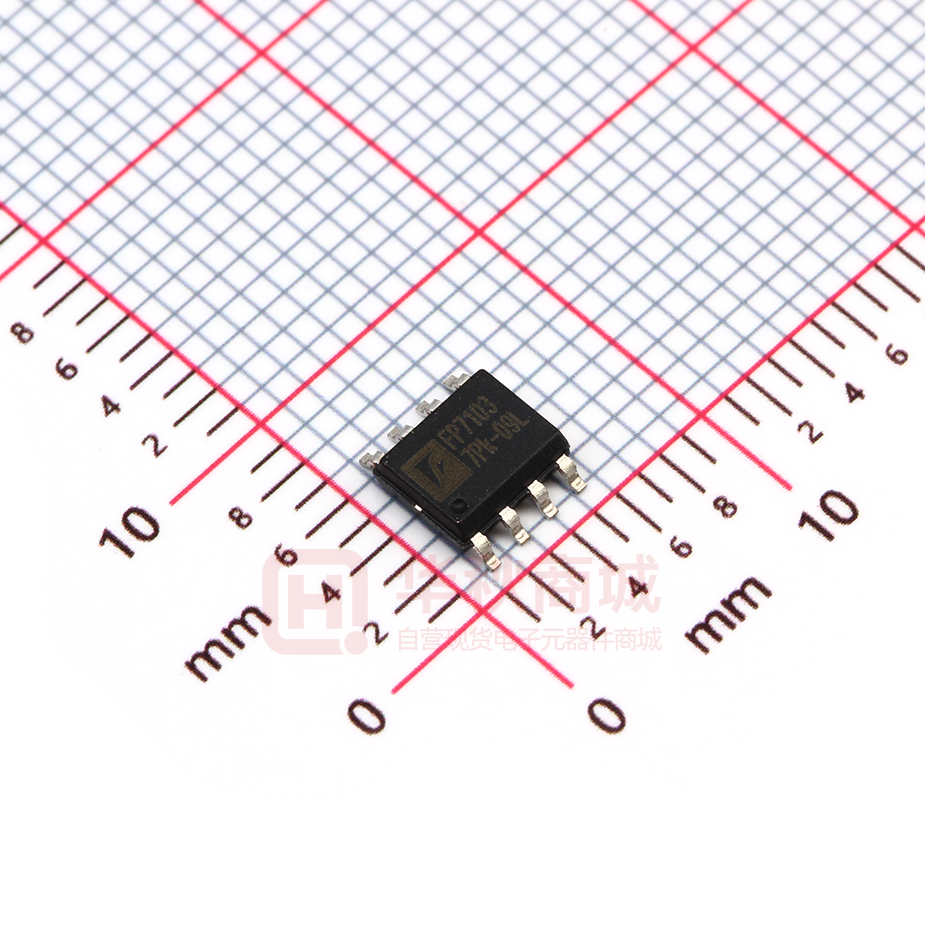

FP7103XR-LF
FP7103XR-LF
    FEELING(遠翔科技)
    ESOP-8
    28V,3A Buck恒流开关稳压器,适用于白色LED
FP7103XR-LF 数据手册
FP7103 28V, 3A Buck Constant Current Switching Regulator for White LED General Description The FP7103 is a PWM control buck converter designed to provide a simple, high efficiency solution for driving high power LEDs. With a 0.25V reference voltage feedback control to minimize power dissipation, an external resistor sets the current as needed for driving various types of LEDs. The FP7103 includes a high current P-MOSFET to realize high efficiency and excellent transient characteristics. The PWM control circuit is able to change the duty ratio linearly from 0 up to 100%. Other features include user accessible EN pin for enabling, thermal shutdown, cycle-by-cycle current limit and over current protection. Features        Wide Supply Voltage Operating Range: 3.6 to 28V Built-in P-MOSFET for 3A Loading Capability Precision Feedback Reference Voltage: 0.25V (2%) Low Current Consumption: 4mA Internal Fixed Oscillator Frequency: 320KHz (Typ.) Internal Soft-Start Function (SS) Over Current Protection  Package: SOP-8L& SOP-8L(EP) Typical Application Circuit VIN LX V CC LX FP7103 ON/OFF EN FB COMP GND GND This datasheet contains new product information. Feeling Technology reserves the rights to modify the product specification without notice. No liability is assumed as a result of the use of this product. No rights under any patent accompany the sales of the product. Rev. 0.93 Website: http://www.feeling-tech.com.tw 1/12 FP7103 Function Block Diagram EN VCC Enable Control Reference Regulator Oscillator 2.50V Over Current Protection 36K FB 0. 25V Output Drive Control Circuits 500 COMP Thermal Shutdown Internal Soft Start Circuit GND GND LX LX This datasheet contains new product information. Feeling Technology reserves the rights to modify the product specification without notice. No liability is assumed as a result of the use of this product. No rights under any patent accompany the sales of the product. Rev. 0.93 Website: http://www.feeling-tech.com.tw 2/12 FP7103 Pin Descriptions SOP- 8L Name FB No. I / O 1 I Description Error Amplifier Inverting Input FP7103 9Fa-86L EN 2 I Enable Control COMP 3 O Error Amplifier Compensation Output VCC 4 P IC Power Supply (PMOS Source) LX 5 P PMOS High Current Output LX 6 P PMOS High Current Output GND 7 O IC Ground GND 8 O IC Ground SOP-8L (EP) Top View FB 1 8 GND EN 2 7 GND COMP 3 6 LX VCC 4 5 LX Bottom View Name No. I / O Description FB 1 I Error Amplifier Inverting Input EN 2 I Enable Control COMP 3 O Error Amplifier Compensation Output VCC 4 P IC Power Supply (PMOS Source) LX 5 P PMOS High Current Output LX 6 P PMOS High Current Output GND 7 O IC Ground GND 8 O IC Ground EP 9 P Exposed PAD. Must connect to LX EP This datasheet contains new product information. Feeling Technology reserves the rights to modify the product specification without notice. No liability is assumed as a result of the use of this product. No rights under any patent accompany the sales of the product. Rev. 0.93 Website: http://www.feeling-tech.com.tw 3/12 FP7103 Marking Information SOP-8L & SOP-8L (EP) FP7103 Halogen Free Lot Number Internal ID Per-Half Month Year Halogen Free: Halogen free product indicator Lot Number: Wafer lot number’s last two digits For Example: 132386TB  86 Internal ID: Internal Identification Code Per-Half Month: Production period indicated in half month time unit For Example: January → A (Front Half Month), B (Last Half Month) February → C (Front Half Month), D (Last Half Month) Year: Production year’s last digit This datasheet contains new product information. Feeling Technology reserves the rights to modify the product specification without notice. No liability is assumed as a result of the use of this product. No rights under any patent accompany the sales of the product. Rev. 0.93 Website: http://www.feeling-tech.com.tw 4/12 FP7103 Ordering Information Part Number Operating Temperature Package MOQ Description FP7103DR-LF -25°C ~ +85°C SOP-8L 2500EA Tape & Reel FP7103XR-LF -25°C ~ +85°C SOP-8L (EP) 2500EA Tape & Reel Absolute Maximum Ratings Parameter Max. Unit 28 V 3 A +1.2 V 650 mW θJA +175 ℃/W θJC +45 ℃/W Symbol Power Supply Voltage Conditions Min. Typ. VIN Output Source Current Error Amplifier Inverting Input -0.3 TA≦+25℃ Allowable Dissipation Thermal Resistance Junction to Ambient Thermal Resistance Junction to Case ESD Susceptibility HBM (Human Body Mode) MM (Machine Mode) Storage Temperature Lead Temperature (soldering, 10 sec) -55 2 KV 200 V +125 ℃ +260 ℃ IR Re-flow Soldering Curve This datasheet contains new product information. Feeling Technology reserves the rights to modify the product specification without notice. No liability is assumed as a result of the use of this product. No rights under any patent accompany the sales of the product. Rev. 0.93 Website: http://www.feeling-tech.com.tw 5/12 FP7103 Recommended Operating Conditions Parameter Symbol Supply Voltage Conditions VIN Operating Temperature Min. Max. Unit 3.6 Typ. 28 V -25 85 ℃ DC Electrical Characteristics (VCC=6V, TA= 25℃, unless otherwise noted) Parameter Symbol Conditions Min. Typ. Max. Unit 0.245 0.25 0.255 V mV Reference Output Voltage VREF FB connected to COMP Input Regulation △VREF VCC=3.6 V to 25 V 2 12.5 Output Voltage Change with Temperature △VREF / TA=-25℃ to +25℃ VREF TA=+25℃ to +85℃ 1 2 1 2 % Oscillator Section Oscillation Frequency f 320 KHz Frequency Change with Voltage Δf / ΔV VCC=3.6V to 25V 5 % Frequency Change with Temperature Δf / ΔT TA = -25℃ to +85℃ 5 % Error Amplifier Section Input Bias Current IB Voltage Gain Av Frequency Bandwidth BW Output Voltage Swing Positive VPOS Output Voltage Swing Negative VNEG Output Source Current -1.0 Av=0 dB 1.7 ISINK Vcomp=200mV 1.0 μA 100 V/V 6 MHz 2 V 0.1 ISOURCE Vcomp=200mV Output Sink Current -0.2 0.2 V -15 -30 μA 15 30 μA 100 % -20 V -3 A Idle Period Adjustment Section Maximum Duty Cycle TDUTY VFB =0.2V Output Section PMOS D-S Voltage VDSS PMOS Source Current ID PMOS On Resistance RDS (ON) Output Leakage Current IL VCOMP=0.1V VCC=5.0V, V FB=0V 40.5 52 VCC=10V, V FB=0V 64 87 VDS=-24V, VGS=0V -1 mΩ μA Thermal Shutdown Section Thermal shutdown Temperature 150 ℃ 4 A Over Current Protection Section PMOS OCP Current IOCP This datasheet contains new product information. Feeling Technology reserves the rights to modify the product specification without notice. No liability is assumed as a result of the use of this product. No rights under any patent accompany the sales of the product. Rev. 0.93 Website: http://www.feeling-tech.com.tw 6/12 FP7103 Parameter Symbol Conditions IEN EN pin Open Min. Typ. Max. Unit 20 μA Total Device Section EN Input Current Upper Threshold Voltage (EN) VUPPER Lower Threshold Voltage (EN) VLOW Hysteresis VHYS Average Supply Current IAVE 4 Ishutdown 15 VCC Shutdown Current 1.12 210 V 0.87 V 250 mV 6 mA μA This datasheet contains new product information. Feeling Technology reserves the rights to modify the product specification without notice. No liability is assumed as a result of the use of this product. No rights under any patent accompany the sales of the product. Rev. 0.93 Website: http://www.feeling-tech.com.tw 7/12 FP7103 Detailed Description Voltage Reference A built-in 2.5V reference regulator supplies FP7103 internal circuits. Also, this 2.5V reference voltage is divided down by an internal resistive divider to provide a 0.25V precision reference voltage to the error amplifier non-inverting terminal. Setting the LED Current FP7103 is a constant current buck regulator. The LEDs are connected between VOUT and FB pin as shown in the Typical Application Circuit section. The FB pin is 0.25V in regulation. Therefore, the LEDs current IF is set by VFB and the resistor R2 connected between FB and ground by the following equation: IF  VFB R2 IF should not exceed the 3A current capability of FP7103 and therefore R2 minimum must be approximately 0.083Ω Output Voltage The output voltage is primarily determined by the number of LEDs(n) connected between VOUT and FB pin. Therefore, VOUT can be written as: VOUT  ((n  VF )  VFB ) Where VF is the forward voltage of one LED at the set LED current level (see LED manufacturer datasheet for forward characteristics curve) Oscillator The fixed PWM frequency is generated by an internal oscillator. Its typical values are 320KHz. Thermal Protection The thermal protection is triggered when junction temperature is higher than 150℃ that may occurs by an abnormal heavy current loading. When this happens, the FP7103 turns output off. Once the junction temperature is cooled down to lower than 130℃, FP7103 starts again and turns the power switch on. This datasheet contains new product information. Feeling Technology reserves the rights to modify the product specification without notice. No liability is assumed as a result of the use of this product. No rights under any patent accompany the sales of the product. Rev. 0.93 Website: http://www.feeling-tech.com.tw 8/12 FP7103 Over Current Protection The FP7103 uses cycle-by-cycle current limit to protect the internal power switch. During each switching cycle, a current limit comparator detects if the power switch current exceeds the internal setting current. If it does, over current protection function decrease the oscillator frequency to prevent thermal issue. This datasheet contains new product information. Feeling Technology reserves the rights to modify the product specification without notice. No liability is assumed as a result of the use of this product. No rights under any patent accompany the sales of the product. Rev. 0.93 Website: http://www.feeling-tech.com.tw 9/12 FP7103 Application Information Typical Application Circuit IC1 1 VIN C2 R1 2 3 0 0.1µF 4 VIN C6 100µF FB GND EN GND FP7103 COMP LX VCC LX 8 7 6 L1 10µH 5 C1 0.1µF D1 SK34 C4 0.1µF C7 100µF LED R2 0.25 FP7103 3W / 5W LED for DC Input Circuit Dimming Control Circuit Changing the duty cycle of PWM signal can get different LED current. The PWM signal is recommended above 10kHz. The application circuit is shown in the following. The LED current can be calculated by the following equation: ILED  VFB  R4  ( VPWM  Duty  VFB ) R3  R5 R2 This datasheet contains new product information. Feeling Technology reserves the rights to modify the product specification without notice. No liability is assumed as a result of the use of this product. No rights under any patent accompany the sales of the product. Rev. 0.93 Website: http://www.feeling-tech.com.tw 10/12 FP7103 Package Outline SOP-8L UNIT: mm Symbols Min. (mm) Max. (mm) A 1.346 1.752 A1 0.101 0.254 A2 1.498 D 4.800 4.978 E 3.810 3.987 H 5.791 6.197 L 0.406 1.270 θ° 0° 8° Note: 1. Package dimensions are in compliance with JEDEC outline: MS-012 AA. 2. Dimension “D” does not include molding flash, protrusions or gate burrs. 3. Dimension “E” does not include inter-lead flash or protrusions. This datasheet contains new product information. Feeling Technology reserves the rights to modify the product specification without notice. No liability is assumed as a result of the use of this product. No rights under any patent accompany the sales of the product. Rev. 0.93 Website: http://www.feeling-tech.com.tw 11/12 FP7103 SOP-8L (EP) UNIT: mm Symbols Min. (mm) Max. (mm) A 1.346 1.752 A1 0.050 0.152 A2 1.498 D 4.800 4.978 E 3.810 3.987 H 5.791 6.197 L 0.406 1.270 θ° 0° 8° Exposed PAD Dimensions: Symbols Min. (mm) Max. (mm) E1 2.184 REF D1 2.971 REF Note: 1. Package dimensions are in compliance with JEDEC outline: MO-178 AA. 2. Dimension ”D” does not include molding flash, protrusions or gate burrs. 3. Dimension “E” does not include inter-lead flash or protrusions This datasheet contains new product information. Feeling Technology reserves the rights to modify the product specification without notice. No liability is assumed as a result of the use of this product. No rights under any patent accompany the sales of the product. Rev. 0.93 Website: http://www.feeling-tech.com.tw 12/12
