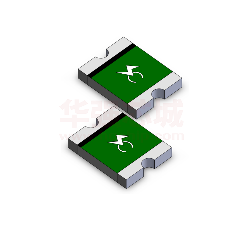

    PTC自恢复保险丝 FUSE0805 Vmax=6V Ih=1A
SCF100-0805R 数据手册
Surface Mount Resettable PTCs SCF0805 Series Description The SCF0805 Series PTC provides surface mount over-current protection for applications where space is at a premium and resettable protection is desired. Features u u u u u RoHS compliant, Lead-Free and Halogen-Free Fast time-to-trip Compact design saves board space Low resistance Low-profile Applications u u u u u u u u PC motherboard - plug and play protection Mobile phones - battery and port protection Game console port protection USB peripherals Disk drive PDAS / digital cameras Power ports General electronics Electrical Parameters Part Number Hold Current Trip Current I hold (A) I trip (A) Rated Voltage Max Current Typical Power Maximum Time To Trip V max (Vdc) I max (A) P dtyp. (W) Current (A) Time (Sec.) R min (Ω) R 1max (Ω) Resistance SCF010-0805R 0.10 0.30 15 100 0.5 0.50 1.50 0.700 6.000 SCF020-0805R 0.20 0.50 9 100 0.5 8.00 0.02 0.400 3.500 SCF035-0805R 0.35 0.75 6 100 0.5 8.00 0.10 0.250 1.200 SCF050-0805R 0.50 1.00 6 100 0.5 8.00 0.10 0.150 0.850 SCF050-9-0805R 0.50 1.00 9 100 0.5 8.00 0.10 0.150 0.850 SCF075-0805R 0.75 1.50 6 100 0.6 8.00 0.20 0.090 0.350 SCF100-0805R 1.00 1.95 6 100 0.6 8.00 0.30 0.060 0.210 I hold= Hold current: maximum current device will pass without tripping in 23°C still air. I trip= Trip current: minimum current at which the device will trip in 23°C still air. V max= Maximum voltage device can withstand without damage at rated current (Imax) I max= Maximum fault current device can withstand without damage at rated voltage (Vmax) Pdtyp.= Power dissipated from device when in the tripped state at 23°C still air. R min= Minimum resistance of device in initial (un-soldered) state. R 1max= Maximum resistance of device at 23°C measured one hour after tripping. Caution: Operation beyond the specified rating may result in damage and possible arcing and flame. SOCAY Electronics Co., Ltd. Revision December 30, 2015 www.socay.com 1/4 @ SOCAY Electronics Co., Ltd. 2015 Specifications are subject to change without notice. Please refer to www.socay.com for current information. Surface Mount Resettable PTCs SCF0805 Series Temperature Rerating Chart – I hold (A) Average Time Current Curves Temperature Derating Curve Ambient Temperature (°C) Fault Current (A) A= SCF010-0805R B= SCF020-0805R C= SCF035-0805R D= SCF050-0805R /SCF050-9-0805R E= SCF075-0805R F= SCF100-0805R Material Specifications Terminal pad material Pure Tin Soldering Characteristics Meets EIA specification RS 186-9E, ANSI/J-std-002 Category 3 Soldering Parameters TP Ramp-up Critical Zone TL to TP TL Temperature TS(max) Ramp-down TS(min) Preheat 25 Time to peak temperature (t 25℃ to peak) Time Profile Feature Pb-Free Assembly Average Ramp-Up Rate (TS max to TP) 3°C/second max. Preheat : Temperature Min (TSmin) Temperature Max (TSmax) Time (TSmin to TSmax) Time maintained above: Temperature(TL) Time (TL) 217°C 60-150 seconds Peak/Classification Temperature(TP): 260°C Time within 5°C of actual peak: Temperature 20-40 seconds Ramp-down Rate: 6°C/ second max. Time 25°C to Peak Temperature 8 minutes max. 150°C 200°C 60-180 seconds Note: All temperatures refer to of the package, measured on the package body surface. Solder reflow Caution: Due to “Lead Free” nature, Temperature and Dwelling time for the soldering zone is higher than those for Regular. This may cause damage to other components. 1. Recommended max past thickness > 0.25mm. 2. Devices can be cleaned using standard methods and aqueous solvent. 3. Rework use standard industry practices. 4. Storage Environment : < 30℃/ 60%RH 1. If reflow temperatures exceed the recommended profile, devices may not meet the performance requirements. 2. Devices are not designed to be wave soldered to the bottom side of the board. SOCAY Electronics Co., Ltd. Revision December 30, 2015 www.socay.com 2/4 @ SOCAY Electronics Co., Ltd. 2015 Specifications are subject to change without notice. Please refer to www.socay.com for current information. Surface Mount Resettable PTCs SCF0805 Series Part Marking Part Numbering SCF XXX – XX – 0805 R F1= SCF010-0805R F X F1 Device Size Code Part Identification Logo Example FA= SCF050-9-0805R Hold Current F7= SCF075-0805R F0= SCF100-0805R Socay Product Code Unit: mm The dimension in the table below provide the recommended pad layout for each SCF0805 device A B C Nominal Nominal Nominal 1.20 1.00 1.50 Device 0805 Series Dimensions F3= SCF035-0805R F5= SCF050-0805R Rated Voltage Pad Layouts F2= SCF020-0805R Unit: mm A B C D E Part Number Min. Max. Min. Max. Min. Max. Min. Max. Min. Max. SCF010-0805R 2.00 2.30 1.20 1.50 0.55 1.00 0.20 0.60 0.10 0.45 SCF020-0805R 2.00 2.30 1.20 1.50 0.55 1.00 0.20 0.60 0.10 0.45 SCF035-0805R 2.00 2.30 1.20 1.50 0.45 0.75 0.20 0.60 0.10 0.45 SCF050-0805R 2.00 2.30 1.20 1.50 0.55 1.25 0.20 0.60 0.10 0.45 SCF050-9-0805R 2.00 2.30 1.20 1.50 0.55 1.25 0.20 0.60 0.10 0.45 SCF075-0805R 2.00 2.30 1.20 1.50 0.55 1.25 0.20 0.60 0.10 0.45 SCF100-0805R 2.00 2.30 1.20 1.50 0.75 1.80 0.20 0.60 0.10 0.45 SOCAY Electronics Co., Ltd. Revision December 30, 2015 www.socay.com 3/4 @ SOCAY Electronics Co., Ltd. 2015 Specifications are subject to change without notice. Please refer to www.socay.com for current information. Surface Mount Resettable PTCs SCF0805 Series Packaging Part Number Packaging Option Quantity SCF010-0805R Tape & Reel -8mm/7″tape 4000 SCF020-0805R Tape & Reel -8mm/7″tape 4000 SCF035-0805R Tape & Reel -8mm/7″tape 4000 SCF050-0805R Tape & Reel -8mm/7″tape 3000 SCF050-9-0805R Tape & Reel -8mm/7″tape 3000 SCF075-0805R Tape & Reel -8mm/7″tape 3000 SCF100-0805R Tape & Reel -8mm/7″tape 3000 Tape and Reel Specifications 7.0 (177.8) 0.157 (4.0) 0.059 Diameter (1.5) 0.314 (8.0) 0.212 (5.4) 0.512(13.0) Arbor Hole Diameter 0.157 (4.0) Cover tape 0.33 (8.4) Direction of Feed Dimensions are in inches (and millimeters) Warning u Operation beyond the specified maximum ratings or improper use may result in damage and possible electrical arcing and/or flame. u PPTC device are intended for occasional over-current protection. Application for repeated over-current condition and/or prolonged trip are not anticipated. u Avoid contact of PPTC device with chemical solvent. Prolonged contact will damage the device performance. SOCAY Electronics Co., Ltd. Revision December 30, 2015 www.socay.com 4/4 @ SOCAY Electronics Co., Ltd. 2015 Specifications are subject to change without notice. Please refer to www.socay.com for current information.
