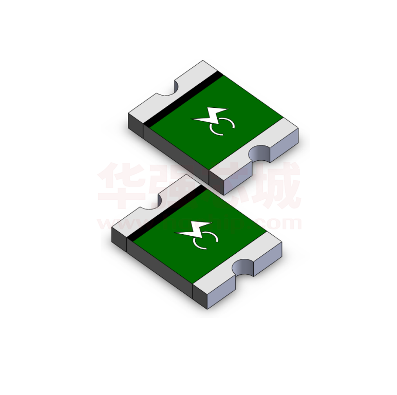

    PTC自恢复保险丝 FUSE1206 Vmax=6V Ih=1A
SCF100-1206R 数据手册
Surface Mount Resettable PTCs SCF1206 Series Description The SCF1206 Series PTC provides surface mount over-current protection for applications where space is at a premium and resettable protection is desired. Features u u u u u RoHS compliant, Lead-Free and Halogen-Free Fast time-to-trip Compact design saves board space Low resistance Low-profile Applications u u u u u u u u PC motherboard - plug and play protection Mobile phones - battery and port protection Game console port protection USB peripherals Disk drive PDAS / digital cameras Power ports General electronics Electrical Parameters Part Number SCF005-1206R SCF010-1206R SCF012-1206R SCF016-1206R SCF020-1206R SCF025-1206R SCF025-24-1206R SCF035-1206R SCF035-30-1206R SCF050-1206R SCF050-24-1206R SCF075-1206R SCF075-16-1206R SCF100-1206R SCF110-1206R SCF150-1206R SCF200-1206R Hold Current Trip Current I hold (A) I trip 0.05 0.10 0.12 0.16 0.20 0.25 0.25 0.35 0.35 0.50 0.50 0.75 0.75 1.00 1.10 1.50 2.00 (A) 0.15 0.25 0.39 0.45 0.40 0.50 0.50 0.75 0.75 1.00 1.00 1.50 1.50 1.80 2.20 3.00 3.50 Rated Voltage Max Current Typical Power Maximum Time To Trip V max (Vdc) I max (A) P dtyp. (W) Current (A) Time (Sec.) R min (Ω) R 1max (Ω) 60 60 48 48 30 16 24 16 30 8 24 8 16 6 8 8 6 100 100 100 100 100 100 100 100 100 100 100 100 100 100 100 100 100 0.4 0.4 0.6 0.6 0.4 0.6 0.6 0.4 0.6 0.4 0.6 0.6 0.6 0.6 0.8 0.8 0.8 0.25 0.50 1.00 1.00 8.00 8.00 8.00 8.00 8.00 8.00 8.00 8.00 8.00 8.00 8.00 8.00 8.00 1.50 1.00 0.20 0.30 0.10 0.08 0.08 0.10 0.10 0.10 0.10 0.20 0.20 0.30 0.30 1.00 1.50 3.600 1.600 1.400 1.100 0.600 0.550 0.550 0.300 0.300 0.150 0.150 0.090 0.090 0.055 0.040 0.040 0.018 50.000 15.000 6.500 5.000 2.500 2.300 2.300 1.200 1.200 0.700 0.750 0.290 0.290 0.210 0.180 0.120 0.080 Resistance I hold= Hold current: maximum current device will pass without tripping in 23°C still air. I trip= Trip current: minimum current at which the device will trip in 23°C still air. V max= Maximum voltage device can withstand without damage at rated current (Imax) I max= Maximum fault current device can withstand without damage at rated voltage (Vmax) Pdtyp.= Power dissipated from device when in the tripped state at 23°C still air. R min= Minimum resistance of device in initial (un-soldered) state. R 1max= Maximum resistance of device at 23°C measured one hour after tripping. Caution: Operation beyond the specified rating may result in damage and possible arcing and flame. SOCAY Electronics Co., Ltd. Revision December 28, 2015 www.socay.com 1/4 @ SOCAY Electronics Co., Ltd. 2015 Specifications are subject to change without notice. Please refer to www.socay.com for current information. Surface Mount Resettable PTCs SCF1206 Series Temperature Rerating Chart – I hold (A) Temperature Derating Curve 5Average Time Current Curves Ambient Temperature (°C) Fault Current (A) Z= SCF005-1206R A= SCF010-1206R B= SCF012-1206R C= SCF020-1206R D= SCF025-1206R E= SCF025-1206R /SCF025-24-1206R F= SCF035-1206R /SCF035-60-1206R G= SCF050-1206R /SCF050-24-1206R H= SCF075-1206R /SCF075-16-1206R I= SCF100-1206R J= SCF110-1206R K= SCF150-1206R L= SCF200-1206R Material Specifications Terminal pad material Pure Tin Soldering Characteristics Meets EIA specification RS 186-9E, ANSI/J-std-002 Category 3 Soldering Parameters TP Ramp-up Critical Zone TL to TP TS(max) Temperature Pb-Free Assembly Average Ramp-Up Rate (TS max to TP) 3°C/second max. Preheat : Temperature Min (TSmin) Temperature Max (TSmax) Time (TSmin to TSmax) Time maintained above: Temperature(TL) Time (TL) TL Ramp-down TS(min) Preheat 25 Time to peak temperature (t 25℃ to peak) Profile Feature Time 150°C 200°C 60-180 seconds 217°C 60-150 seconds Peak/Classification Temperature(TP): 260°C Time within 5°C of actual peak: Temperature 20-40 seconds Ramp-down Rate: 6°C/ second max. Time 25°C to Peak Temperature 8 minutes max. Note: All temperatures refer to of the package, measured on the package body surface. Solder reflow Caution: Due to “Lead Free” nature, Temperature and Dwelling time for the soldering zone is higher than those for Regular. This may cause damage to other components. 1. Recommended max past thickness > 0.25mm. 2. Devices can be cleaned using standard methods and aqueous solvent. 3. Rework use standard industry practices. 4. Storage Environment : < 30℃/ 60%RH 1. If reflow temperatures exceed the recommended profile, devices may not meet the performance requirements. 2. Devices are not designed to be wave soldered to the bottom side of the board. SOCAY Electronics Co., Ltd. Revision December 28, 2015 www.socay.com 2/4 @ SOCAY Electronics Co., Ltd. 2015 Specifications are subject to change without notice. Please refer to www.socay.com for current information. Surface Mount Resettable PTCs SCF1206 Series Part Marking Part Numbering F X SCF XXX – XX – 1206R FA Part Identification Logo Device Size Code Example Rated Voltage Hold Current Socay Product Code Pad Layouts Unit: mm The dimension in the table below provide the recommended pad layout for each SCF1206 device A B C Nominal Nominal Nominal 2.00 1.00 1.90 Device 1206 Series Dimensions FZ= SCF005-1206R FA= SCF010-1206R FJ= SCF012-1206R FK= SCF016-1206R FB= SCF020-1206R FL= SCF025-1206R FP= SCF025-24-1206R FC= SCF035-1206R FM= SCF035-30-1206R FD= SCF050-1206R FN= SCF050-24-1206R FE= SCF075-1206R FO= SCF075-16-1206R FF= SCF100-1206R FG= SCF110-1206R FH= SCF150-1206R FI = SCF200-1206R Unit: mm Part Number SCF005-1206R SCF010-1206R SCF012-1206R SCF016-1206R SCF020-1206R SCF025-1206R SCF025-24-1206R SCF035-1206R SCF035-30-1206R SCF050-1206R SCF050-24-1206R SCF075-1206R SCF075-16-1206R SCF100-1206R SCF110-1206R SCF150-1206R SCF200-1206R A Min. 3.00 3.00 3.00 3.00 3.00 3.00 3.00 3.00 3.00 3.00 3.00 3.00 3.00 3.00 3.00 3.00 3.00 B Max. 3.50 3.50 3.50 3.50 3.50 3.50 3.50 3.50 3.50 3.50 3.50 3.50 3.50 3.50 3.50 3.50 3.50 Min. 1.50 1.50 1.50 1.50 1.50 1.50 1.50 1.50 1.50 1.50 1.50 1.50 1.50 1.50 1.50 1.50 1.50 C Max. 1.80 1.80 1.80 1.80 1.80 1.80 1.80 1.80 1.80 1.80 1.80 1.80 1.80 1.80 1.80 1.80 1.80 Min. 0.45 0.45 0.45 0.45 0.45 0.45 0.45 0.30 0.90 0.25 0.80 0.45 0.45 0.45 0.45 0.80 0.85 SOCAY Electronics Co., Ltd. Revision December 28, 2015 D Max. 0.85 0.85 0.85 0.75 0.75 0.75 0.75 0.75 1.30 0.55 1.20 1.25 1.25 1.00 1.00 1.40 1.60 Min. 0.10 0.10 0.10 0.10 0.10 0.10 0.10 0.10 0.25 0.10 0.25 0.25 0.25 0.25 0.25 0.25 0.25 E Max. 0.75 0.75 0.75 0.75 0.75 0.75 0.75 0.75 0.75 0.75 0.75 0.75 0.75 0.75 0.75 0.75 0.75 Min. 0.10 0.10 0.10 0.10 0.10 0.10 0.10 0.10 0.10 0.10 0.10 0.10 0.10 0.10 0.10 0.10 0.10 Max. 0.45 0.45 0.45 0.45 0.45 0.45 0.45 0.45 0.45 0.45 0.45 0.45 0.45 0.45 0.45 0.45 0.45 www.socay.com 3/4 @ SOCAY Electronics Co., Ltd. 2015 Specifications are subject to change without notice. Please refer to www.socay.com for current information. Surface Mount Resettable PTCs SCF1206 Series Packaging Part Number Packaging Option Quantity SCF005-1206R Tape & Reel -8mm/7″tape 3000 SCF010-1206R Tape & Reel -8mm/7″tape 3000 SCF012-1206R Tape & Reel -8mm/7″tape 3000 SCF016-1206R Tape & Reel -8mm/7″tape 3000 SCF020-1206R Tape & Reel -8mm/7″tape 3000 SCF025-1206R Tape & Reel -8mm/7″tape 3000 SCF025-24-1206R Tape & Reel -8mm/7″tape 3000 SCF035-1206R Tape & Reel -8mm/7″tape 4000 SCF035-30-1206R Tape & Reel -8mm/7″tape 3000 SCF050-1206R Tape & Reel -8mm/7″tape 4000 SCF050-24-1206R Tape & Reel -8mm/7″tape 3000 SCF075-1206R Tape & Reel -8mm/7″tape 3000 SCF075-16-1206R Tape & Reel -8mm/7″tape 3000 SCF100-1206R Tape & Reel -8mm/7″tape 3000 SCF110-1206R Tape & Reel -8mm/7″tape 3000 SCF150-1206R Tape & Reel -8mm/7″tape 2000 SCF200-1206R Tape & Reel -8mm/7″tape 2000 Tape and Reel Specifications 7.0 (177.8) 0.157 (4.0) Diameter 0.314 (8.0) 0.212 (5.4) 0.157 (4.0) Cover tape 0.33 (8.4) Direction of Feed Dimensions are in inches (and millimeters) Warning u Operation beyond the specified maximum ratings or improper use may result in damage and possible electrical arcing and/or flame. u PPTC device are intended for occasional over-current protection. Application for repeated over-current condition and/or prolonged trip are not anticipated. u Avoid contact of PPTC device with chemical solvent. Prolonged contact will damage the device performance. SOCAY Electronics Co., Ltd. Revision December 28, 2015 www.socay.com 4/4 @ SOCAY Electronics Co., Ltd. 2015 Specifications are subject to change without notice. Please refer to www.socay.com for current information.
SCF100-1206R
物料型号:SCF1206 Series PTC
器件简介:SCF1206系列PTC提供表面贴装过流保护,适用于空间有限且需要可重置保护的应用。
引脚分配:文档中没有提供具体的引脚分配图,但通常PTC为两个引脚。
参数特性: - 符合RoHS标准,无铅和无卤素 - 快速响应时间 - 紧凑设计节省板空间 - 低电阻 - 低轮廓
功能详解: - 过流保护:在23°C静止空气中,设备在达到设定的触发电流前不会触发。 - 可重置:在过流条件移除后,设备可以恢复到初始状态。
应用信息: - 电脑主板 - 即插即用保护 - 移动电话 - 电池和端口保护 - 游戏控制台端口保护 - USB外围设备 - 磁盘驱动器 - PDA/数码相机 - 电源端口 - 一般电子设备
封装信息: - 封装类型:1206 - 封装尺寸:长3.00mm至3.50mm,宽1.50mm至1.80mm,最大高度0.45mm至1.60mm
电气参数详细列出了不同型号的保持电流、触发电流、额定电压、最大电流、典型功率消耗、最小电阻和最大电阻等。
焊接参数和材料规格也在文档中有详细说明。此外,还提供了温度重评曲线、平均时间电流曲线和零件编号规则。
